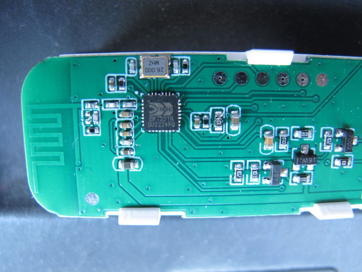

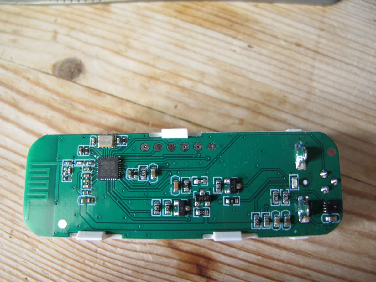

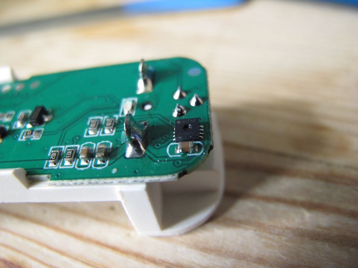

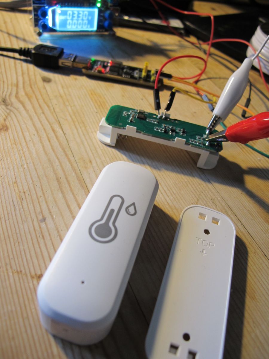

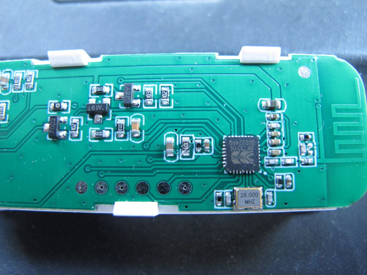

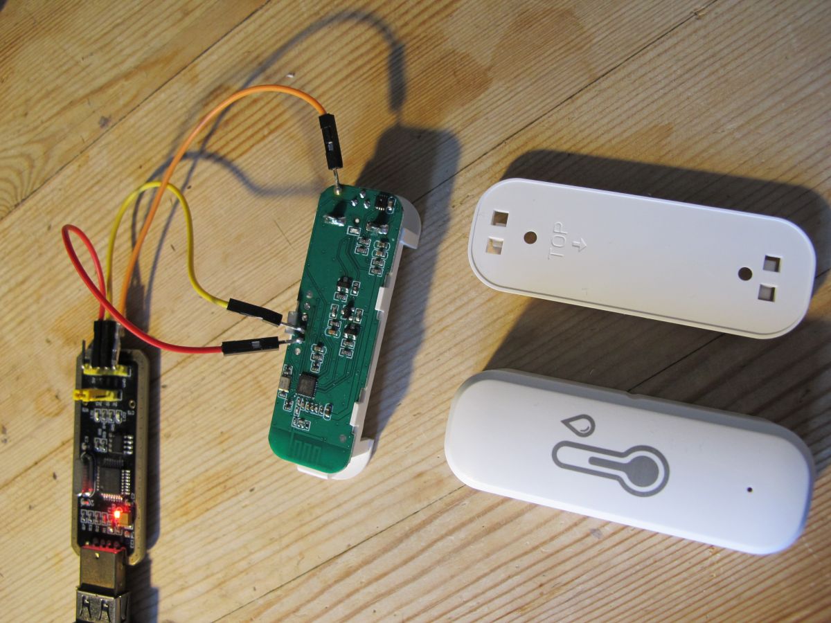

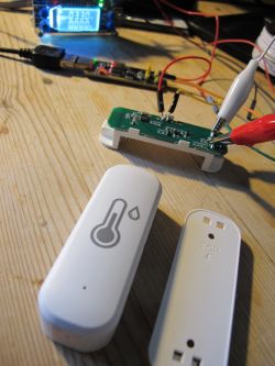

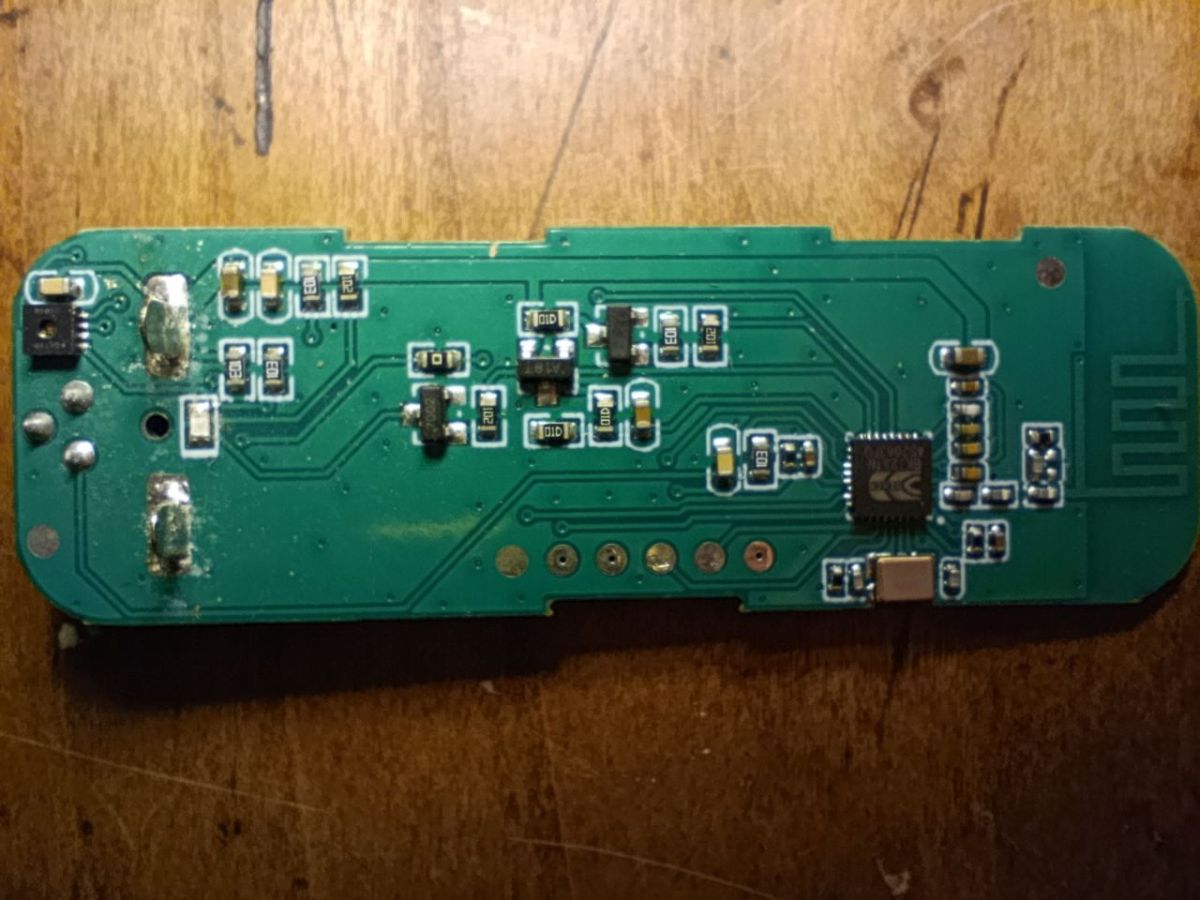

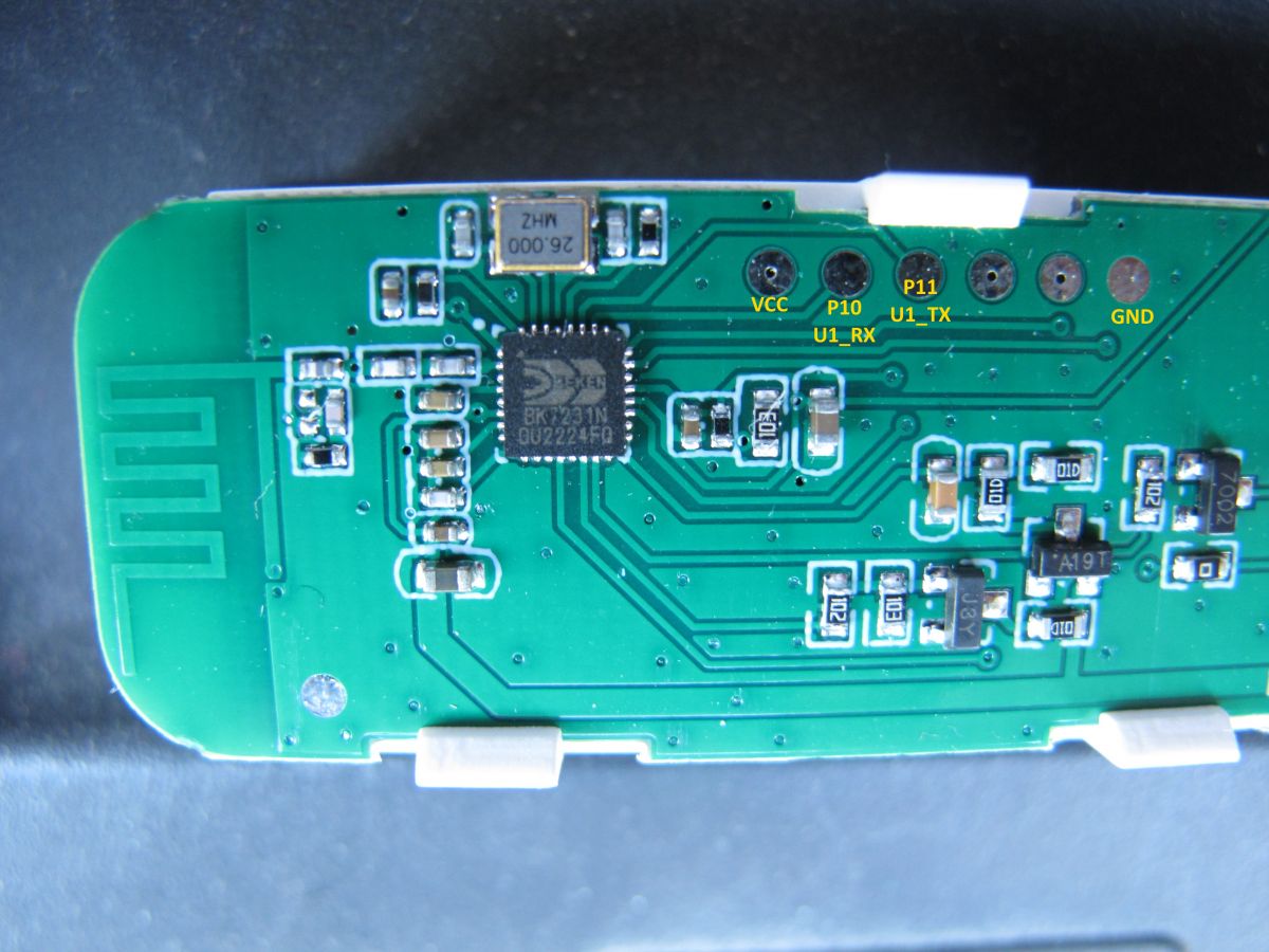

    I won't go mad with detail because it's just another TH01 type battery temperature/humidity sensor that other threads can be consulted on for more intimate detail on this kind of device. Posting so this can be another +1 for the device list.
    This one appears to vary in that it has no module. The BK7231N is soldered directly to the PCB and is accompanied by an SHT30 temperature and humidity sensor.
    TH01 temperature and humidity sensor with attached test wires on a wooden table next to the casing. TH01 temperature and humidity sensor with connected wires on a wooden floor background. User manual brochure for a temperature and humidity sensor. Sensor box with a label containing barcodes and compatibility icons. Wi-Fi temperature and humidity sensor kit, user manual, and reset tool. Close-up of a printed circuit board with a BK7231N chip and other electronic components. Close-up of a PCB with a BK7231N chip. Close-up of a circuit board with a soldered integrated circuit and components. Circuit board with mounted integrated circuit and electronic components.

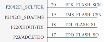

    The test pads are
    Printed circuit board of a temperature and humidity sensor with BK7231N chip.
    The two unlabelled in the middle are two of these 4 I believe
    Diagram of connections with labeled pins on a circuit board.
    which means there is no readily available UART2_TXD for the output log. The underside of the PCB is plain but for a ground pad.

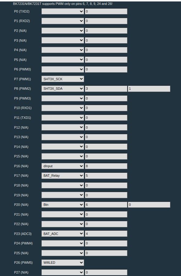

    Dump attached. Firmware version 1.1.17, which looks to be cloudcuttable. Extracted pin assignments:
    and the user params
    The presence of "net_led_pin":"26" in the json but not in the plain text assignment list means Easy Flasher forgot to include P26 for the WifiLED.
    It's good to see the new additions showing

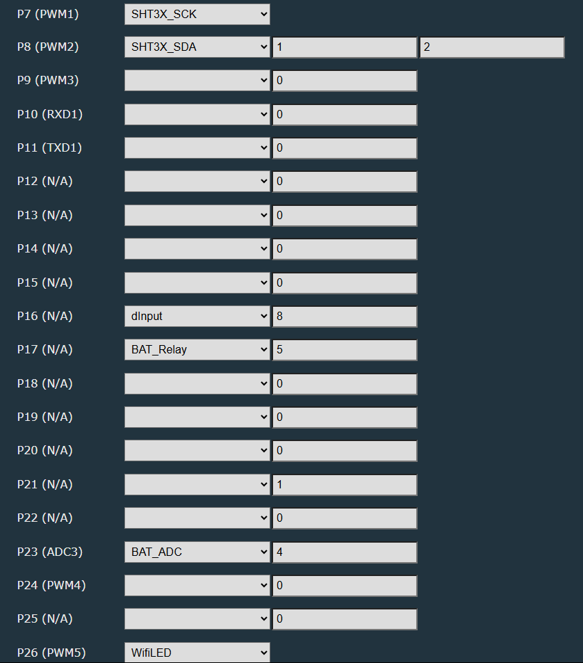

    which means we assign the SHT:
    Screenshot of the pin configuration interface for P7 and P8 with SHT3X assignments.
    The alert pin is not yet usable.

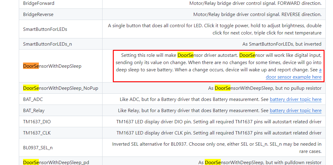

    basic autoexec to config battery:
    P20 button swapped for DoorSnsrWSleep so the button can wake the device from deep sleep.
    Data table for DoorSensorWithDeepSleep driver.

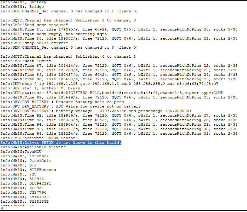

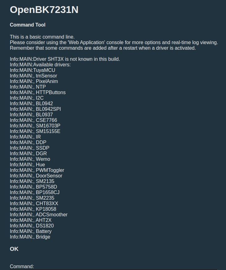

    Hi and congratulations for your excellent work.
    I've a problem with a sensor, it's like the one posted in the first message.
    It doesn't show temperature nor humidity.
    I've flashed it with openbeken, last version. It shows battery percentage, although I'm feeding it with a lm1117.
    In the log is showing a clear message that states: "Info:MAIN:Driver SHT3X is not known in this build."
    Is there a way to test if sht30 isn't damaged? I'm not using this sensor for a few months, without batteries.
    This is the startup command:

    For now I'm only interested in having temp and humidity values, because probably the sensor will be permanently energized, so don't mind about power save modes.
    Thanks for any help.
    Fernando
    Screenshot of system logs, showing channel changes, MQTT connections, and errors related to unknown SHT3X driver.
    Screenshot of the OpenBekenX user interface showing device status information.
    GPIO interface configuration showing a list of pins and their functions.

    SHT3X driver is not enabled in the firmware by default.
    If you have a git account, you can download a version with this driver in the artifacts of
    PR #1601.

    Good morning
    Thanks max4elektroda, you nailed it.

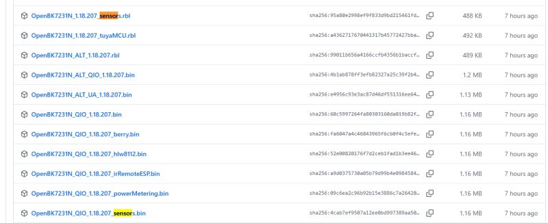

    I think that Releases section has _sensors build version of OpenBeken available for download. https://github.com/openshwprojects/OpenBK7231T_App

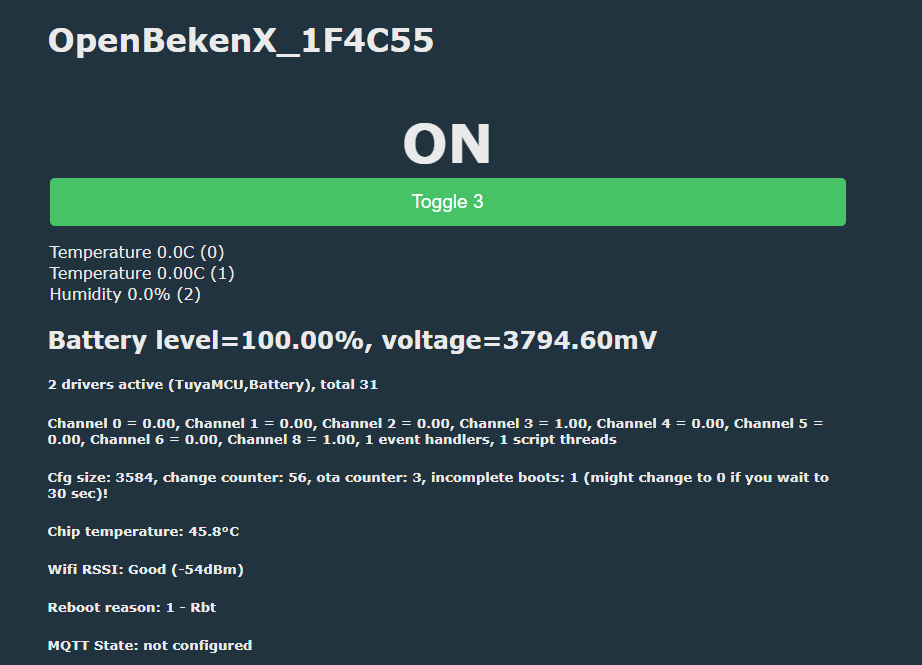

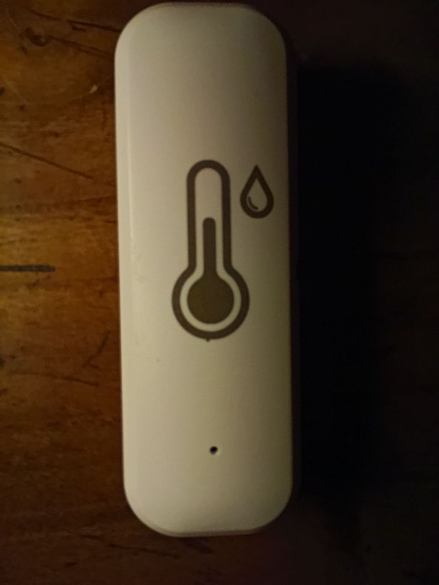

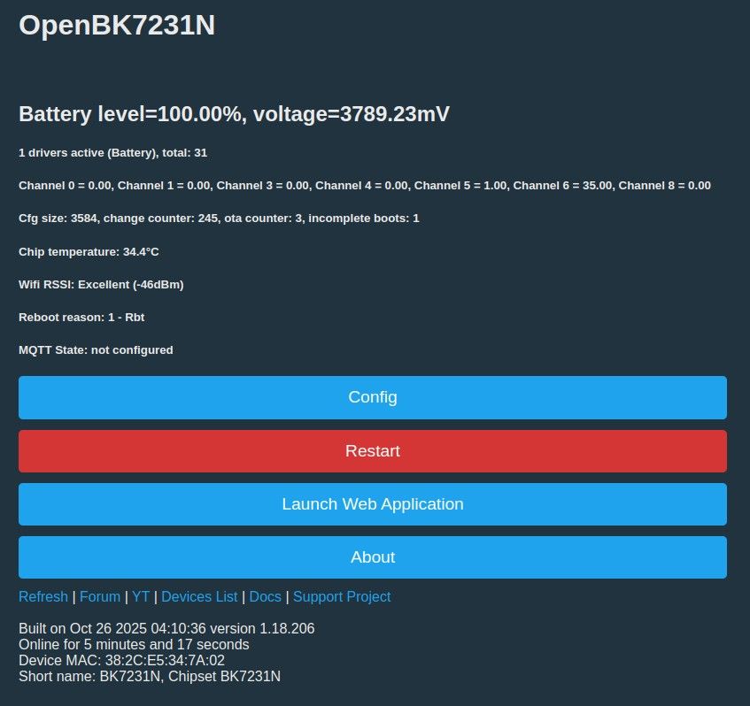

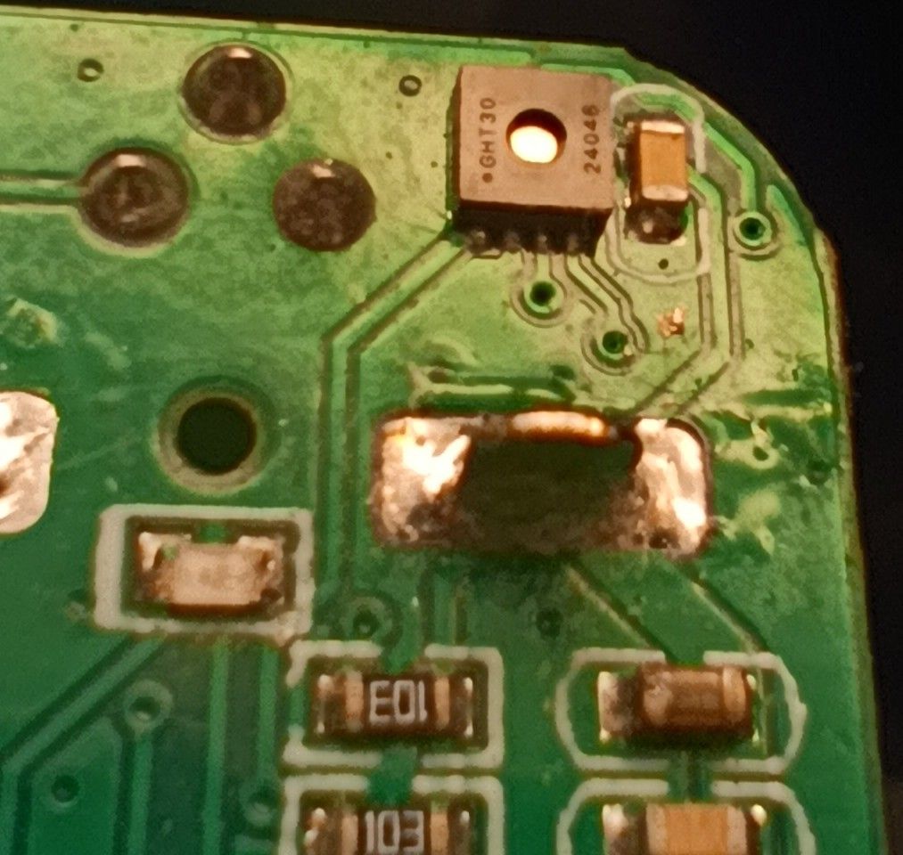

    Hi,
    I've the same TH01 as posted in the first message but it doesn't show temperature or humidity.
    Running on Built on Oct 26 2025 04:10:36, version 1.18.206.
    In the log nothing is mentioned about missing driver. I've added in autoexec.bat: startDriver SHT3X
    BK7231T microcontroller pin configuration with functions and values mapped
    But only one driver is loaded
    Screenshot of OpenBK7231N interface showing system status and control buttons
    I took a good look at the sensor and it's an 8-pin GTH30 (https://www.lcsc.com/datasheet/C3010791.pdf) instead of a SHT30, but don't know if I need another driver. All the pins are connected as earlier mentioned (GHT30 pin1 SDA to PWM2/P8 pin 24, and GHT30 pin4 SCL to PWM1/P7 pin 23)
    Close-up of a GTH30 sensor on a green PCB with visible traces and electronic components.
    I've tried it on two others with the same result. I'm curious if one of you faced the same issue and if you have a solution.
    Thanks

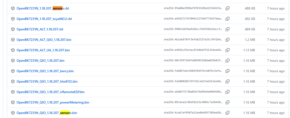

    SHT30 driver and soft I2C scan suggestion
    #12 21743731
    Posts: 5217
    Help: 448
    Rate: 917
    SHT30 driver is available in the Sensors release of OpenBeken
    https://github.com/divadiow/OpenBK7231T_App/blob/main/src/obk_config.h#L340
    List of OpenBK7231N binary firmware files with configuration variants
    Not heard of GHT30 before.

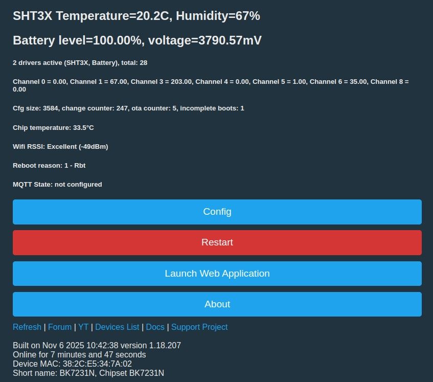

    You could swap SHT3X assignment now for SoftSDA and SoftSCL, run startdriver i2c then try scani2c soft command
    do you get an i2c address back like
    it looks like SHT3X driver expects 0x44
    https://github.com/openshwprojects/OpenBK7231T_App/blob/main/src/driver/drv_sht3x.c#L16
  • #13 21743974
    jacgerri
    Level 4  
    Yes, brilliant. It cost me days, but this is the solution! Thanks.
    startdriver i2c gave me the feedback that it was loaded; startDriver SHT3X gave me this:
    Driver list in the OpenBK7231N command tool console interface
    So I've flashed the release which you mentioned and I've finally the sensor output.
    IoT device status panel with temperature, humidity, and battery level data
    Thanks again.

    Please post config template json from web app and I'll add to device list. Any other pics or keywords from PCB, make, model etc unique to your variant, welcome. 😊
    TH01 variant with GHT30 and OpenBK config
    #16 21749525
    jacgerri
    Level 4  
    Sure. My board looks exactly like the first post but with a GHT30.
    White sensor with thermometer and droplet icon on wooden surface
    Green PCB with electronic SMD components on wooden surface
    GHT30 sensor and several SMD components on a green PCB
