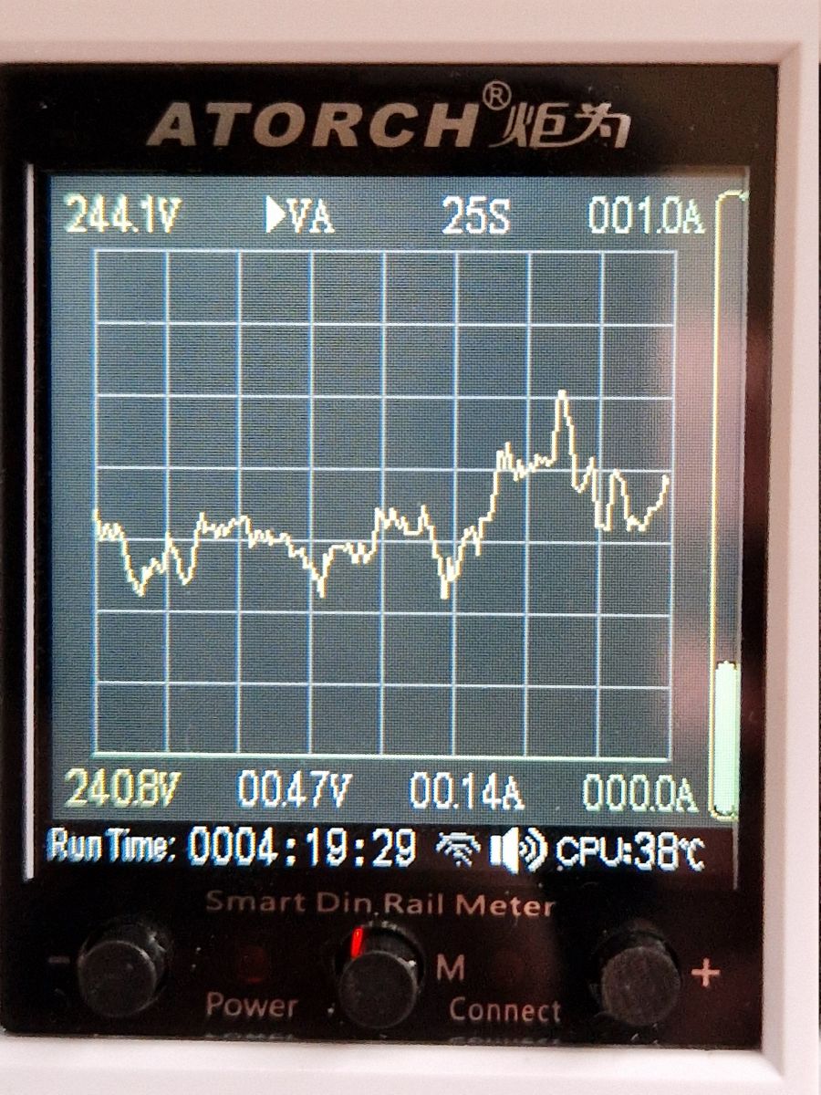

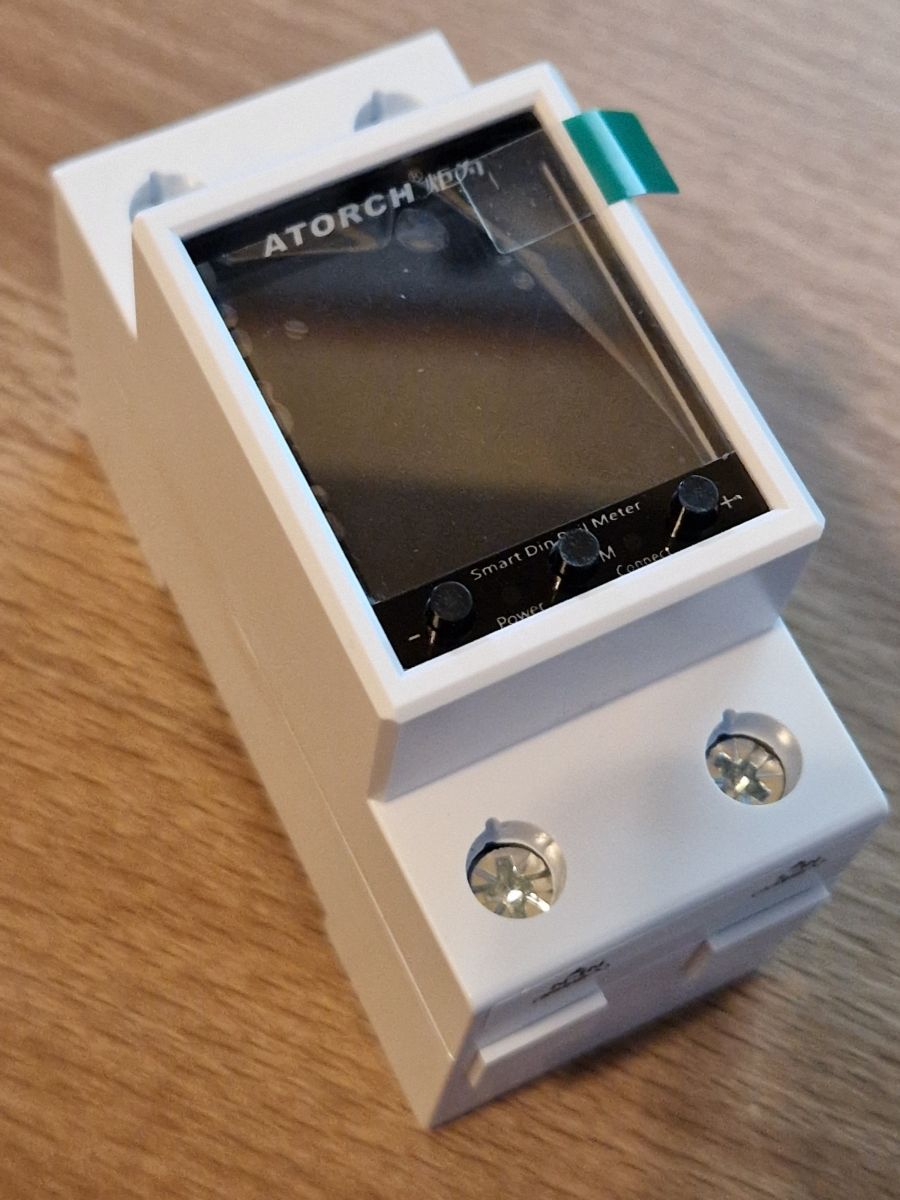

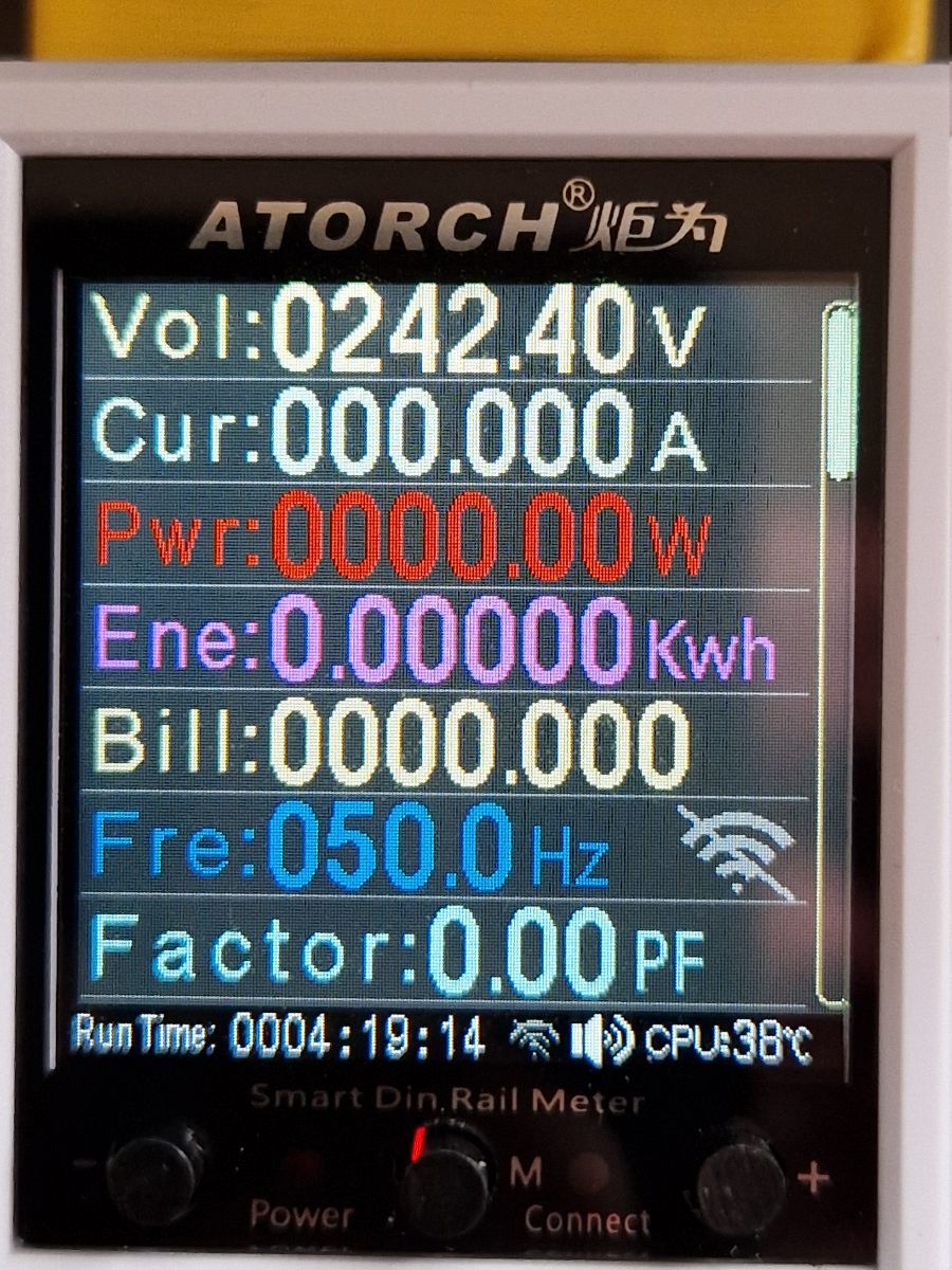

    DIN Rail Energy monitor Atorch GR2P with display.
    Close-up of the Atorch DIN Rail Energy monitor display with measurement data.

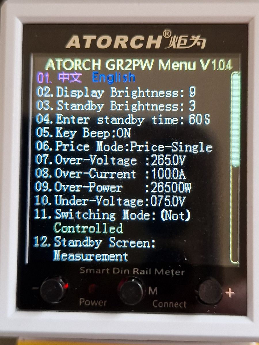

    The buttons, menus, and display appearance are strikingly similar to the Atorch S1-B/W/T/H.

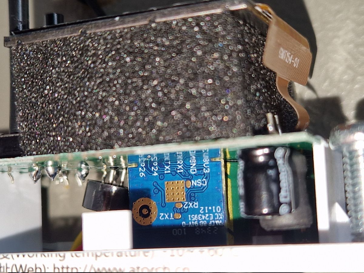

    The GR2P is easy to open with two screws on the bottom.

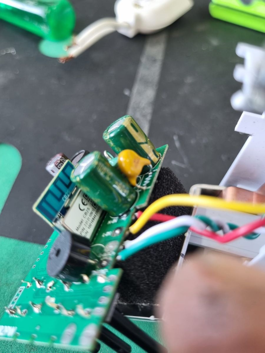

    Inside, there is a stack of the display on top of the PCB with a block of black foam in between.
    Close-up view of the interior of a DIN Rail Energy Monitor with exposed PCB module and protective foam.
    A CB2S is mounted through the PCB from below. The foam sticks to both, the display and the board.
    To get to the component side of the board, one has to peel off the foam block. The adhesive is somewhat strong, some residues of foam stuck to the components.
    On the board, there are the following ICs:
    - CHF573F (RISC-V MCU)
    - BL0942 (Metering IC)
    - PN8015 (Power Management)
    I didn't try to flash the CB2S in place. It came out easily with the help of desoldering braid and gravity.
    After flashing and soldering it back into the device, the wifi node and the openbeken web app came up as expected.

    Close-up of the Atorch GR2PW energy monitor display showing the settings menu.

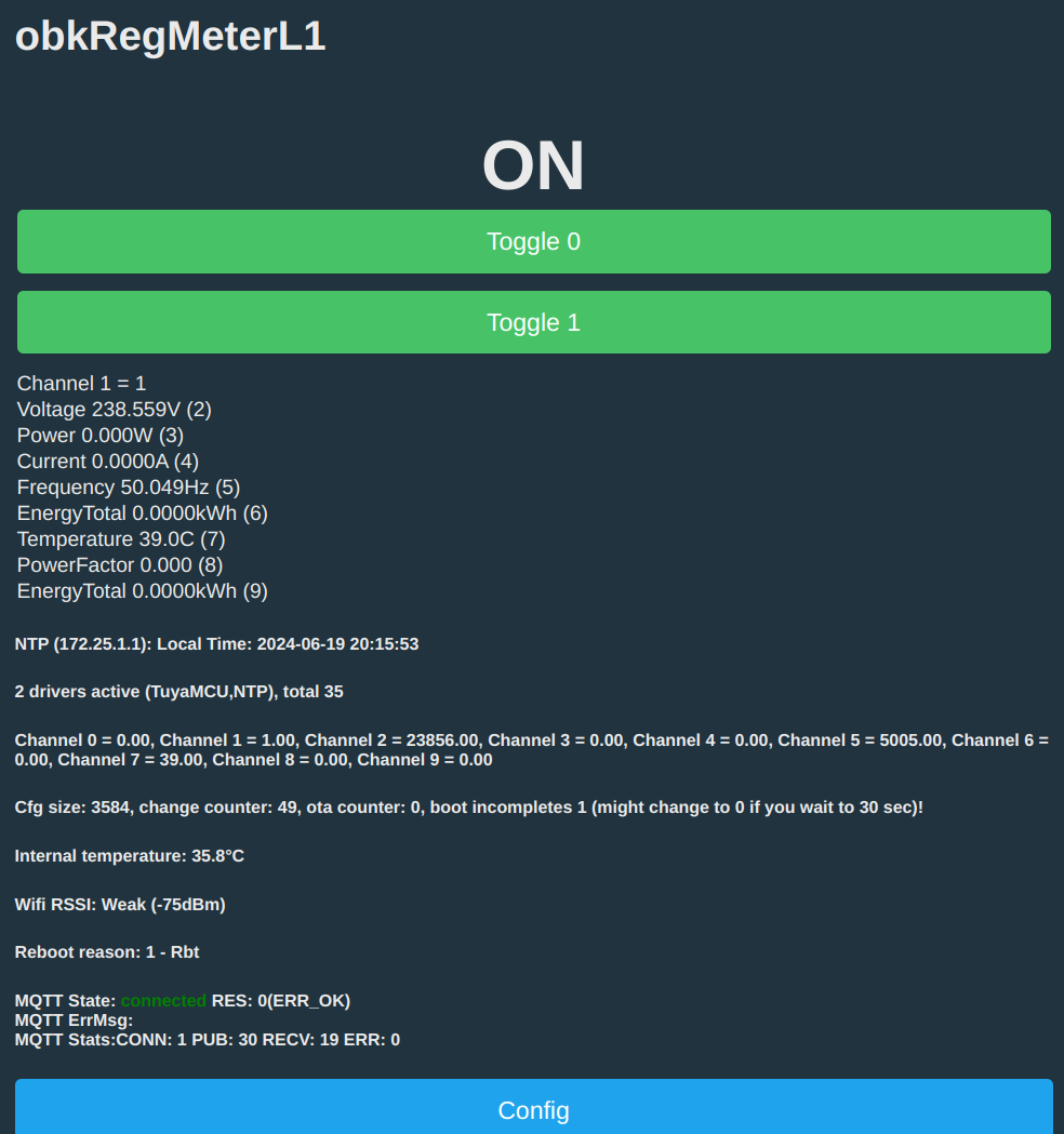

    Thanks for the hint! I dumped the backup image on extractor in the flash tool, and it said
    "baud":"9600"
    Probably I could have guessed that as well.   :)
    autoexec.bat wrote:
    startDriver TuyaMCU
    startDriver NTP
    ntp_setServer 172.25.1.1
    ntp_timeZoneOfs +01:00
    tuyaMcu_setBaudRate 9600
    setChannelType 0 Toggle_Inv
    setChannelType 1 ReadOnly
    setChannelType 2 Voltage_div100
    setChannelType 3 Power_div100
    setChannelType 4 Current_div1000
    setChannelType 5 Frequency_div100
    setChannelType 6 EnergyTotal_kWh_div1000
    setChannelType 7 Temperature
    setChannelType 8 PowerFactor_div100
    setChannelType 9 EnergyTotal_kWh_div1000
    linkTuyaMCUOutputToChannel 131 enum 0
    linkTuyaMCUOutputToChannel 1 bool 1
    linkTuyaMCUOutputToChannel 20 1 2
    linkTuyaMCUOutputToChannel 19 1 3
    linkTuyaMCUOutputToChannel 18 1 4
    linkTuyaMCUOutputToChannel 133 1 5
    linkTuyaMCUOutputToChannel 102 1 6
    linkTuyaMCUOutputToChannel 135 1 7
    linkTuyaMCUOutputToChannel 134 raw 8
    linkTuyaMCUOutputToChannel 123 1 9
    User interface of obkRegMeterL1 displaying measurement data and Toggle buttons.
    I get measurements in both web app and to the mqtt server (no load connected). Perfect!

    9600 is a default baud, it should work without any specific settings.
    Is everything working as expected? I can see your config is missing the setting of default WiFi state 0x04. By default, it's set only when MQTT is connected.
  • Corrected GR2P autoexec and baud rate settings
    #5 21125450
    bbb34
    I realize that I posted the wrong autoexec. It was the last from the S1 instead of the GR2P.
    I corrected that above: Baud rate is 9600 and 'mqtt_broadcastInterval 5' is not there. Sorry for the confusion!
    You are right that it works with the default baud rate without tuyaMcu_setBaudRate. It was just there because I copied from the S1.
    I don't know why the main page shows two toggle buttons. I'm using the device without any switch.
    But yes, everything that is there seems to work!
    I didn't know about the WiFi state 0x04, but I think that showing the MQTT state is the best for my use case.

    Maybe you still have "Toggle" channel types set? Check in the web app.

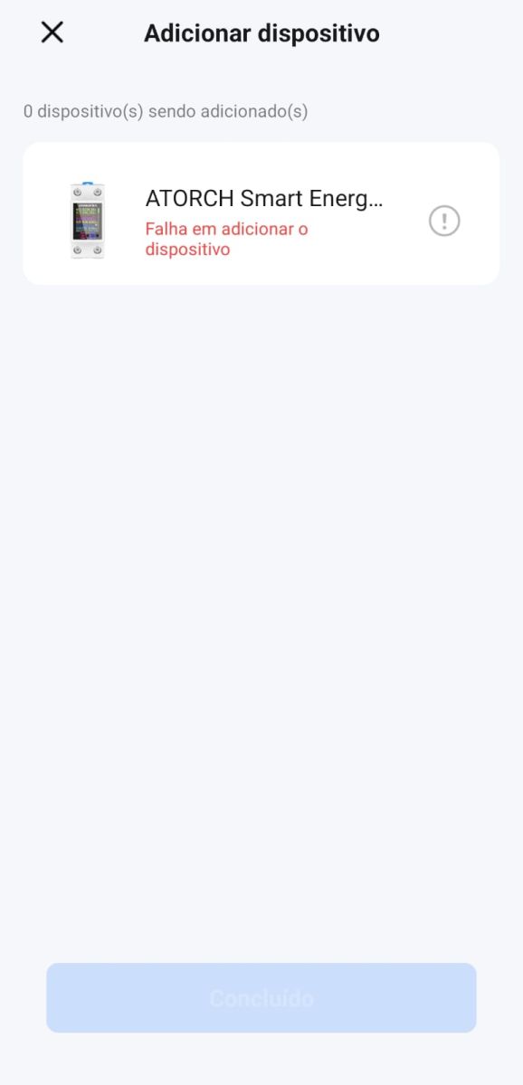

  • Question about recovering an offline ATORCH GR2PW with OpenBeken
    #8 21647307

    I have an ATORCH GR2PW that went offline. It appears in the Smart Life app, but it fails to connect and is blinking slowly.
    My device details:

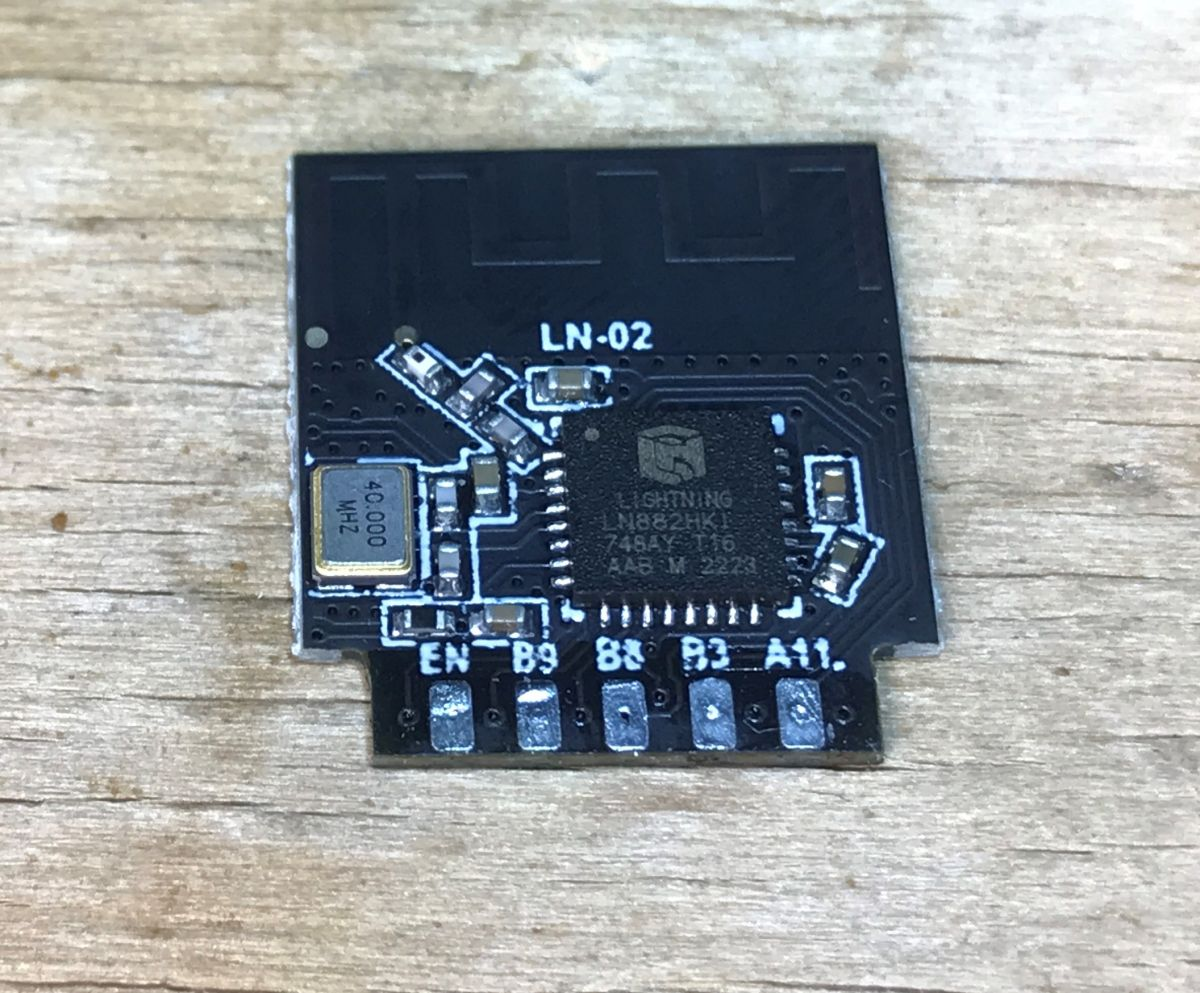

    Wi-Fi Module: LN-02 (Beken BK7231N)
    LN-02? This is known to have a Lightning Semi LN882H chip, rather than Beken. Do you have a pic?
    LN-02 electronic module with Lightning Semi LN882H chip on wooden surface

    #10 21647450

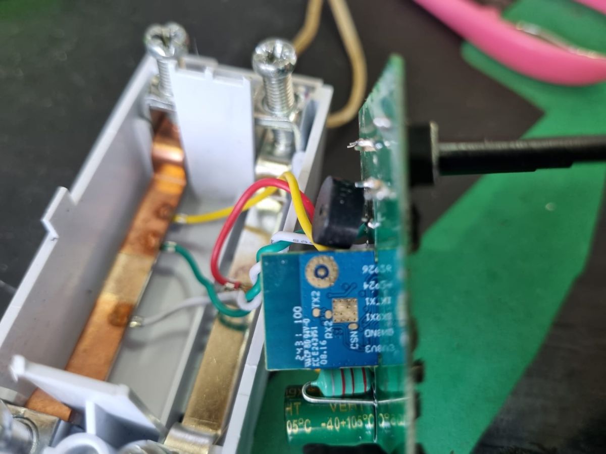

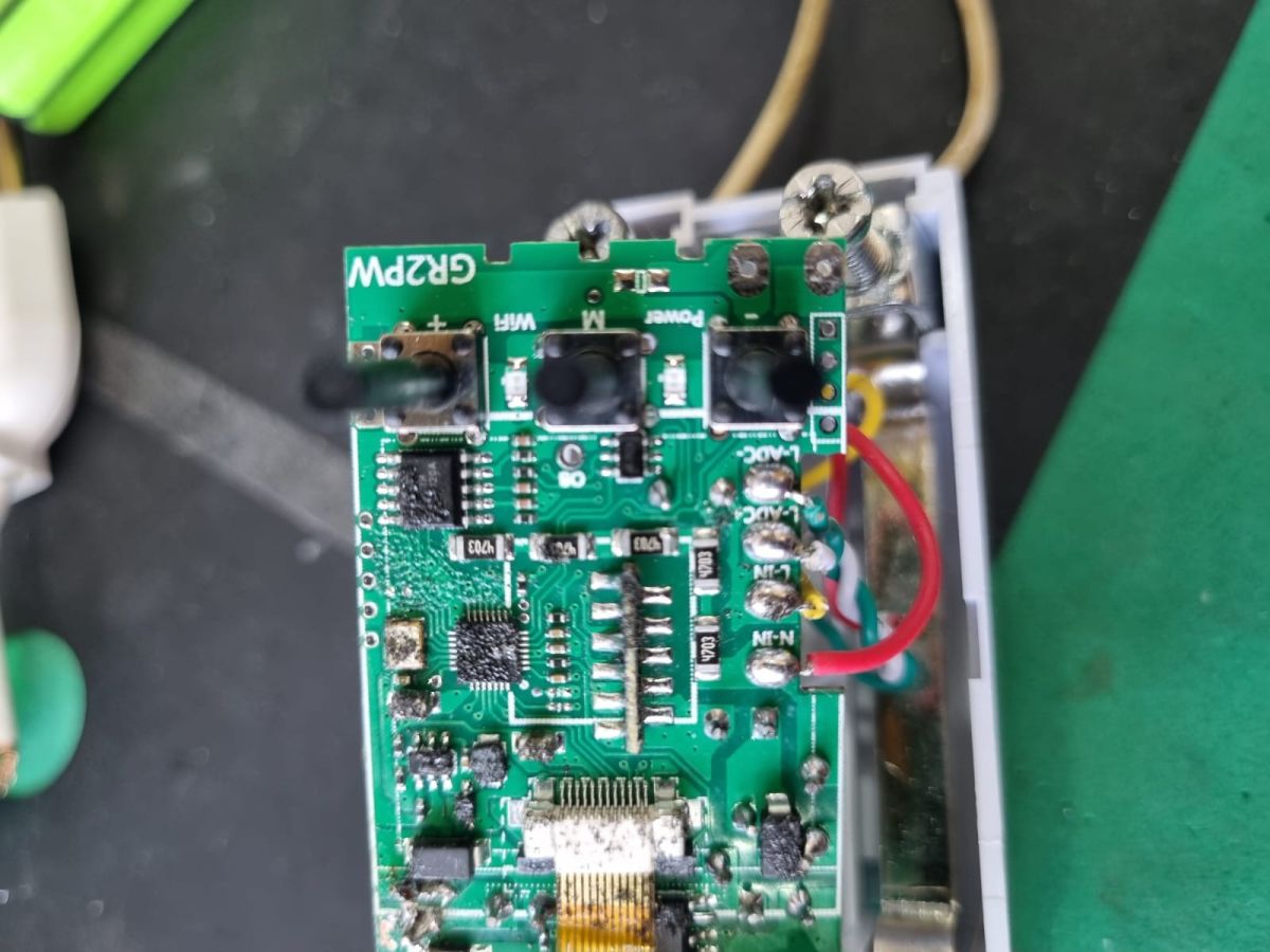

    viniciusmbs
    >>21647389 No, the GR2PW really uses a CB2S module (you can see the marking on the Wi-Fi module in the first photo). It worked for a month: my Home Assistant was running perfectly, pulling data from the solar panels and the device, and providing my consumption data. What could have happened? Suddenly, it went offline, and I deleted it from the app.
    When I open Tuya or Smart Life, it is recognized immediately, but it keeps trying to connect and eventually fails. The green LED blinks slowly. I tried putting it in AP mode, but nothing worked. I don’t know how to make it blink fast.
    The chip you showed me is an LN-02. Thank you for your time and for the response.
    Close-up of a circuit board with a CB2S Wi-Fi module and three electrolytic capacitors.
    Electronic module with connected wires and visible PCB marked CB2S mounted in a smart device enclosure.
    Close-up of GR2PW device PCB with visible connectors, wires, and Wi-Fi and power module labels.
    I even went as far as replacing one of the 16V 220µF capacitors to see if it would start working again. I’m planning to replace the other two 450V 4.7µF capacitors to see if that helps, because I have some Tuya devices that were like this and came back to life. They were swollen, but these ones look fine visually.

  • Smart Life pairing fails after initial recognition
    #12 21647925

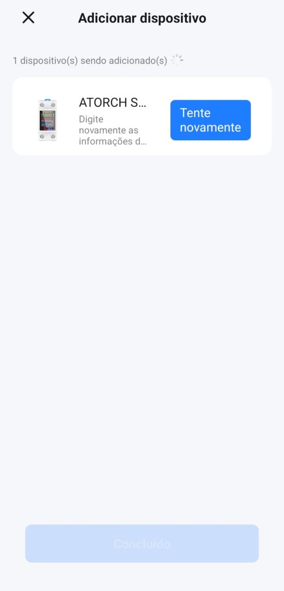

    viniciusmbs
    >>21647478 Hello @p.kaczmarek2, first of all, thank you for your reply. My name is Vinicius, I’m from Brazil. I will study your documentation carefully, and congratulations on your initiative. I am replacing all the capacitors; even though they look fine, one of them might be failing. If in the end I cannot get a connection with Smart Link, I will try Tasmota. I just want the device to connect, because without it I cannot integrate the consumption graphs in Home Assistant with my solar production.
    Device pairing screen showing ATORCH S with retry message in Portuguese.
    App screen showing error adding ATORCH Smart Energy device.

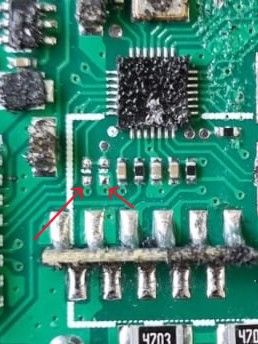

    Just one more question: these two ferrite components, it looks like something is missing. Is that normal?
    Close-up of PCB with two missing ferrite elements marked by red arrows
    Added after 1 [hours] 57 [minutes]:
    It's very strange: it is recognized by Smart Life at first, but in the end it fails. I’ve tried every possible way, even in AP mode. It creates the network, but it doesn’t connect to the app.
    In the video below, the connection light keeps blinking slowly and it doesn’t enter fast pairing mode.
    I've just answered this question here
