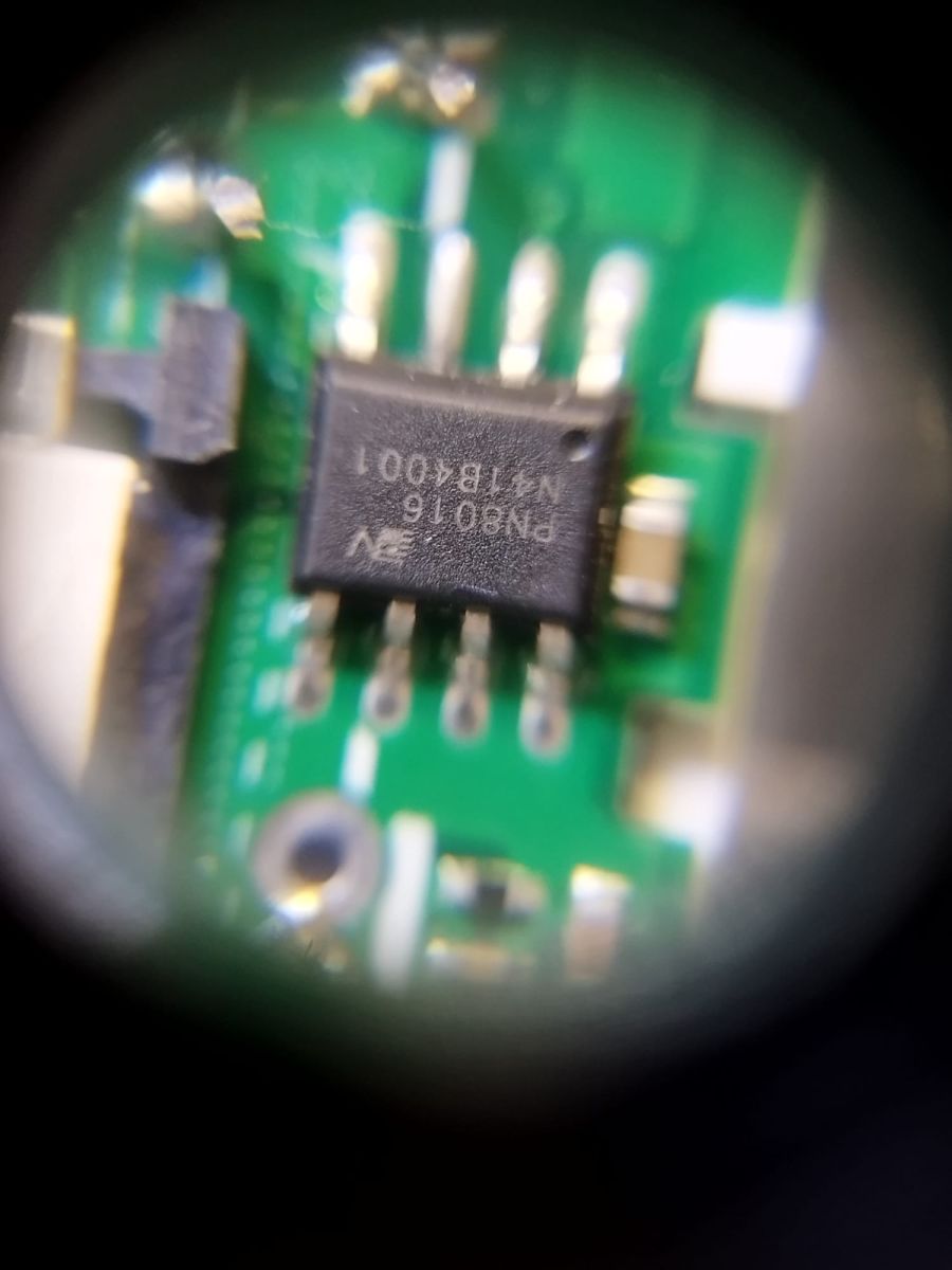

  • Inside, it uses a CB2S module with BK7231N, a CH573F Tuya MCU, BL0942 metering chip, PN8016 supply, and a bistable relay driver.
  • The power board measured 10.1V from the rectified AC and 3.23V on the downstream regulator, and the Tuya model exposed 44 DpIDs.

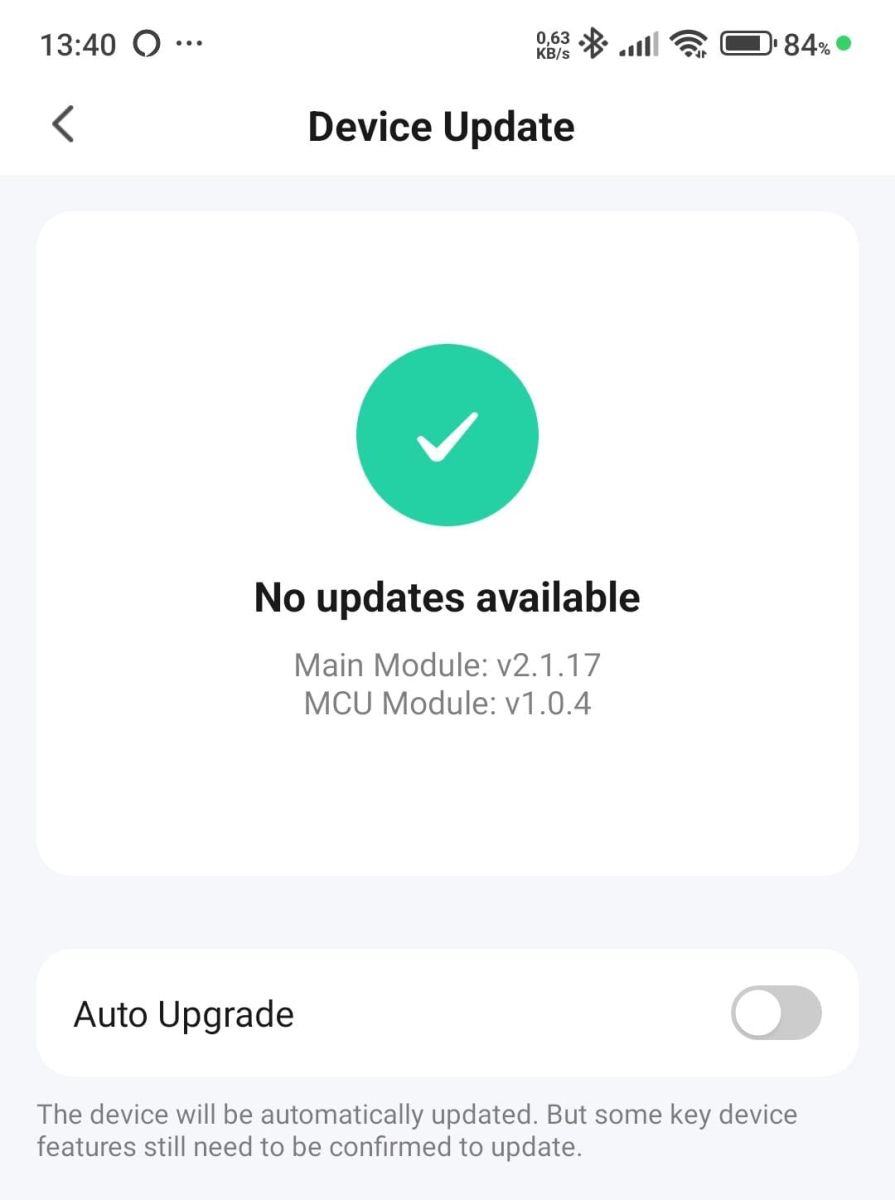

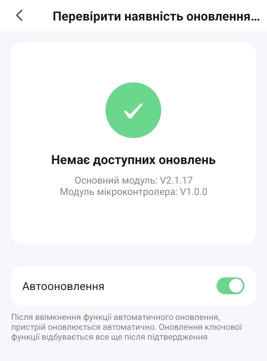

    Could I flash 3.1.17 in the older one with 2.1.17 and see if it prompts for an MCF FW upgrade, or will this break something?
  • BK7231N backup still offers MCU update 1.0.3
    #32 21566646
    Posts: 5216
    Help: 448
    Rate: 917

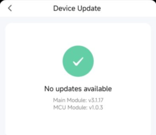

    could try? If you don't go through with any update, then maybe it'll be fine?

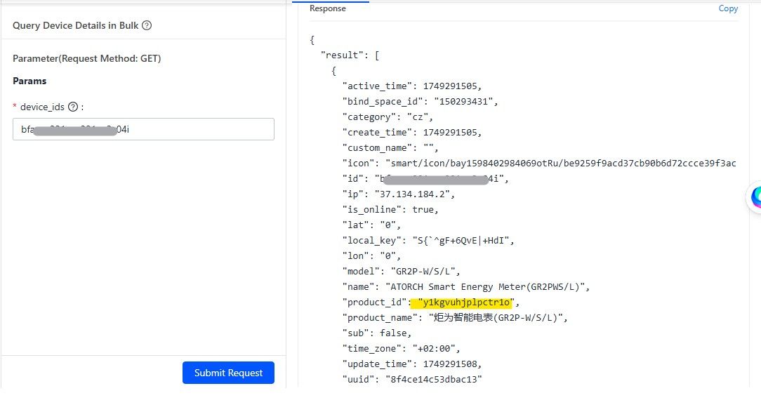

    or, I have already tested - I flashed your new device backup to BK7231N and used same pid in Tuya MCU debug assistant. I specified MCU version 0.0.1 -> offers update 1.0.3 still. Then I stepped up a version at a time 1.0.3->1.0.7 but no updates were offered at any level.
    Device update screen showing no updates available and a green check mark.

    confirms the pid I guess - sq1ahfxhgove4kgo

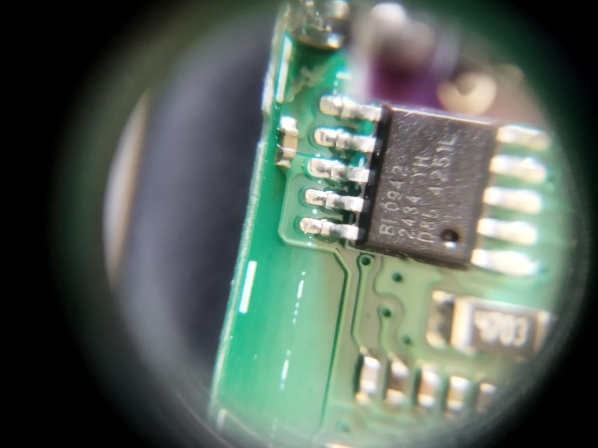

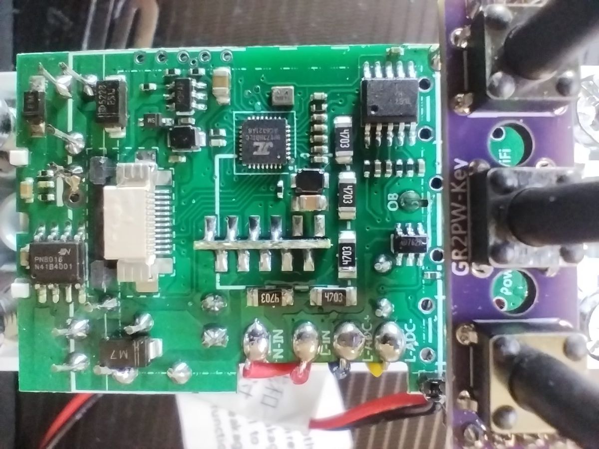

    Posts: 5216
    Help: 448
    Rate: 917

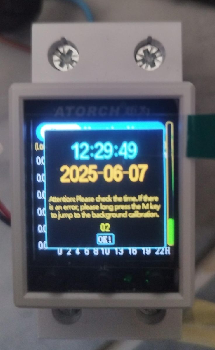

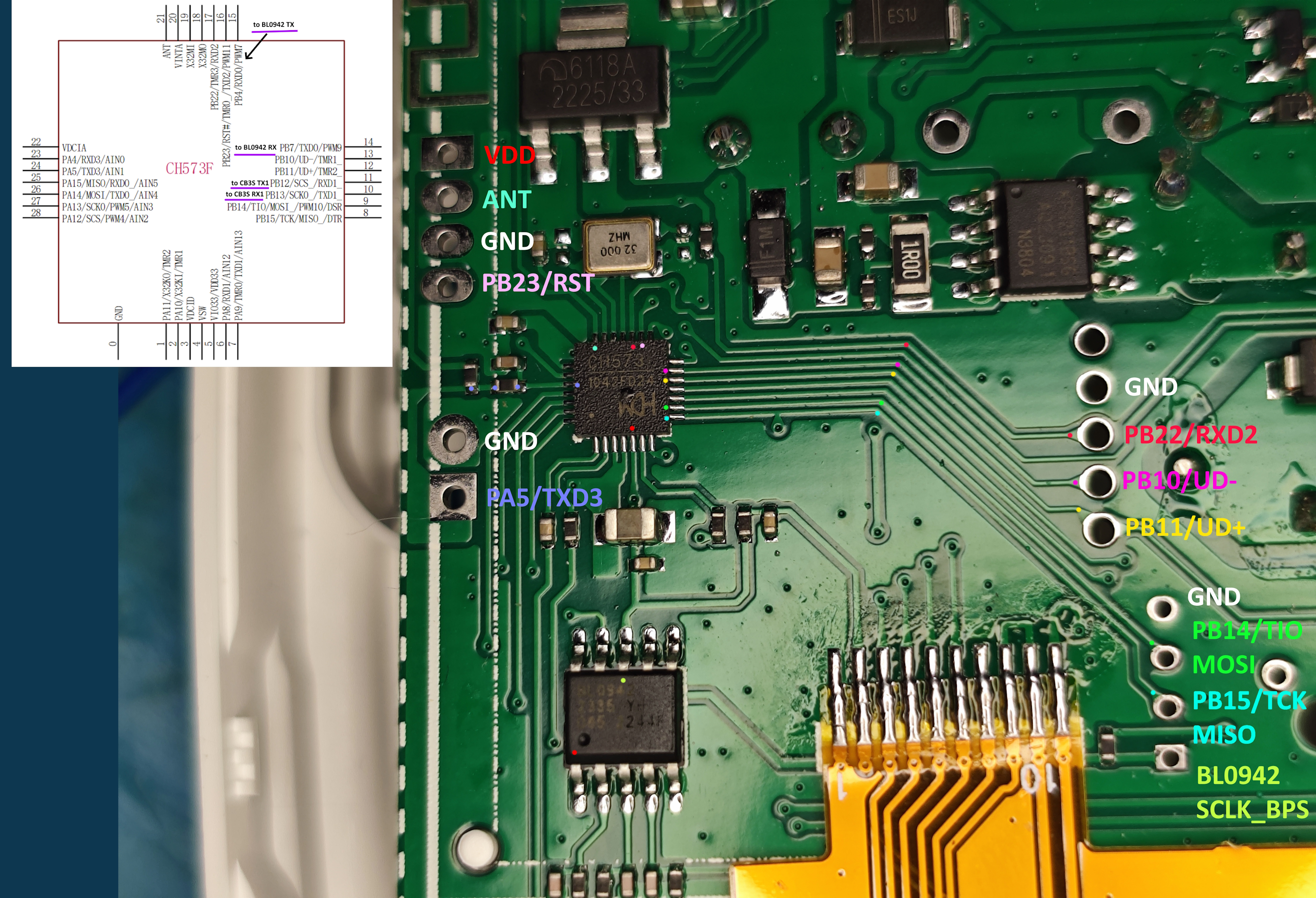

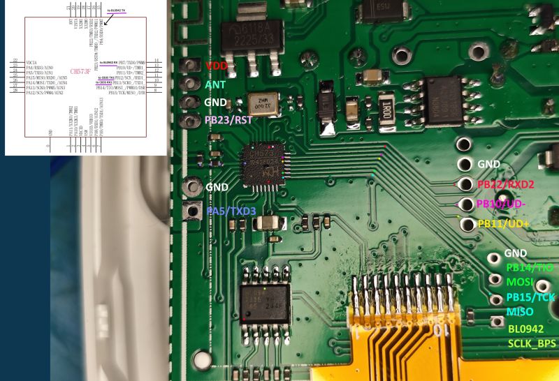

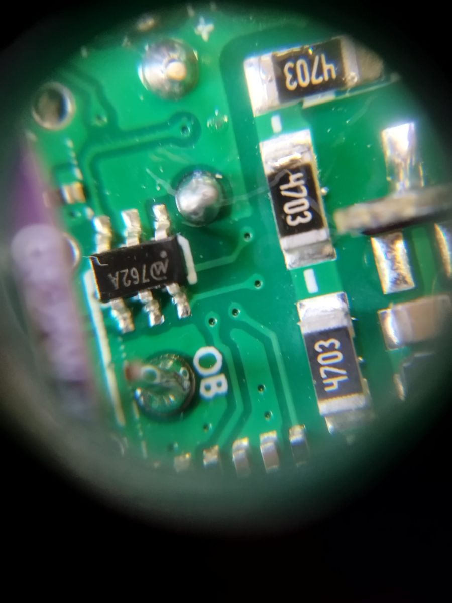

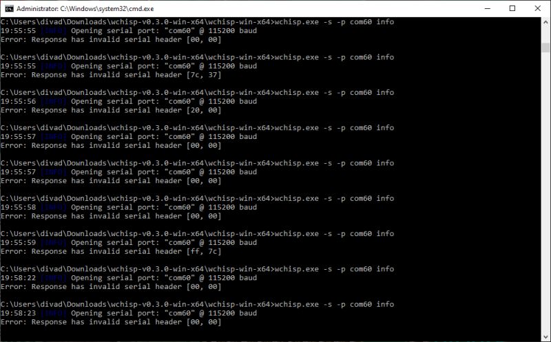

    Spent hours trying to get my only CH573F into UART ISP mode to no avail. This is from the Atorch S1-B. managed to trace a lot though with decent confidence it's right
    Close-up of a PCB with labeled pinouts and a snippet of an integrated circuit schematic.
    I even took off the BL0942 to clear any potential interference when pulling PB4 low at power-on. This was to be my tool of choice https://github.com/ch32-rs/wchisp
    Windows command prompt window with repeated errors while trying to open a serial port.
    USB- and USB+ showed no signs of USB ISP device detection either however you pulled PB4/PB23.
    Device would always boot and do it's normal beep and Atorch LCD display boot checks. PB23 RST didn't seem to reset anything either, so, dunno.
  • USB flashing detected but flash backup unavailable

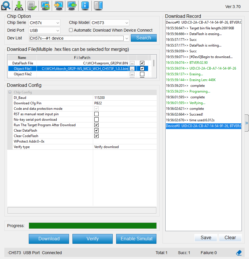

    #36 21568785
    morgan_flint
    Posts: 251
    Rate: 63

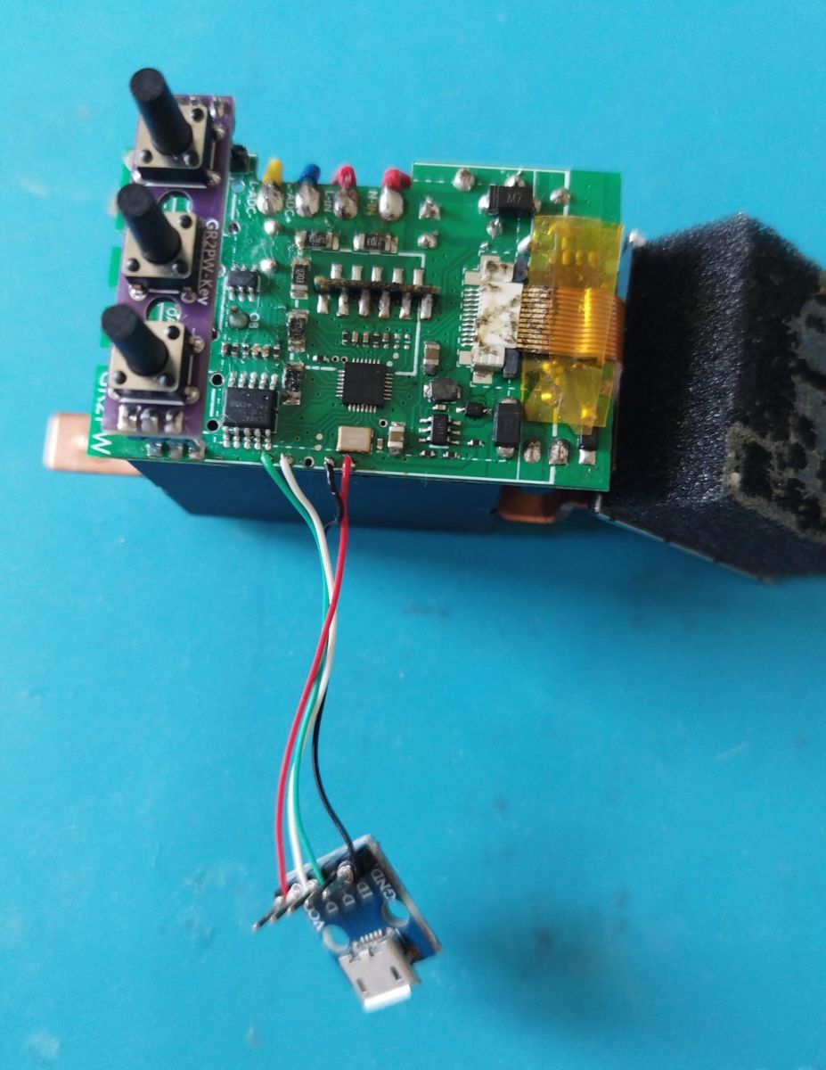

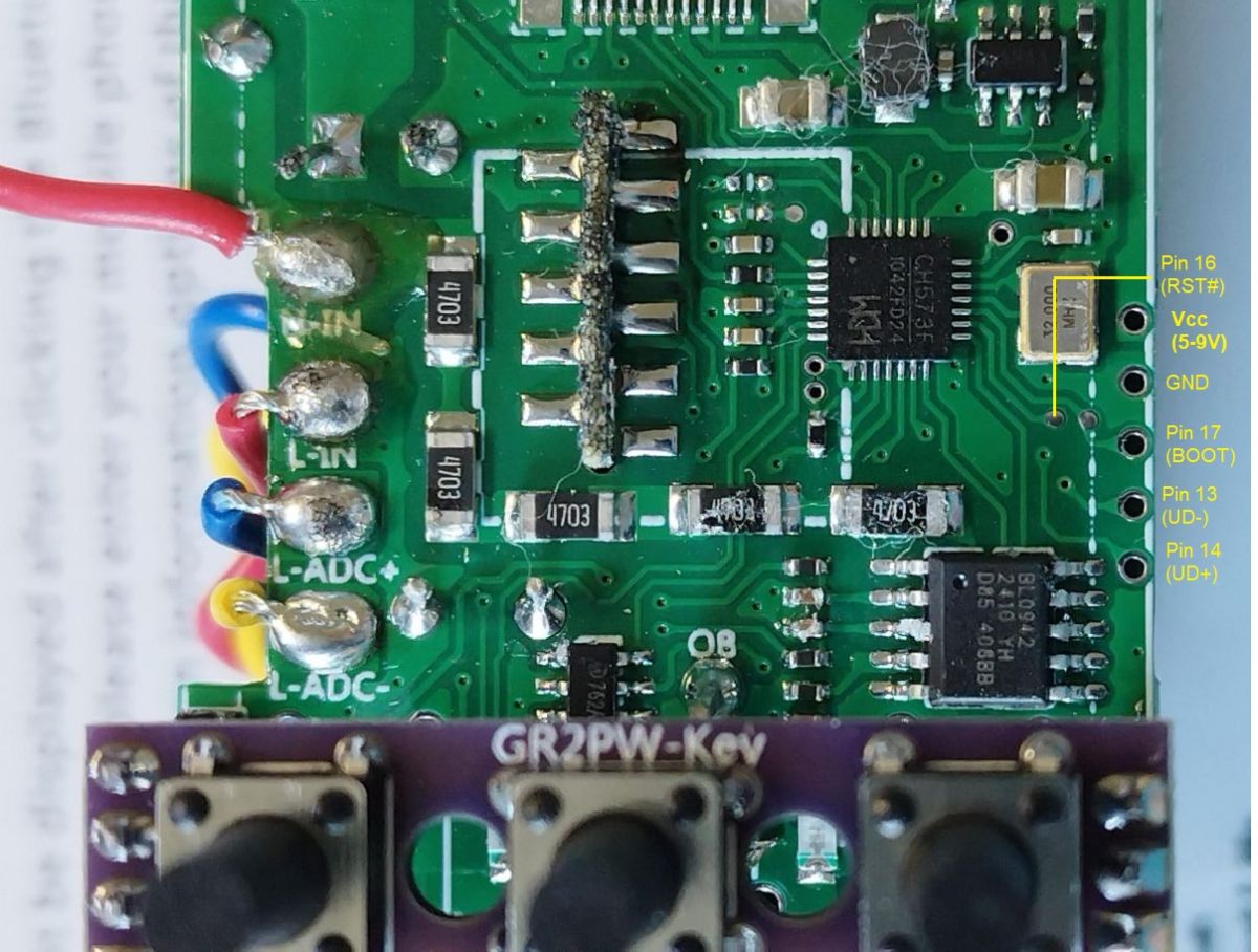

    >>21568294
    Thank you for your tests!
    I've also attempted, but without too much fortune...

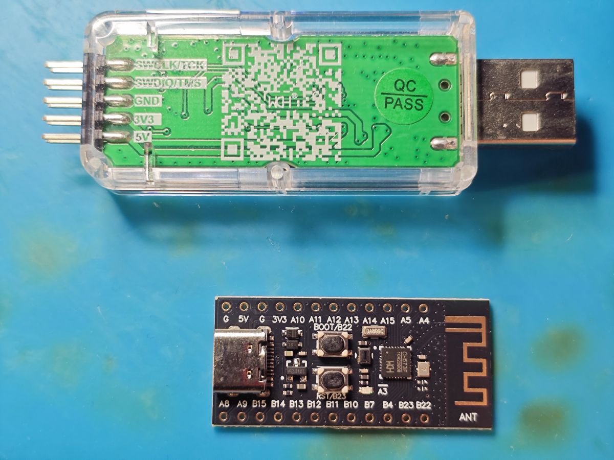

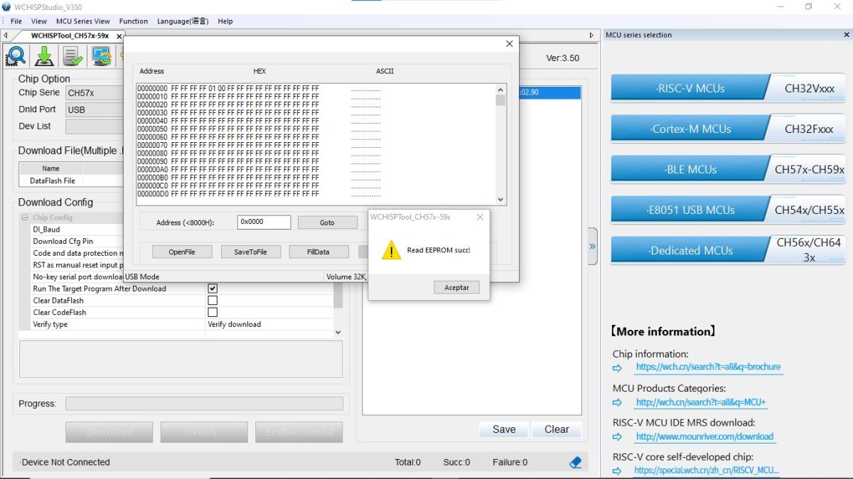

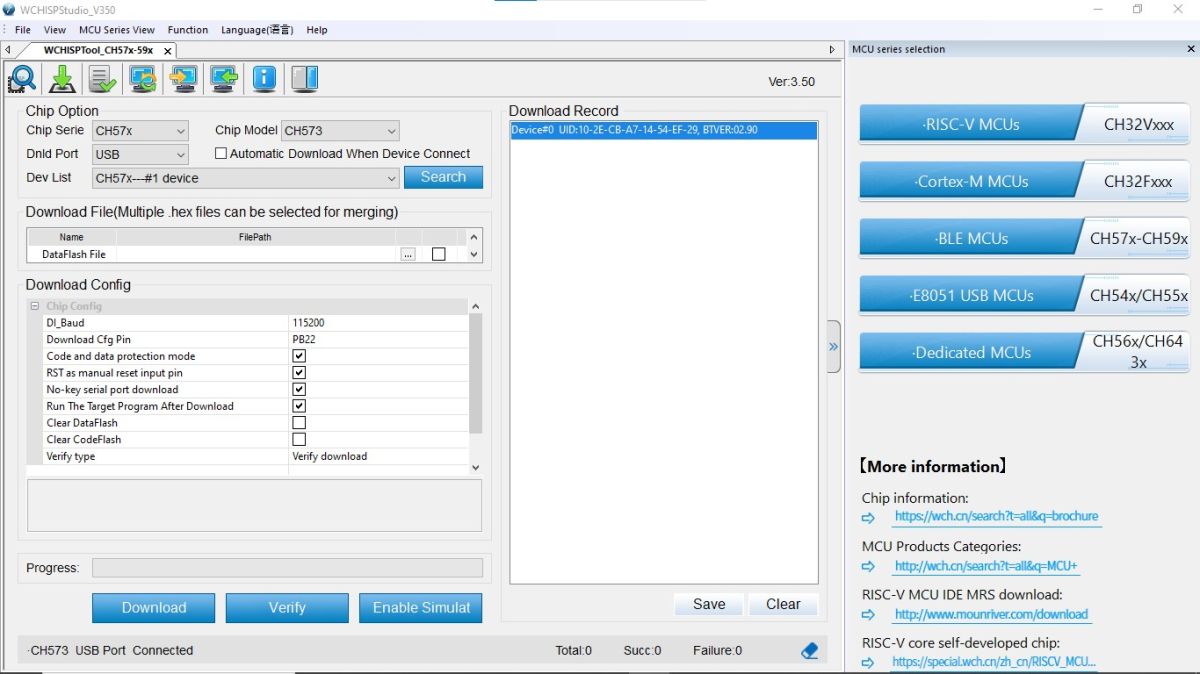

    My approach was to use the USB port with the instructions here, downloading the drivers and programs also there.
    I connected a USB port, according to the pinout I had described in this post:
    Close-up of a printed circuit board with electronic components, including chips, resistors, and labeled pins. Electronic module with three buttons and a micro USB connector on blue background.
    Plugging in the USB to the PC running WICHISPStudio, and with BOOT (pin 17) grounded, the USB device was detected and recognized by the program:

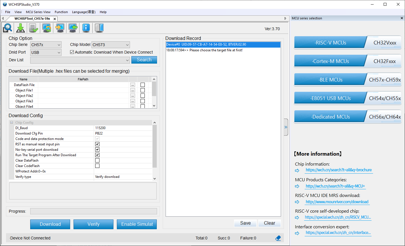

    Screenshot of the WCHISPToolStudio application with CH573 microcontroller configuration and download options.
    Unfortunately, there's no option in the program to backup the flash; only an option to read the EEPROM:
    Screenshot of WCHISPStudio_V350 software showing EEPROM data read in hexadecimal format.
    (Attached the 32 KB file, which is almost full of FF, except for a few bytes)
    Could this procedure be useful to flash the firmware in your GitHub repository?
    I'm not sure if it's worth risking the device, anyway (it'd be more for the fun of experimenting than for the possible benefits 😂)
    It seems like CH573 has memory read-out protection by default and, although this video explains a bypass to it, I'm not sure if I would be able to replicate it, nor if I would get something useful from that. I read something about FW encryption at the end of this page, but I don't fully understand its consequences.
    Thanks again for helping me learn something about these things.
    • GR2PWS_CH573_3.BIN (32 KB) You must be logged in to download this attachment.
  • USB mode access and EEPROM dump confirmed

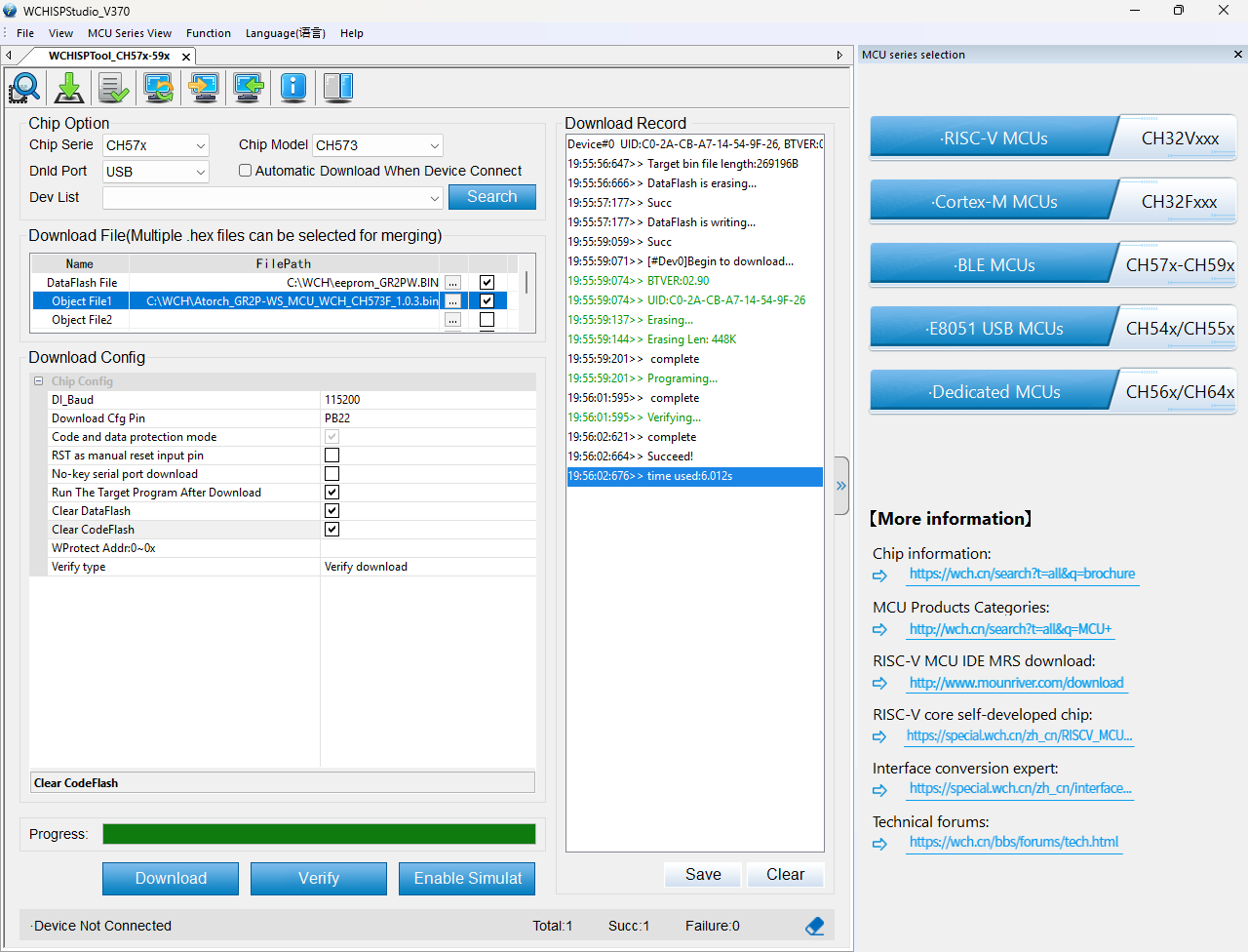

    #37 21568865
    Posts: 5216
    Help: 448
    Rate: 917

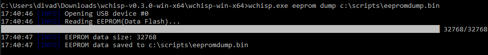

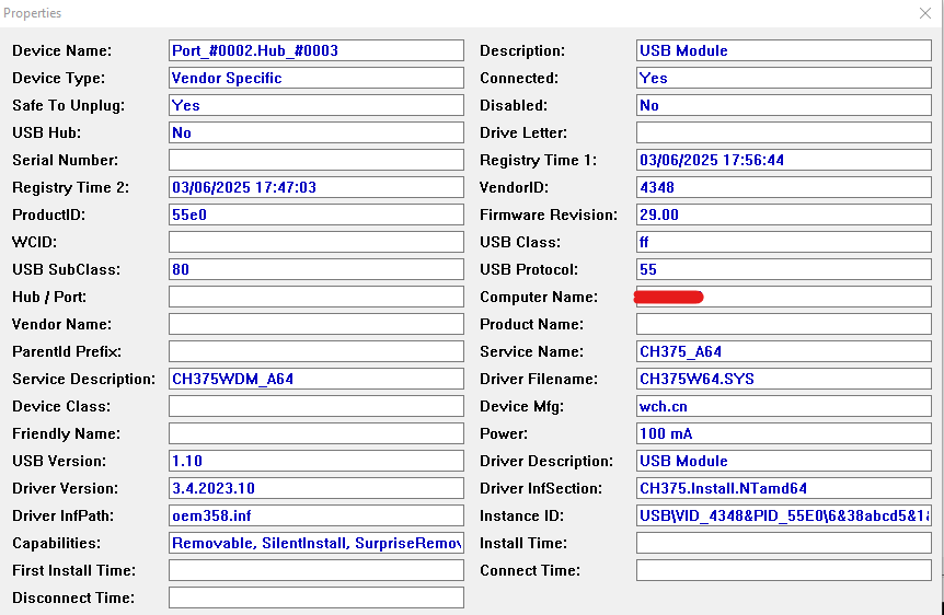

    blinded by my own adventure! thanks for pointing out your previous post. I'd not fixated enough on USB mode and the presence and significance of PB22. I had come across that video too on Youtube :)
    I have now managed to get the USB device to show, albeit for a limited period of time, before the CH573F boots into normal mode again.
    Screenshot showing the USB device properties window with detailed info about CH375 module, driver, and connection parameters.
    Screenshot of WCHISPStudio_V370 software showing connected CH573 device and chip configuration details.
    I see we both have bootloader version 2.90.
    With WCHISPStudio open the USB seems to stay open for longer, long enough to change the driver with Zadig to the WinUSB driver needed for wchisp to operate in USB mode
    so then with wchisp.exe info I get
    and I can dump the eeprom too to file
    Screenshot of a console showing successful EEPROM dump using wchisp.exe.
    next, I'll see if I can wrap my head around that post and what it means for dumping full flash https://github.com/frank-zago/isp55e0?tab=readme-ov-file#note-on-the-firmware-encryption
    • atorch_s1b_ch573f_1.0.7_eepromdump.bin (32 KB) You must be logged in to download this attachment.
  • CFG_ROM_READ blocks flashing over UART
    #38 21568882
    Posts: 5216
    Help: 448
    Rate: 917
    The Atorch_GR2P-WS_MCU_WCH_CH573F_1.0.3.bin OTA bin?
    Added after 2 [hours] 37 [minutes]:
    the dump flash options in https://github.com/frank-zago/isp55e0 and https://github.com/MarsTechHAN/ch552tool just read eeprom (for me)
    Added after 26 [minutes]:
    https://github.com/frank-zago/isp55e0/blob/master/protocol.txt
    so yes, my readout is disallowed, as expected, and it looks like flashing would fail anyway. Also, you notice in that video that atc1441 has to write a program to read out the flash over uart, which is initially flashed to the CH573F, overwriting existing data. His uart output happens to include the OTA2 bank firmware. This method is the 'bypass' that was reported to WCH. His device had BL v2.80 - I wonder if 2.90 is patched for this anyway. If 2.90 isn't patched then I guess we'd have to - locate that program, compile and upload it (assuming CFG_ROM_READ is 0, flashing will fail is incorrect), potentially sacrificing a device to see if untouched OTA2 exists in firmware.
  • EEPROM dump shows similar structure offset by 0x100
    #39 21569369
    morgan_flint
    Posts: 251
    Rate: 63

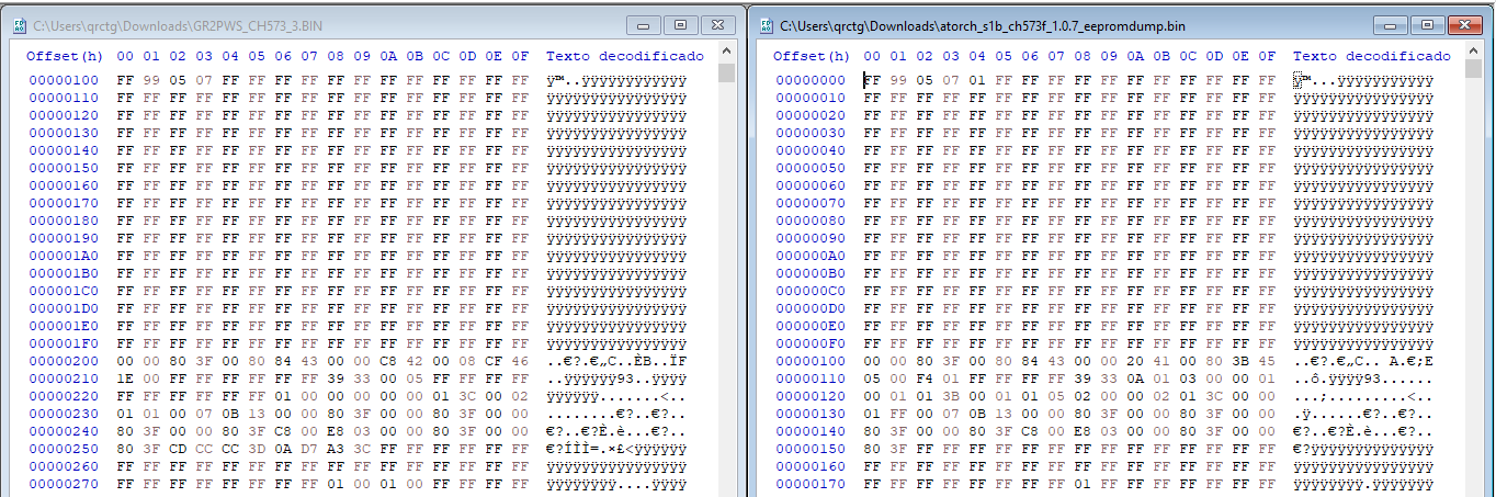

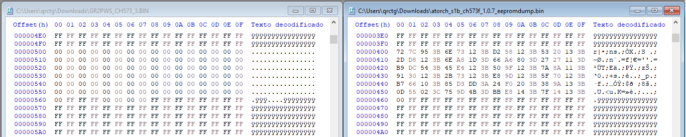

    Just for curiosity, I compared yours with mine, and although they belong to different devices, they seem to have a similar structure with an offset of 100h (different contents, of course):
    Comparison of two BIN files shown in a hex editor, displaying addresses, hex values, and decoded text.
    Comparison of two binary files opened in a hex editor, showing their hexadecimal and decoded text content.
    The programmer at Atorch is reusing a lot of code, I suppose.
    I'm not sure it's worth the sacrifice 😂
    I'm planning on buying one of these to experiment with
  • #40 21569371
    Posts: 5216
    Help: 448
    Rate: 917
    no indeed.
    morgan_flint wrote:
    I'm planning on buying [https://www.aliexpress.com/item/1005006806579557.html]one of these[/url] to experiment with
    me too! :)
  • New GR2PWSL hardware and firmware differences

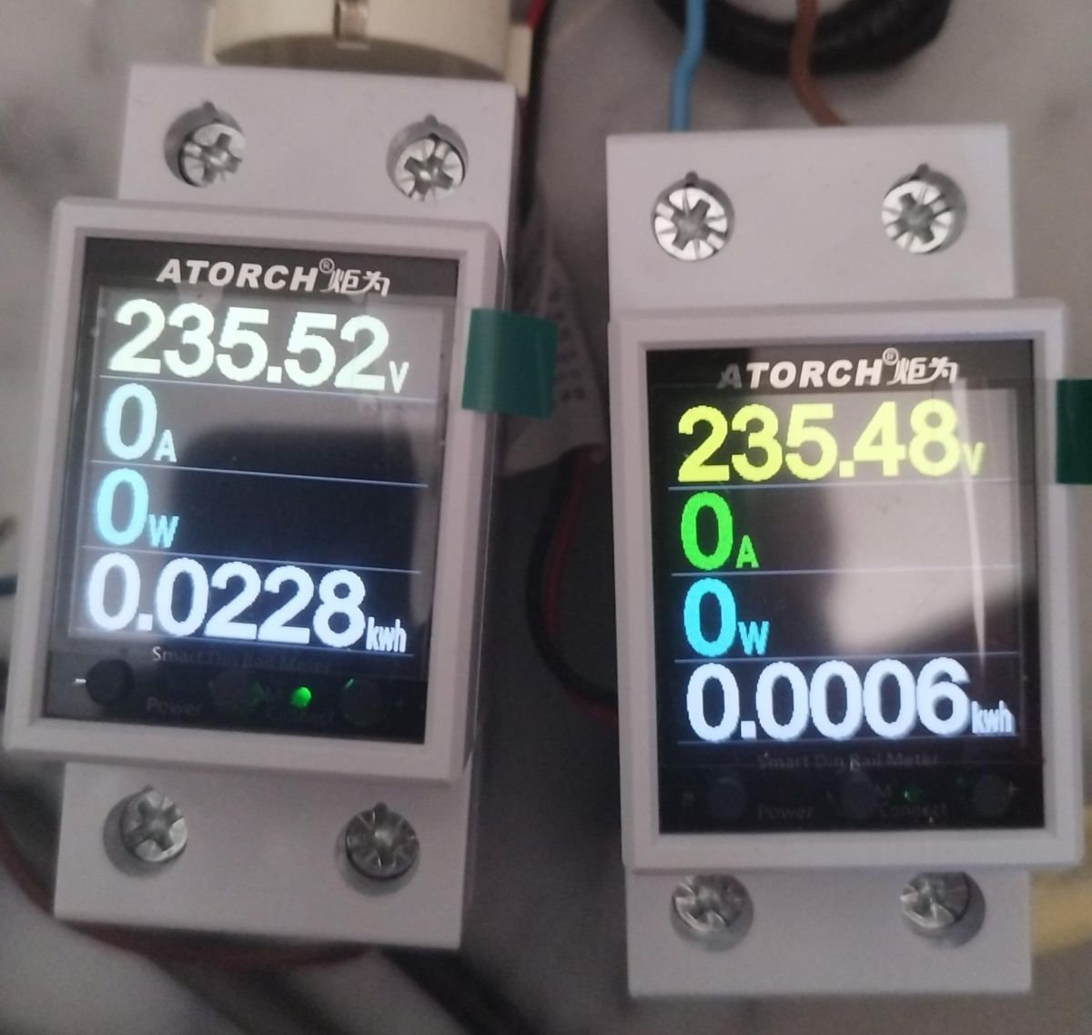

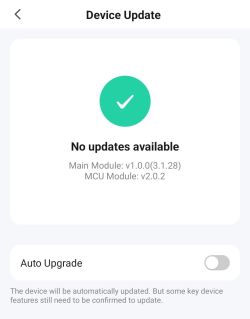

    #41 21572984
    morgan_flint
    Posts: 251
    Rate: 63
    morgan_flint wrote:

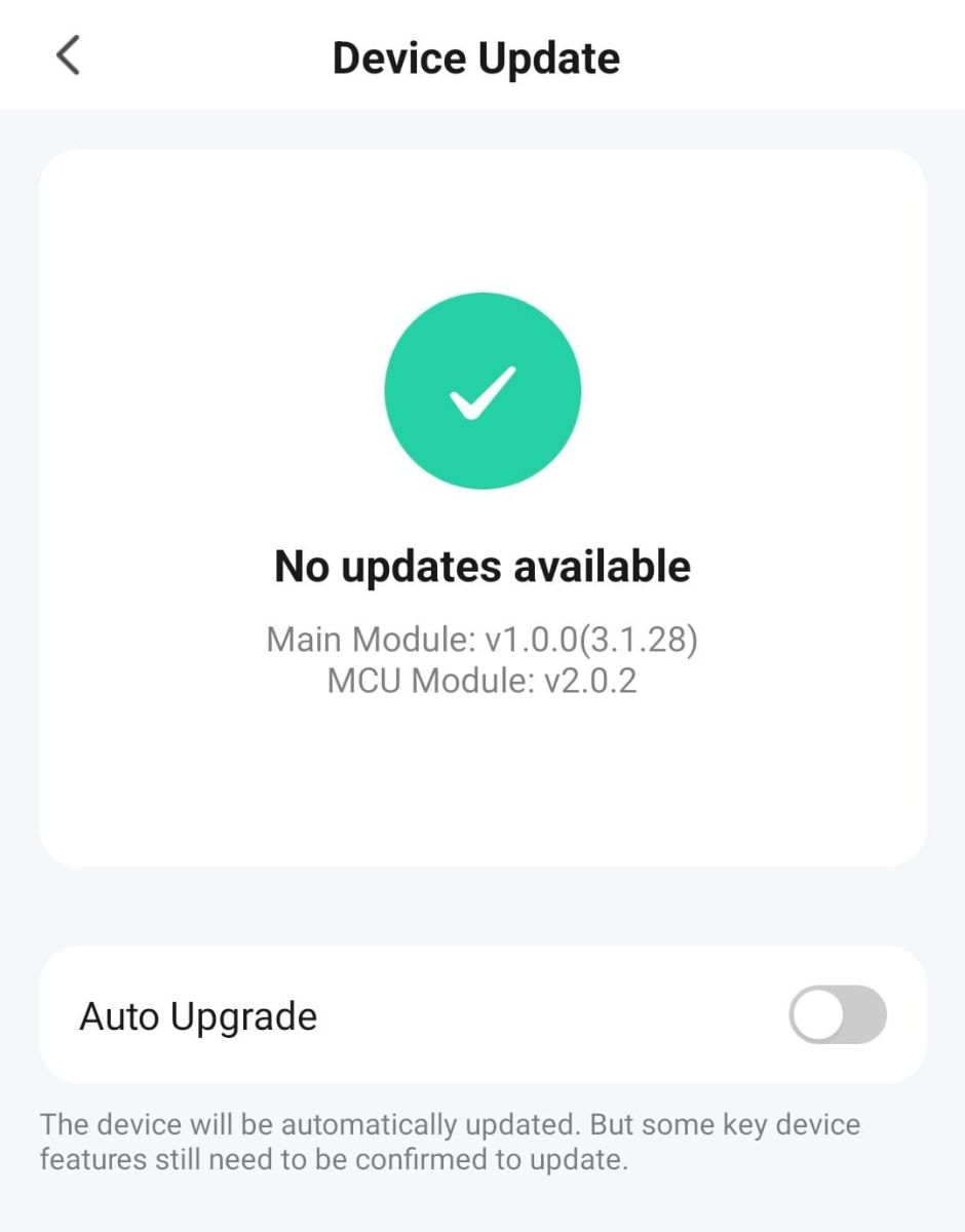

    With that in mind, and also wanting to inspect the HW differences with GR2PWS, I have ordered (and am waiting for its arrival) a GR2PWSL (with external leakage current transformer). In the advertisement, some pictures of the device's screen are different from my devices, or even don't exist in them, but are similar to those in AT4P advertisements. So I'm also curious to check the FW version in this new acquisition. In one of the ad's screenshots it says "BengFang Sys Settings 2.0.1":
    My new GR2PWS version, GR2PWSL, finally arrived!
    As could be foreseen from the photos in the advertisement I posted in the referred post, it's a different version than the previous GR2PWS devices shown in this thread, not only beacause this one has an external current transformer (and tha associated components in the PCB), but also because the MCU FW is different (more options in the device's screen), and also hardware differences (another MCU). On the other hand, and from the MCU - WiFi Module communication perspective, no important changes have been made, as we have the same dpIDs with only a slight difference (more on this later).
    To start with, let's see the update screen in the Tuya App:
    [BK7231N] Teardown and flashing of Atorch GR2P-WS: DIN rail device with graphic screen
    Compared to those of my older devices, posted in the referred post:
    A screenshot from an IoT device management app showing no firmware updates available for the main and MCU modules. App screen showing no updates available for the device, with Main Module v3.1.17 and MCU v1.0.6 versions.
    So, new versions for both the Main module and the MCU module.

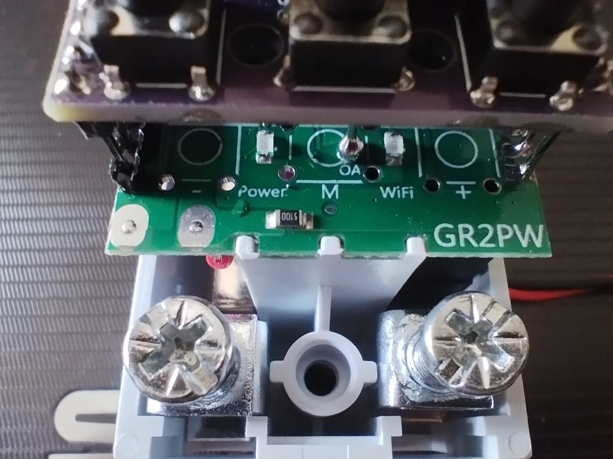

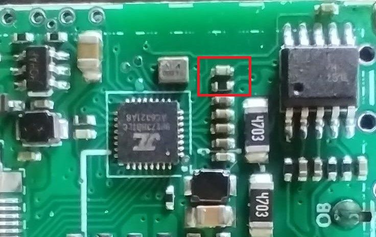

    Now, the HW differences:

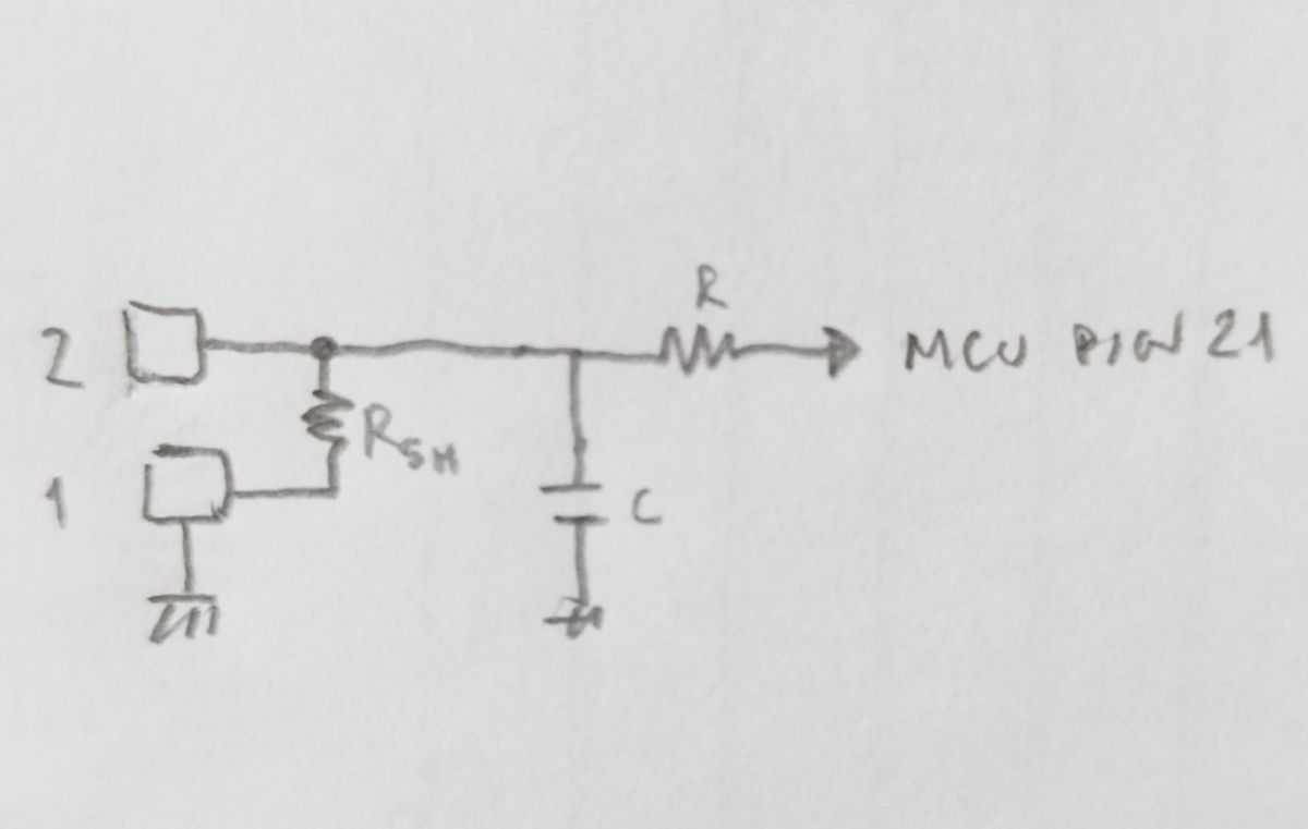

    The layout has some differences with the previous one, the most eye-catching being the MCU and the location of its programming port. Let's see some details:
    [BK7231N] Teardown and flashing of Atorch GR2P-WS: DIN rail device with graphic screen [BK7231N] Teardown and flashing of Atorch GR2P-WS: DIN rail device with graphic screen [BK7231N] Teardown and flashing of Atorch GR2P-WS: DIN rail device with graphic screen [BK7231N] Teardown and flashing of Atorch GR2P-WS: DIN rail device with graphic screen [BK7231N] Teardown and flashing of Atorch GR2P-WS: DIN rail device with graphic screen

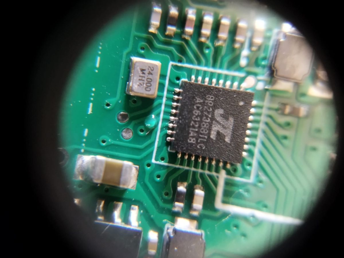

    The MCU is very different (32 pins instead of 28), but the main components (SMPS, metering, relay driver) are very similar to the previous version. Of course, the shunt resistor (510 ohm) for the leakage current measuring, and also the equivalents of the other two missing in the other ones, are installed in this one:
    The other two components are a series resistor (also around 500 ohms) and a capacitor to GND, as I suspected in the previous post:
    The missing components circled in the other photo are probably a capacitor to GND and a resistor between pad 2 and pin 28 of the MCU, which would be configured as an analog input for residual current measurement:
    Hand-drawn simple electrical diagram showing two pads connected via a shunt resistor, capacitor, and resistor to MCU pin 21.

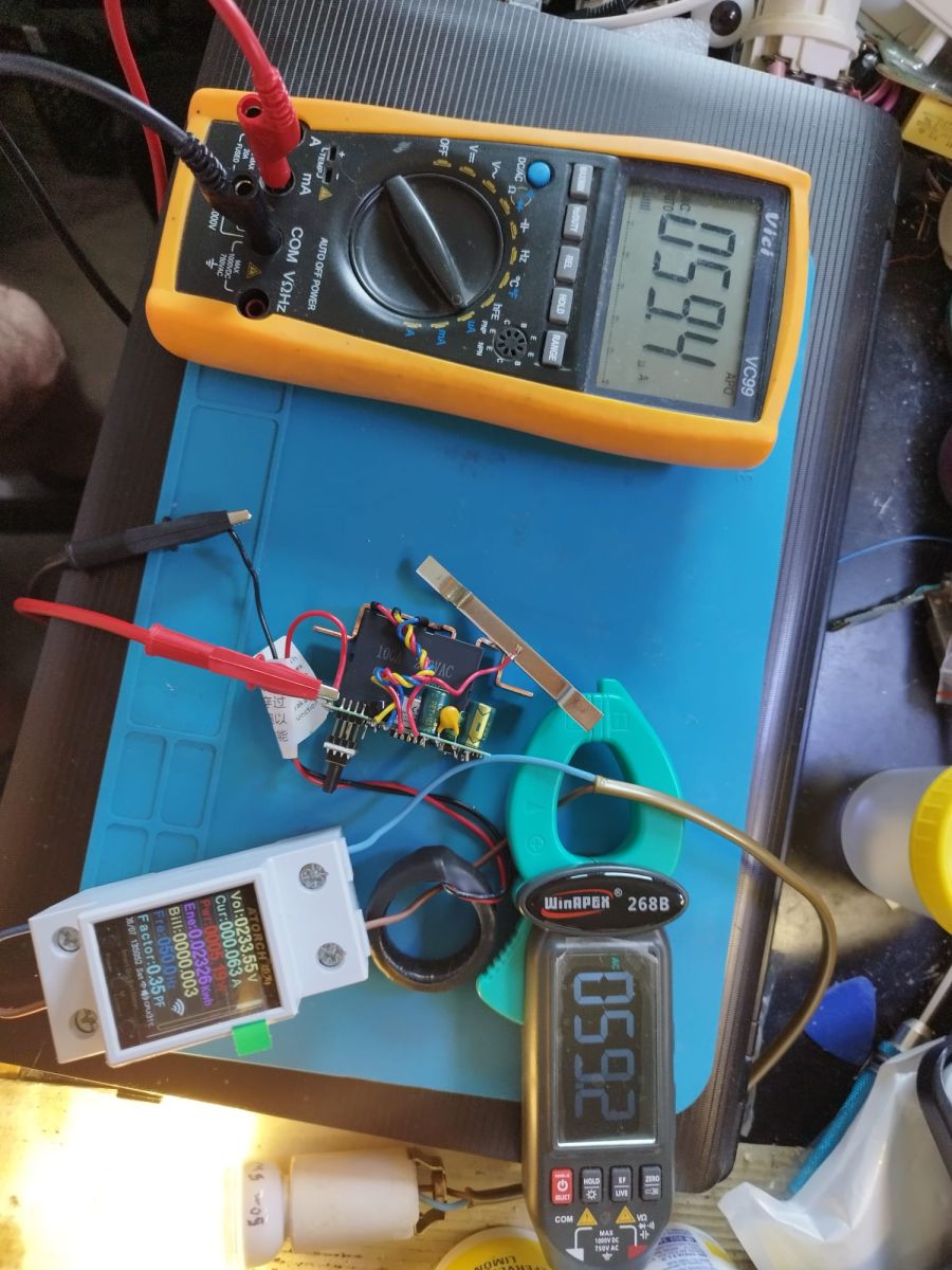

    I could check that the residual current transformer has a relationship of 1:1000:
    So I guess just adding these 4 components (current transformer, shunt resistor, series resistor, and capacitor), it would be possible to measure leakage current in the older devices, as the FW seemed to be prepared for it also in them. Alternatively, the pin where the resistance is connected can be used to measure a voltage between 0 and 102 mV (would be interpreted by the FW as 0 - 200 mA, approximately).

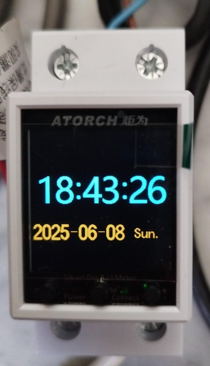

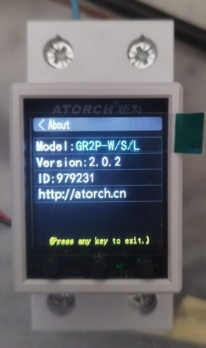

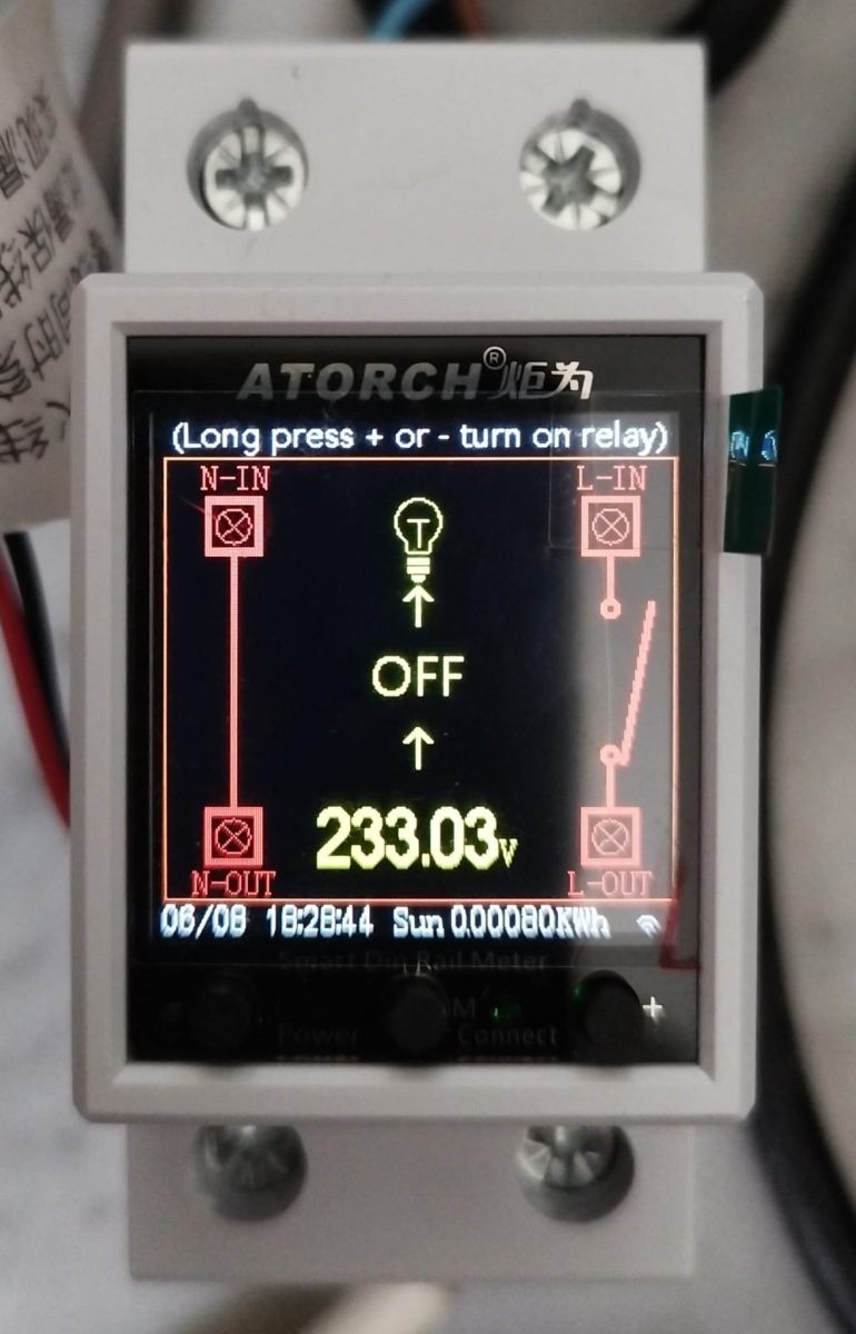

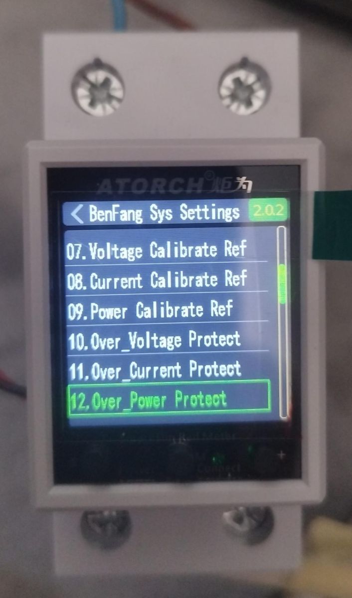

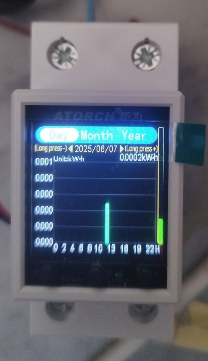

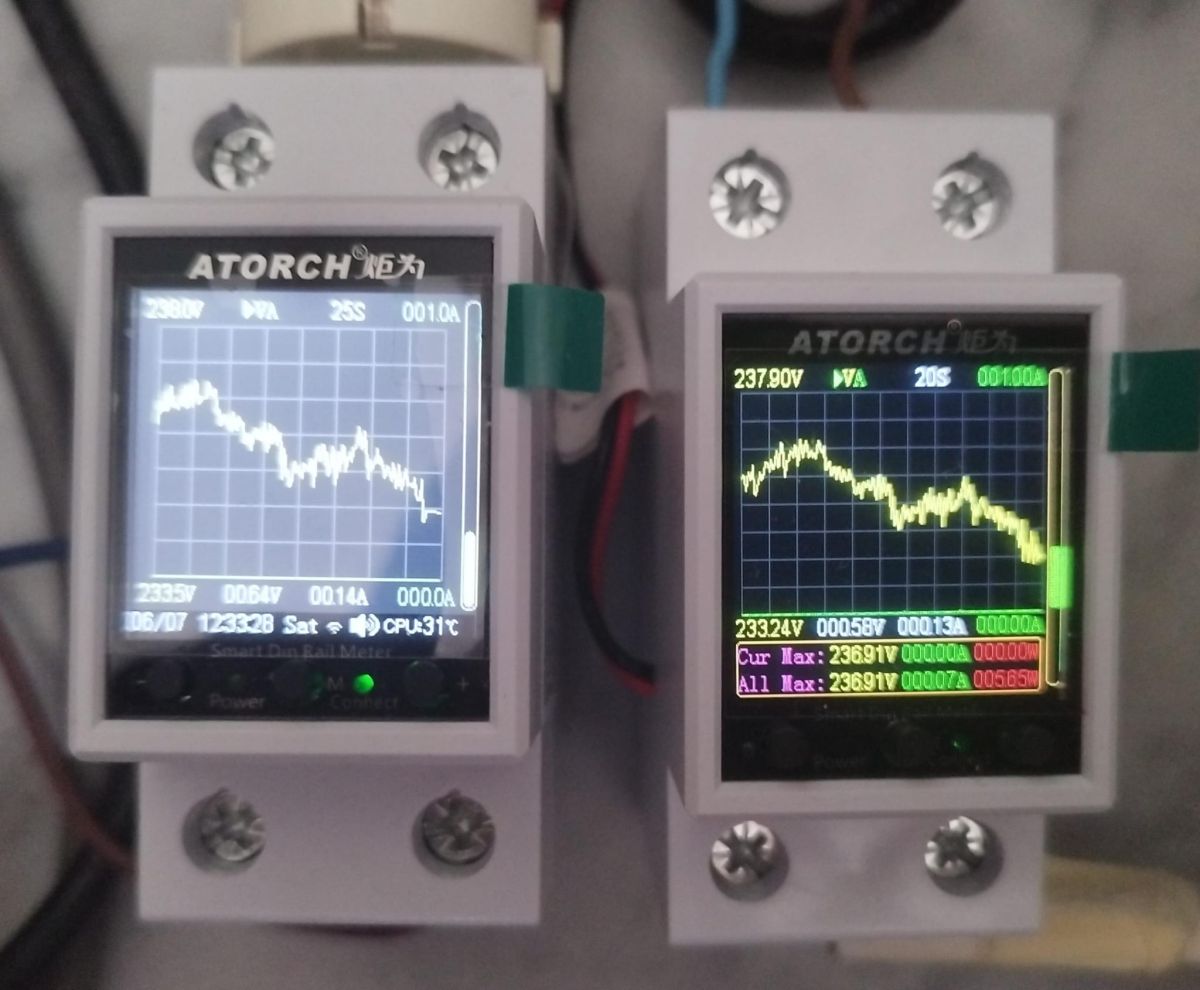

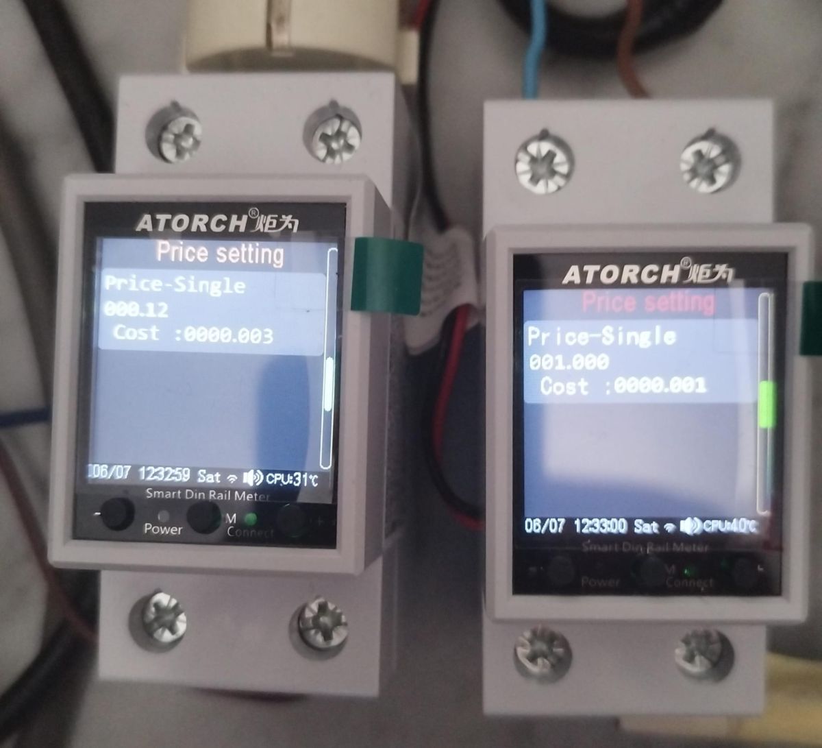

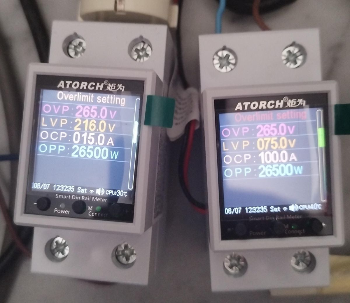

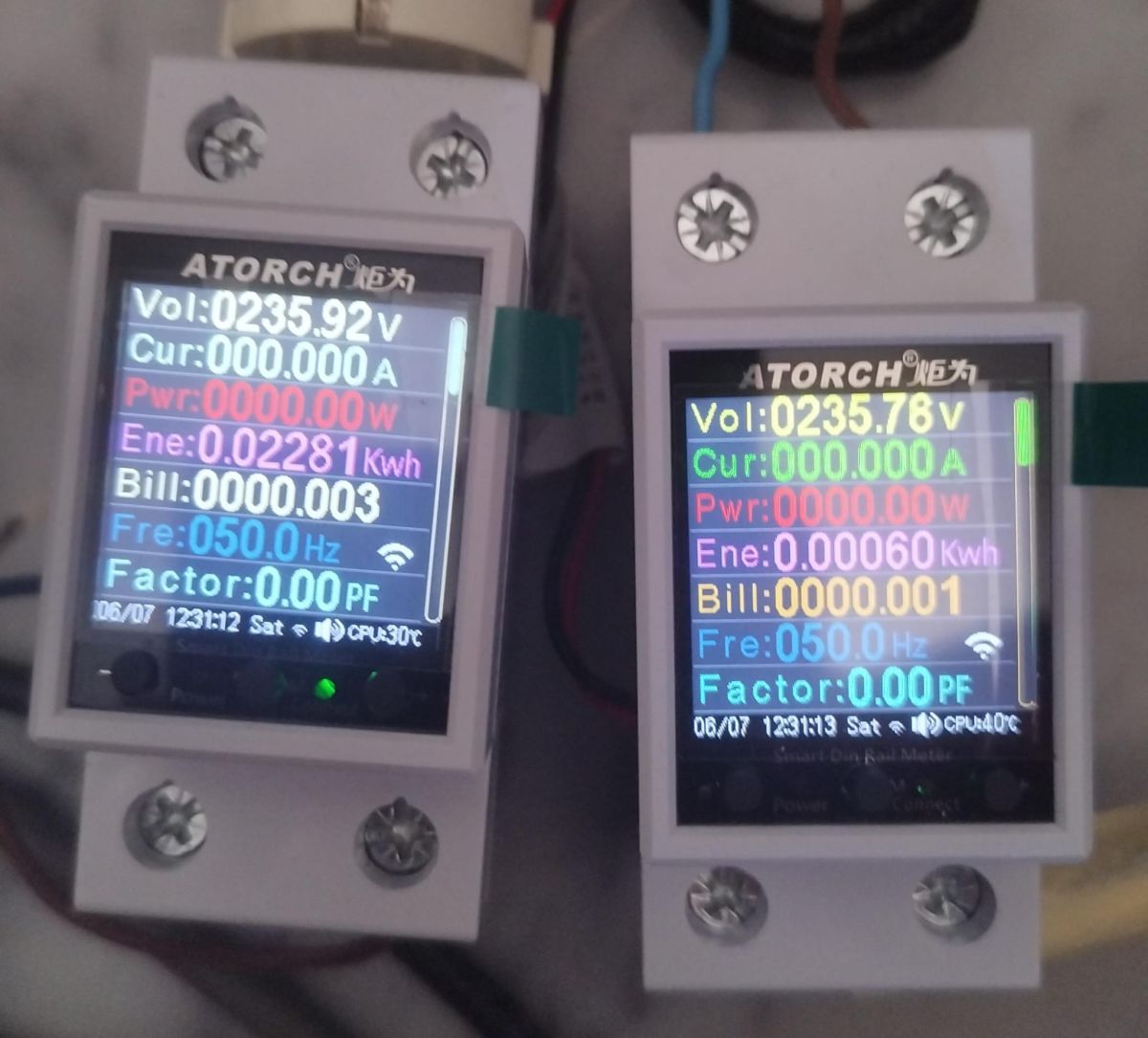

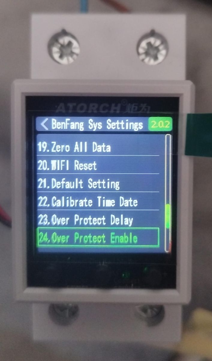

    Now, let's see the differences in the FW from the device's screen point of view. These are very similar, maybe a slight difference in colours:
    The differences start with the graphics:

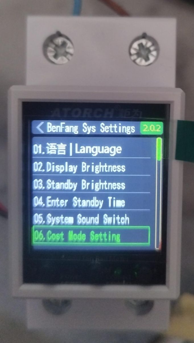

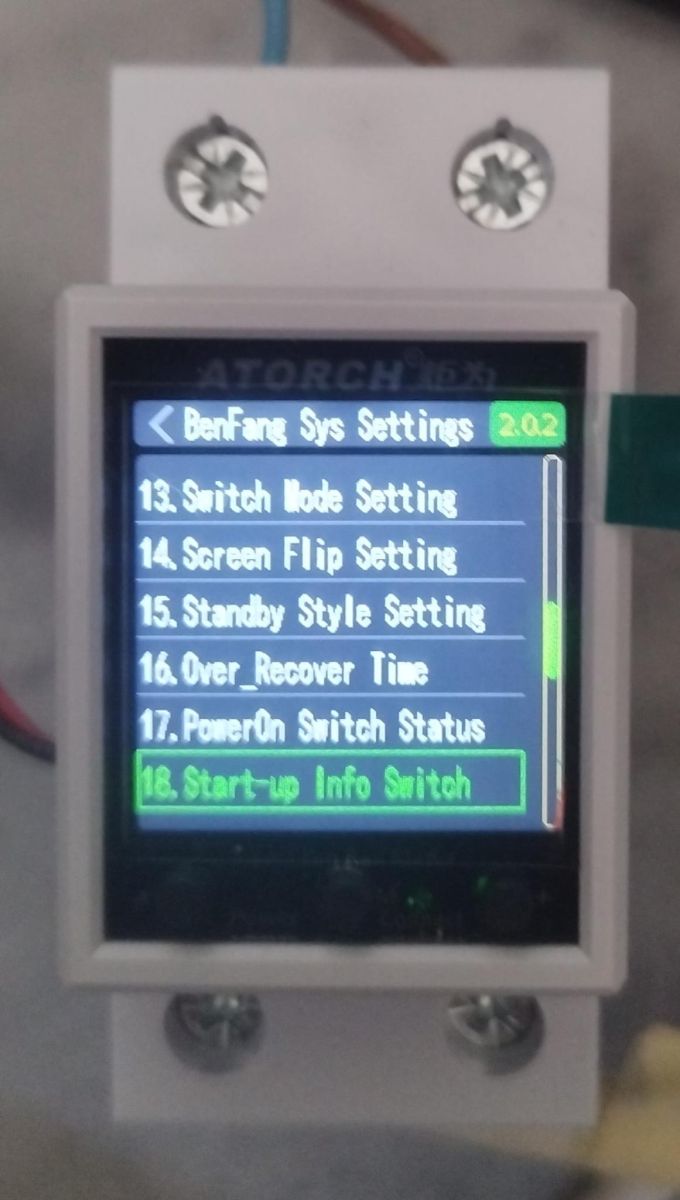

    And continue in the settings menu, and a new standby screen:
    [BK7231N] Teardown and flashing of Atorch GR2P-WS: DIN rail device with graphic screen [BK7231N] Teardown and flashing of Atorch GR2P-WS: DIN rail device with graphic screen [BK7231N] Teardown and flashing of Atorch GR2P-WS: DIN rail device with graphic screen [BK7231N] Teardown and flashing of Atorch GR2P-WS: DIN rail device with graphic screen [BK7231N] Teardown and flashing of Atorch GR2P-WS: DIN rail device with graphic screen [BK7231N] Teardown and flashing of Atorch GR2P-WS: DIN rail device with graphic screen [BK7231N] Teardown and flashing of Atorch GR2P-WS: DIN rail device with graphic screen
    I'll stop here by now because I have to leave, but still have to add more info later...

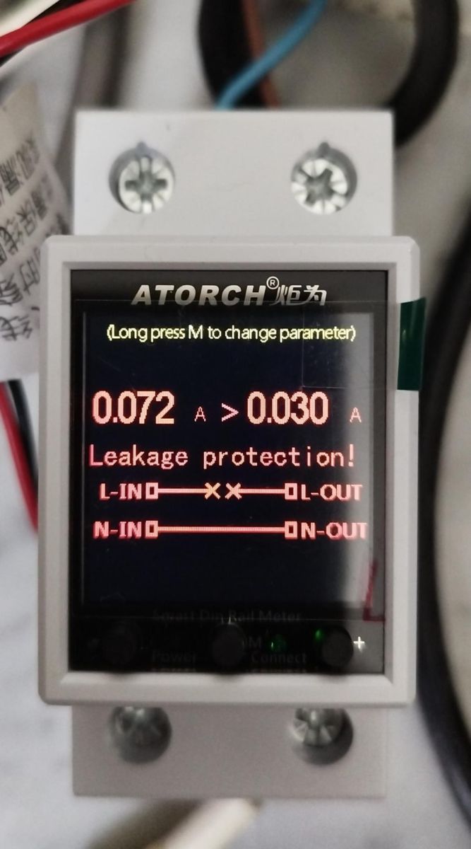

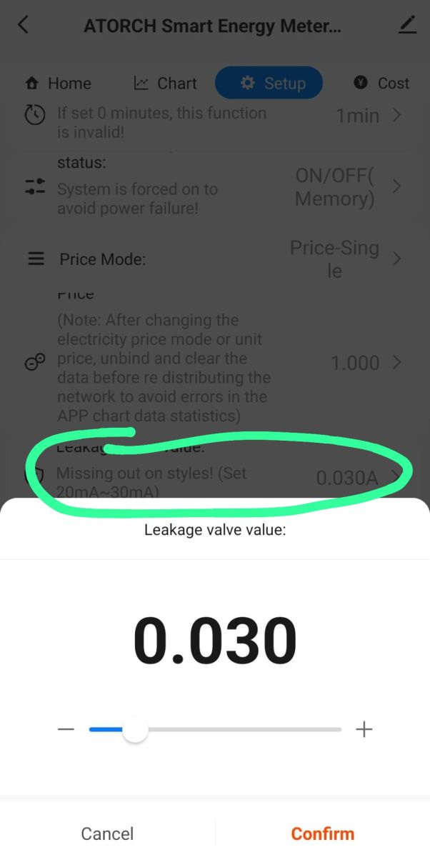

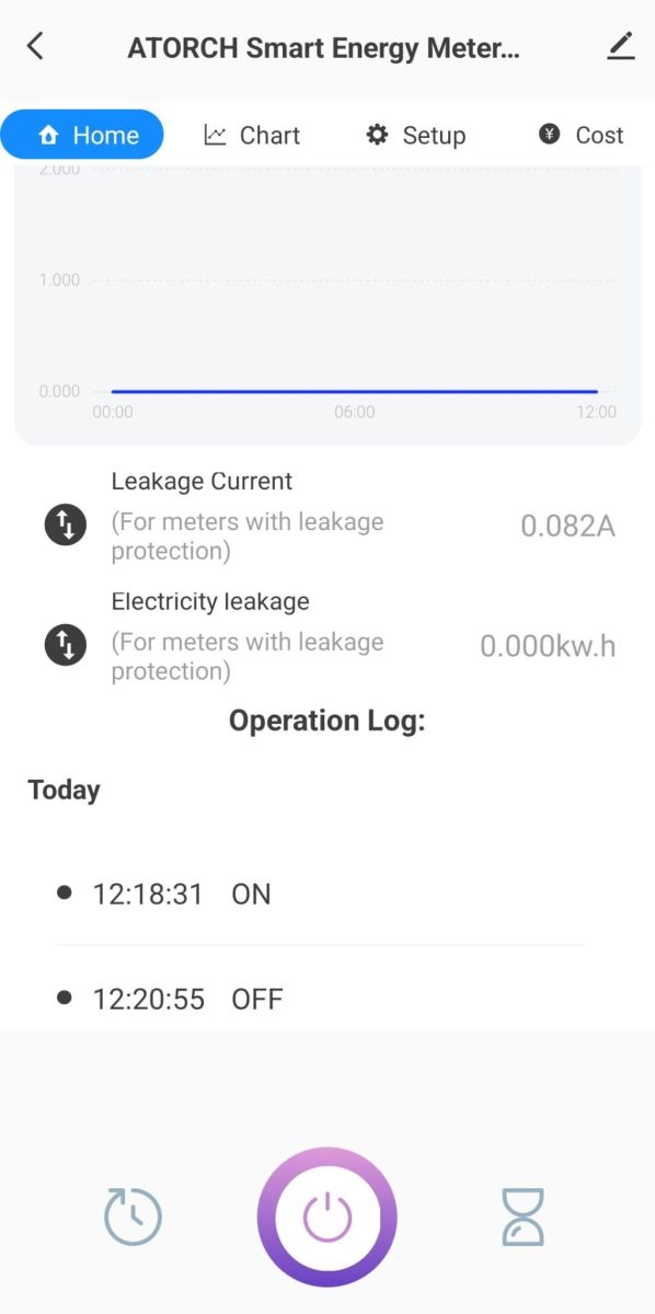

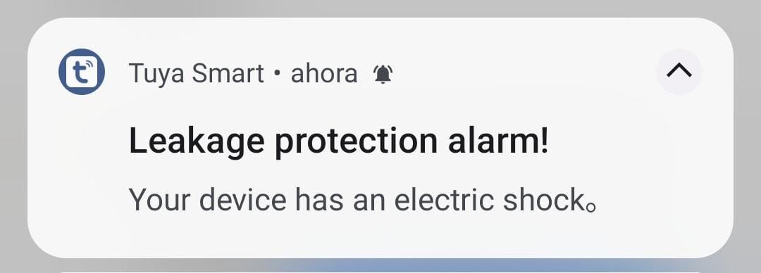

    It's curious, but there isn't an entry in the screen menus to set the residual current limit and enable protection; this is done in the Tuya App (also present in the model without the necessary HW):
    And this is the info on the screen and the App after a leakage:

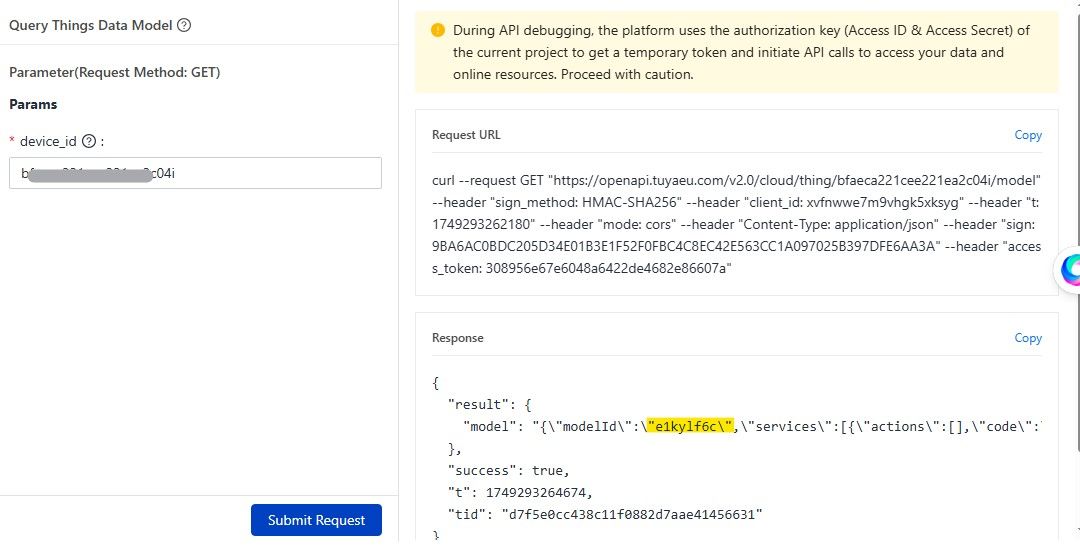

    To conclude this long post, this is the "Things Data Model" from Tuya Developer's web, extracted according to my tutorial:
    Translation of Chinese words is a pending job for @ElektrodaBot... I asked him to do another translation for me here, but he seems to be ignoring that thread 😂😂
    On comparing this JSON with the one for the previous models, apart from the ModelID, I've only found one significant difference, that is the scale in dpID 101 (electricity price), which changed from 2 to 3. ModelId and ProductId have changed:
    @divadiow: Still pending to extract the backup of the WiFi module's FW, I'll try to do it soon

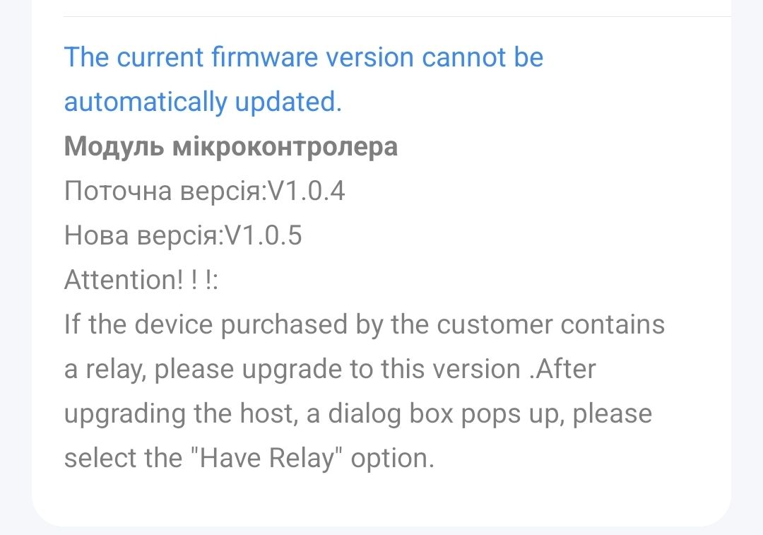

    Hello, perhaps my experience and the information I provide will be useful.
    Last year, I had an unsuccessful update on my GR2PW device via tuya-update due to weak Wi-Fi in the workshop and premature shutdown of the device.
    This is what the page looked like.
    Firmware update failure message from version V1.0.4 to V1.0.5 with relay upgrade instruction
    The device itself displayed the following on its built-in screen
    Device screen showing firmware update in progress with warning messages
    After changing locations to one with a good signal, I received the following information from Tuya
    Device update screen showing no updates available and module version information

    #51 21617678
    seregagnelicky
    >>21617488
    I will try to explain in more detail and clarify the points that I took for granted.
    So, working with this MCU does not allow you to read the firmware dump only from EEPROM or as in the WCH_ISP_Tool (DataFlash) program, so the only hope in this case is tuya-update, and I am grateful to @divadiow for the opportunity to even try this.
    That is, the firmware file was used
    Atorch_GR2P-WS_MCU_1.0.3.bin
    Physically, 12. 13 MCU pins and GND were connected to the PC, as well as three USB wires: D+, USB D-, and GND. The power supply was connected separately.
    The program downloaded and checked the firmware.
    You know the result.
    I understand that there may be flaws in my logic and that I may have done something wrong. If so, please guide me.
    Now I am inclined to think that the firmware I uploaded is from another device, which is why I am getting a cyclic reboot.
    Added after 42 [minutes]:
    Screenshot of WCHISPTool showing firmware flashing process for CH573 MCU
    Added after 5 [minutes]:
    I also forgot to write an important point pin 17 (boot) must be connected to GND since the MCU will periodically turn off the USB I add a screenshot when the USB is activated
    Screenshot of WCH ISP Tool during firmware upload to CH573 microcontroller

    Could it be that it has something to do with the offset (memory location) where the FW is written?
  • #53 21619068
    seregagnelicky
    I'm leaning towards buying a ch-link and trying to dump the dump from the working device, but this is a last resort as fw may be protected
    in attaching the eeprom from the working device
    • eeprom_GR2PW.BIN (32 KB) You must be logged in to download this attachment.
  • CFG_ROM_READ must be enabled for flashing

    viniciusmbs
    >>21563984 "Friend, in photo 3, did you find out whether those two ferrites are missing or if they are supposed to be like that?"
    Quer que eu d
  • #56 21648538
    morgan_flint
    Posts: 251
    Rate: 63
    >>21647412
    The two missing components are for leakage current measurement in the corresponding device version. This one includes an external current transformer (1000:1 ratio), and has installed these two components (capacitor to GND and 500 ohm serial resistor to MCU), plus a 510 ohm shunt resistor close to the edge of the PCB.
    You can see the details at the middle of this post

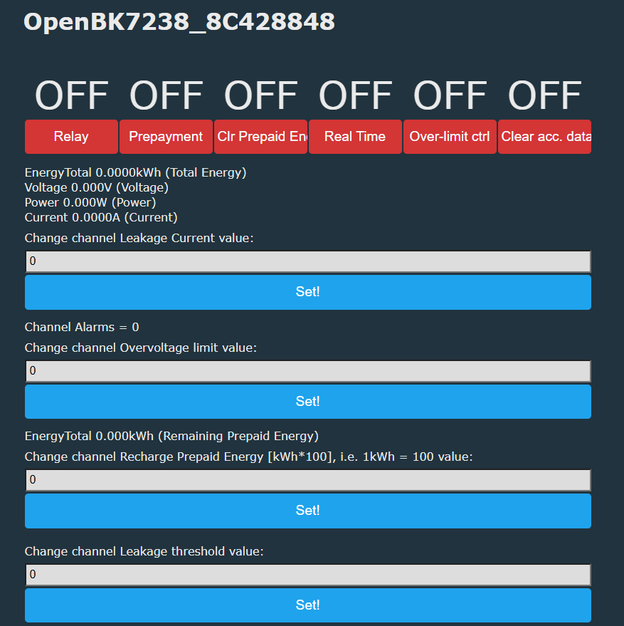

    I have a new version of GR2PWS with T1-2S-NL chip instead of CB2S. I flashed it with OpenBeken as BK7238. It is working but how do I configure it to work like the old one? Does anyone have a valid autoexec?
  • #58 21784344
    yarik8117
    Posts: 10
    I also have a GR2PWS with a T1-2S-NL chip. After flashing, did you try to upload the original autoexec from the first post? Did you upload it and nothing works, or did you not try? I took it apart today and saw the T1-2S-NL. I'm thinking about whether to flash it or not. I'm new to this.
  • Autoexec upload still leaves values blank
    #59 21784534
    GoldMember
    Posts: 26
    yarik8117 wrote:
    I also have a GR2PWS with a T1-2S-NL chip. Did you try to upload the original autoexec from the first post after flashing? Did you upload it and nothing works or did you not try? I took it apart today and saw the T1-2S-NL. I'm wondering whether to flash it or not. I am new to this.
    Yes, I uploaded autoexec, here is the result:
    OpenBK7238 control panel displaying zero energy readings and all switches off
    I does not show the values.
  • #60 21784541
    Posts: 5216
    Help: 448
    Rate: 917
    I imagine the dpIDs have changed, different schema?
