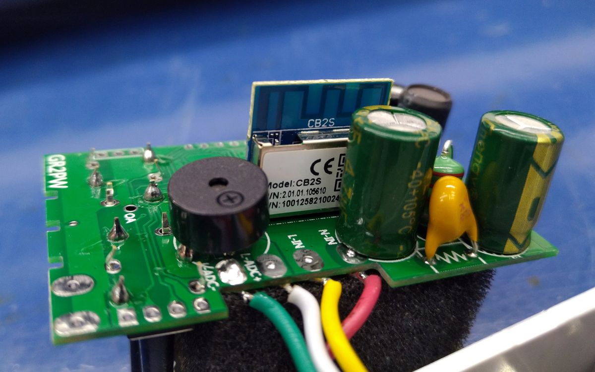

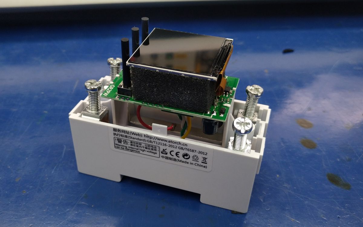

    The Chinese, on the other hand, looks like this:
    GR2P-W/S/L Atorch CB2S firmware modification options and compatibility GR2P-W/S/L Atorch CB2S firmware modification options and compatibility GR2P-W/S/L Atorch CB2S firmware modification options and compatibility GR2P-W/S/L Atorch CB2S firmware modification options and compatibility GR2P-W/S/L Atorch CB2S firmware modification options and compatibility .

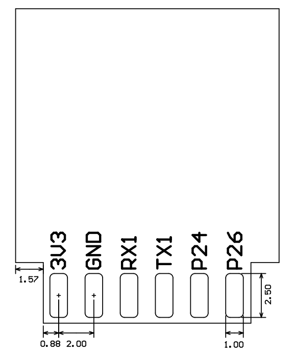

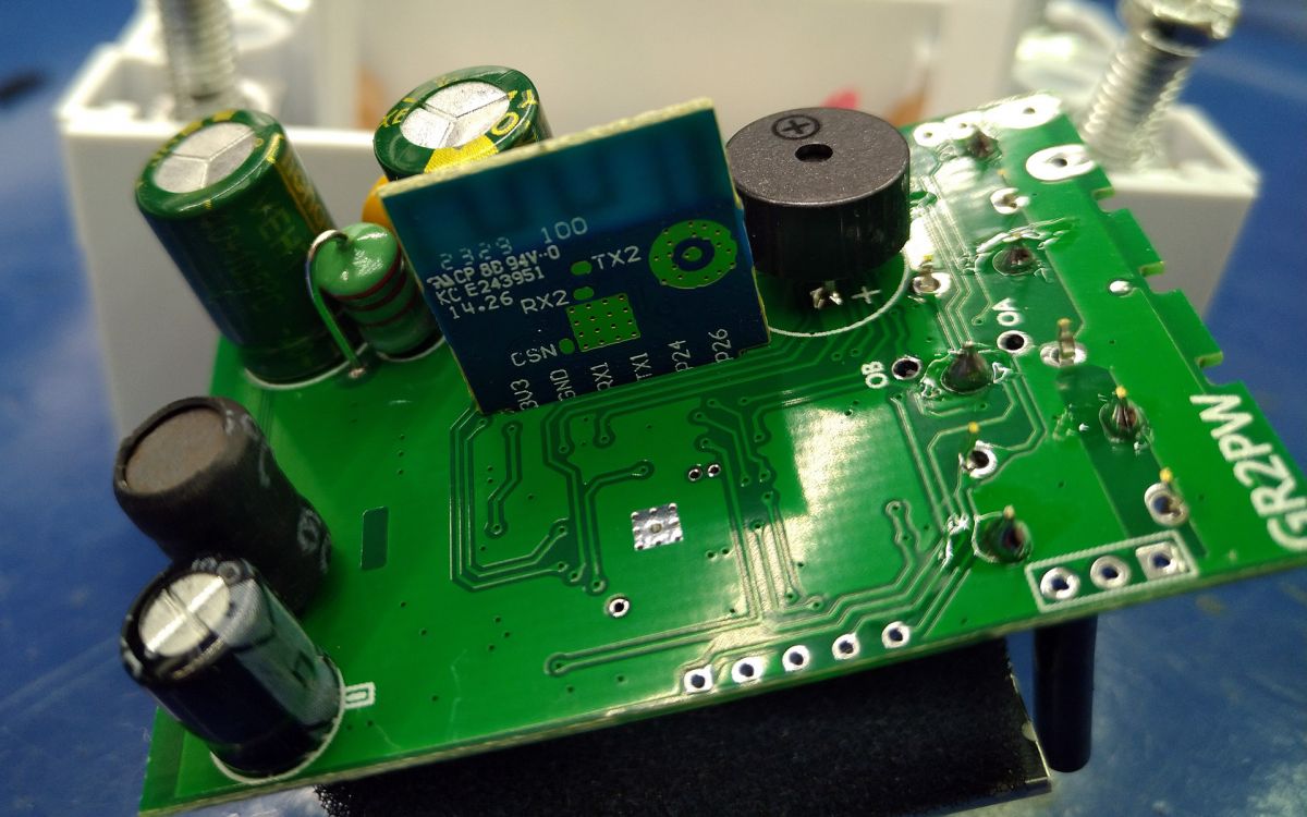

    It is most likely to be TuyaMCU , but it is still worth checking that there are paths going from RX1 and TX1 of the CB2S to the microcontroller:
    If so, according to the tutorial:
    TuyaMCU flashing, installation and configuration guide - configure dpID for Home Assistant .
    I would also try performing this (before flashing):
    Extract DpIDs for TUYA MCU devices .
    Then changing the firmware as here (2MB backup first):
    Then let us know, but analogously as in the tutorial or as here:
    Advanced energy meter/thermostat with LCD Atorch S1TW-FR - cloudless operation .
    If you undertake it, it's unlikely there should be any problems. So far every Tuya device I have encountered , as long as it has a display, is based on the TuyaMCU.
