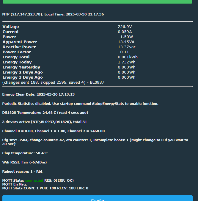

    ok2vuv
    >>21379314 Driver for DS18B20 starts with this key startDriver DS1820 by inserting it into Config and Execute Custom Command. To start after startup, insert into Configure Startup a startup command as well as startDriver NTP and ntp_timeZoneOfs 2
    I just can't get the temperature into MQTT and Home Assistant.
    Please help.
    Radek
    Screenshot with data on energy and temperature of a device.

  • #34 21688767
    ok2vuv
    >>21687944 Not yet, but I haven’t looked very thoroughly. I’m also not a complete IT specialist…
  • #35 21688949
    max4elektroda
    Posts: 754
    Help: 48
    Rate: 187

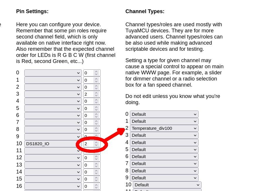

    You can configure the channel to hold the temperature in the second field after the pin for DS1820_IO on the config page.
    In the screenshot I see you configured channel 2 - channel 2 has (temperature * 100) = 2468 there.
    I'm not sure, but isn't this channel published on every change of channel = change of temperature?

    #37 21689034
    max4elektroda
    Posts: 754
    Help: 48
    Rate: 187
    I'm not really fit in MQTT / HA.
    I just tired here and looks like if you set the "channel type" for the channel with temperature value to "Temperature_div100" (like her in Web App on "Config" page)
    Screenshot of pin and channel configuration with DS18B20 sensor highlighted

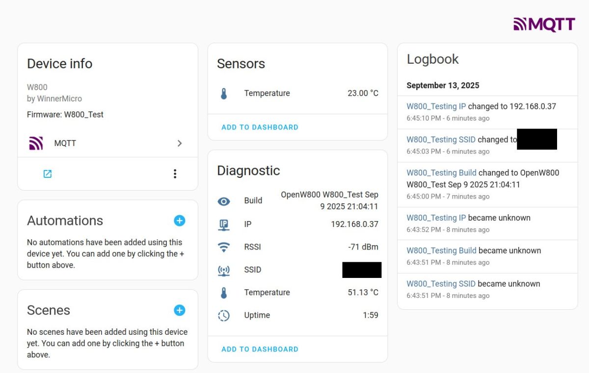

    then in HA a new (separate) temperature for the same device is shown (after starting a new "HA Discovery" on OBK):
    Diagnostic panel of W800 device with network data and temperature reading

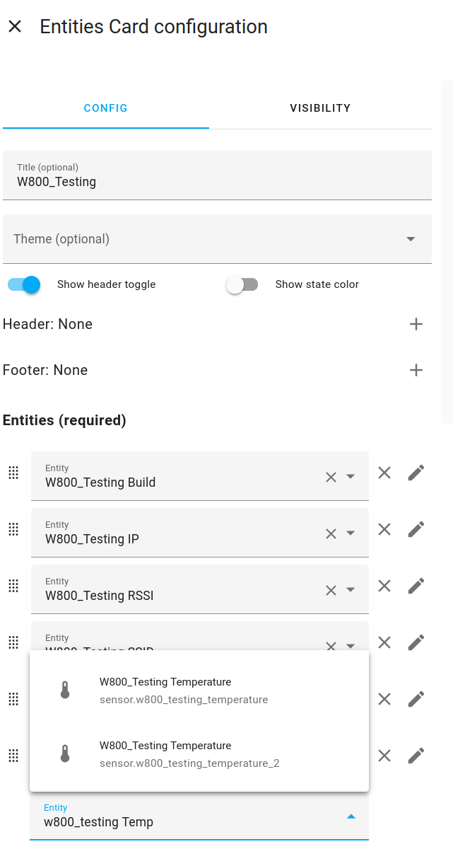

    If you edit your device entities, you can add a second "Temperature" (there will be two, check out which one is chip internal and which DS1820 - for me it was the one without "_2"):
    Entity card configuration titled W800_Testing showing five listed entities

  • #39 21689056
    max4elektroda
    Posts: 754
    Help: 48
    Rate: 187
    buenogy wrote:
    Work Verry Well !!!
    Great!
    If you configure channel type, the temperature will also appear a third time on OBK main Page (beside the drivers value and the channels value) as "Temperature <value> (<channel>)"
    Screenshot of OpenW800 interface showing temperature and system status
    BTW: You don't need Web App to configure channel, it can also be configured with the command (e.g. in "Execute Custom Command)
    setChannelType 2 Temperature_div100
