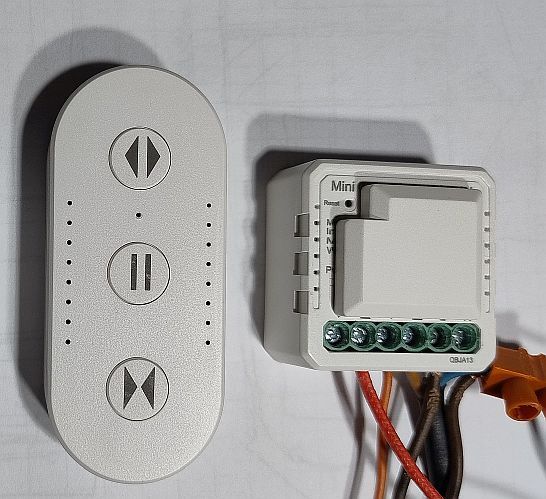

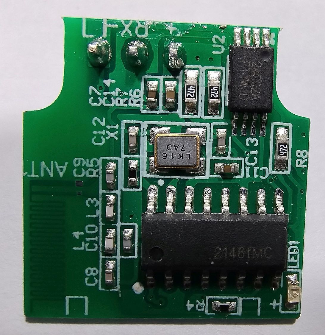

    Additional RF slot leads to RX1 pin, this can be used, e.g. by connecting DHT11 or other sensor (we just happen to have 3.3V, GND and one GPIO lead out, just in time!)
    The RF socket is originally designed for mounting the wireless radio remote control module:
    Radio remote control and mounting module. Close-up of a green circuit board with various electronic components, intended for wireless module installation. .

    What you are talking about was stated at the beginning of the topic, before the firmware change:
    The product is characterised by the ability to plug in RF control, there is a connector on the casing for this. Apart from this, there is only WiFi. The product is realised on the BK7231, as evidenced by
    Thank you for showing a pic of what it looks like.
    After the firmware change, as I wrote, the socket can be used to connect a wide variety of sensors. For example to connect a DHT (several types are supported):

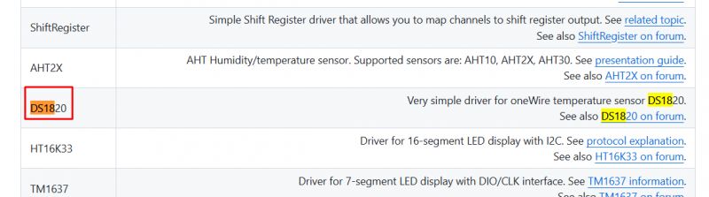

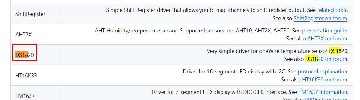

    Or even a DS18B20:
    Table with information about various drivers, including DS18B20 highlighted in orange. .
    Just be aware that there is an uninsulated power supply inside.
