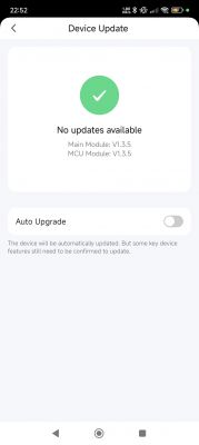

    v1.3.5 known patched = no cloudcutter.

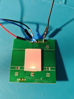

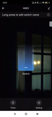

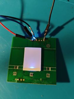

    Upon flashing and import of the extracted config we have a 100% working device with behaviour like that of the factory firmware.
    -button backlight and wifi LED flash when connecting to wifi and then solid blue when connected
    -switch off = blue backlight hue
    -switch on = red backlight hue
    personally, red signals off for me, but I guess red could also be interpreted as "hot", live, on.

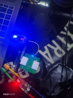

    Hello @divadiow Thank you for the write up, I came across this recently and because of your detailed instructions I decided to order this switch, however I have been trying to follow your instruction to flash it but I have not had any success so far, please how do I get it to enter flashing mode? Thank you

    hi. OK. how long are your wires from device to USB-TTL adaptor? How are you supplying the 3.3v to device? If you have pics of your setup that would definitely help.

    Thank you, the data wires are short, I used external power from a 12v adapter and a buck converter set to 3.33v. I couldn't get it to flashing mode no matter how many rebooting I did, and I also couldn't recognize CEN on the board to ground, easy flasher was set to 115200 baud rate, attached are some pictures

    I'm in daylight on my phone at the moment so the pic is a little hard to make out but do I see the USB-TTL not in common ground with the ext PSU?

    Thank you, sorry about the picture, yes the USB-TTL GND is not connected to the ext PSU GND, is it supposed to be?

    Yes. Common ground with device, usb adaptor and psu

    Thank you so much for your help, this still doesn't work for me, please can I use tuya-cloudcutter
