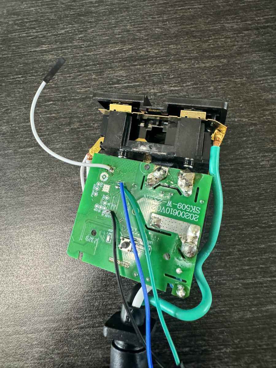

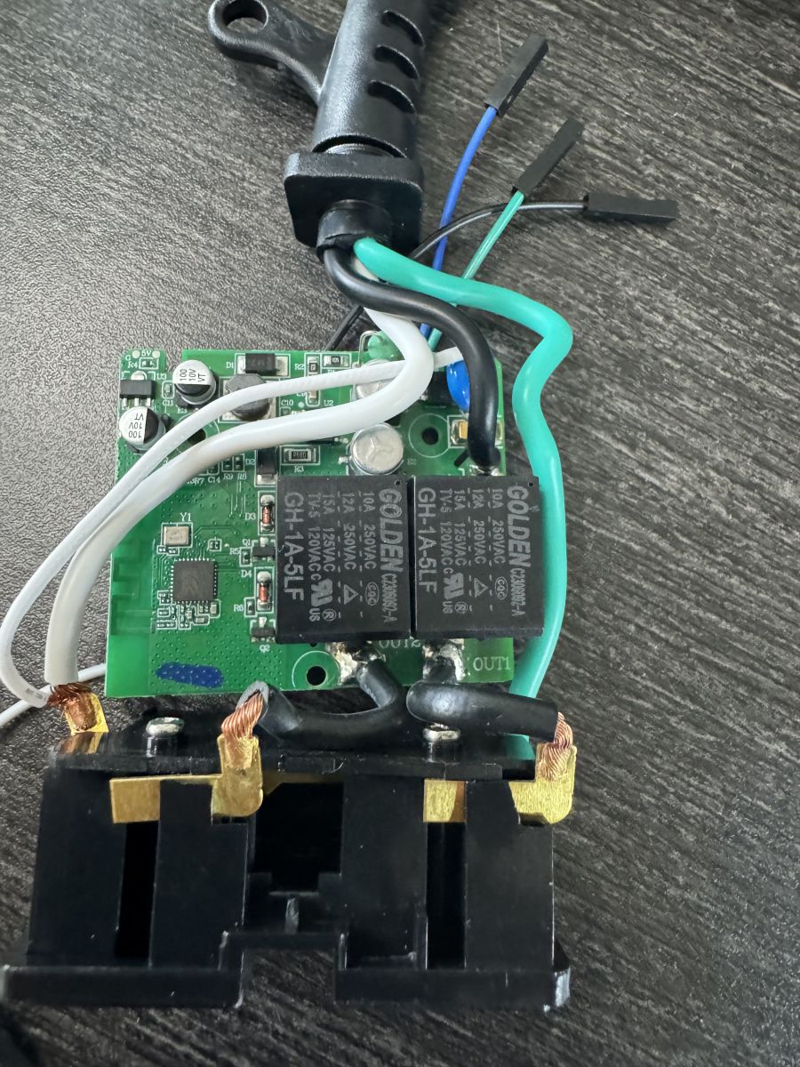

    (AQIA) Microcenter Smart outdoor plug, I am able to flash it using BK7231 UART Flasher but don't know its configuration (JSON) template tried to use Fiet but there are differences Fiet only has one really but this has two
    Close-up of a Microcenter smart plug with visible PCB and connected wires. Open circuit board with wires and electronic components.
    If someone has a similar device and knows the configuration??
    if not any clue to find the JSON for this. I already tried described in this video but it gives key error
    https://www.youtube.com/watch?v=WunlqIMAdgw&t=110s

    If the automatic extraction fails, then you can easily use GPIO doctor to figure out the pin roles. Have you tried it? GPIOdoctor is in the Web App.
  • #3 21162980
    arvindrajput
    >>21162909
    I did not know that but it was very help full . I am able to make it work
    here is the template
