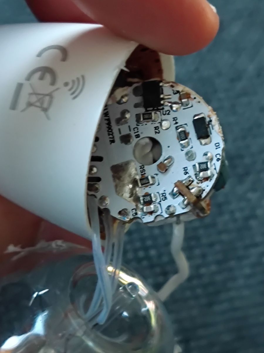

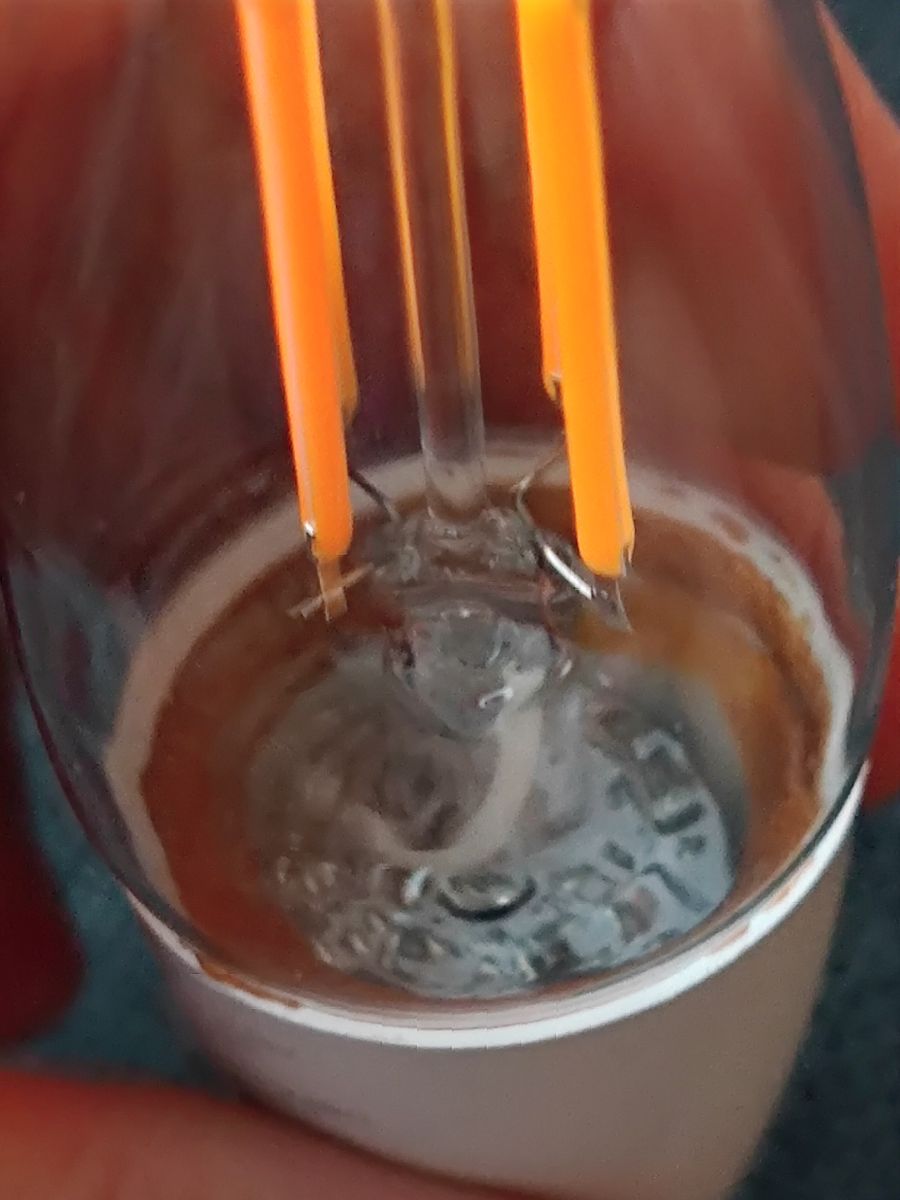

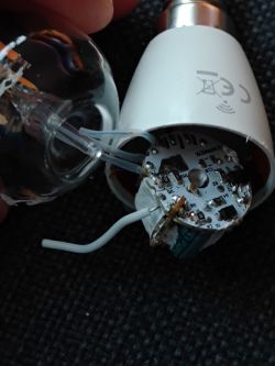

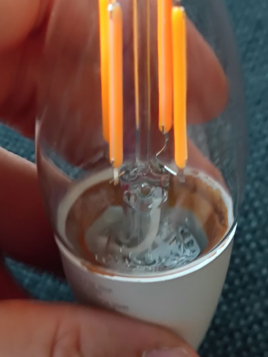

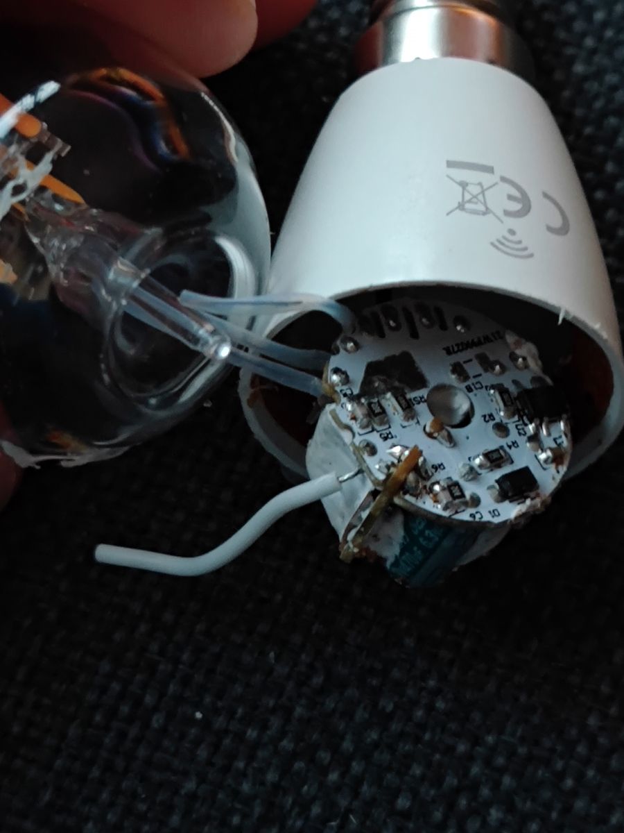

    Could anyone tell me what this white wire might be for? Can't figure out where/how it was connected, but the lamp doesn't work anymore. Have one similar lamp and the white wire doesn't seem connected to anything? Added some images of functioning lamp.

    It's the WiFi antenna
    Added after 8 [minutes]:
    they tend to be present when the bulb has a smaller module, one without its own aerial built-in. like CBLC5. eg https://www.elektroda.com/rtvforum/topic4040714.html
    https://obrazki.elektroda.pl/3178564400_1709672972.jpg
    https://obrazki.elektroda.pl/3116048200_1709672851.jpg
    https://obrazki.elektroda.pl/1457091600_1709672851.jpg

    Haha so obvious now that I know. Anyway, the lamp doesn't work anymore, rest of the wires are connected. I'll see if I can flash and repurpose the chip and components for a relay or something similar I guess!
