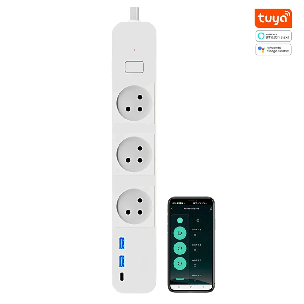

    MELERY POWER STRIP (3 AC 2 USB A 1 USB C)
    The device is simple to open - just unscrew the bottom and the small circuit. After which I un-soldered the CB2S chip and flashed it with openBK.
    Once done the following JSON template and autoexec.bat will allow the main power button to switch all AC ports on and off, and double clicking it will switch all the USB ports on and off.

    Wow, those USB ports are separately controlled? This is something new. All the strips I've bought so far had all USB ports together on a single MOSFET switch. Thanks for sharing!

    >>21218025 Yes, they also have a blue light turning on when they are on (except the USB-C that does not have such light).
