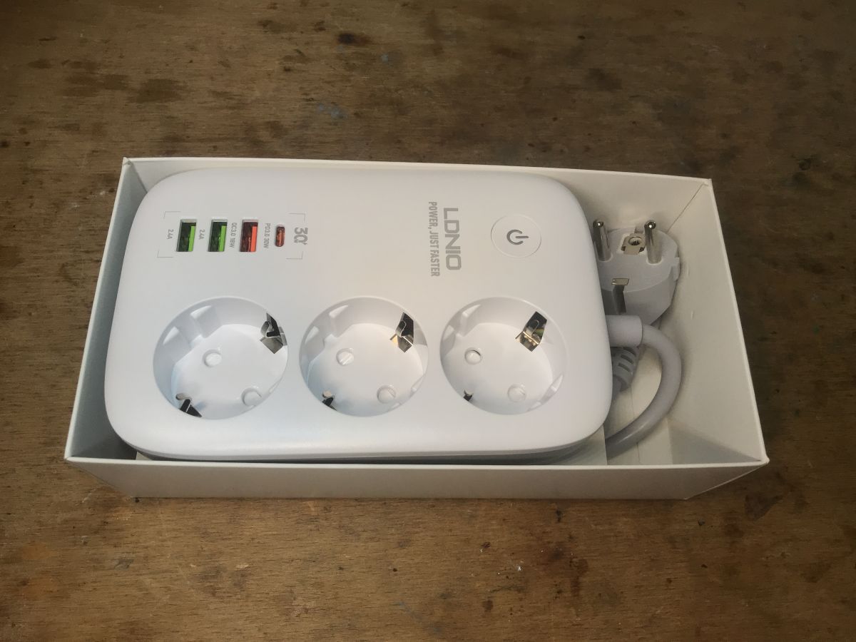

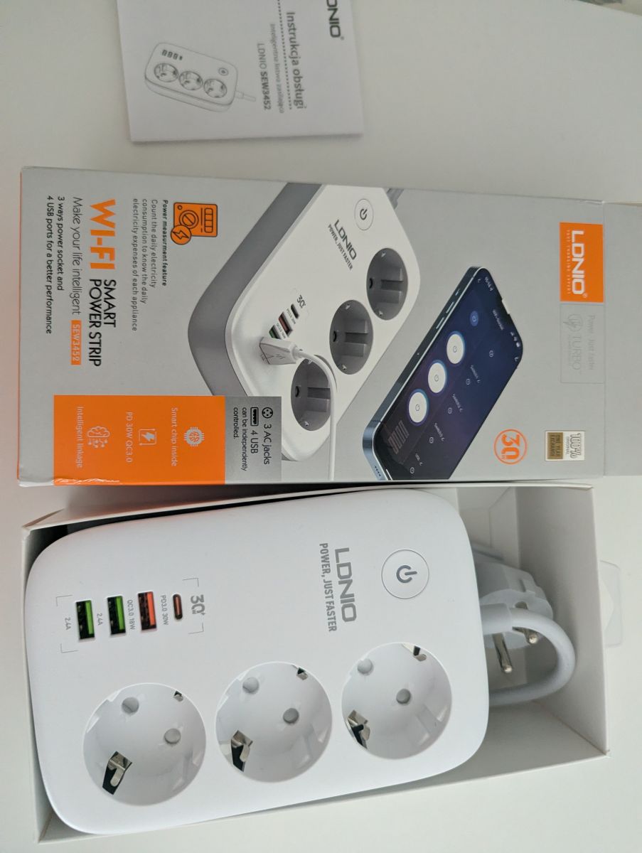

  • LDNIO SEW3452 power strip with three sockets and four USB ports in a box. Today I will present the interior and firmware change of a strip/extender offering three power sockets and four USB sockets, in addition with QC support. I will upload open source software onto the product OBK so that it works 100% locally, in a way that is secure and respects the user's privacy, without the cloud.

    What you get in practice:
    Box of LDNIO SEW3452 power strip with three sockets and four USB ports. Packaging of LDNIO SEW3452 power strip with 200 cm power cord Package of the LDNIO SEW3452 Wi-Fi power strip on a table. White power strip with three electrical sockets and four USB ports in a box. Instruction:
    User manual of LDNIO SEW3452 power strip Wi-Fi power strip instruction manual with three sockets and four USB ports. User manual for LDNIO SEW3452 Wi-Fi Smart Power Strip Instruction for adding WiFi-Socket device on a leaflet. User manual for a power strip with WiFi function.

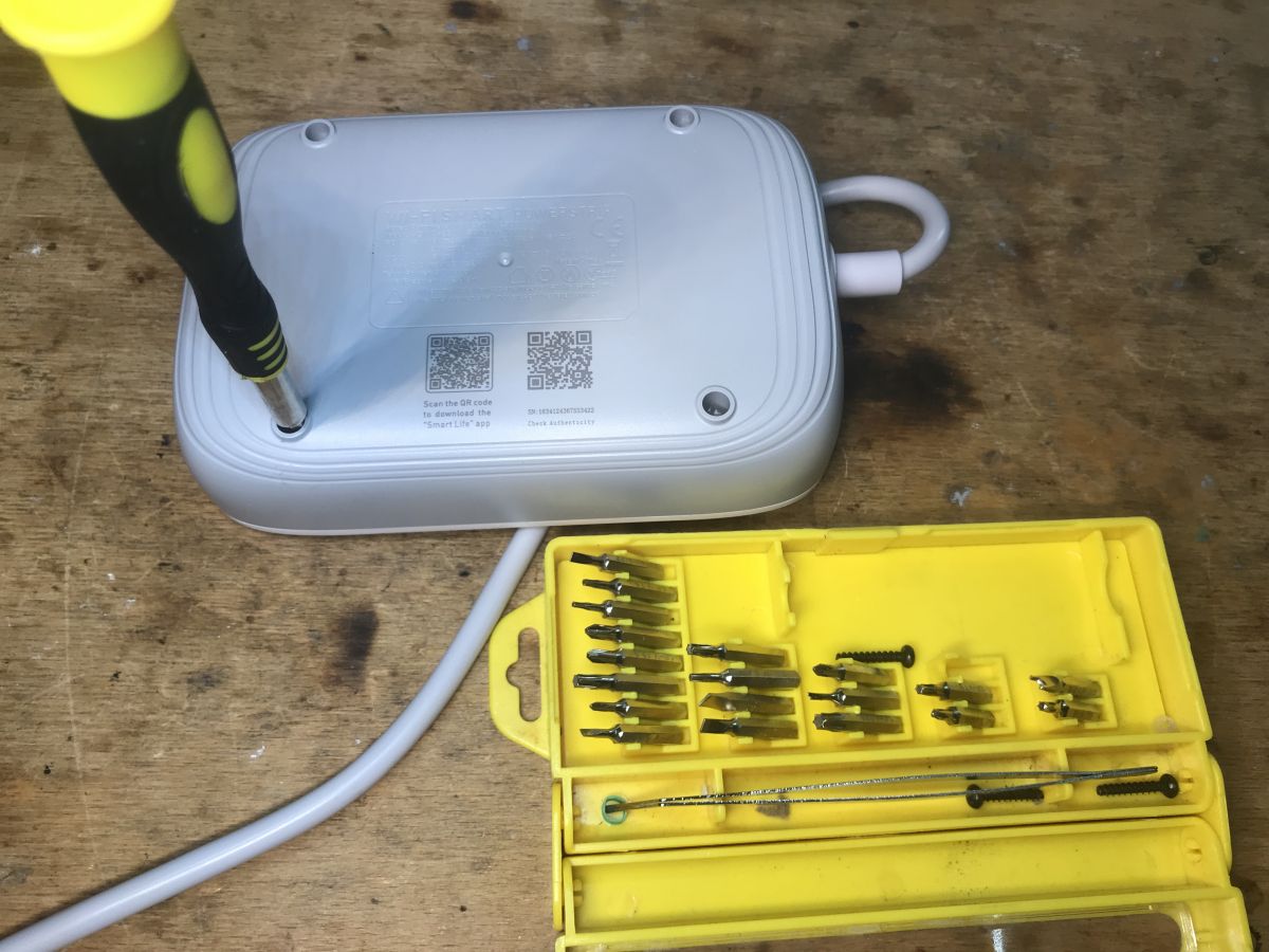

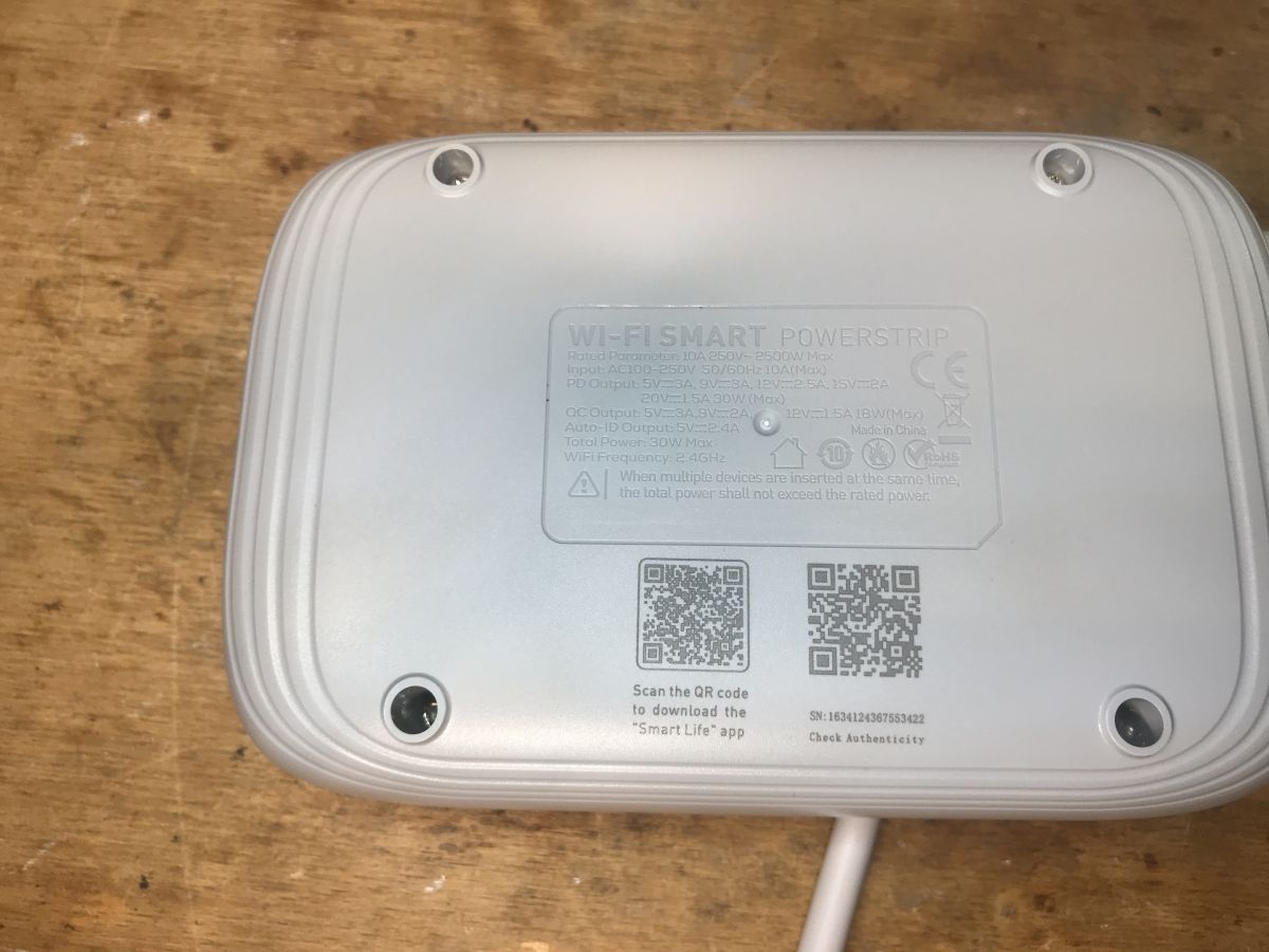

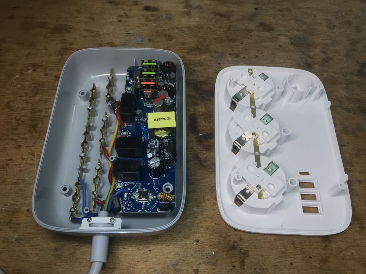

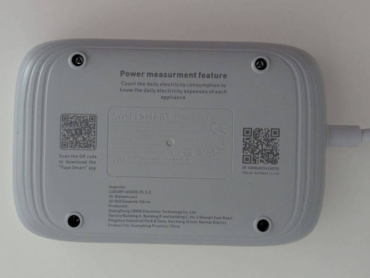

    Interior of the LDNIO SEW3452 USB QC This will be a bit tricky. You need a special screwdriver with a triangular tip.
    Bottom of a power strip with technical data and QR codes Screwdriver opening power strip case with a set of bits.

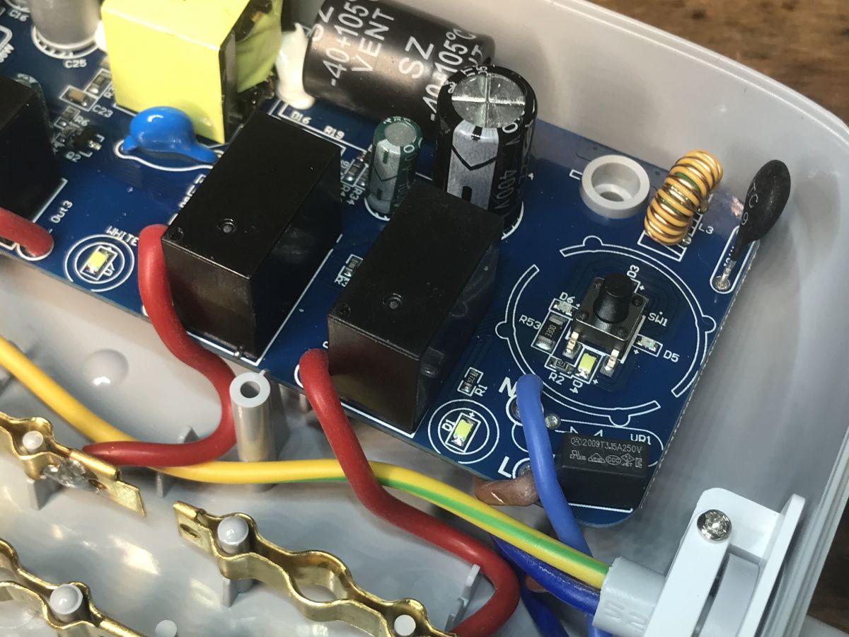

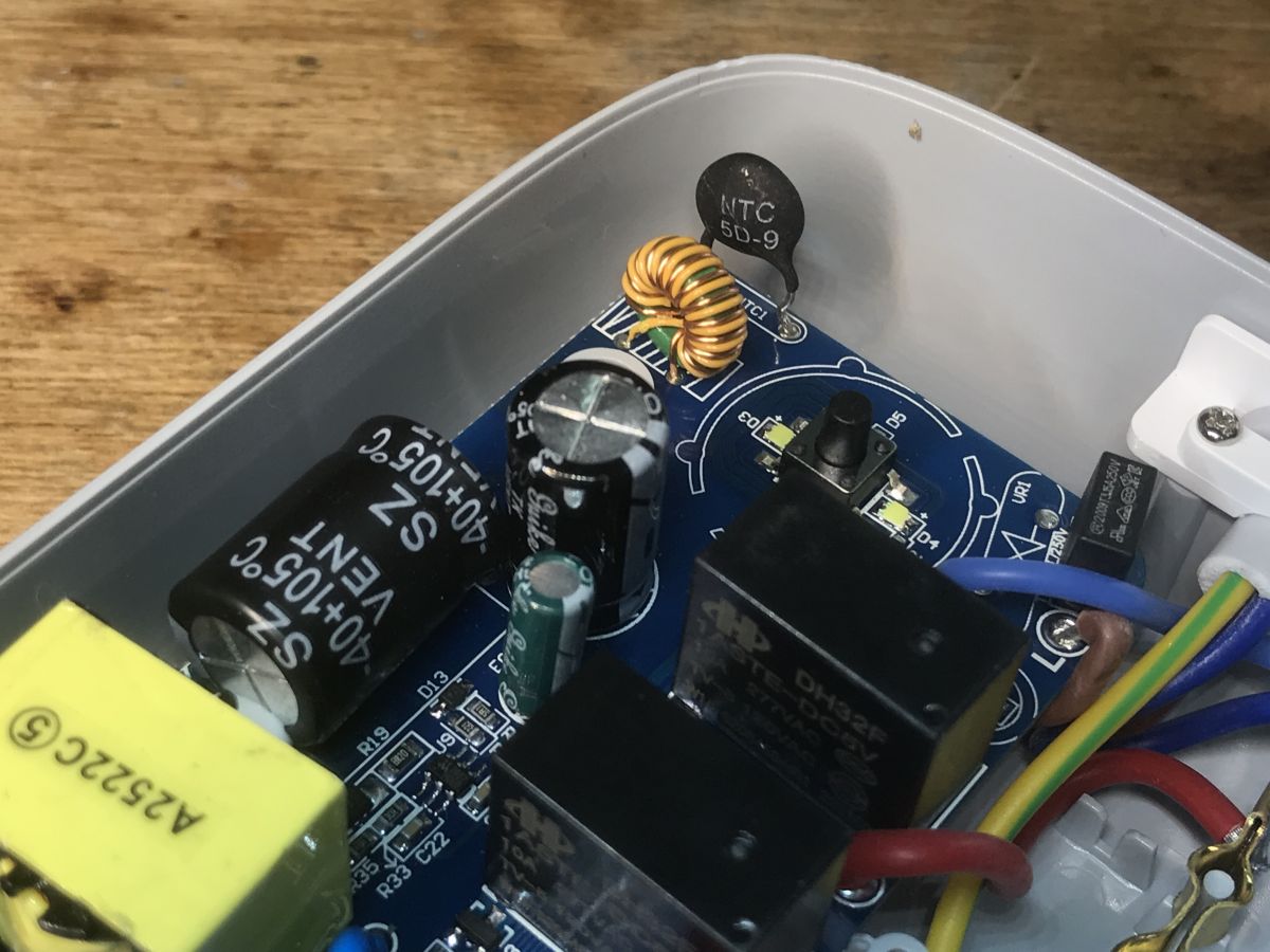

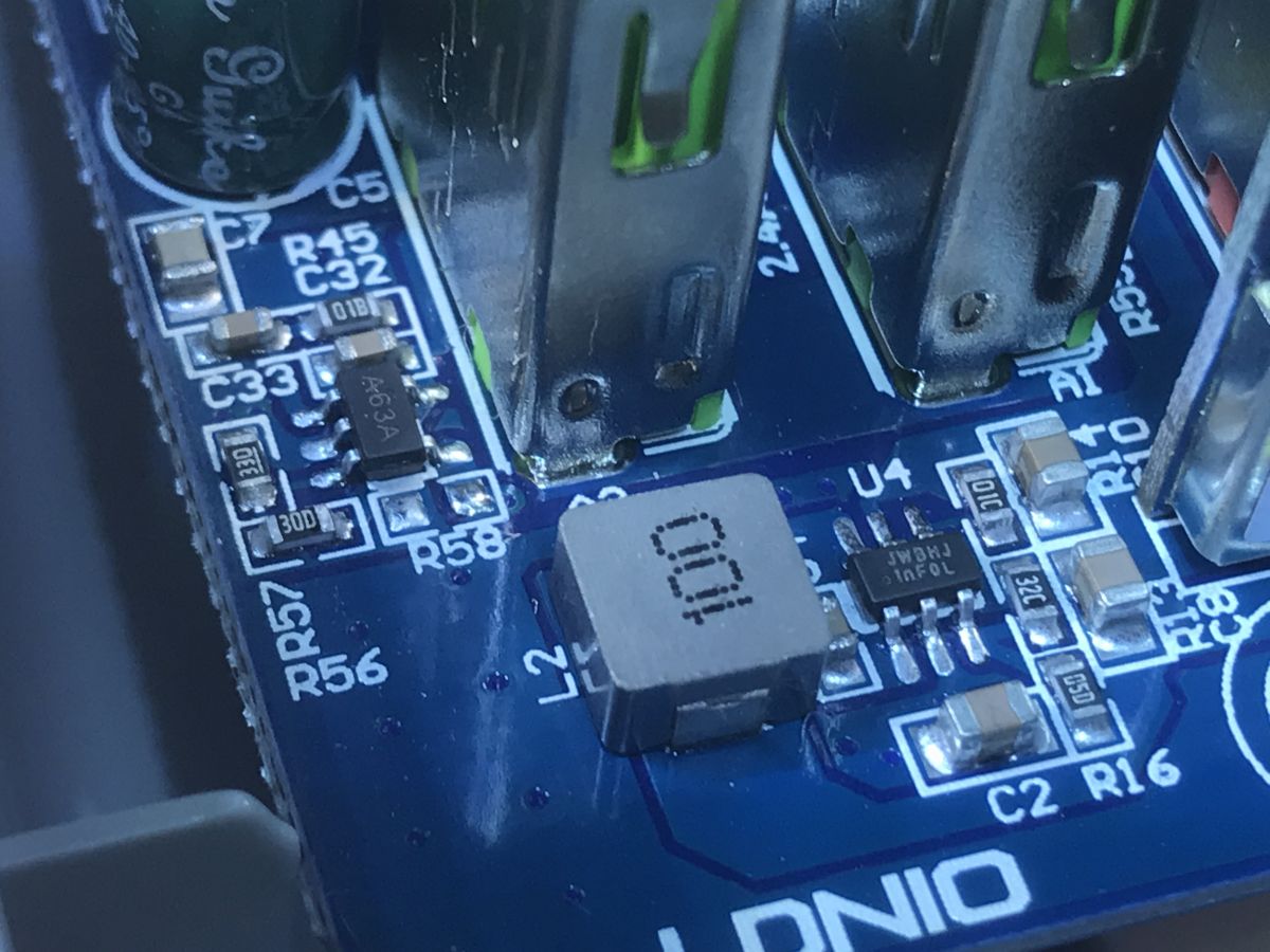

    The interior is really rich. I can even see some coil and filters, although there is an empty space for a varistor?
    Interior of a disassembled LDNIO SEW3452 power strip showing electronics and sockets. Interior of a power strip with electronic components. Interior of the QC USB LDNIO SEW3452 power strip showing electronic components. There is also an NTC thermistor, probably limits the inrush current.

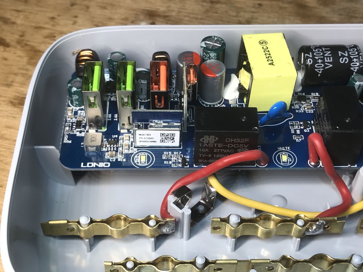

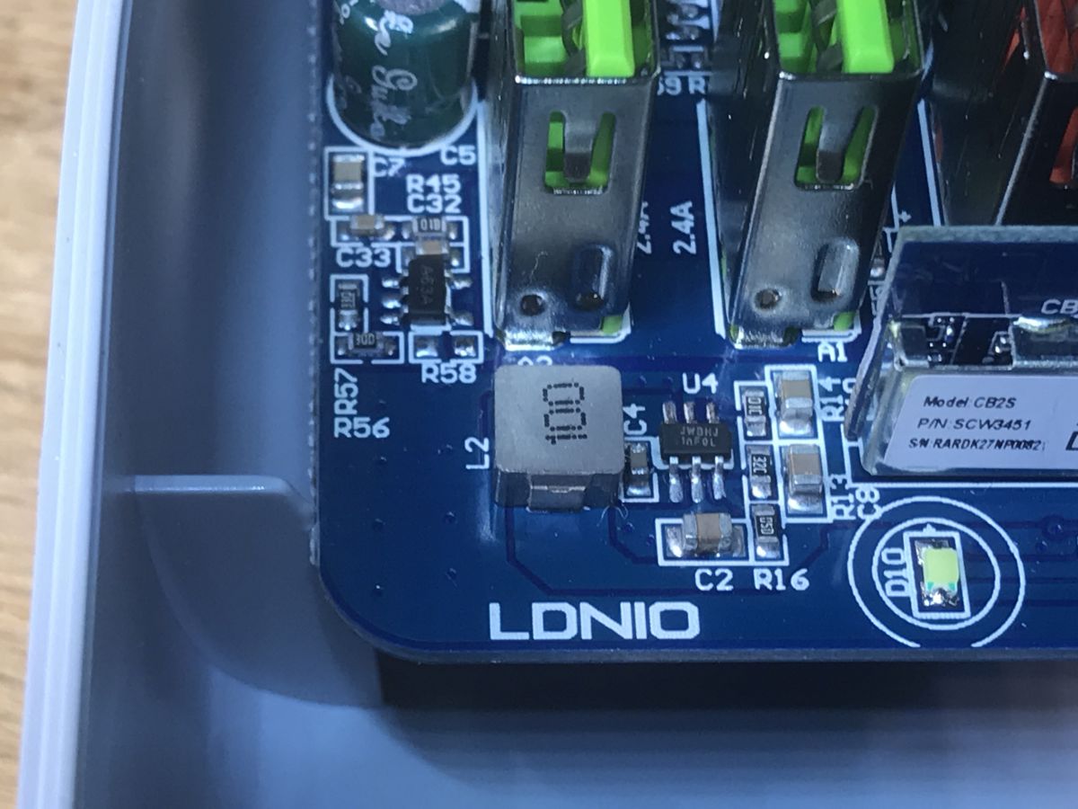

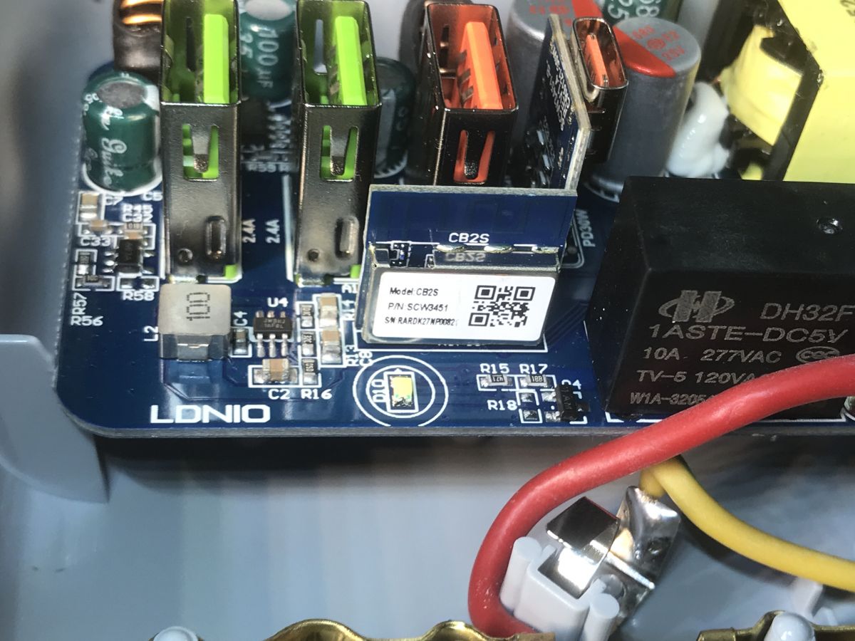

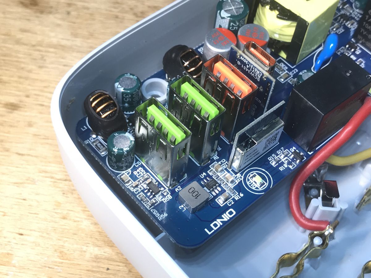

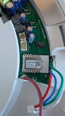

    Interior of LDNIO SEW3452 power strip with WiFi module CB2S.
    The WiFi module is a CB2S (BK7231N). You can see the step down converter next to it (element U4 with large coil L2). The relay is for 5V, 1ASTE-DC5V.
    Interior of LDNIO SEW3452 power strip showing electronic components. Interior of LDNIO SEW3452 power strip showing electronics including WiFi module, capacitors, and relays.

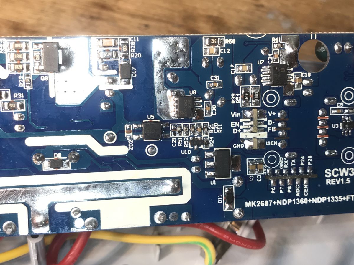

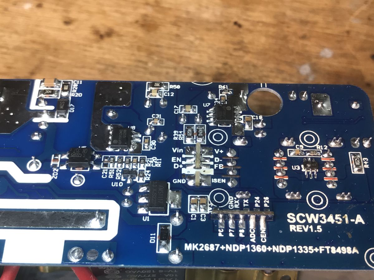

    You can see the A63A circuit:
    Close-up of the PCB board of the LDNIO SEW3452 power strip with visible electronic components and USB connectors. Close-up of the interior of the LDNIO SEW3452 power strip showing an electronic component and USB ports. Close-up of electronic components on the LDNIO SEW3452 circuit board

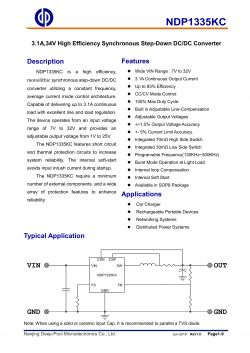

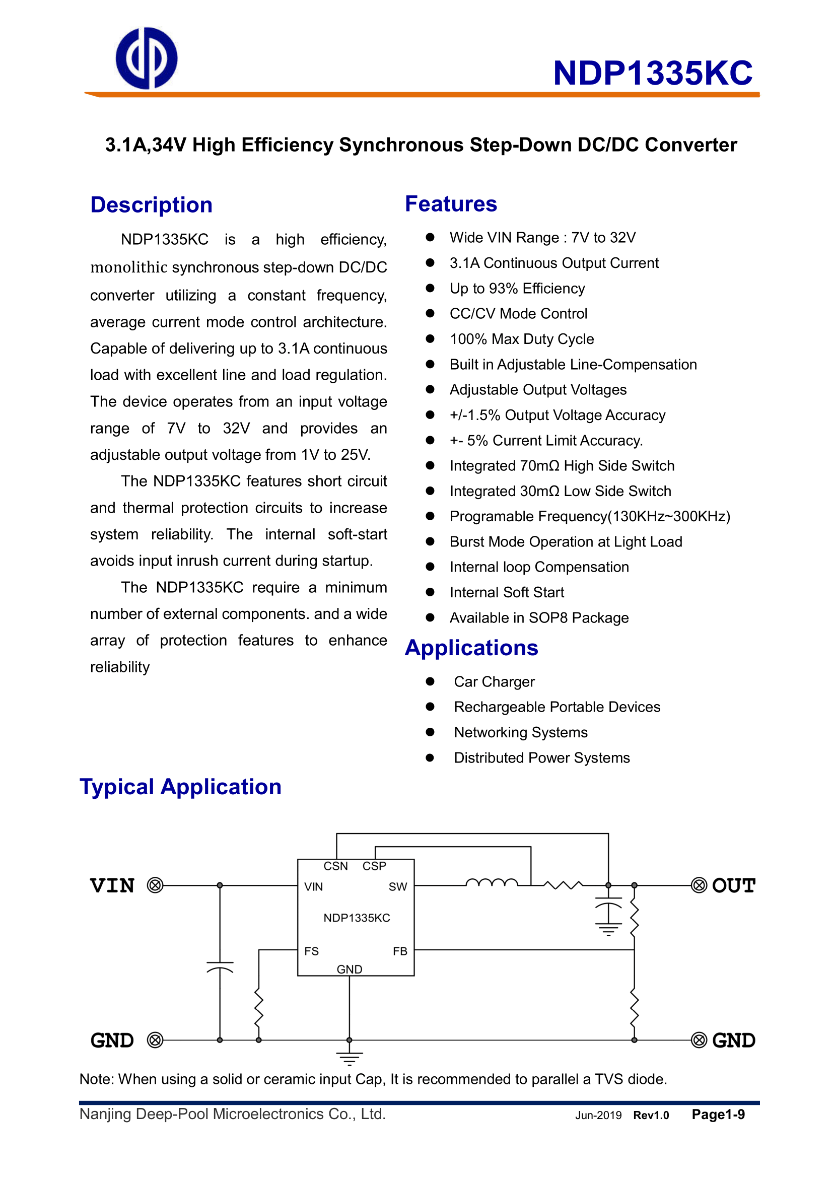

    The intermediate inverter is based on NDP1335KC:
    Close-up of a circuit board with electronic components, including USB ports and capacitors. Close-up of a circuit board with electronic components, including USB ports and capacitors.
    Technical specification of the NDP1335KC chip.

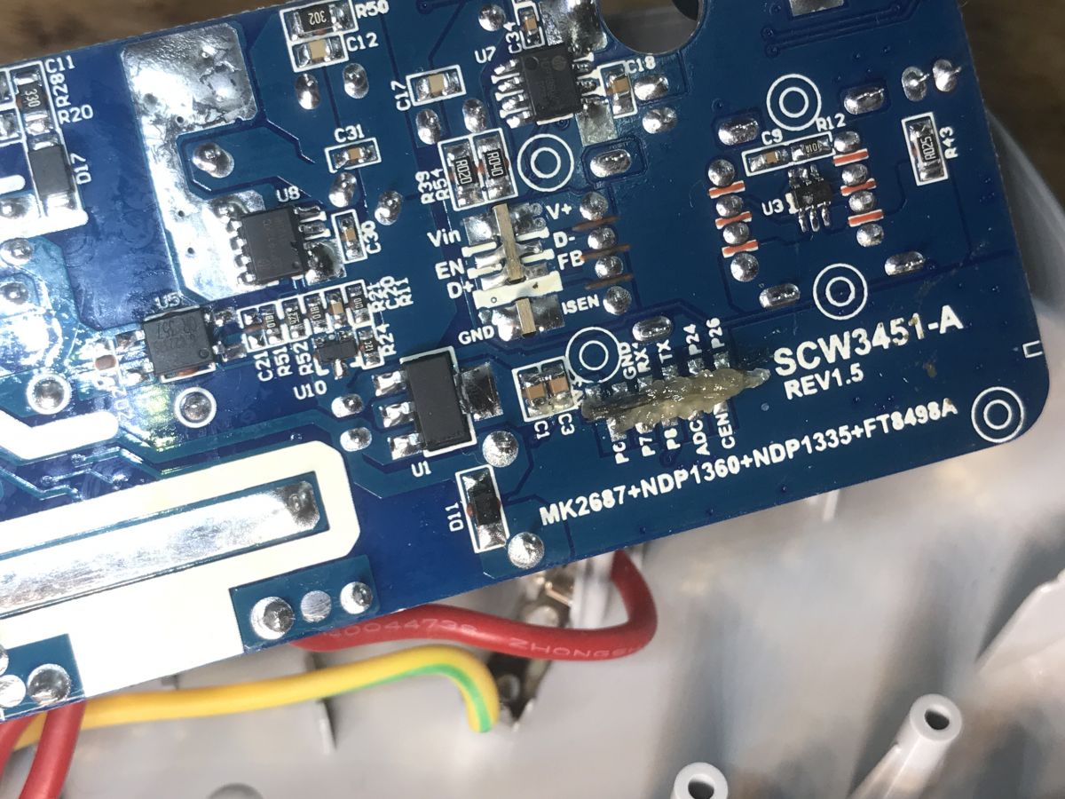

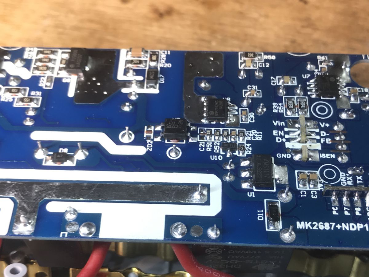

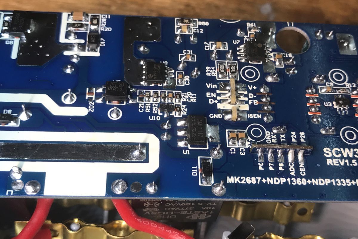

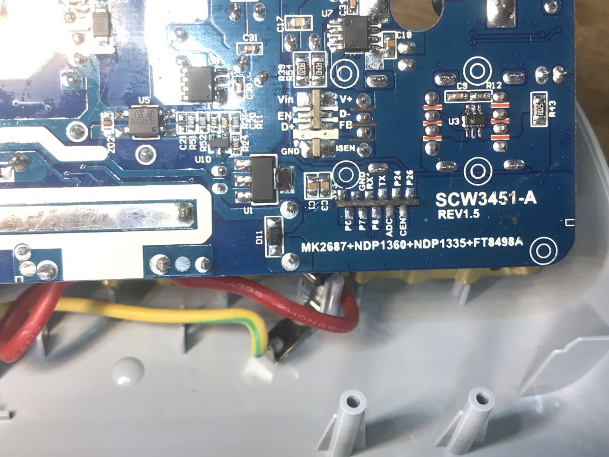

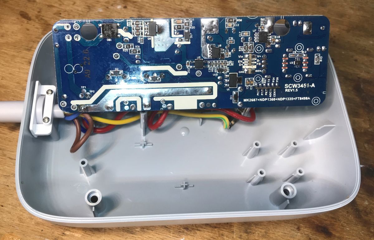

    PCB designation: SCW3451-A REV1.5
    MK2687+NDP1360+NDP1335+FT8498A
    Interior of a disassembled power strip showing the circuit board.

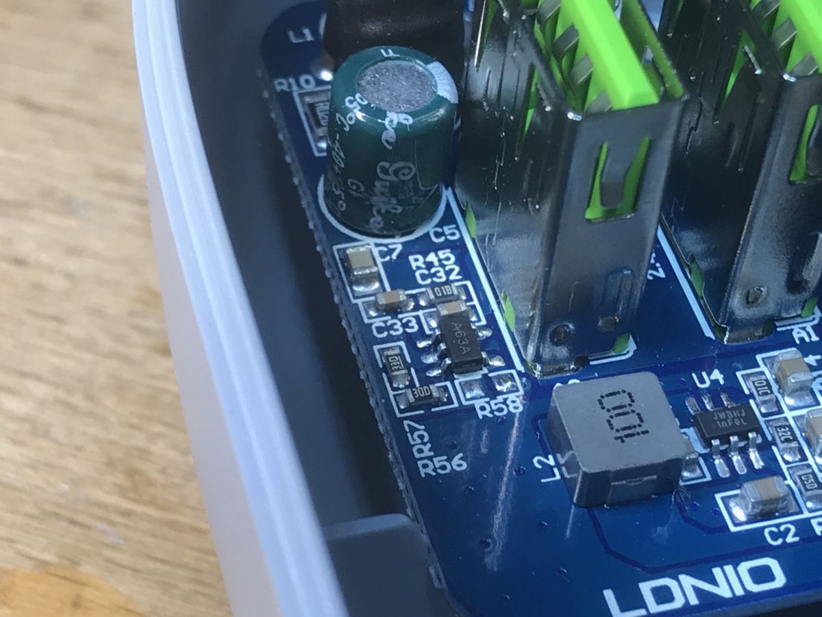

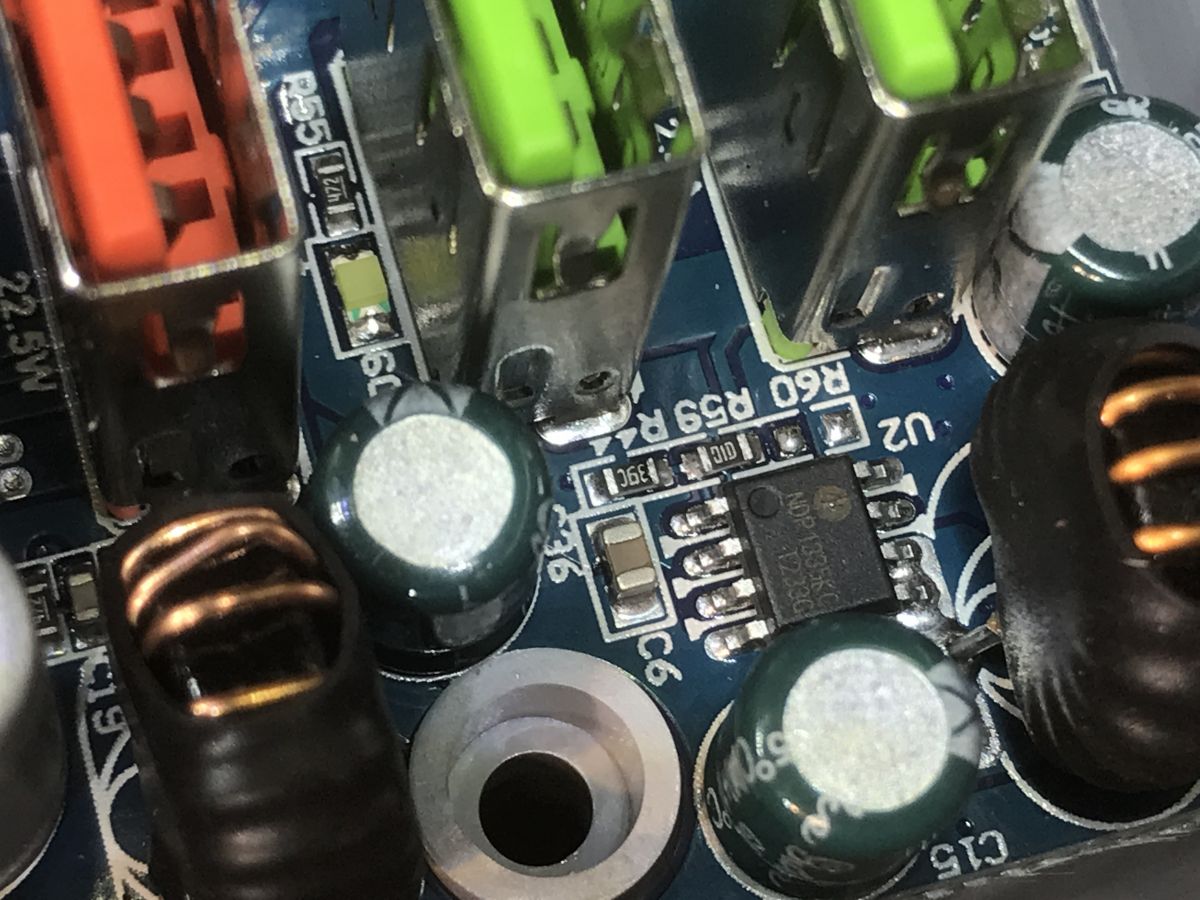

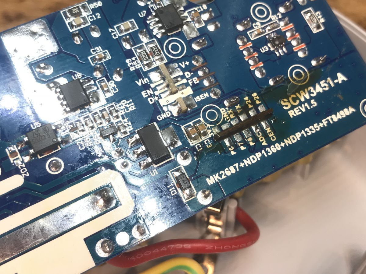

    On the underside I also see an NDP7912KC and I think some kind of optocoupler.
    Interior of SEW3452 power strip with electronic components on PCB Close-up of a PCB with electronic components inside the LDNIO QC USB SEW3452 power strip. Interior of the LDNIO SEW3452 power strip showing a printed circuit board. Close-up of a circuit board with electronic components and markings. Close-up of the circuit board inside the LDNIO SEW3452 power strip. Close-up of the PCB of the QC USB LDNIO SEW3452 power strip with visible electronic components. Close-up of the interior of the LDNIO SEW3452 power strip showing electronic components. Close-up of a circuit board with electronic components. NDP7912KC is a synchronous rectifier, not bad, it's more efficient than a Schottky diode:

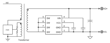

    Flyback converter schematic with transformer and PWM circuit.

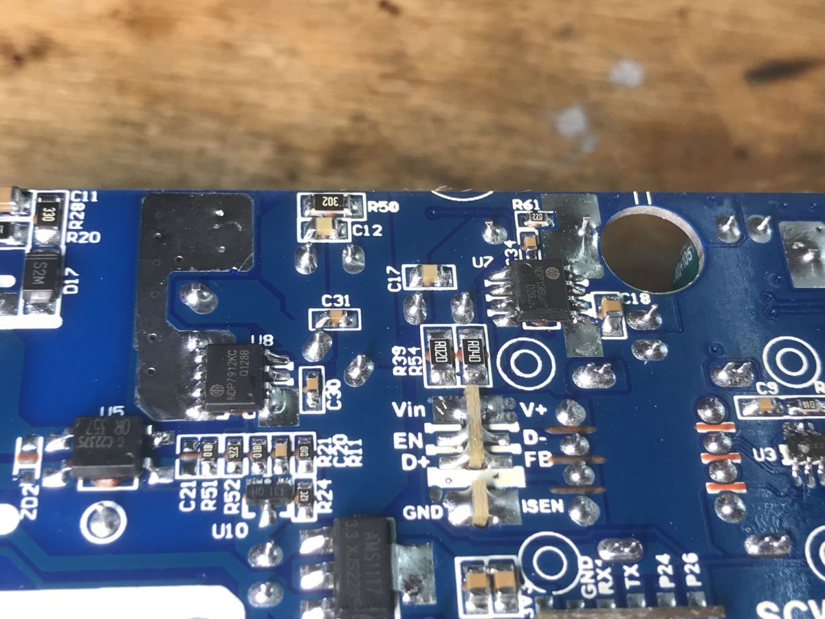

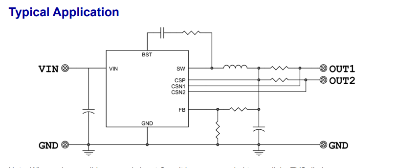

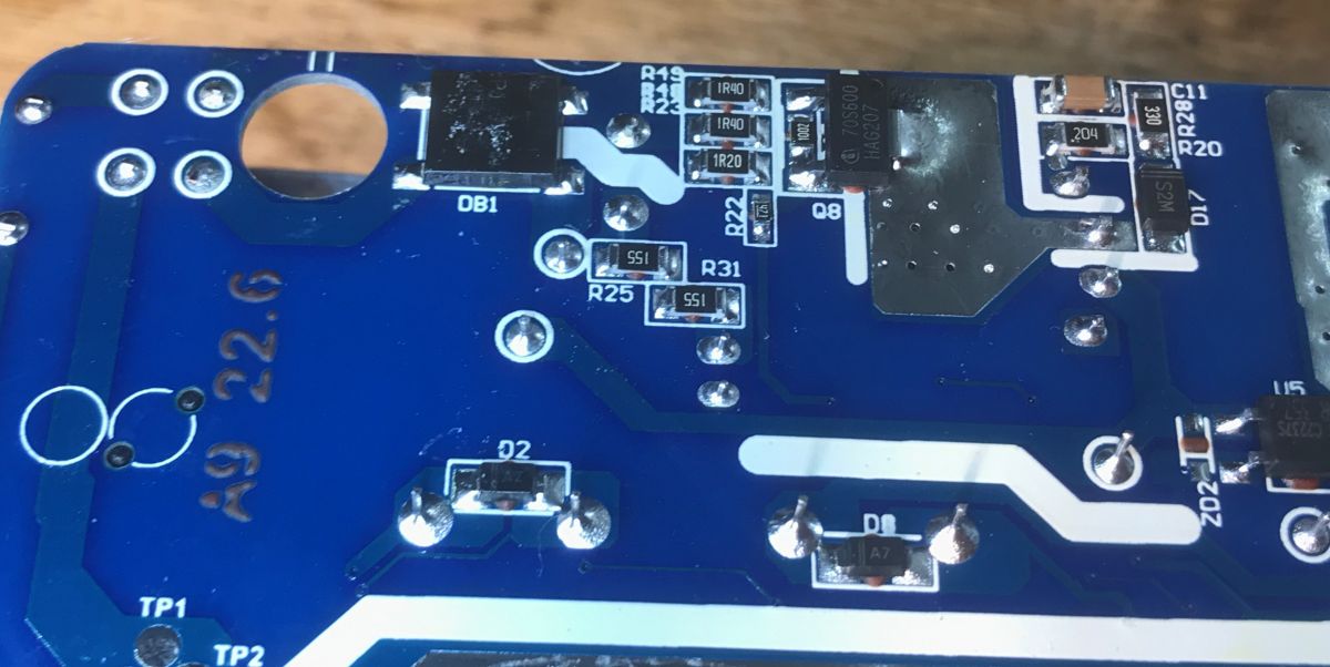

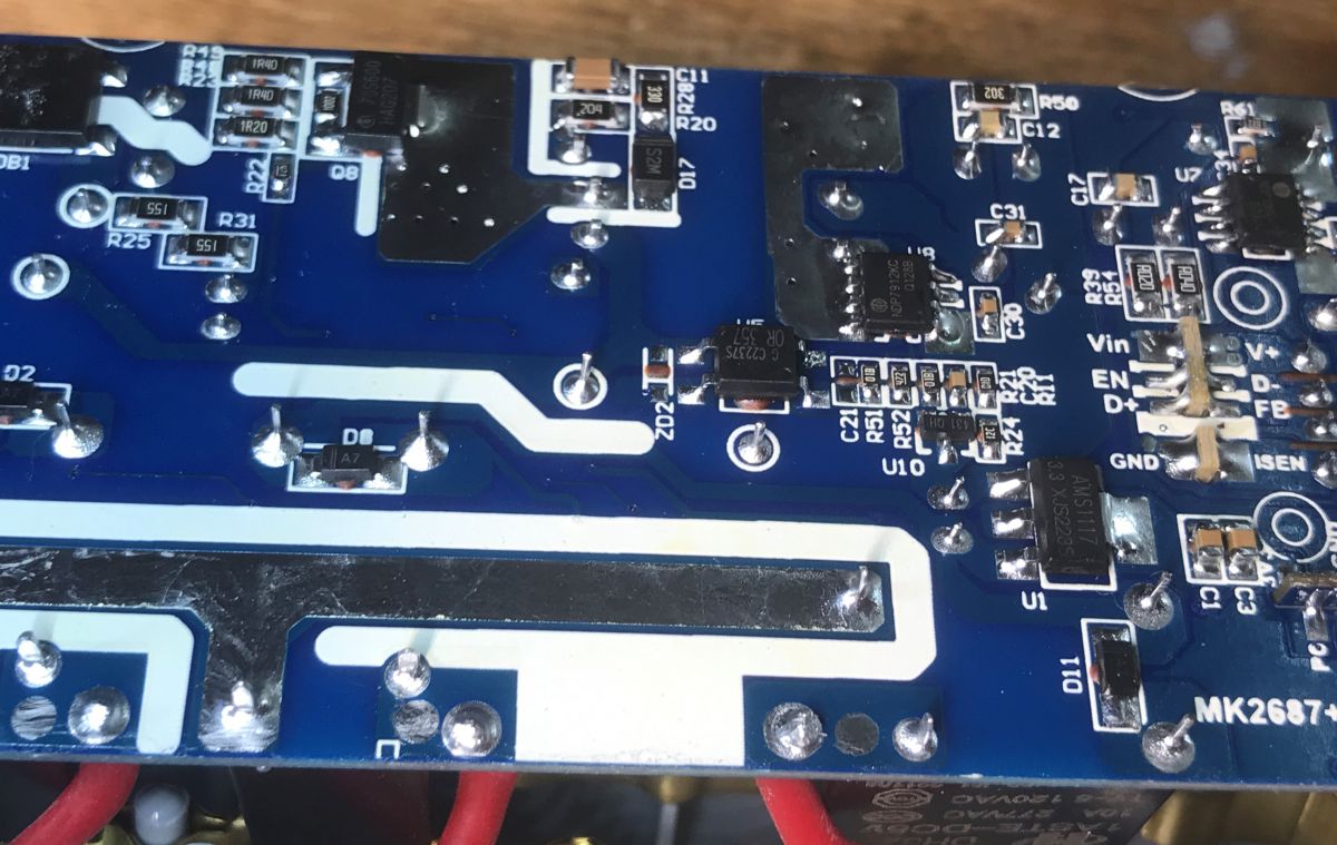

    Another inverter seen on the bottom is the NDP1360:
    Technical specifications of the NDP1360KC converter Diagram of a typical application circuit with an integrated circuit and passive components.

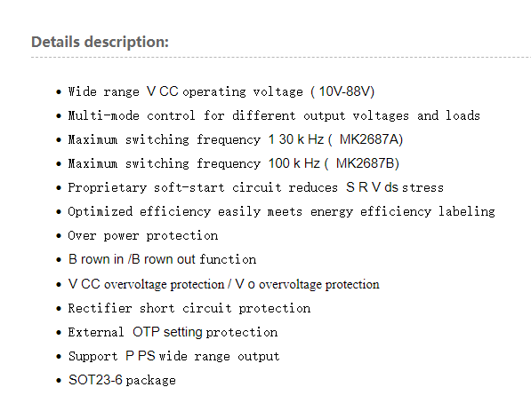

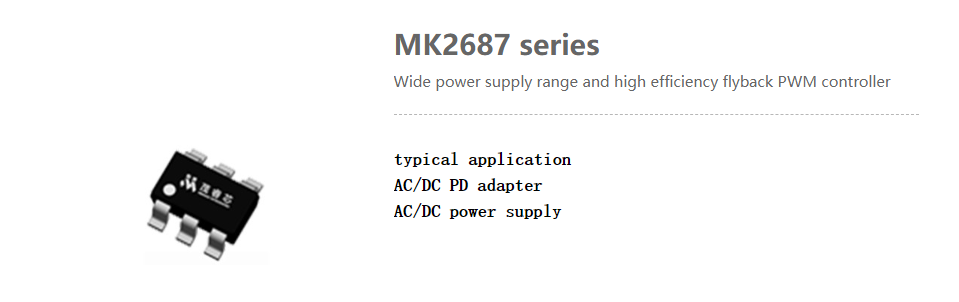

    The flyback converter controller itself here is an MK2687:
    MK2687 series - wide power supply range and high efficiency flyback PWM controller. Technical features of the MK2687A/B power module.

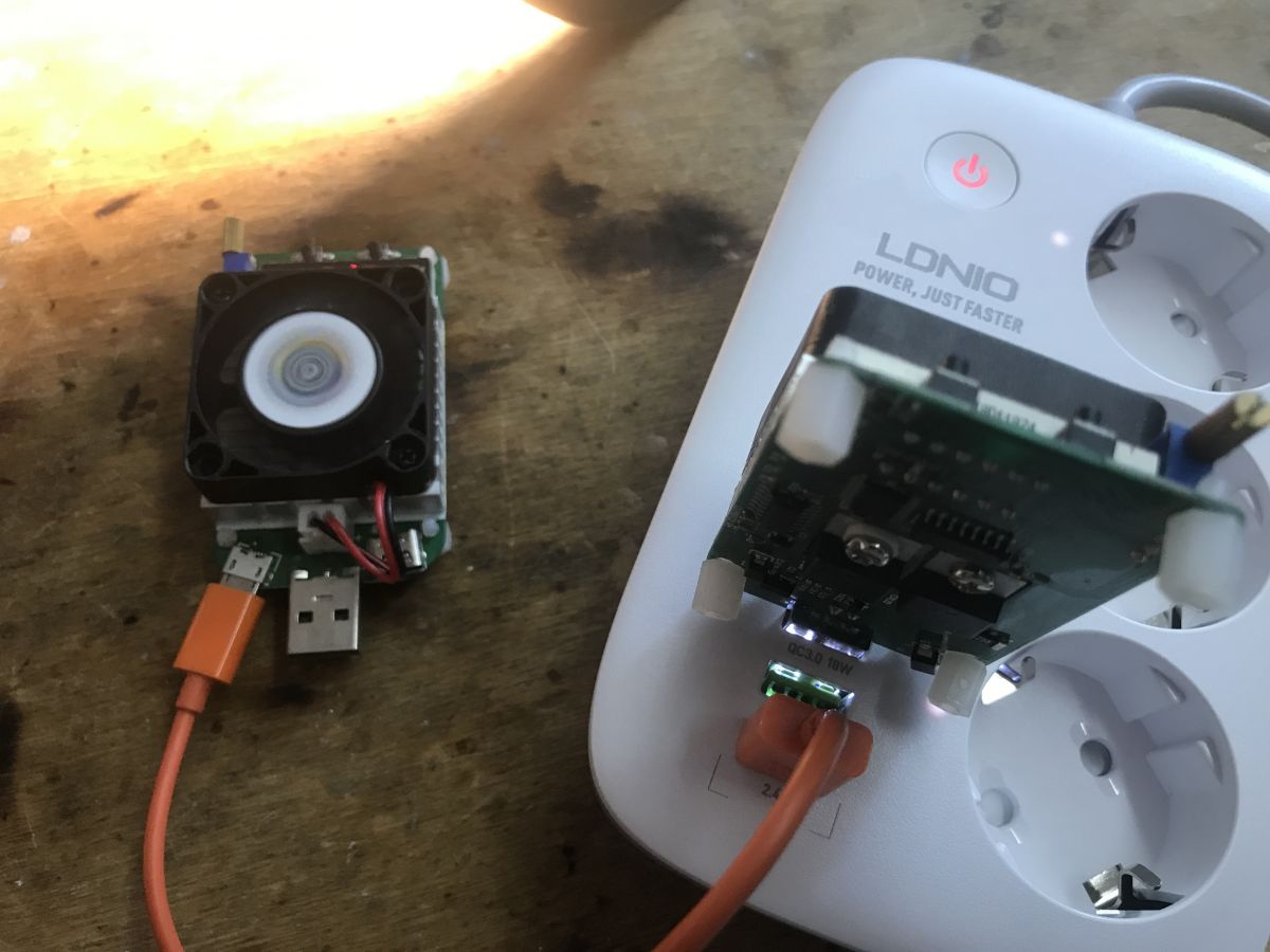

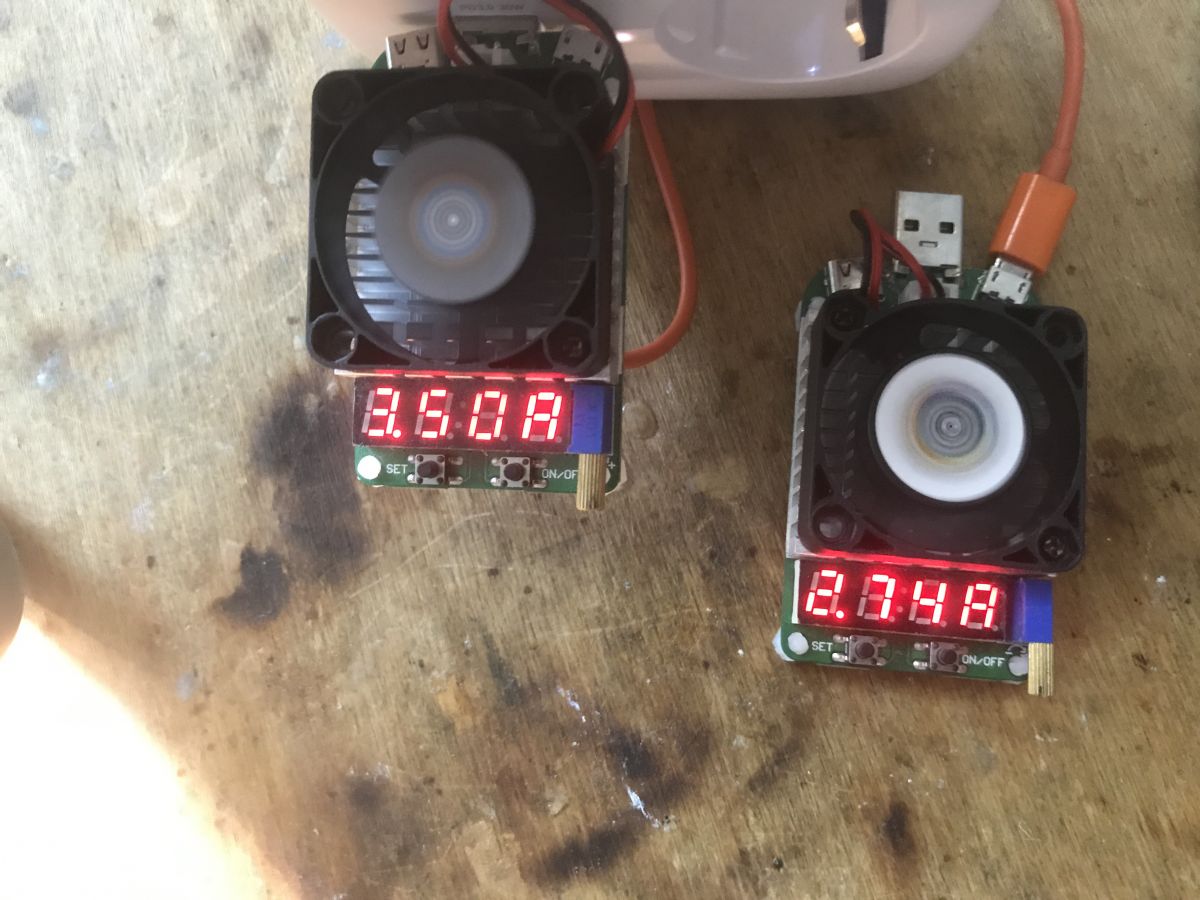

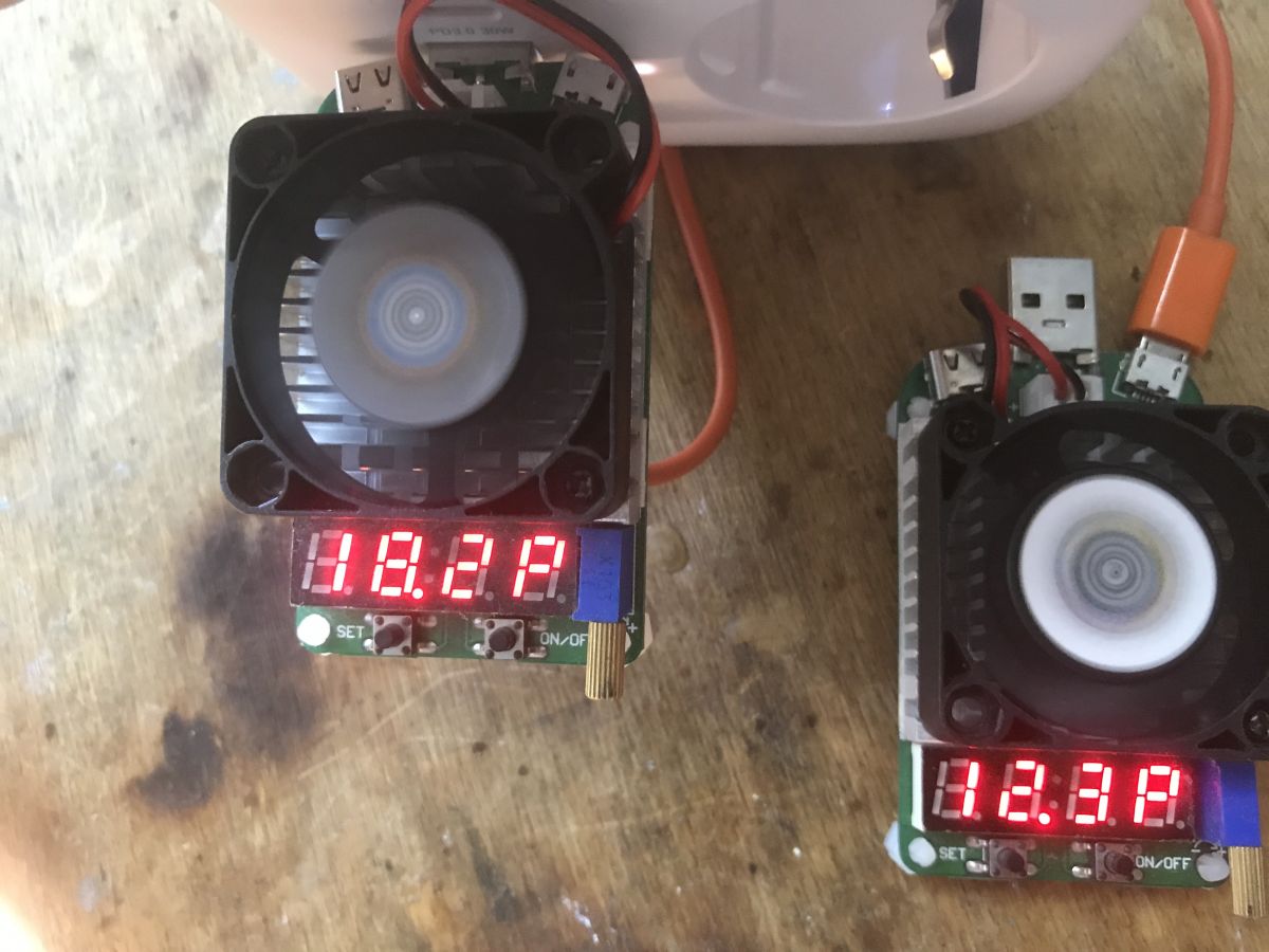

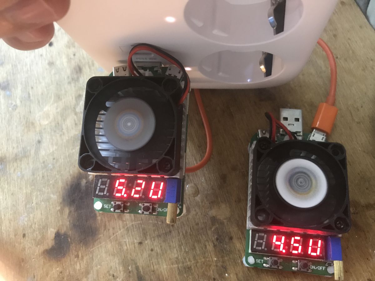

    [b] Current capacity test of the LDNIO SEW3452 USB QC
    I wanted to test the current capacity of this strip, but I did not have a suitable artificial load. I therefore used two loads at once - LD25 and LD35.
    Testing LDNIO SEW3452 power strip with two loads Two electronic loads with fans and LED displays showing current values. Two test loads with fans and digital displays on a table. LDNIO SEW3452 power strip connected to testing devices. Let's add up the currents - 3.5A + 2.74A,
    Power: 18.2W + 12.3W. That is, a total of 31W.
    Then the protection is switched on.

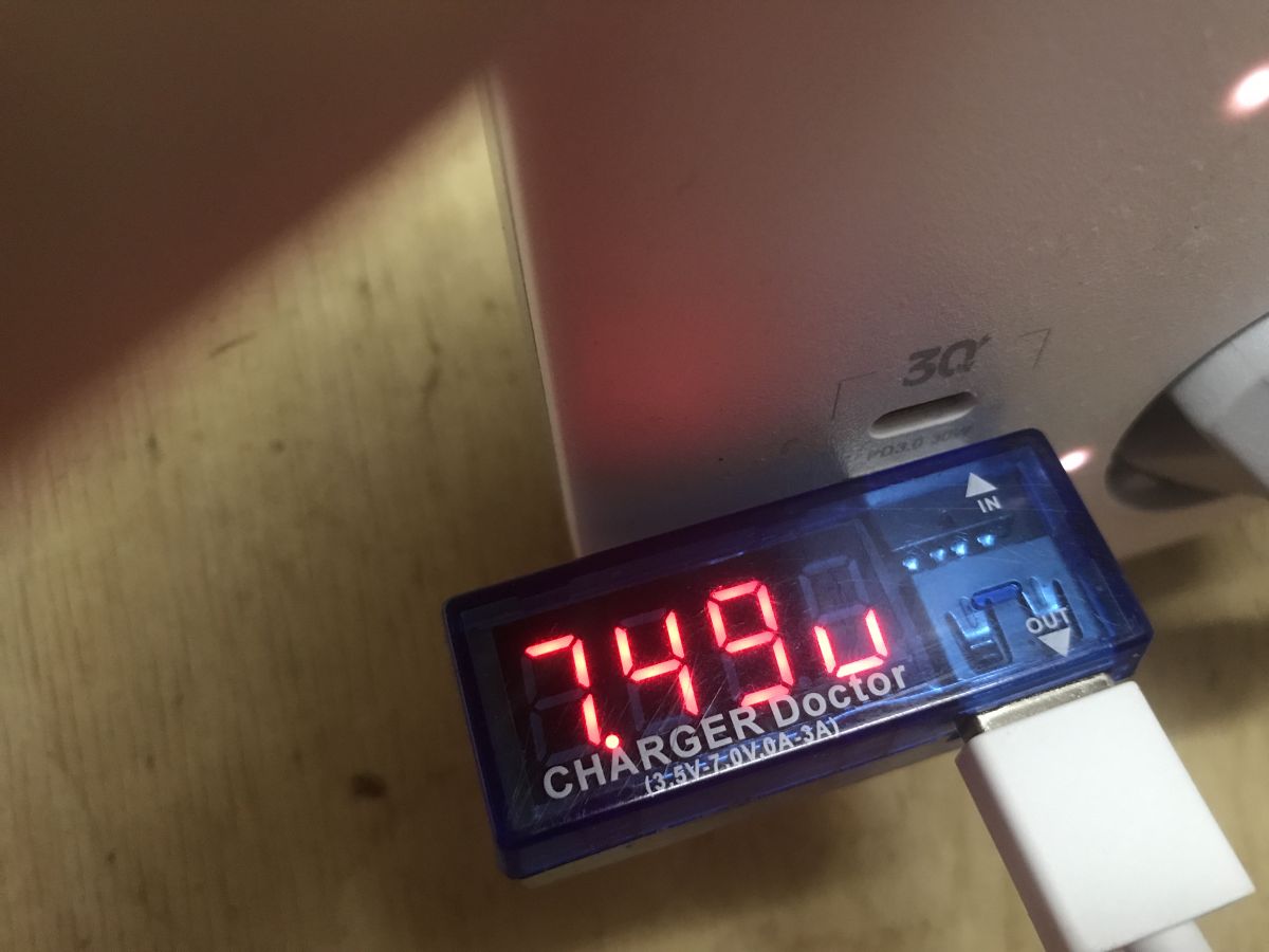

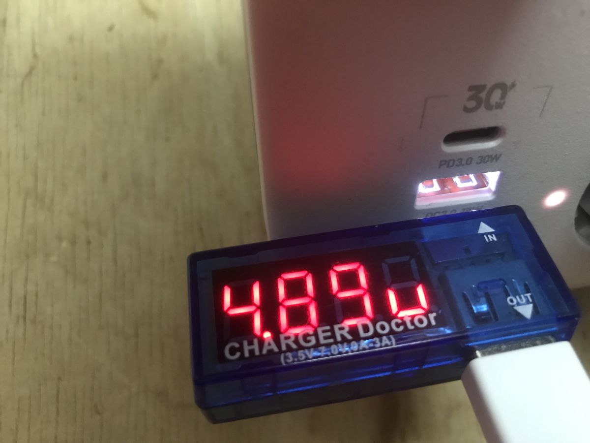

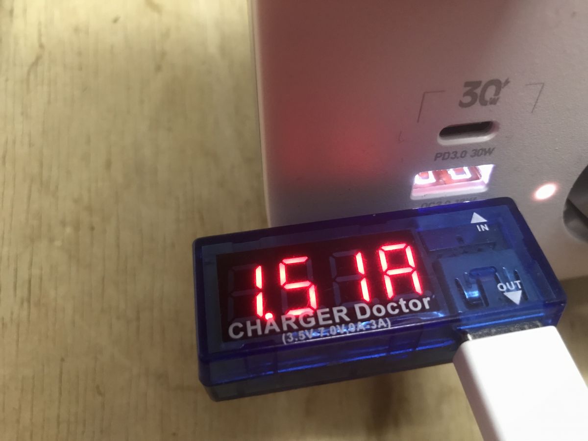

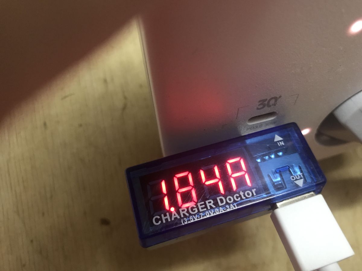

    I also checked the QC with my Xiaomi phone:
    Charger Doctor display showing a voltage reading of 1.84A. Display of a meter with a connected USB cable showing 7.49 V.
    Truly, it switches on 7.5V and 1.5A.
    However, not every port has QC:
    Display of a USB Charger Doctor current meter connected to an LDNIO power strip showing a reading of 1.51A. Electronic voltmeter displaying 4.89V connected to a USB port of the LDNIO power strip.

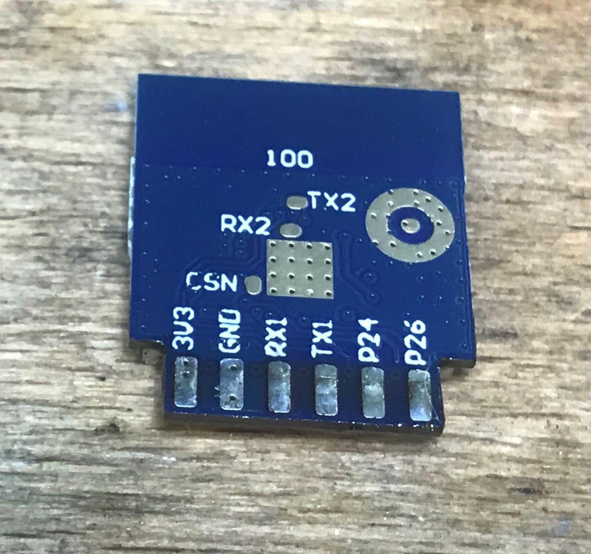

    Changing the QC USB firmware LDNIO SEW3452 In the middle is CB2S, or BK7231. You can upload OpenBeken:
    According to the flasher instructions:
    And our tutorials on YT:
    https://www.youtube.com/playlist?list=PLzbXEc2ebpH0CZDbczAXT94BuSGrd_GoM
    CB2S is best soldered out. I soldered it out straight away, I didn't test the programming in the circuit. After all, all you need is a bit of braid, flux and you're done.
    Close-up of a circuit board labeled SCW3451-A REV1.5 with electronic components. Close-up of the PCB of LDNIO SEW3452 power strip showing electronic components. PCB module with pin labels on a wooden surface.
    My flashing circuit (USB to UART converter and LDO 3.3V):
    Breadboard connected with an electronic module and wires on a wooden surface.
    After reading the 2MB firmware my flasher correctly decodes the Tuya configuration partition, so we know the GPIO roles. There is no need, as with Tasmota, to guess what is on which pin. Everything is given like on a tray:
    BK7231 flasher software interface with device GPIO configuration readout results.
    Tuya configuration:
    Word description:
    Device seems to be using CB2S module, which is BK7231N chip.
    - Relay (channel 1) on P6
    - Relay (channel 2) on P7
    - Relay (channel 3) on P8
    - Relay (channel 4) on P26
    - WiFi LED on P23
    - Pair/Toggle All Pin on P24
    The fourth relay controls the USB outputs.
    OpenBeken template:
    The template can be added according to the instructions from here:
    After uploading, everything works as expected.

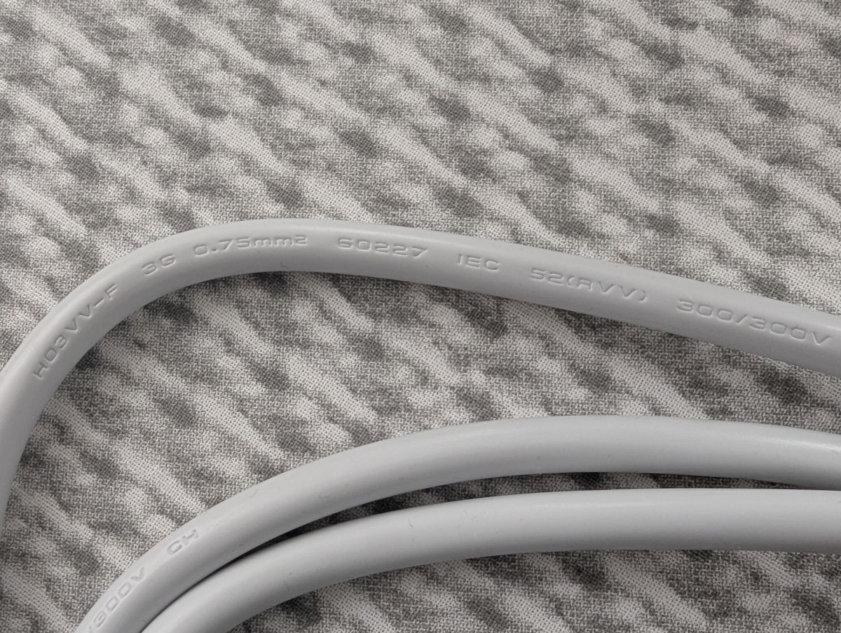

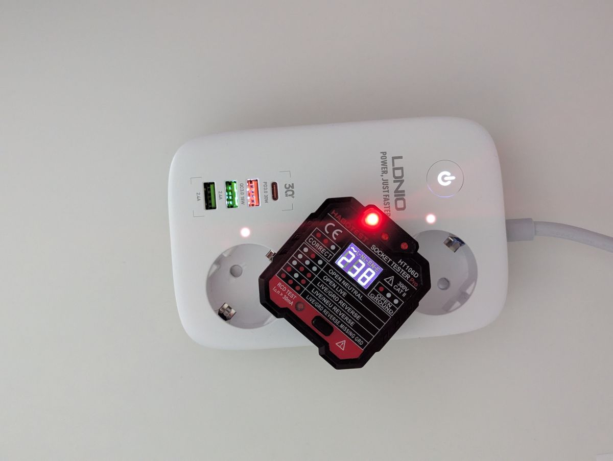

    I bought (and sent back but more on that later) this strip in the variant with current consumption measurement. The interior has been well described by colleague @p.kaczmarek2 , I have not opened the strip.
    LDNIO power strip with three sockets and four USB ports in open packaging Bottom of Wi-Fi power strip with technical details and two QR codes visible.
    The power strip makes a good impression when opened. The power cable advertised as thick is only 0.75mm2.
    Close-up of a gray cable labeled 3G 0.75mm² 300/300V on a patterned fabric

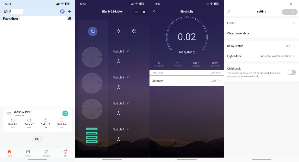

    The strip pairs with the Tuya app, there is a summary measurement of current consumption with a daily breakdown. The behaviour of the indicator LEDs can be set, automations can be created.
    Screenshots of the Tuya app managing a power strip with energy monitoring

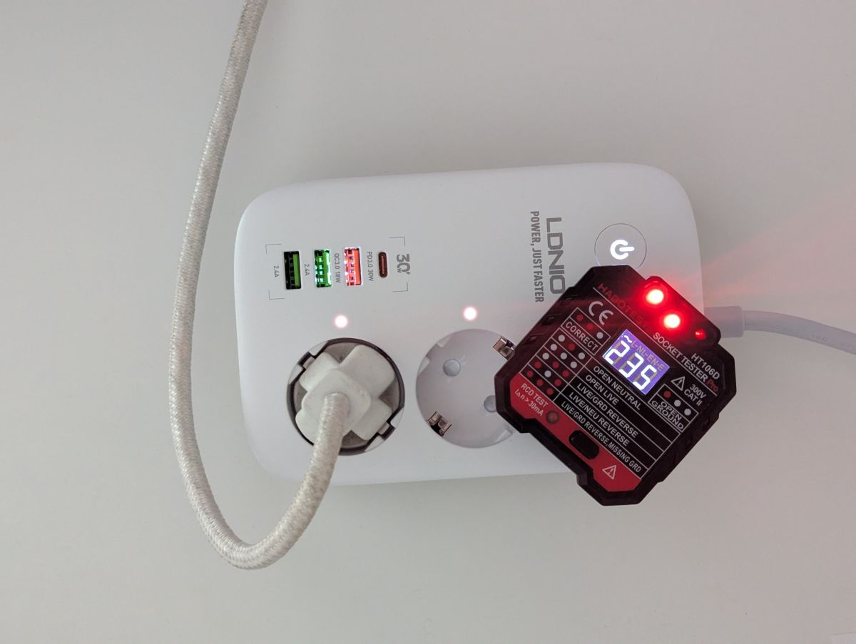

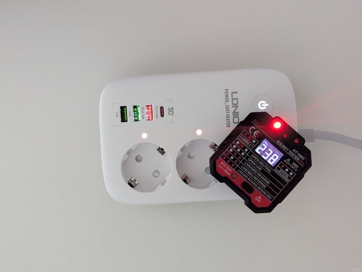

    From the pictures of the interior I deduced that only one track is disconnected. By design it should be the L, but if we have the reverse arrangement in the socket then the N will be disconnected and the L will remain on all the time. Measurements with the Habo tester confirmed this. I was expecting this to happen, but it was not a problem for me, as I planned to plug the strip into sockets with a circuit adapted to the strip. More worrying was a check of the so-called earthing action. The tester showed that it was not connected on two of the three sockets. Pictures of the test below. One red diode on the left-no earthing. Two diodes-correct connection.
    Socket tester inserted into power strip shows no grounding on one socket Socket tester shows missing ground in powered LDNIO power strip Socket tester plugged into LDNIO power strip showing 239V and one red LED lit
    I thought I had come across a faulty unit and decided to clarify this with the seller who is also the importer. I described the situation and received the following reply:
    (...) for this strip, please use the following connection order: first connect the cable/device to the first grounded socket (pin/PE). Once plugged into this socket, the earthing is transferred, also to the other two sockets, so they can be used normally.
    We recommend that you always start with the earthed socket and only then connect further appliances to the other sockets.(...)
    I checked. Indeed if you plug any receptacle into a "grounded" socket you gain grounding on the others.
    Socket tester connected to LDNiO power strip shows one red LED on the left
    For me, such an action is unacceptable. I have not opened the skirting board, but from the photos of the interior I can see that the part with the PE plates is not permanently connected to the base of the skirting board and the cable. The connection is made when the skirting board is screwed together, there are two contacts that connect and the lack of a plugged-in device causes a lack of pressure.
    I decided to send the strip back. You could try to solve the problem by replacing the current connection with an additional wire. I have decided not to do this.
