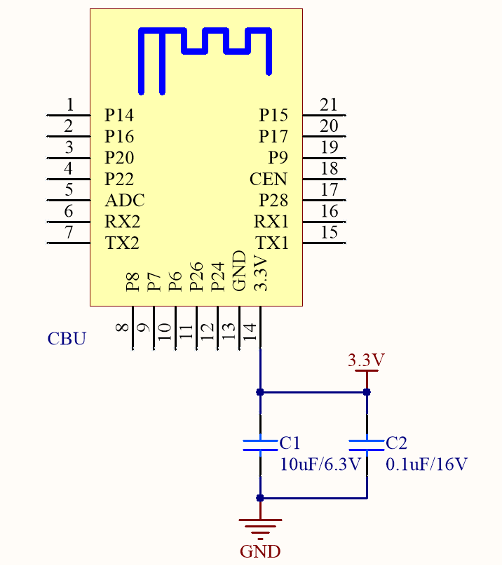

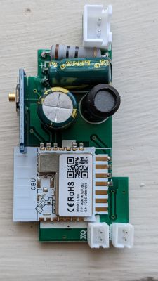

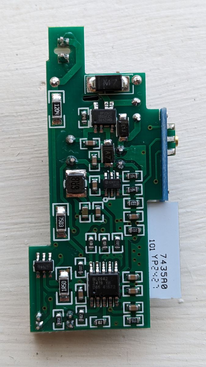

    I recently purchased (September 2024) a Tomzn TOB9-VAP which is a 63A (1U din mountable) wifi relay with VA protection and metering.
    I purchased it under the assumption that I was going to flash it (via cable) using the information shared in this post https://www.elektroda.com/rtvforum/topic4000770.html#20853888 but it appears that the number of pins on the main chip has changed and I'm not sure what the pinouts are now (I'm a programmer who is quite inexperienced with electronics)
    Can anyone help me to understand which are the GND, 3.3V, TX and RX pins on the chip?
    Tomzn TOB9-VAP relay with power button and Wi-Fi markings.
    Tomzn TOB9-VAP module with a chip and connectors on a circuit board.
    Image of a Tomzn TOB9-VAP WiFi relay circuit board with electronic components.

    Not sure I see what the differences are. Your device still has a CBU module
    Diagram of CBU module connection with capacitors.

    >>21228643
    @divadiow thanks for that! The schematics I had seen previously showed a CBU with 24 pinouts.
    https://templates.blakadder.com/tomzn_TOB8-63WiFi.html
    And in my haste I had miscounted the ones in the image on the post I previously referenced. Do you mind sharing a link to where you found the schematic you shared?
