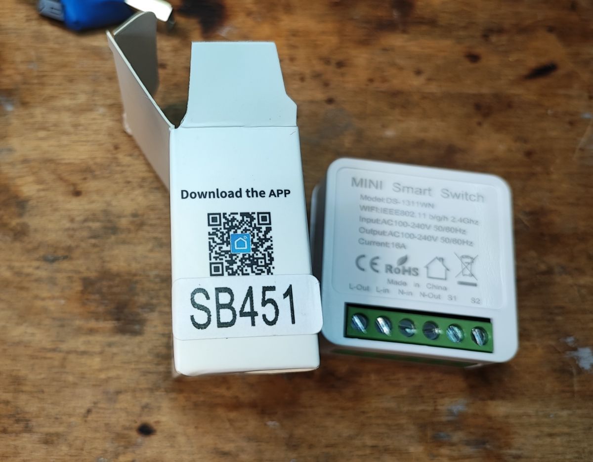

    Today we are taking a look inside a fairly new "smart switch" relay, dated 2023-10-05 on the PCB. As standard here, I will show its construction and change its firmware to make it free from the manufacturer's servers. The product itself from this topic resembles the already discussed ZN268131 , but is an updated version of it, among other things the old WB2S has been replaced by CB2S. The whole thing is available to buy in many shops and often under other names, so look at the pictures.
    First - the packaging:
    Smart Switch Module packaging on a wooden surface, featuring Amazon Alexa and Google Assistant logos. Side of smart switch relay packaging with specification markings. .
    The set is quite poor:
    Packaging and smart switch SB451 with labels.

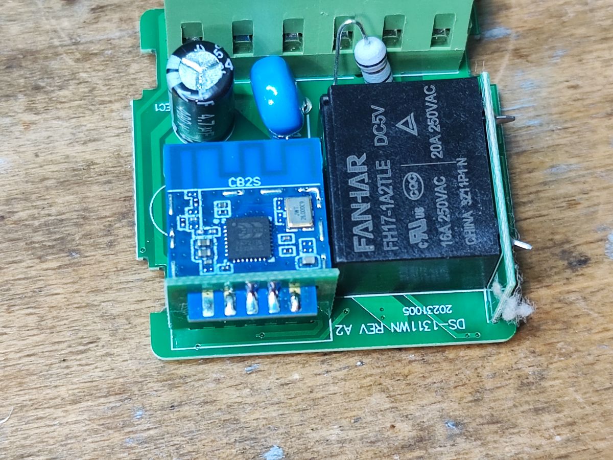

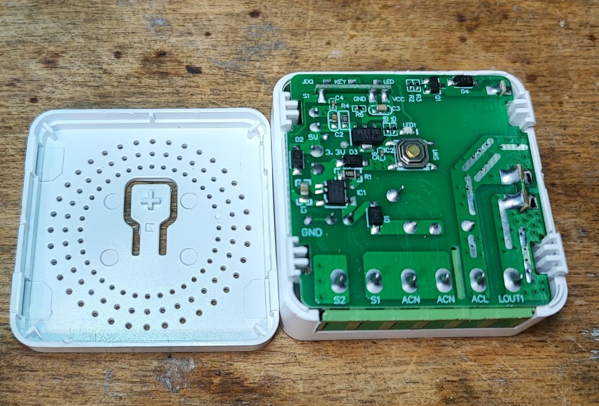

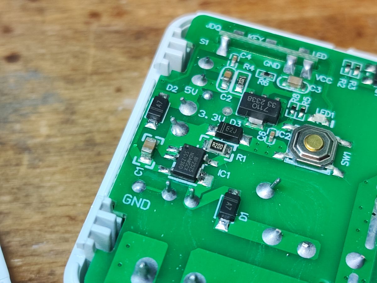

    Now the interior:
    Close-up of the interior of a smart switch with a PCB and visible electronic components. PCB of a smart switch relay with visible components. Close-up of the printed circuit board inside a smart switch relay. .

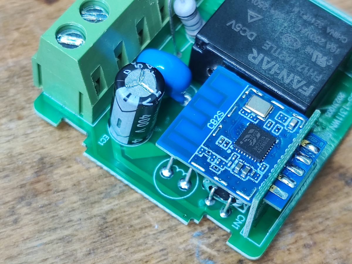

    I don't see much change, in the linked older version of this product sat the AP8506, here is the BP2525 (classic), the rest similar.
    Image of the interior of a smart switch relay with a CB2S module on the circuit board. Close-up of the inside of a smart switch relay with a CB2S component on a PCB. Interior of an electronic relay with visible capacitors. .
    Here we have the FH17-1A2TLE relay at 5V (it is powered directly from the BP2525), the CB2S itself is powered from a 3.3V LDO.
    Of surprises, we also have a varistor present here - this is an exception, it is often overlooked.

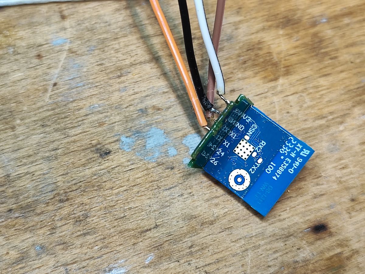

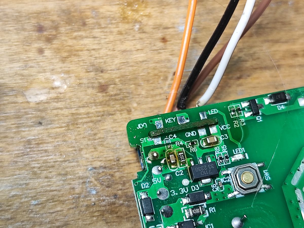

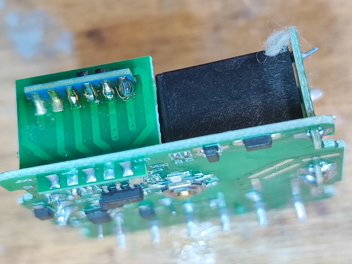

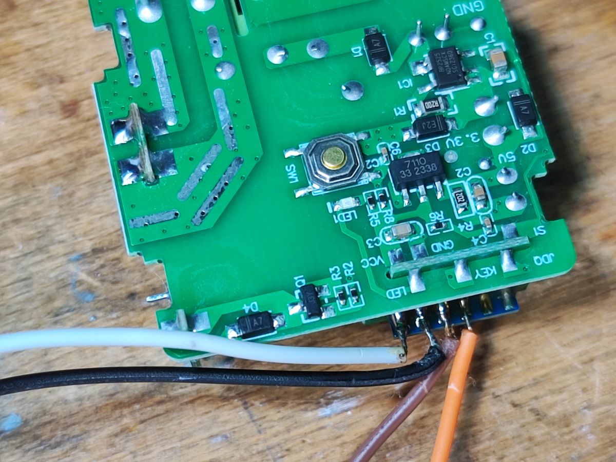

    According to the flasher instructions - you need to solder the power supply, RX and TX:
    One would like to solder to the CB2S pad without removing it:
    Smart switch relay with CB2S module on a PCB View of the interior of a smart switch relay with CB2S module. .
    But that won't work. You need to desolder the CB2S, flux and braid will help:
    Close-up of a PCB with electronic components and colored wires. .

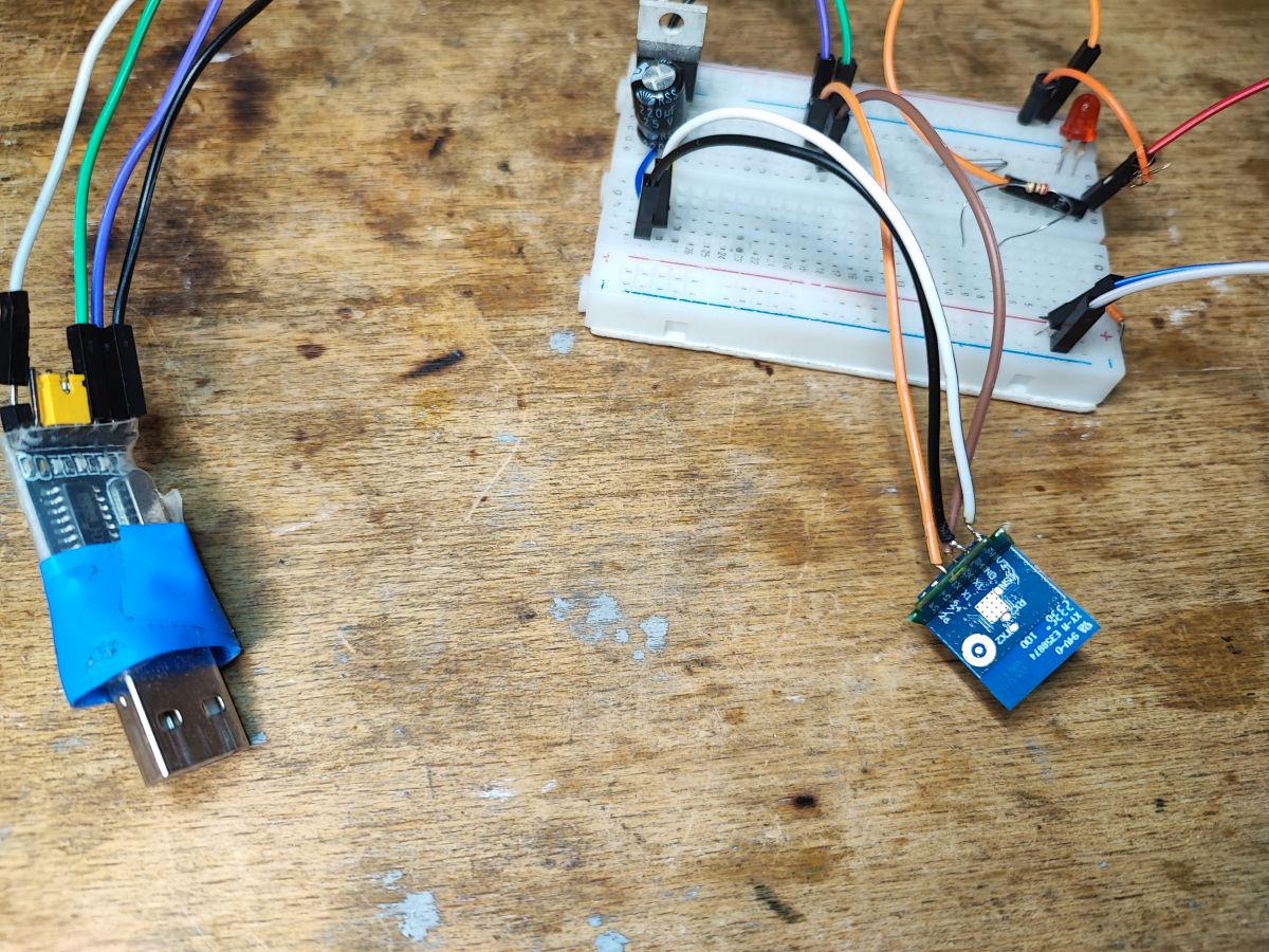

    Here's my whole circuit, together also with the 3.3V LDO (I'm using TC1264-3.3V, but you can use any or even take 3.3V from NodeMCU or Arduino):
    CB2S module PCB with soldered wires Printed circuit board with relay connected to a breadboard on a table. .

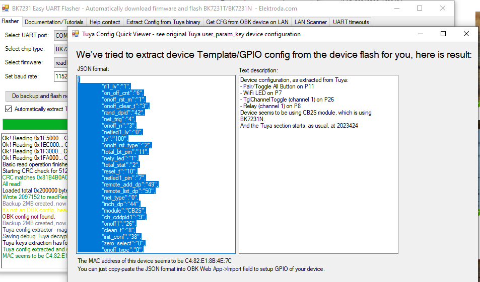

    When reading the batch, my flasher correctly discovers the Tuya configuration:
    Screenshot of firmware flashing software displaying JSON configuration. .
    JSON Tuya:
    Verbal description:
    Device seems to be using CB2S module, which is BK7231N chip.
    - Relay (channel 1) on P8
    - WiFi LED on P7
    - TglChannelToggle (channel 1) on P26
    - Pair/Toggle All Pin on P11
    OBK template:
