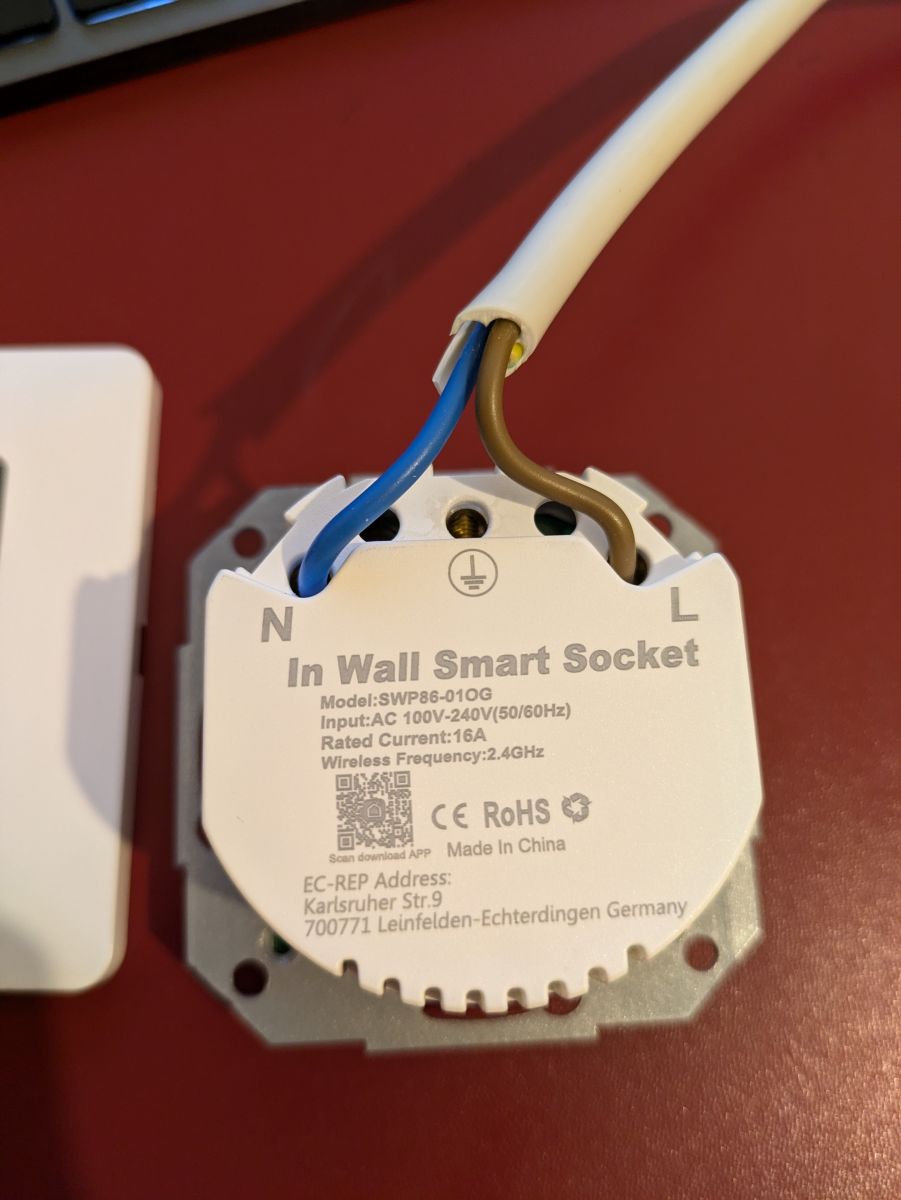

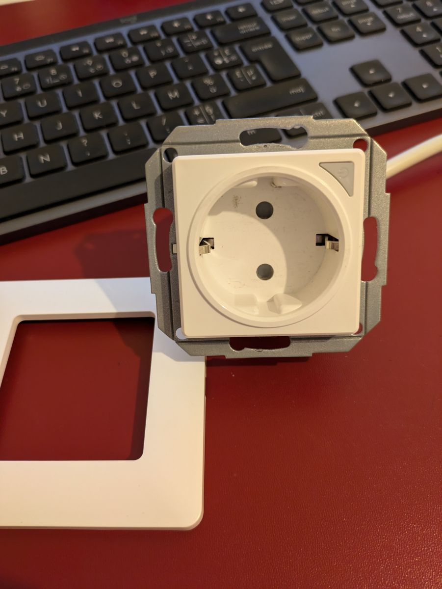

    Hi, I'm sharing my device that I just successfully flashed. It's a wall socket without a power monitoring module and based on the TW-02 chip. There are other variants, see below.
    View of a white wall socket against a keyboard background. Close-up of a smart wall socket with W600 chip.

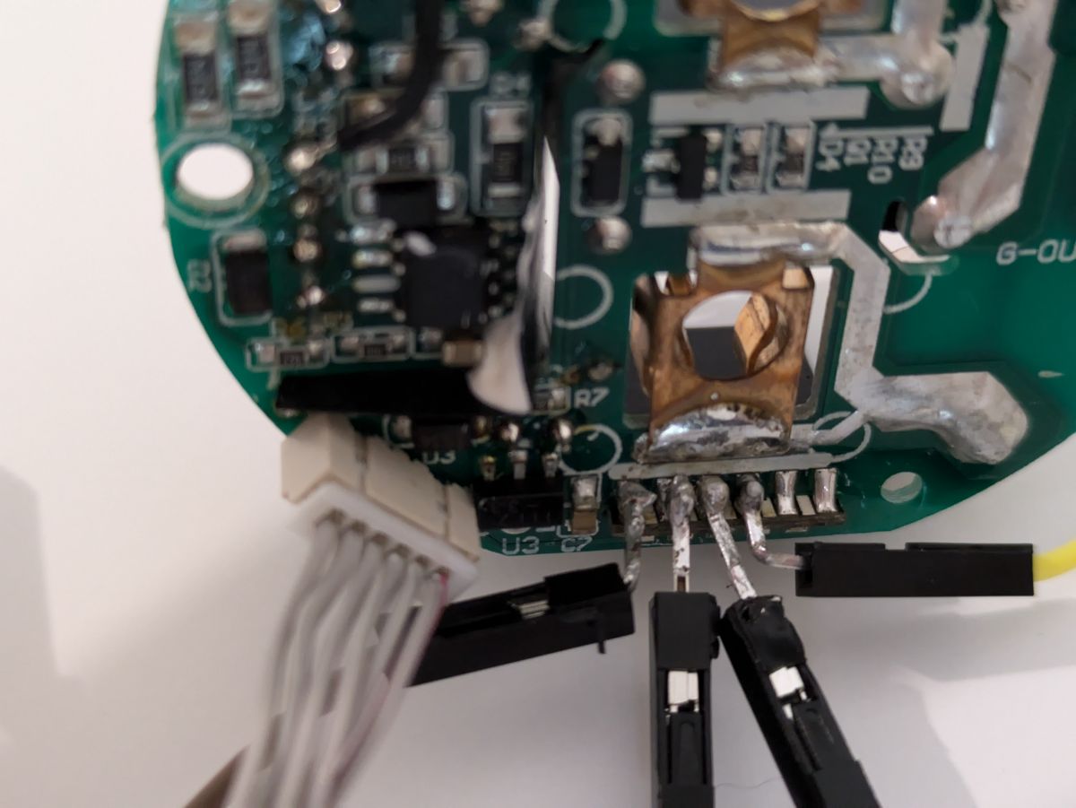

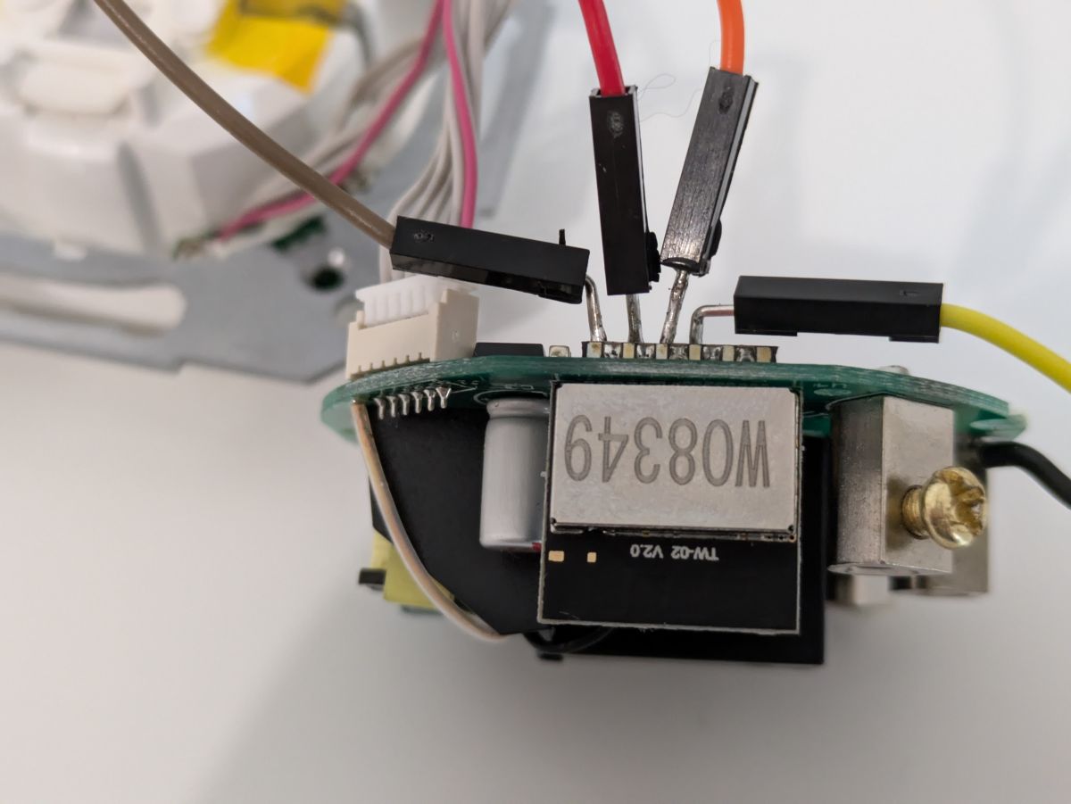

    I flashed 3 of them using soldering. Usually, I prefer the no-soldering method with Cloudcutter, but this time I had no choice (Tuya firmware v1.2.0).
    Close-up of a circuit board with connected wires for programming. Close-up of a wall socket's internal circuit with soldered wires.

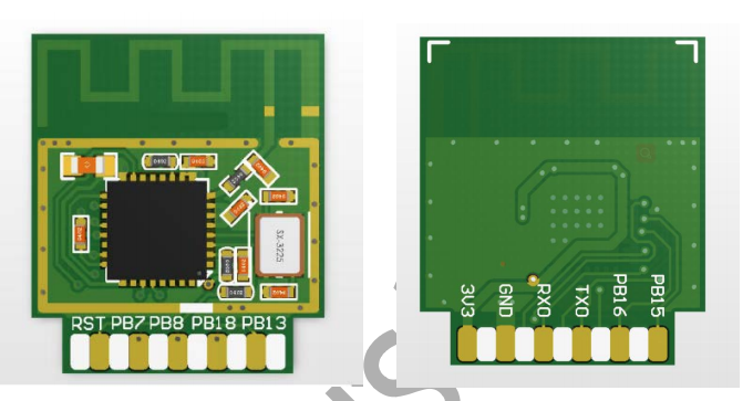

    Two views of the TW-02 module's circuit board.
    So for flashing, I experimented 2 methods, both successful:
    - Method 1: the w600tool Link . It's command-line based and only accepted .img files:
    w600tool.exe -p COM9 -u OpenW600_1.17.721_gz.img -b 115200
    - Method 2: with the Upgrade Tools Link . only accepts `.fls` file.
    Note: To start the writing process, briefly connect the GND to the RESET pin.
