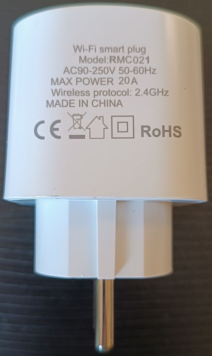

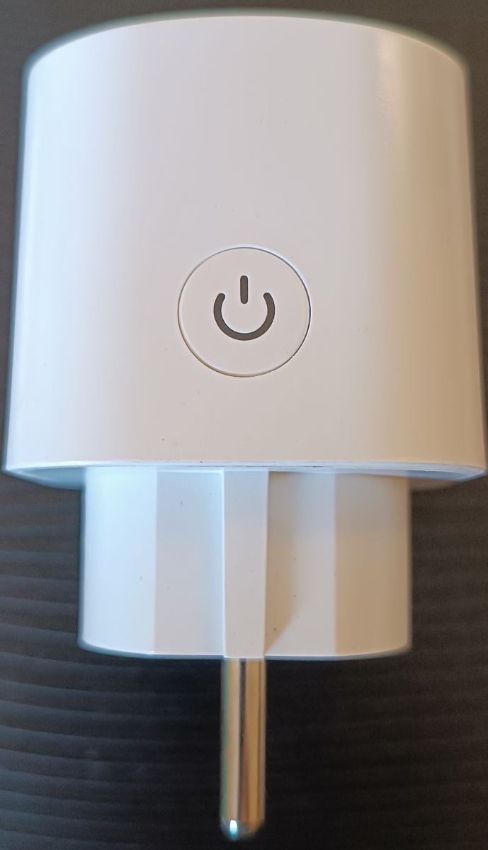

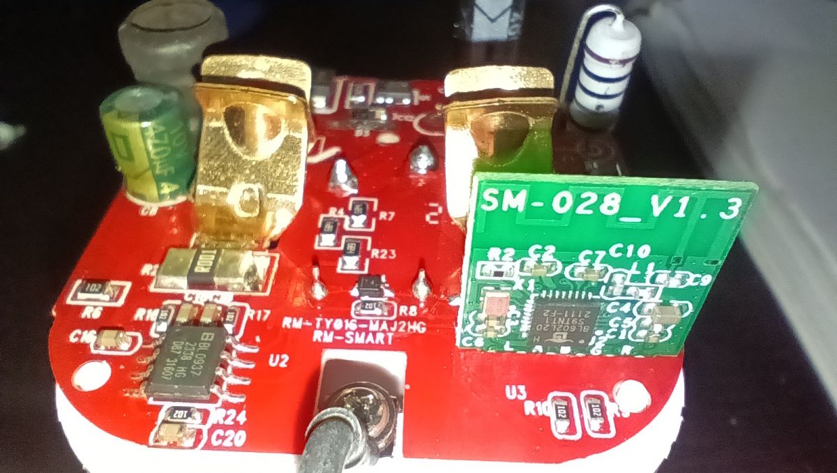

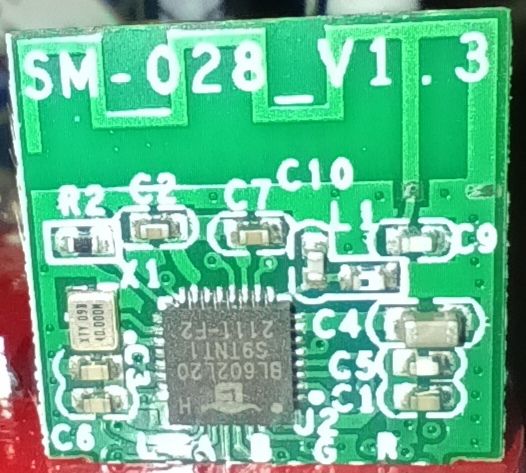

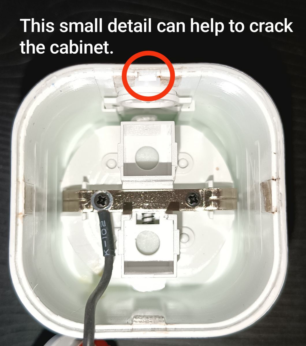

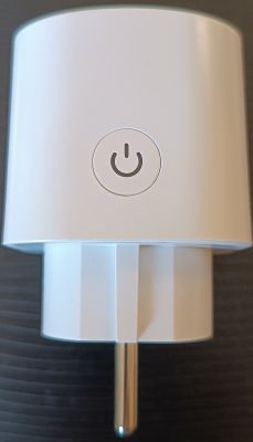

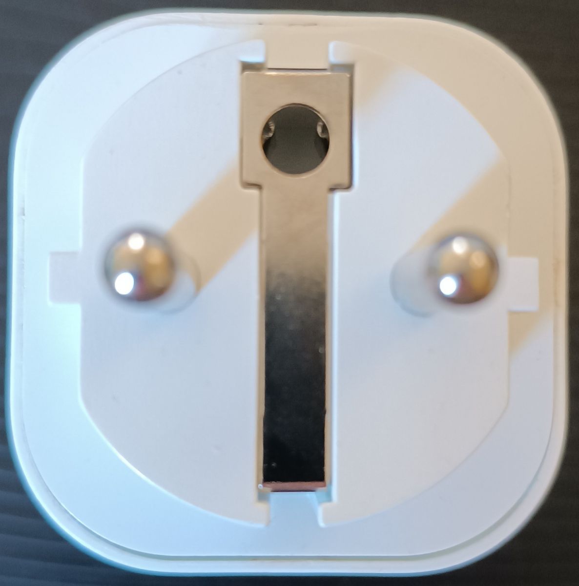

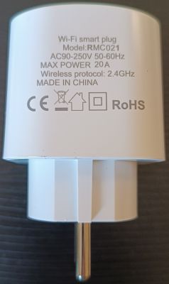

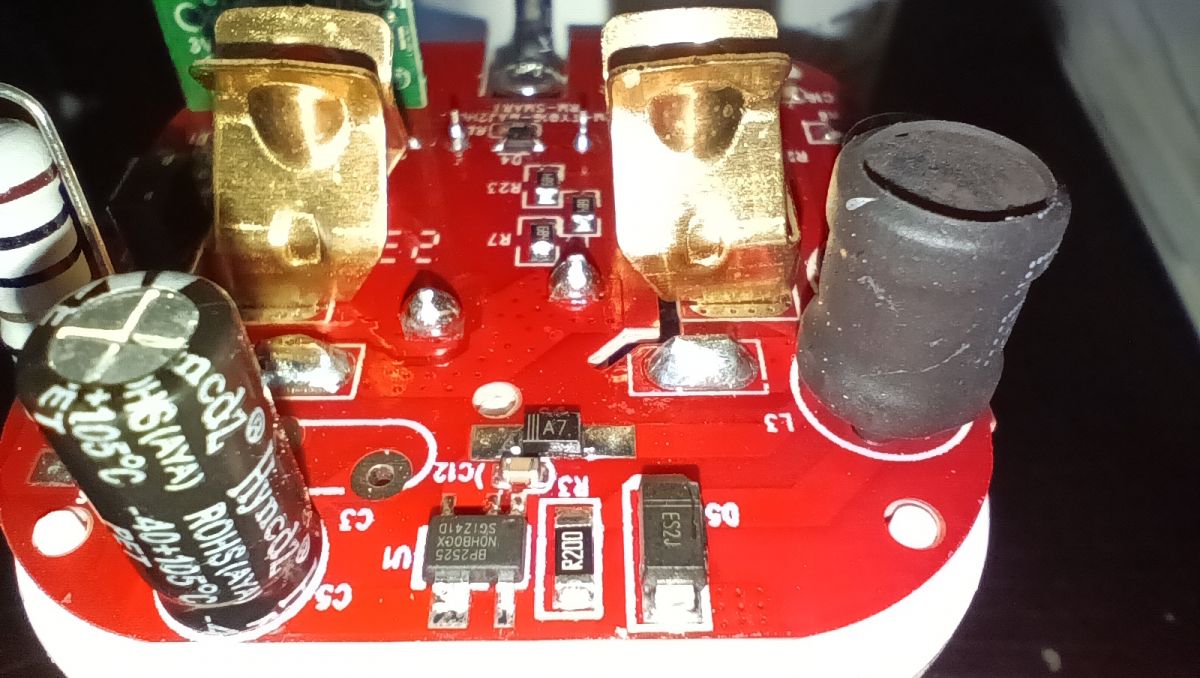

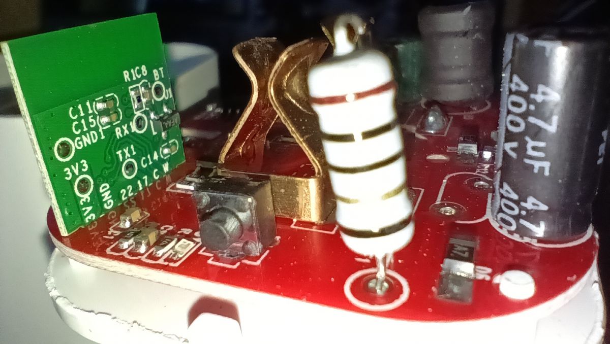

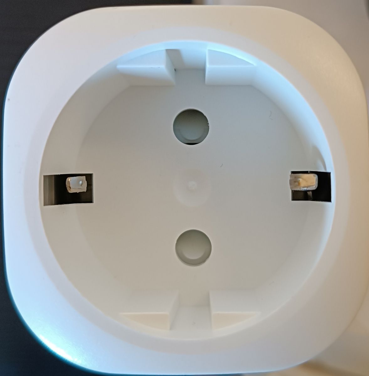

    It seems I got a device that board is not listed here?

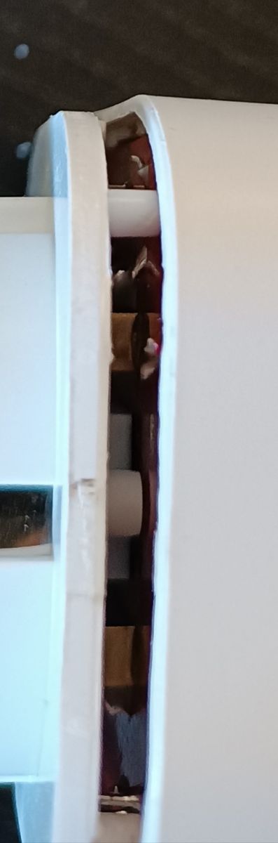

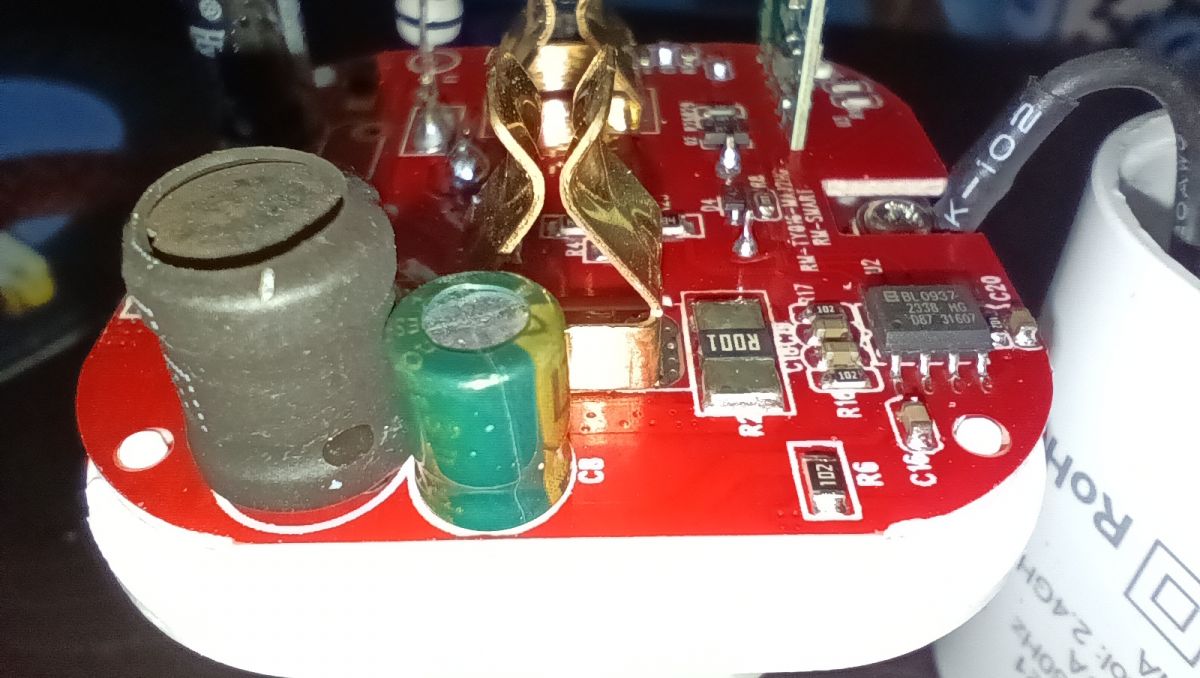

    If it is, admin please delete it. Wi-Fi smart plug model RMC021 with technical specifications on the casing. White smart plug with a power button in the center. Close-up view of an electrical socket. Network adapter with an electrical plug. View of the interior of a device with a detail circled in red and text indicating that this detail can help open the cabinet. The image shows a close-up of a white device with visible internal components. Small green printed circuit board labeled SM-028_V1.3 with various components. Close-up of a printed circuit board with electronic components on a red background. Close-up of an electronic module with components like resistors, capacitors, and buttons on a red circuit board. Close-up of a circuit board with various electronic components. Close-up of electronic components on a red printed circuit board.
  • #2 21155316
    Posts: 14755
    Rate: 12880
    It looks like another BL602 module. I can see that required BT pin is on the back of the module. Have you tried to flash it?
  • #3 21155476
    150219v8
    Posts: 46
    Yes I flash it successful.
  • #4 21155482
    Posts: 14755
    Rate: 12880
    This device seems to have similiar module:
    https://www.elektroda.com/rtvforum/topic4063490.html
    But it's not the same, so good find. Maybe @divadiow can check as well.
    Do you have @150219v8 a template for your device? JSON format
