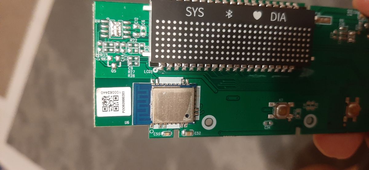

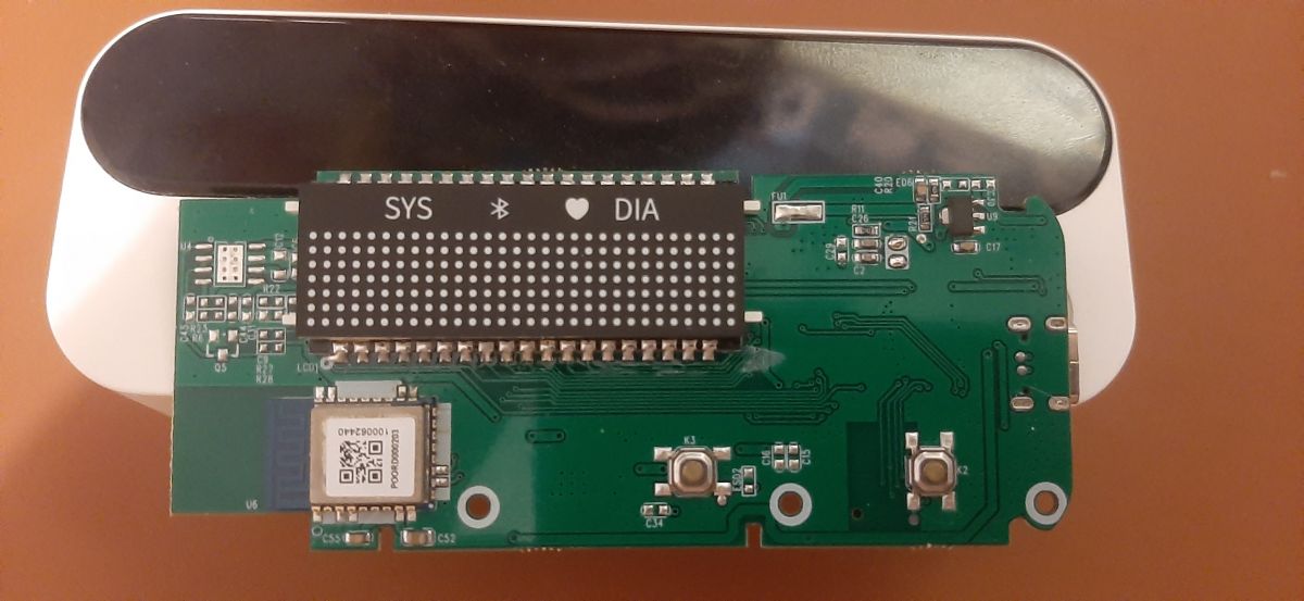

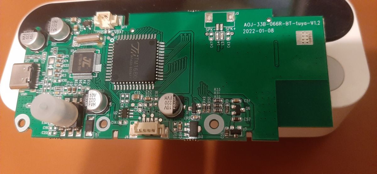

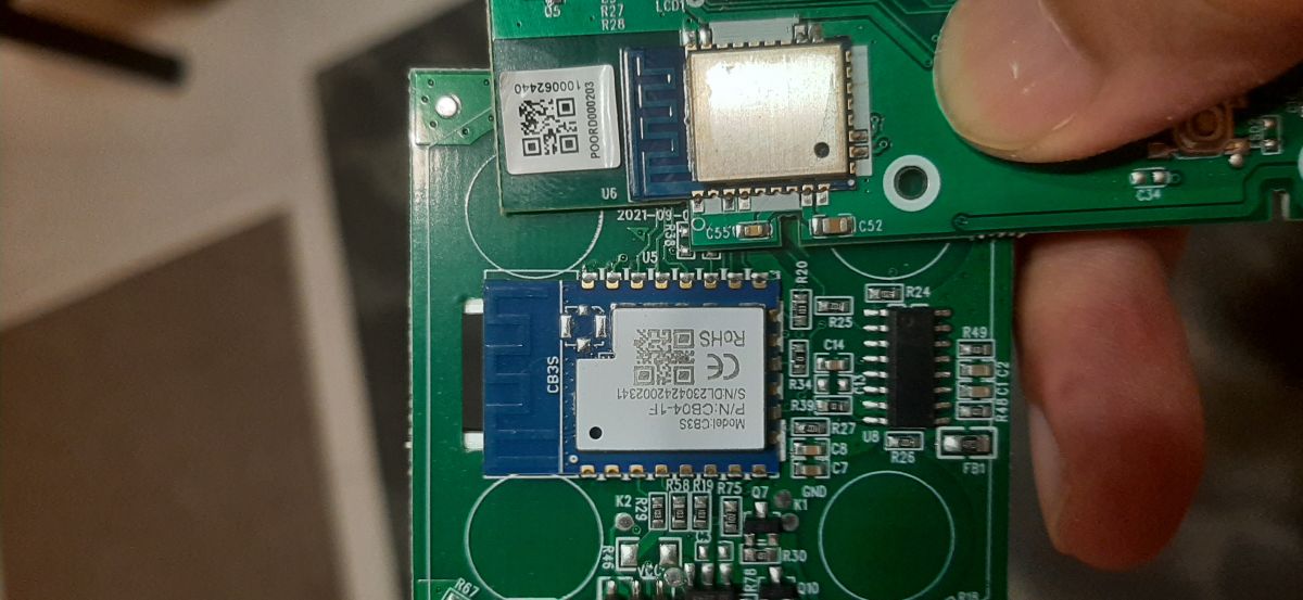

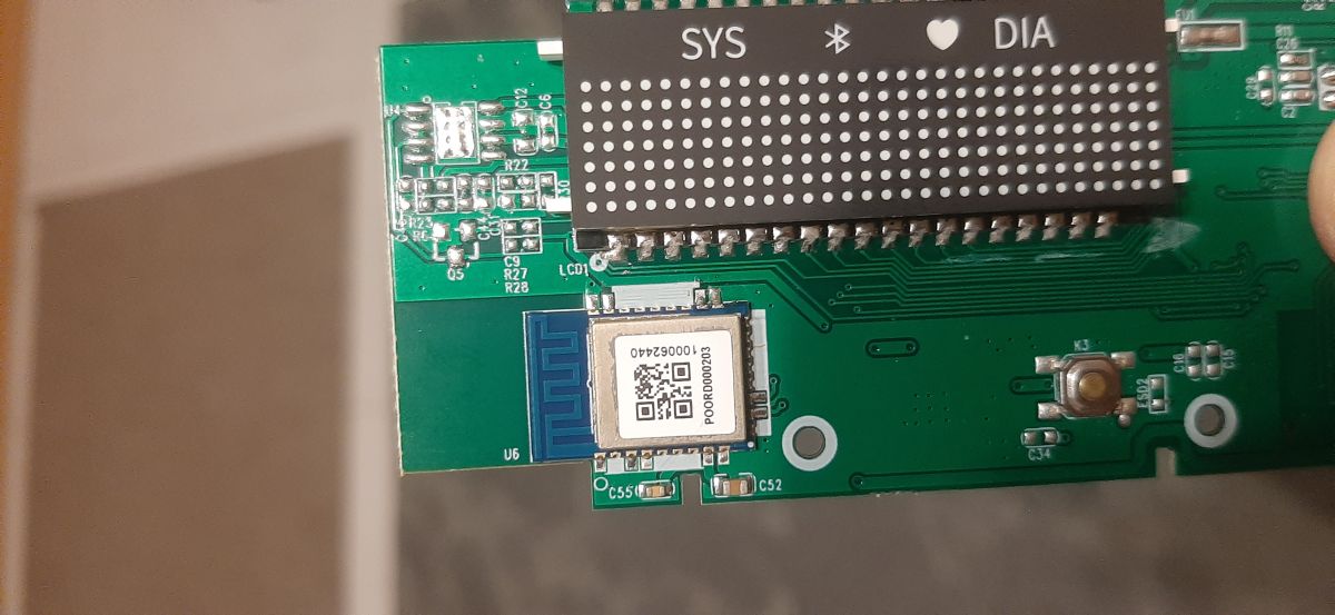

    Circuit board with electronic components of a TUYA blood pressure monitor. Circuit board with electronic components, including a BLE module and LED display. TUYA blood pressure monitor circuit board with electronic components and LED display. Close-up of a pressure monitor circuit board with a BLE module and LED displays. Electronic module with TUYA marking on a circuit board, visible components and connectors.
    This is a TUYA blood pressure monitor and I'm trying to get the readings via BLE. It is smaller than the usual ones found in the switches, anyone seen this before?
  • #2 21281085
    Posts: 14763
    Rate: 12893
    Can you remove the metal shield and tell which MCU is used by this wireless module? Is it Beken?

    If you are sure that it's bk3432, there is no need to remove the metal shielding.
    By the way, removing metal shielding does NOT Break the device, if done correctly.
    Still, we didn't do any work on BK3432 yet. We would need to first try available SDKs, like:
    https://github.com/Cdreamyao/tuya_ble_sdk_Demo_Project_bk3432

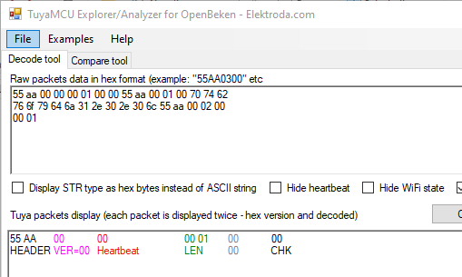

    The device transmits to the BK3432 using 9600bps UART
    Added after 5 [minutes]:
    Every time I power up, it sends this to the BK3432
    55 aa 00 00 00 01 00 00 55 aa 00 01 00 70 74 62
    76 6f 79 64 6a 31 2e 30 2e 30 6c 55 aa 00 02 00
    00 01
    Then if I quickly power it off, it sends 0x00
    Any idea what this protocol is?
    Added after 18 [minutes]:
    Found https://images.tuyacn.com/smart/aircondition/Guide-to-Interworking-with-the-Tuya-MCU.pdf

    partially decodes as a heartbeat
    Screenshot of the TuyaMCU Explorer/Analyzer program showing raw packet data in hex format, partially decoded as heartbeat.

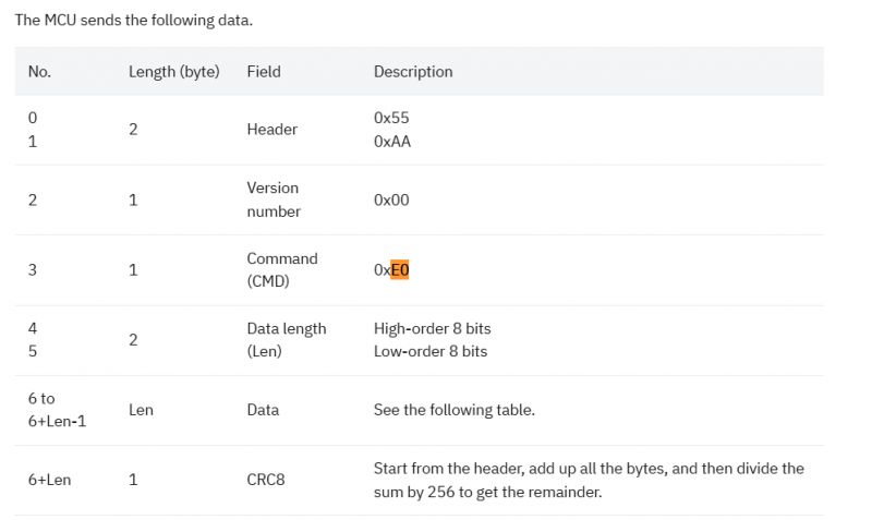

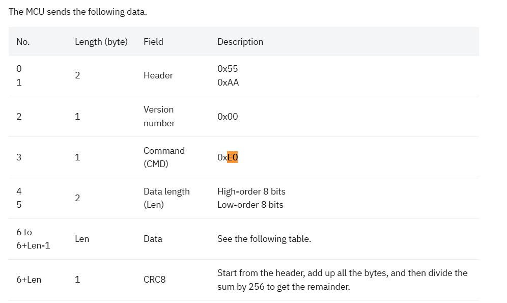

  • E0 report frame and DP cache limits noted
    #14 21285412
    Posts: 14763
    Rate: 12893

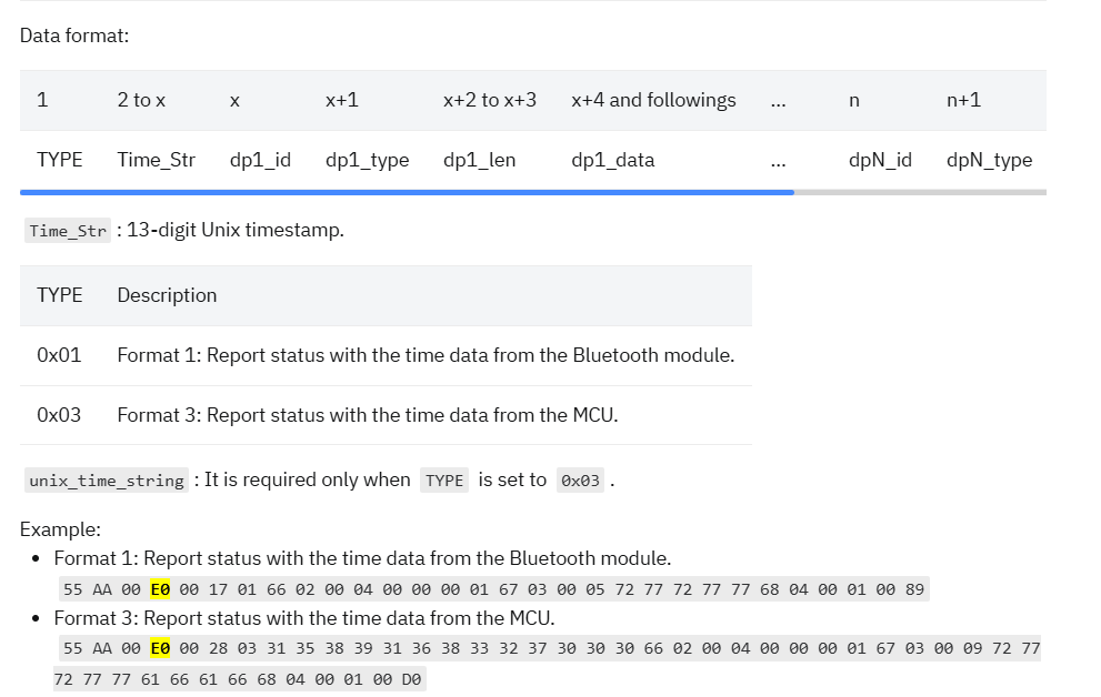

    This may contain some data:
    Received by WiFi module:
    55 AA 00 E0 00 30 033137333032383033363330303001020004000000880202000400000055030200040000004A04010001000904000100 F6
    HEADER VER=00 Unk LEN 033137333032383033363330303001020004000000880202000400000055030200040000004A04010001000904000100 CHK
    0xE0 may mean it's a Report record-type data (0xE0) command.
    See: https://developer.tuya.com/en/docs/iot/ble-do...ock-mcu-development-overview?id=K95l67wf9xopf
    - If the module is offline when receiving reported data from the MCU, it will save the data to its flash memory and send the stranded data after going online. After the last piece of stranded data is sent to the cloud, the module will release the cache.
    - The module can cache up to N pieces of DP data. When the limit is reached, the newest record will overwrite the oldest one.
    -> The nRF52832 and BK3431Q based modules can store up to 80 pieces of data, with a maximum length of 200 bytes per piece.
    -> The BK3432 based modules can store up to 32 pieces of data, with a maximum length of 32 bytes per piece.
    - The time drift of the module’s internal clock is less than one minute in 24 hours. The module will sync its clock with the server time each time it is connected to the cloud. If you require highly accurate time, you can report data using the MCU’s timestamp.
