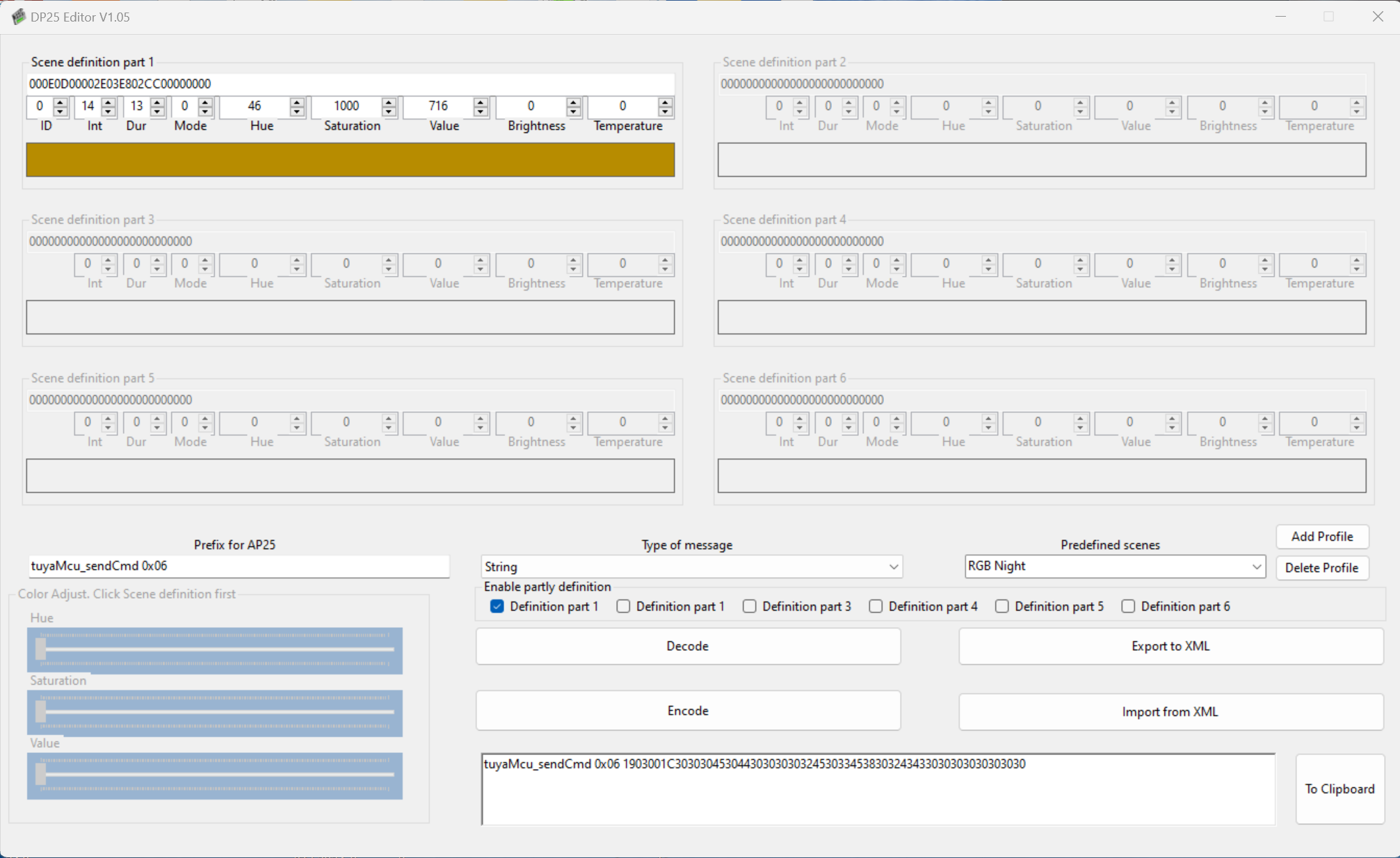

    A small explanation for this tool.
    It is for designing DP25 profiles. This is related to Tuya RGB(CW) scenes. So a series of different colors.
    A DP25 message can have 6 parts. The message has to follow rules to be generated. Tuya has published it as light function specification.
    https://developer.tuya.com/en/docs/iot/product-function-definition?id=K9s9rhj576ypf
    My devices only accept the messages be coded as string. When the message is accepted, the MCU repeats the received message (see log window)
    The tool supports definition of the needed message
    The tool can split a hex string into the parameters. --> decode
    The tool builds a hex string based on the parameters. --> encode
    The tool can generate up to 6 color definitions per scene
    The tool supports add, delete, import and export of profiles using XML (datasets.xml). DON'T delete it.
    The tool supports color definition in hsv format using trackbars
    The tool will show the resulting color
    The message can be copied to clipboard.
    Use WebAPP / log from OpenBeken inside of the device to send the message
    sample string generated:
    tuyaMcu_sendCmd 0x06 1903001C30303045304430303030324530334538303243433030303030303030
    Screenshot of the DP25 Editor V1.05 tool for designing profiles
    This tool has to be taken as it is. No support. Play around and try it.
    Regards
    DP25Edi...zip (182.54 kB)You must be logged in to download this attachment.
