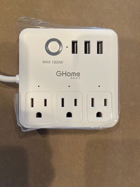

    I bought a GHome WP9 on Amazon.

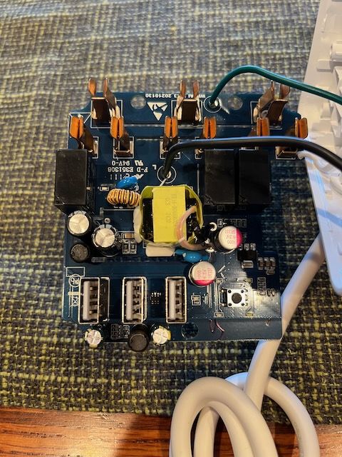

    - It has a relay for the USB switches, though they're controlled as a unit.

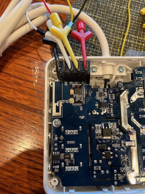

    - It presents nice, big, accessible pads for v3.3, GND, RX and TX on the edge of the circuit board when you remove the back.

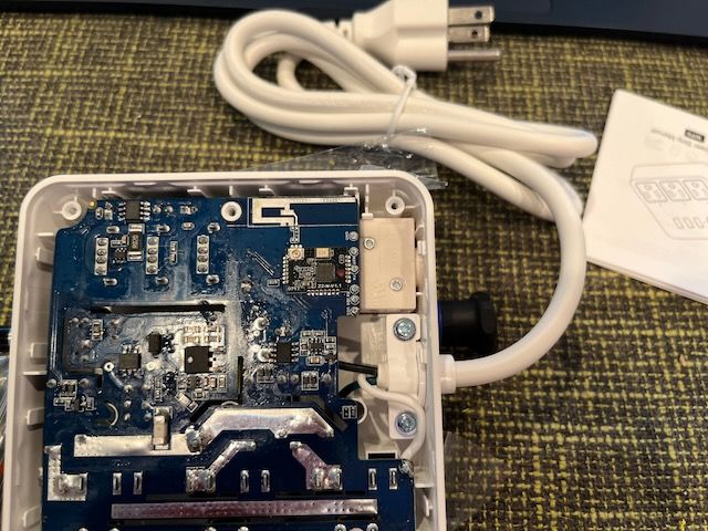

    - It uses a Z2-N-V1.1 module.
    - That module contains:

    I whipped up a 3d-printed pogo pin jig to keep things simple, shared:
    - here on Thingiverse; and
    - here on Printables.
    Both include the CadQuery source code, an STL file, the `.bgcode` for my Prusa Mini, and a link to the pogo pins I used.
    Flashing was easy:
    - Position the jig and hold it firmly.
    - Insert USB UART into laptop.
    - Run `ltchiptool -v flash write ./OpenBK7231N_QIO_1.17.739.bin`
    - Wait until `ltchiptool` prompts for a reset, then disconnect the power lead, wait a second, then reconnect it.
    - Wait patiently for the upload to finish.

    There's also an LED on pin 8, but if I try to set is as an LED it messes with the one on pin 7. I'm confused...
    Note: The Tasmota device page for this device warns about reversed polarity on middle and right plugs. All of the plugs on my device pass muster with my little plug-in circuit tester.
