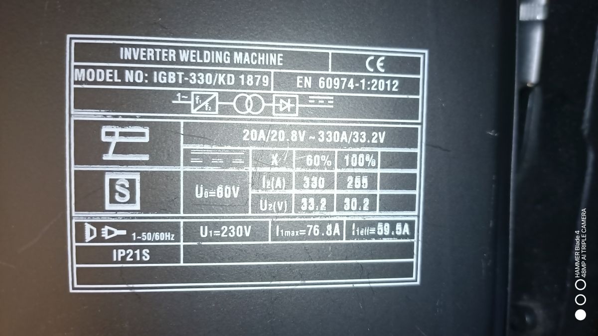

    Would a colleague be kind enough to upload a photo of the nameplate, of the described welder?

    Please, a photo of the 'plaque':
    Nameplate of an inverter welding machine with blurred text. .
    The photo is not moved. only the lettering is so blurred.

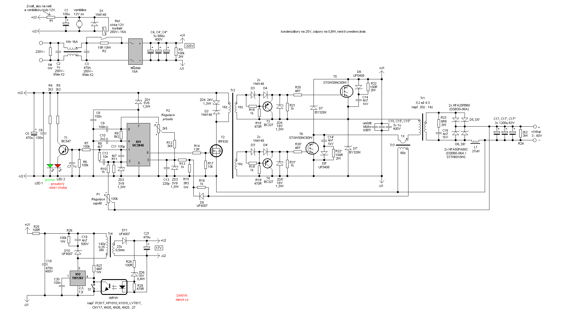

    Low price. I wonder how much work it would take to convert such a welder into a booster by lowering the maximum output voltage to 14 volts?

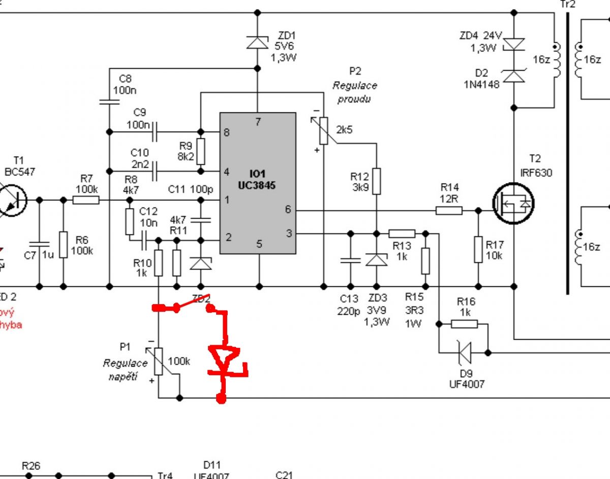

    In my opinion, it is enough to add one Zener diode. Obviously in the case of the diagram below.
    Circuit diagram showing an electrical circuit with power supply and Zener diodes. .

    The output voltage is determined by the divider R10 P1 / R11.

    Yes, I know. And I would include a Zener diode there with an additional switch. I don't trust potentiometers in this type of device.
    In this case, the issue is simple. Most cheap welders don't have voltage regulation, but in practice there is always a point in the circuit which, when shorted to ground or some other potential, stops the keying. Sometimes an optocoupler may be needed.
    Circuit diagram with a modified connection. .

    No point, you would have to be sure what dynamic resistance the Zener diode has for a given voltage and current.
    Simpler to use a resistor if you don't trust potentiometers.
