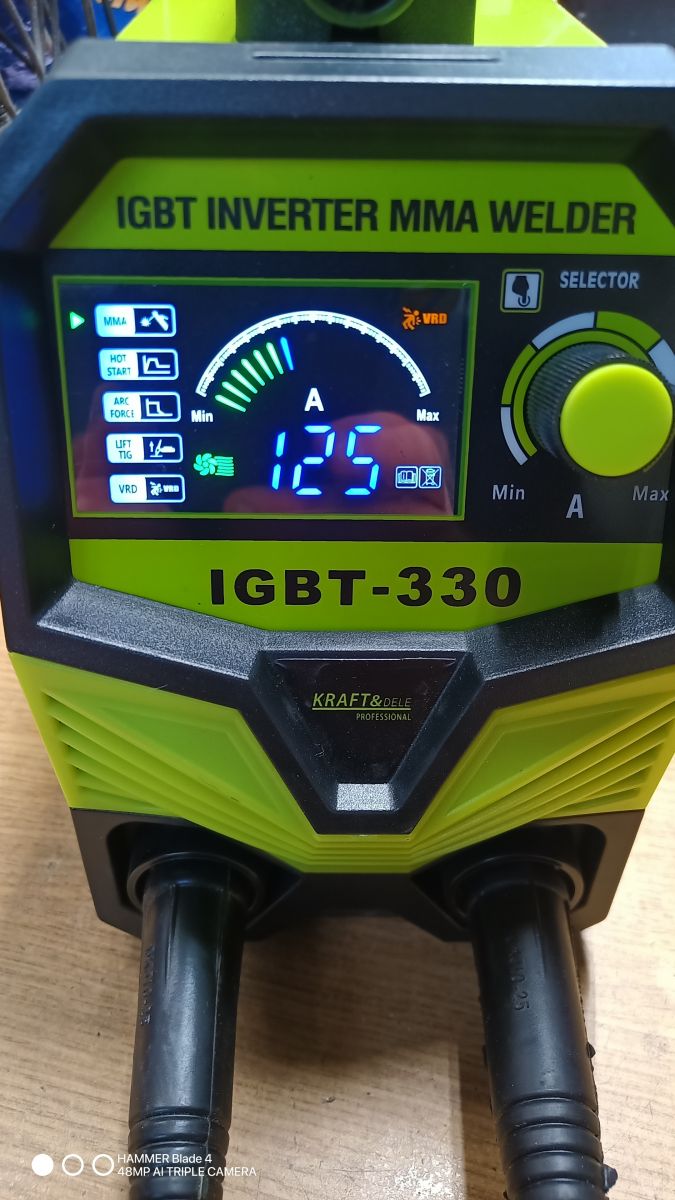

  • Hello.
    A few days ago a colleague sent me a link to a well-known auction site leading to a welding machine for less than PLN90. I don't think anyone with a bit of technical imagination could be so naive as to believe in the miraculous performance of the device. However, I decided to sacrifice the equivalent of 5 packets of cigarettes and buy this marvel marked KD1879.
    IGBT-330 inverter MMA welder with display and control knob.

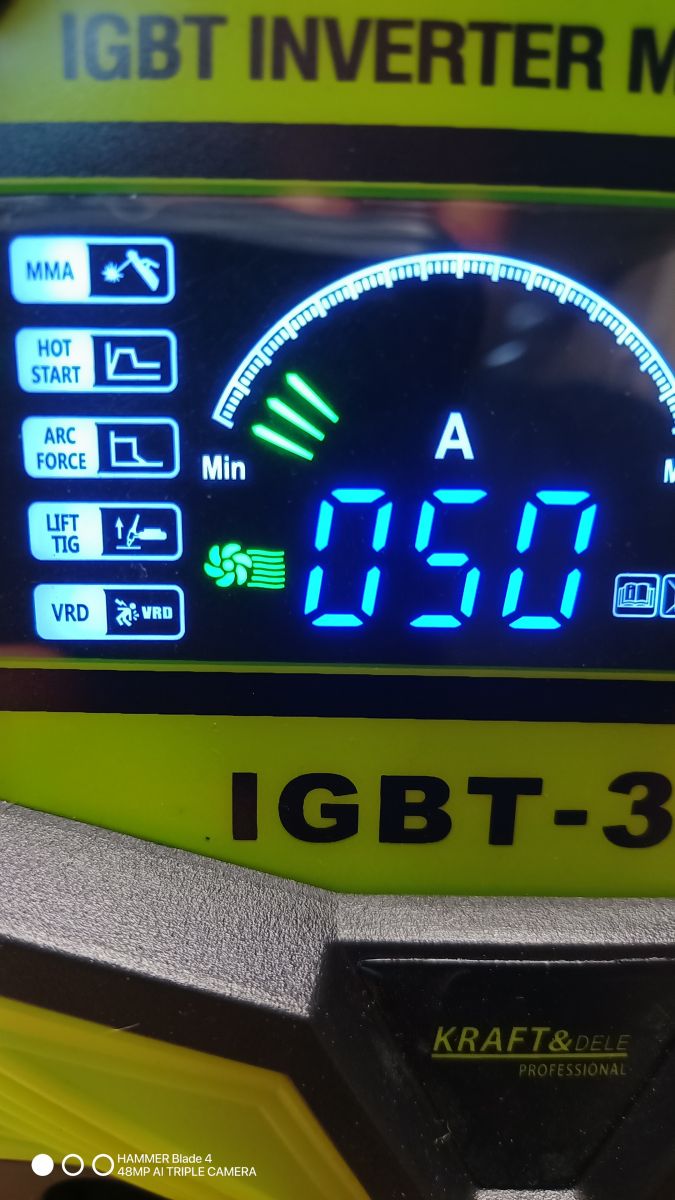

    The inscription IGBT-330 and the parameter declaration in the manual suggest that this is the maximum welding current at 60% cycle. I don't know if measuring with digital clamps would be reliable with such distorted waveforms, so I let it go for a while and focused on the purely functional qualities. First, of course, I took a closer look at the device.
    IGBT-330 inverter welder with a digital display set to 125 amps.
    Close-up of IGBT-330 welder display showing current parameters. Welder display showing a reading of 50 amps and welding mode icons. Welder display showing a reading of 50 amps and welding mode icons.
    The display is very easy to read and changing parameters via the push-button encoder is convenient. I then turned my attention to the leads, pleasantly soft and long enough. The electrode terminal holds firmly, as does the ground terminal.

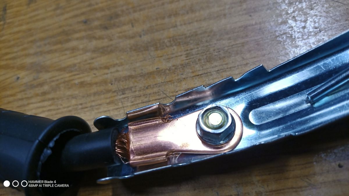

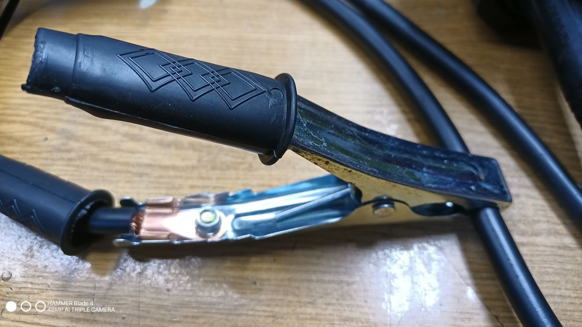

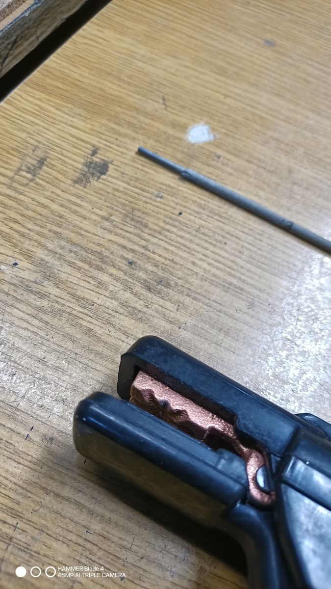

    Close-up view of an electrode clamp with a copper wire in the KD1879 welder. Close-up of a welding machine's ground clamp on a wooden table. Close-up of a black electrical cable with TUV H01N2-D 1X12mm² markings on a wooden surface. Close-up of a cable labeled H05VV-F 3x1 mm². .
    Welding clamp on a wooden table. .

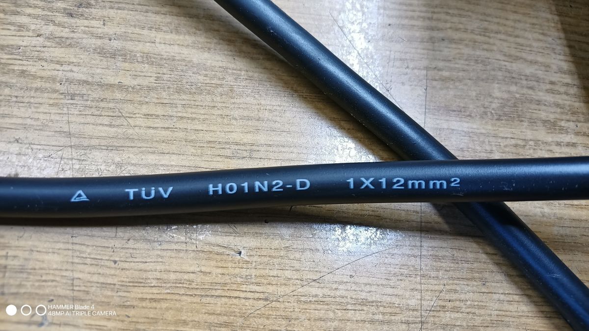

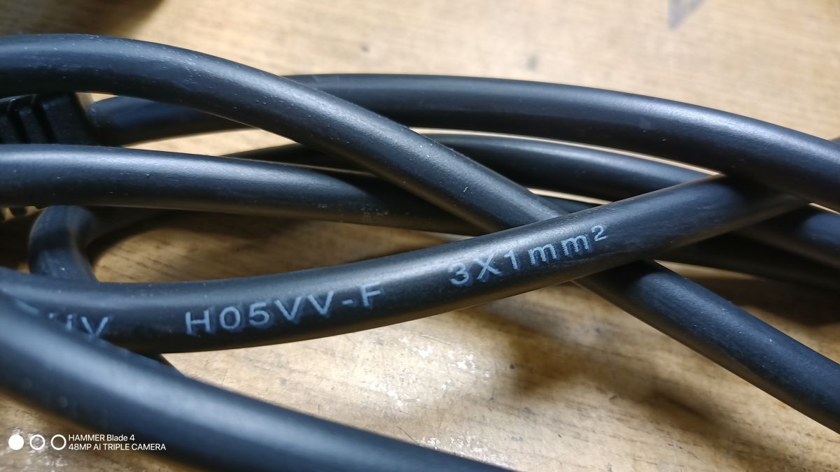

    The wires have a wicked cross-section, but they are copper. In my opinion, for this type of device the absolute minimum is 16 mm² on the secondary side and 3x2.5 mm² on the primary.

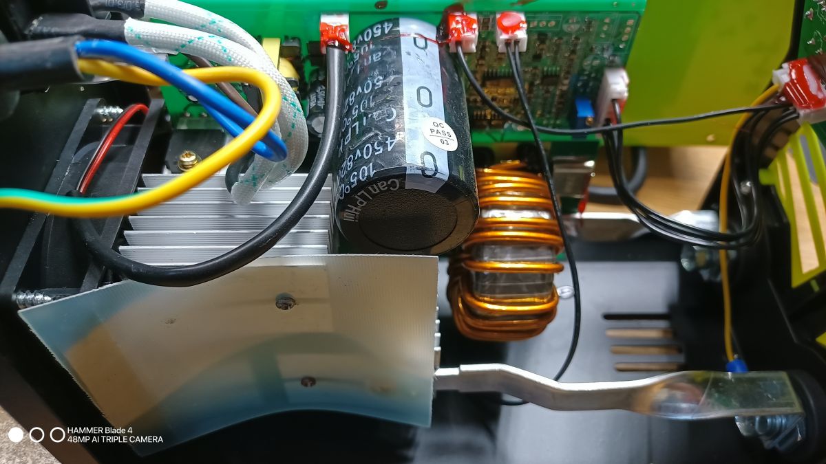

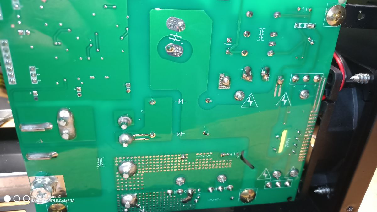

    Inside the welder you will find nothing interesting. Here, copper has already been abandoned in favour of aluminium both for the current leads and for the choke.
    Image of the interior of the KD1879 welding machine showing electronic components and wires. Close-up of a green printed circuit board inside a welding machine. .

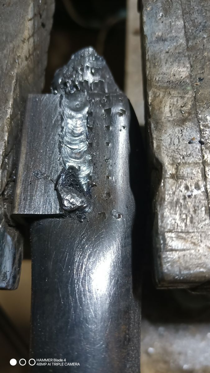

    I am absolutely not a welder, no one has taught me to weld in my life, I've sloughed off maybe 2kg of electrodes, so I don't feel competent to comment on the end result. To the question of whether it works? Yes, it welds somehow.
    Close-up of a weld on a metal pipe, showing signs of unevenness and cracks. .
    Finally, impressions:

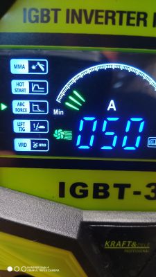

    1. I have to set a higher current than in the old Dedra 160A to get the same melt with the same electrode. I will do this weld on the photo (2.5 mm electrode) with the Dedra at a setting of 70-80 A, here I had to set 125 A, which makes me think that we are dealing with "Chinese amps".
    2 Either the non-contact arc ignition doesn't work, or I don't know enough. This is the first welder with this feature I've got to, so maybe I'm doing something wrong.
    3. the welder is extremely handy, lightweight, and so if it doesn't fail too quickly I'll be happy to take it on away jobs for those reasons. Of course, we're talking about simple jobs (on fences, gates and other lightweight structures) that I can handle myself without calling in a professional.

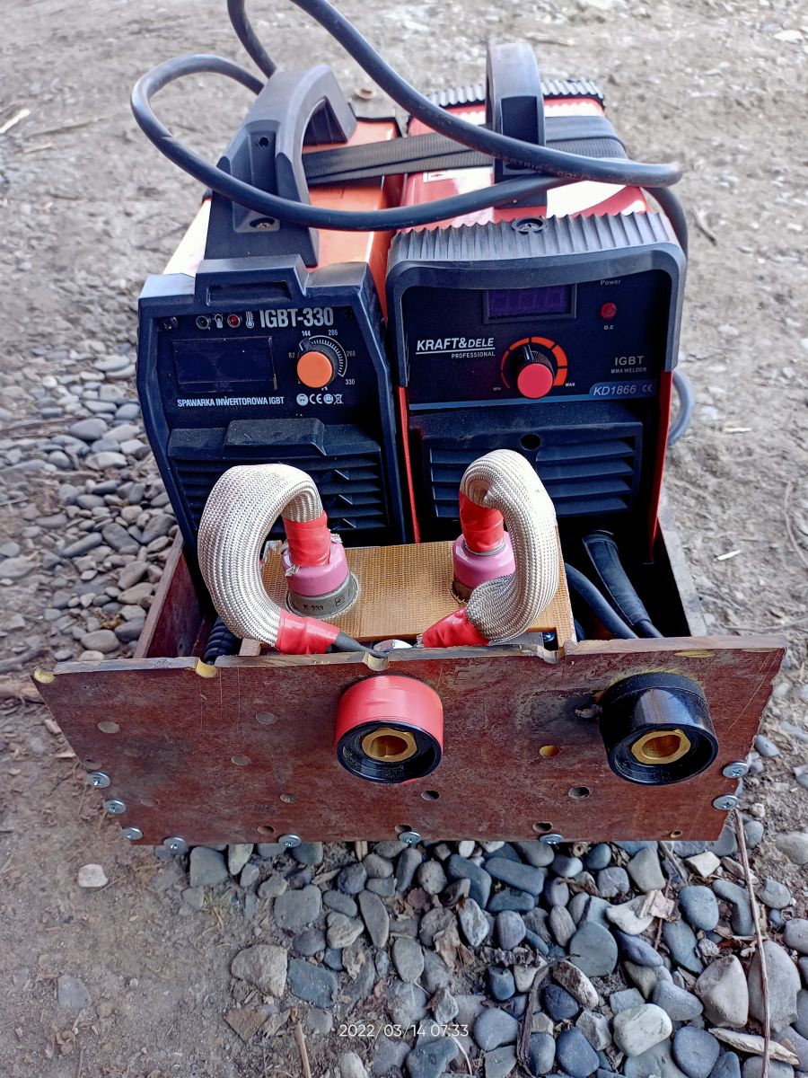

    A little short of amps, I decided to purchase another one, but the same one was no longer available. I acquired a similar one, it turned out to be the same inside, I connected two in parallel on the plus side two russian diodes two minus directly to ground. The result max current 280 A, from the mains slightly goes beyond 25 A.
    Two inverter power sources IGBT side by side, with different labels on the front panels. .

    In total the whole thing cost me PLN300, a negligible cost, I moved the cables from an old 35mm welder. I have to say that in a dual configuration it works well. I would also add that the sound when welding is quite a loud swish, always on some construction site my colleagues would accost me as to what kind of equipment it is that gives so much.

    >>21262994 You probably don't need the diodes, they are galvanically separated on the secondary.

    I admit that such a topic was not expected. Is the author sure that the wires are copper and not just copper plated? Such welders have 120-140 A maximum. These functions on the display are probably a pic of water. The display is just to attract the customer in this product.

    The first thing you need to do with a cheap welder is replace the welding leads, as they are aluminium.

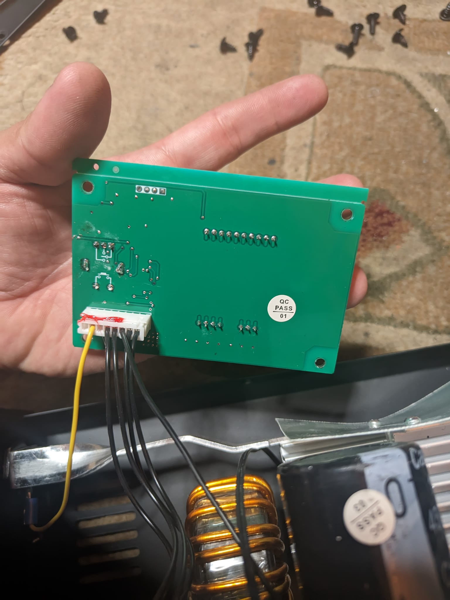

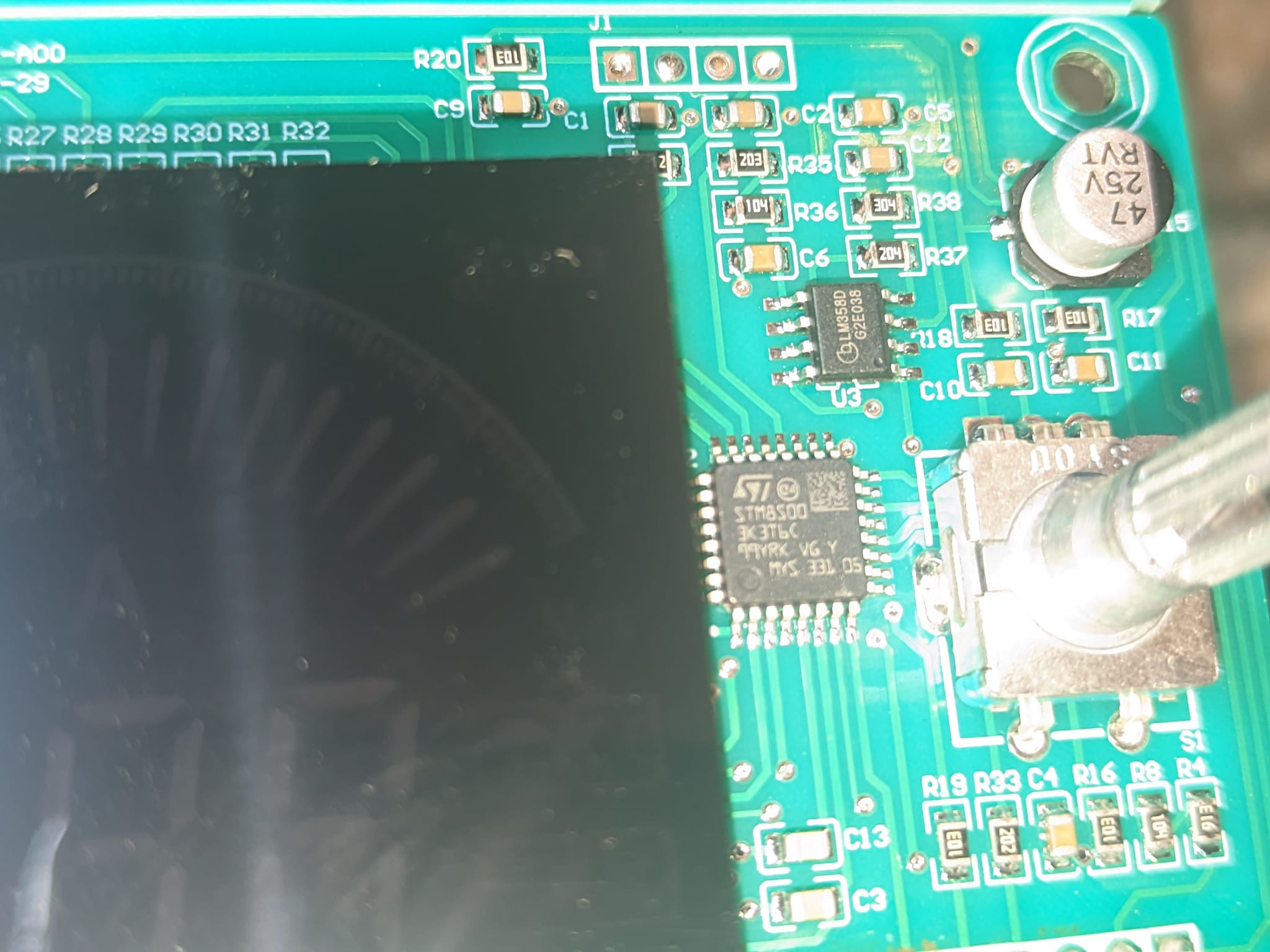

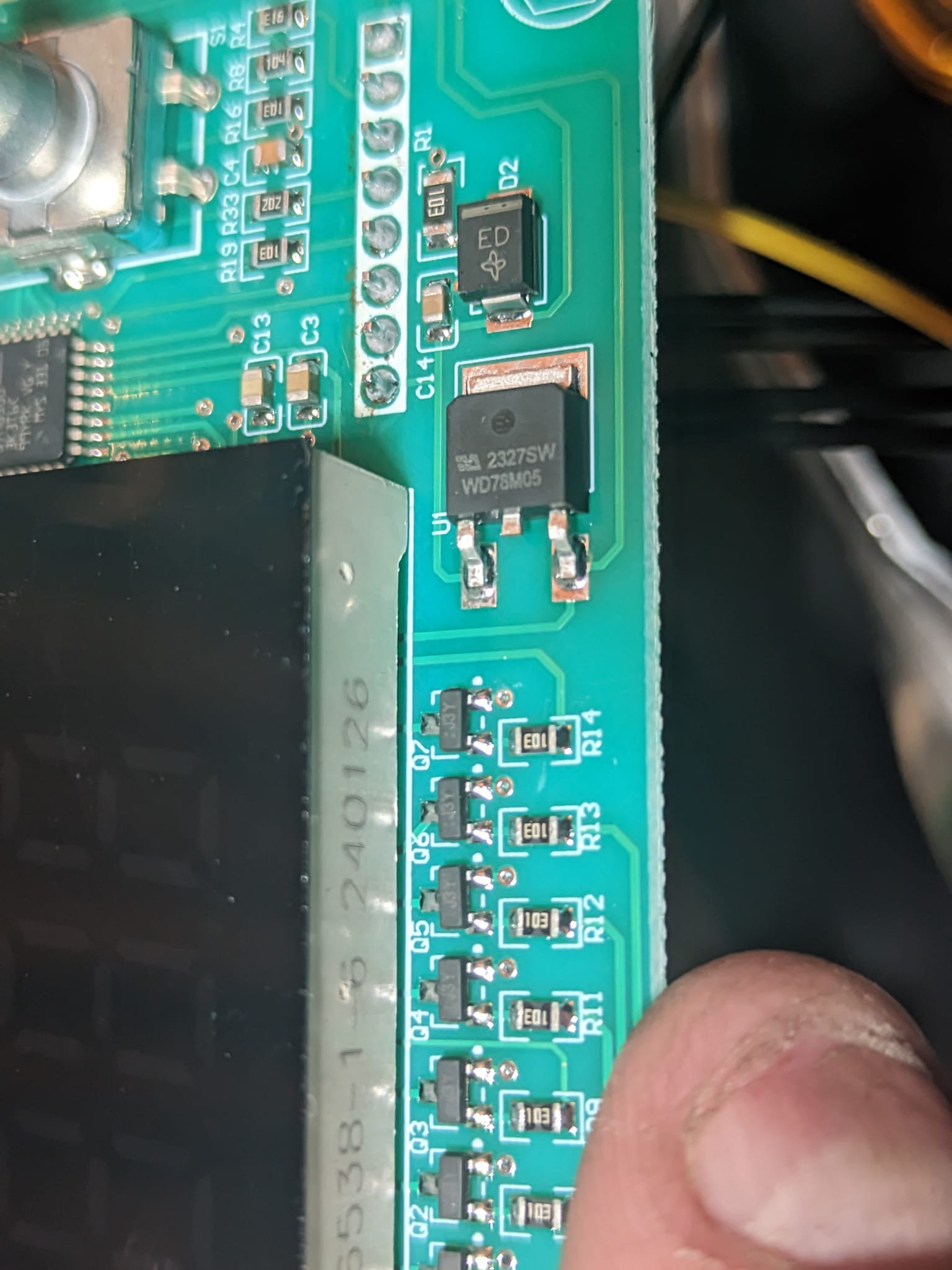

    I will add from myself that in the display sits STM8S003, stabilizer and encoder (+ small thing) however it looks a bit like there is a measurement (yellow wire)
    Obviously a motherboard based on the SG3525A.

    2. Either the non-contact arc ignition doesn't work, or I don't know enough. This is the first welder with this feature I've gotten to, so maybe I'm doing something wrong.
    There is no such thing on this welder.

    I have not mentioned at all the details of the construction of the electronics itself. The main inverter works in push-pull topology, the secondary winding is also split so that we have two double diodes on a common heatsink (cathodes connected). Plus an auxiliary inverter for the logic. I won't give you the names of the semiconductors because I didn't want to dismantle the device that much; moreover, everything is generously varnished, which effectively discourages reading their symbols. Well, but there is nothing to reinvent the wheel.
    A classic layout in this type of device. Number of keys and rectifier diodes kept to a minimum. Transformer minimalist too, but what to expect from a device priced at a set of decent keys and diodes for these claimed amperages.
    Minimalist cables no wonder, as the price must be low. To tempt the customer there must be fab displays and 'paper' parameters.
    Used occasionally and stored away from moisture it is likely to work.
    The ground terminal looks "very professional" not to mention the place where the ring terminal with the cable is screwed on - the seller forgot to add the covered handle heating function....

    The wires are copper, I distinguish copper from copper plated ones made of aluminium, steel or fibreglass (because I have seen those too). But the cross-section is as I wrote. What is aluminium is the wire on the choke and the connections between the board and the output sockets. The ground terminal obviously brings to mind Chinese starter wires, but it's actually much stiffer and with a stronger spring. Surely if I were to use it on a daily basis there are many things that could be improved.
    Regarding the aforementioned starter wires, a colleague calls them tongue-in-cheek 'safe'. They can be short-circuited or connected the other way round and no mishap will occur, apart from the possibility of getting your hands hot with them. :)

    Nothing to complain about, at least they have used capacitors from the renowned Can LP Hui company, if it fires it will. ;)

    I was also thinking of connecting cheap welders in parallel. They are basically current sources so theoretically no extra treatment is needed. You can connect via external chokes that are not inside.
    There is also rather nothing preventing you from connecting to different phases.

    Replacing with decent wires in cheap Chinese kits always helps a bit. They give there aluminium wire painted and it looks like copper because of this it is light and flexible. Real cable has a stiffer cross-section and weighs more. I myself also have a cheap Kraft 330 welder which gives different values on the display than it should, only when I measured with a clamp meter do I know that the max amps are up to 140.
    You would probably need to set something in the display to make it indicate correctly. Bad parameters result in poor and ugly welds. Cheap stuff has that, but for amateurs they are just fine.
