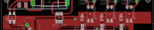

    Electrical schematic for an irrigation controller with ESP8266. Wiring diagrams of an irrigation controller on two colorful PCBs.
    Power supply. .
    I based the power supply module on the LM2675M-3.3 chip, which is popularly used. I had picked it up on the forum for several projects.
    The purpose of the module was to convert 24V AC to 3.3V DC, which is needed to power the ESP8266. The device is powered by 24V AC because this is the rated current to be supplied to the solenoid valves.
    I made the module as a cross between information from DS and archived threads where user @-RoMan- and advice given to me by user @ArturAVS.
    The power module has two protections. The first protection is a 1A polymer fuse on the path that goes to the rectifier bridge, the idea is to not let too much current into the inverter.
    The second protection is a 1A fusible (cylindrical) fuse that protects the solenoid valves. I don't expect to use more than one valve at a time, so this protection is more than OK (the coil current of my solenoid valve at start-up should not exceed 0.5A, and 0.2A during operation). Possible additional protection is software prohibiting the actuation of more than one valve.
    . Control of 3 24V AC valves
    Controlled by optoMOS relays (Panasonic AQY212).
    The control is done with SSR optoMOS relays (Panasonic AQY212). I used them because the technology in which they are made guarantees galvanic separation between the board circuit and the valve circuit.
    They are controlled from three pins of the ESP8266 chip. These pins are also used to illuminate the buttons, so a high state of a pin illuminates the diode in the relay (and closes it, consequently activating the valve) and illuminates the diode in the button on the case. Cool effect.

    Detecting if current is actually flowing through the valves (using ACS711)
    As stated above, there may be a situation where there is an order to splash water and at the same time there is a disconnection of the solenoid valve circuit by the rainfall sensor. I detect this situation with a Hall sensor (ACS711 chip). It is plugged into the solenoid valve circuit and it measures the current in this circuit, the analogue measurement from this sensor is passed to the ESP8266, and this pin it with the ADC (pin A0). .
    With this function I detect a "RAIN STOP" situation, i.e. stopping watering due to rainfall (logically: IF the solenoid valve is open AND no current is flowing through it THEN signal RAIN STOP).
    VERY IMPORTANT NOTE : when using the WiFi libraries on the ESP8266 you need to know that the A0 pin (or more precisely the ADC) is used by the ESP in the WiFi signal quality monitoring process. Reading the current value from the ACS should be done in intervals - I use 50ms and it is OK. A non-stop reading with no interval will result in signal loss (and the module will no longer recover the connection). For the inquisitive, I refer to the references (ref 4., ref 5.).

    From a device point of view, The buttons are shorted to the input pins of the ESP8266, each input pin is pulled up to 3V3 with a 10k resistor (PULL UP). Pressing the button short circuits the input pin to ground and this signal is interpreted by the ESP.
    As the buttons are connected to the board via wires, there is a risk of them generating interference (they can act as antennas). For this reason, I additionally used 100nF capacitors on the input pins of the ESP8266.

  • Insulation gap must run the full circuit length
