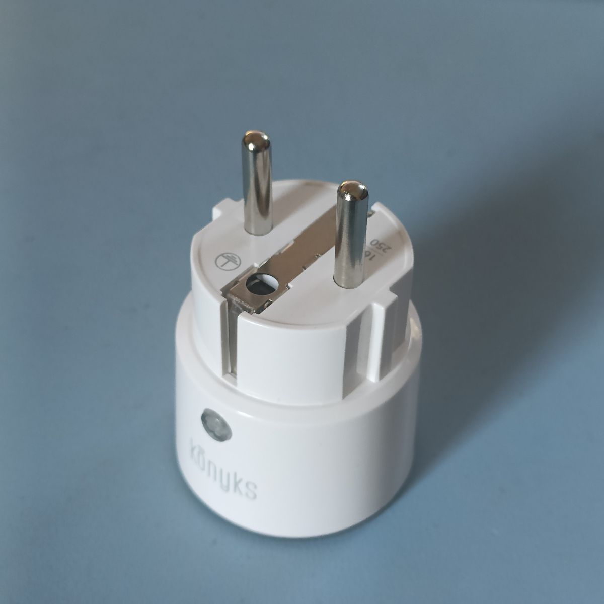

    I bought in 2021 a wifi smart plug from a french vendor, Konyks :
    Box of the Konyks Priska Mini 3 FR smart Wi-Fi plug with promotional price displayed.

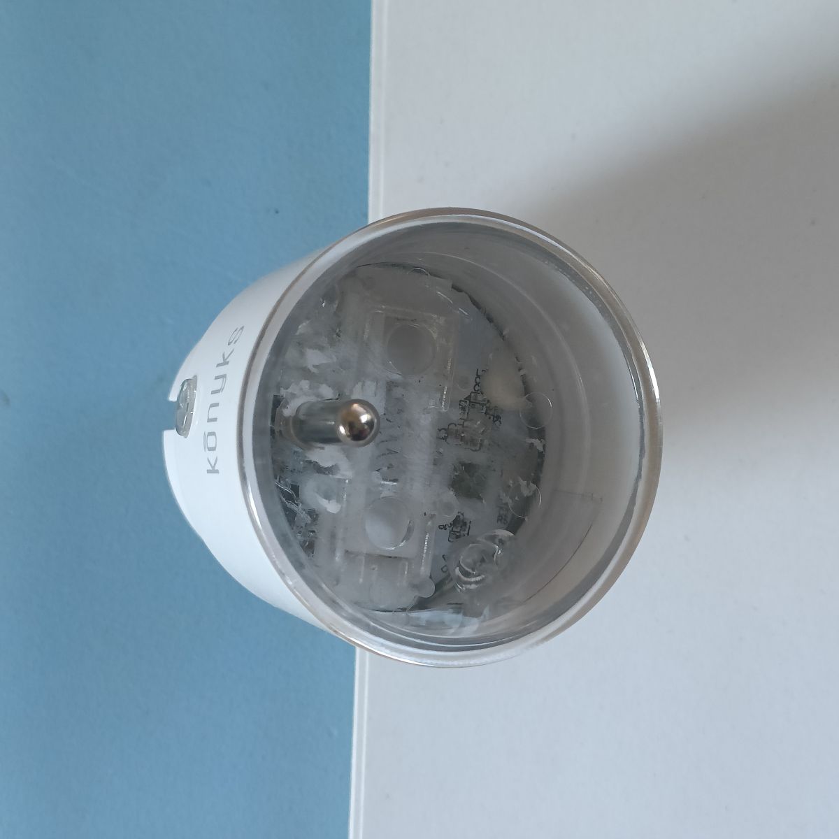

    Unboxed :
    Konyks Priska Mini 3 smart wifi plug on a blue surface. Close-up of the Konyks Priska Mini 3 smart plug from above.
    It is yet another Tuya device. After a few searches I found it has many clones. See for example this teardown or this one.
    I also found that another clone already had a profile in tuya-cloudcutter, branded Nous A1. I can confirm that this profile works on this device too:
    sudo ./tuya-cloudcutter.sh -p nous-a1-smart-plug -f OpenBeken-v1.17.697_bk7231n.ug.bin
    I'll post the OpenBK template in a second post

    With this template the button toggles the power and the indicator LED, and the power measure was correct even with re-calibrating.
    Many thanks for OpenBeken ! I'm not sure that's the correct way to have this plug listed on the official device list, but hope this helps !

    Interesting, I know this plug! I've had it some time ago with ESP8266 chip. It was marked as "NEO COOLCAM NAS WR01W/Gosund SP111": https://www.elektroda.pl/rtvforum/topic3941251.html
    You're lucky that it was flashable without opening, it's hard to disassemble.
