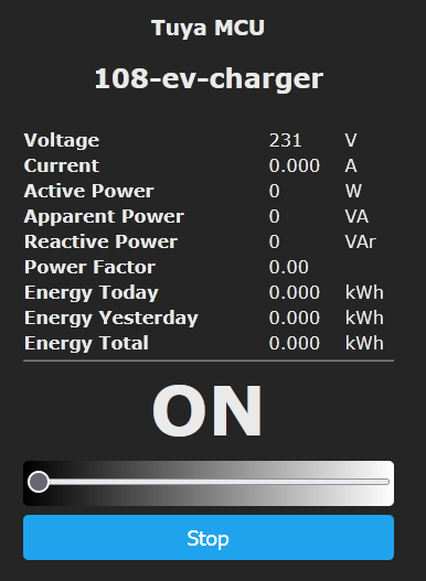

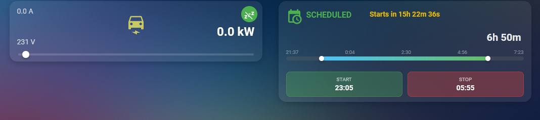

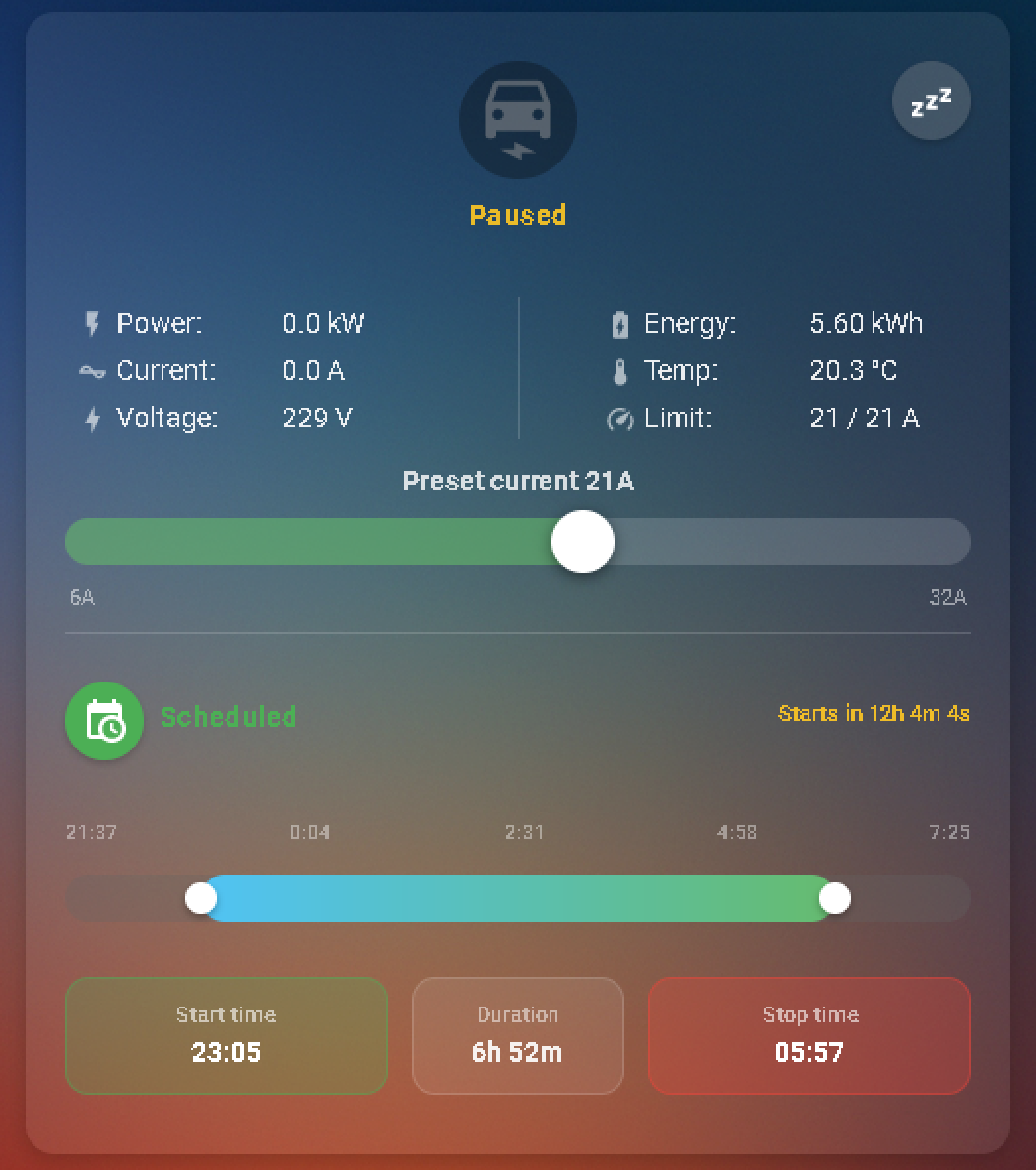

    Thank you for your article; it served as inspiration and a guide for me. I have replaced the WiFi module with ESP8266 (12F) and have gone with Tasmota. I have put effort to make sure the main functions work exactly as expected. So far I have Tasmota UI showing the V/A/P (some are in wrong scaling) and able to control start/stop charge and current (A) value. Also MQTT is set and in Home Assistant I have built a minimalistic dashboard which shows same data and allows same control. Then, as extra, I have created a scheduler (very basic) that can set the charge start and stop time for the low tariff hours. Also, I have added a keep alive function that kicks in every so to not let the car go in deep sleep as it prevents charging after that.
    I will provide the Tasmota and HA configs once I consider they are finalized.
    Electric vehicle charging panel with schedule showing start and stop times
    EV charger control panel showing voltage, current, energy stats and a Stop button

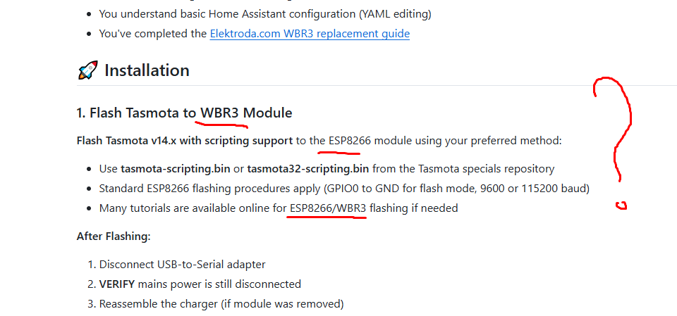

    @momo4 your readme looks suspicious, is it AI generated? It contains nonsense. I would suggest taking it down and doing a manual revision, before uploading it again.
    Screenshot of Tasmota flashing instructions for WBR3 module with red annotations.
    Tasmota runs on ESP, it does not support WBR3...

    >>21825357
    Hi P. and thanks for spotting those and for all your hard work on the non-ESP chips - yes it is AI-generated - and at the end... the idea of open source is - people can contribute and correct some things that others have overlooked - I have done the changes - but you could also submit a correction PR - it would be much more productive compared to the advice to take it down ;). It is provided as is and others are welcome to provide improvements. If I had kept it to myself and kept checking - it might have never gone out.

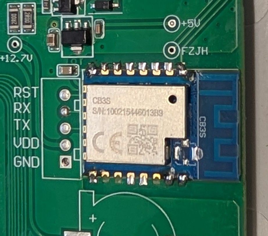

  • Clarifying CB3S flashing and Home Assistant setup
    #44 21892883
    thueri01
    Hello everyone,
    I have the 3-phase 11 kW charger.
    I would like to replace the WBR3 with a CB3S. I have already flashed OpenBeken onto the CB3S (in the removed state, not yet soldered in). I'm coming to the surface too.
    Do I have to flash something else onto it, or can I do the rest while it is soldered in?
    I still need some support. What are the next steps after the exchange?
    Where do the individual files have to be stored in Home Assistant?
    thueri01
  • OpenBeken already runs on WBR3 via OTA
    #45 21892970
    Posts: 14770
    Rate: 12913
    OpenBeken already runs on WBR3, so why replace?
    There is nothing else to flash - TuyaMCU firmware stays unchanged. OBK can be updated via OTA, if that's needed.
    Can you provide WBR3 flash backup for analysis (before you pair it with your WiFi, as it may contain your ssid)?
    Well, next steps are configurating TuyaMCU and later HA. It should be relatively easy as long as Tuya didn't change dpIDs.... we have a list of them in first post of this topic.
  • #46 21893166
    thueri01
    >>21892970 >>21892970
    Maybe I didn't express myself correctly.
    I still soldered in the original WBR3. I would like to replace this with the CB3S. I have already flashed the CB3S with OpenBeken. It's already running on my network.
    I think you were trying to tell me that no additional software is needed on the CB3S.
    Correct?
    Further configuration takes place OTA or in Home Assistant.
    Correct?
  • #47 21893206
    Posts: 14770
    Rate: 12913
    No futher physical actions are required on CB3S. You can later update it via OTA (via WiFi) if needed.

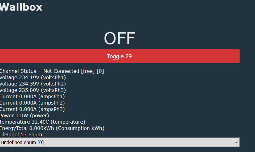

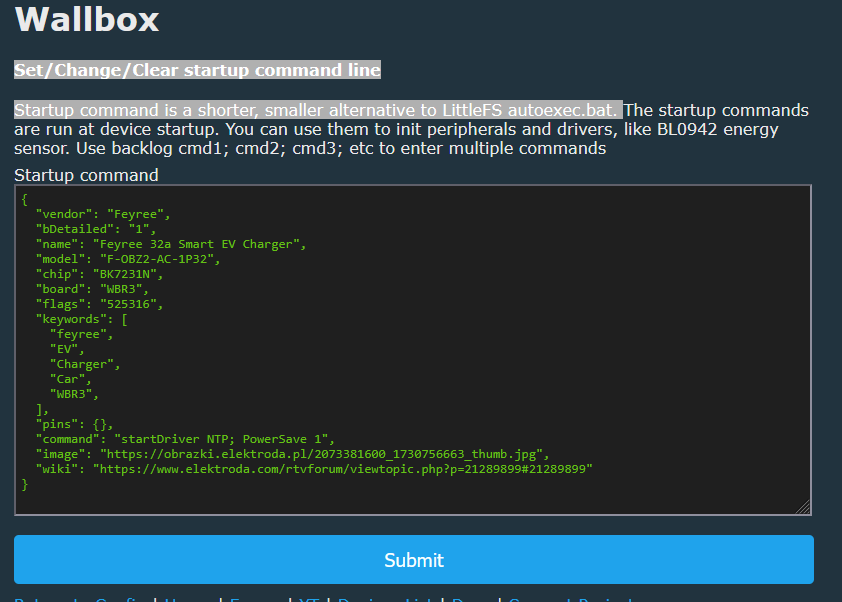

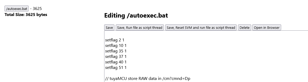

  • OpenBeken values now display after fixing autoexec.bat
    #48 21895931
    thueri01

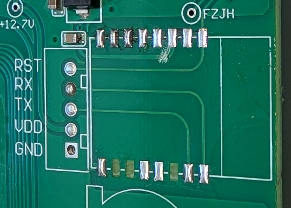

    The next step is done: replacing the chips. I cut the PIN 3.
    [WBR3] Feyree EV Charger teardown with adjustable charging via TuyaMCU
    The CB3S with open beken runs in the wallbox. It has a fixed IP address. I need in Home Assistant:
    for example, voltage of the 3 phases Tuya dpID 102-10. How do I get the values ​​displayed in Home Assistant?
    Which file has to go where in HA?
    I need an example, please.
    Where do you copy the autoexec.bat to?
    I can´t find this side:
    Added after 9 [hours] 50 [minutes]:
    I messed up. Now I've entered the autoexec.bat correctly. I found the right place:
    Now these values ​​are already being displayed in Open beken:
    Nothing is showing up in Home Assistant yet, but I'm sure I'll figure that out too.

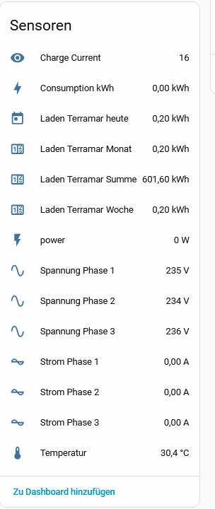

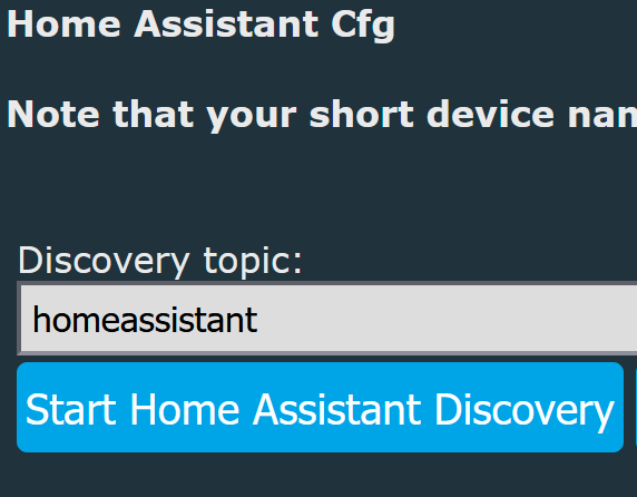

  • #49 21896977
    thueri01
    Success!
    First, I deleted the mqtt.yaml file. It's no longer needed.
    Then I deleted the device from the MQTT integration.
    Finally, I did the following in the config:
    Result:
    @ stonacek
    Thank you so much for your great work!

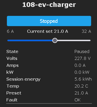

    I did swap the module in portable changer to ESP12E. With a bit of try and errors I have come up with the following configuration for ESPHome component: Github.
    From what I understand it is possible to use existing module using LibreTiny platform. However it is required to desolder the module for flashing via UART, because TX/RX pins are on the back side of the module. The other downside to using existing module is storage space. Module has 2MiB of flash which might lead to OTA flashing problems (depending on what do you bundle in the firmware).
    I hope i helped someone.
