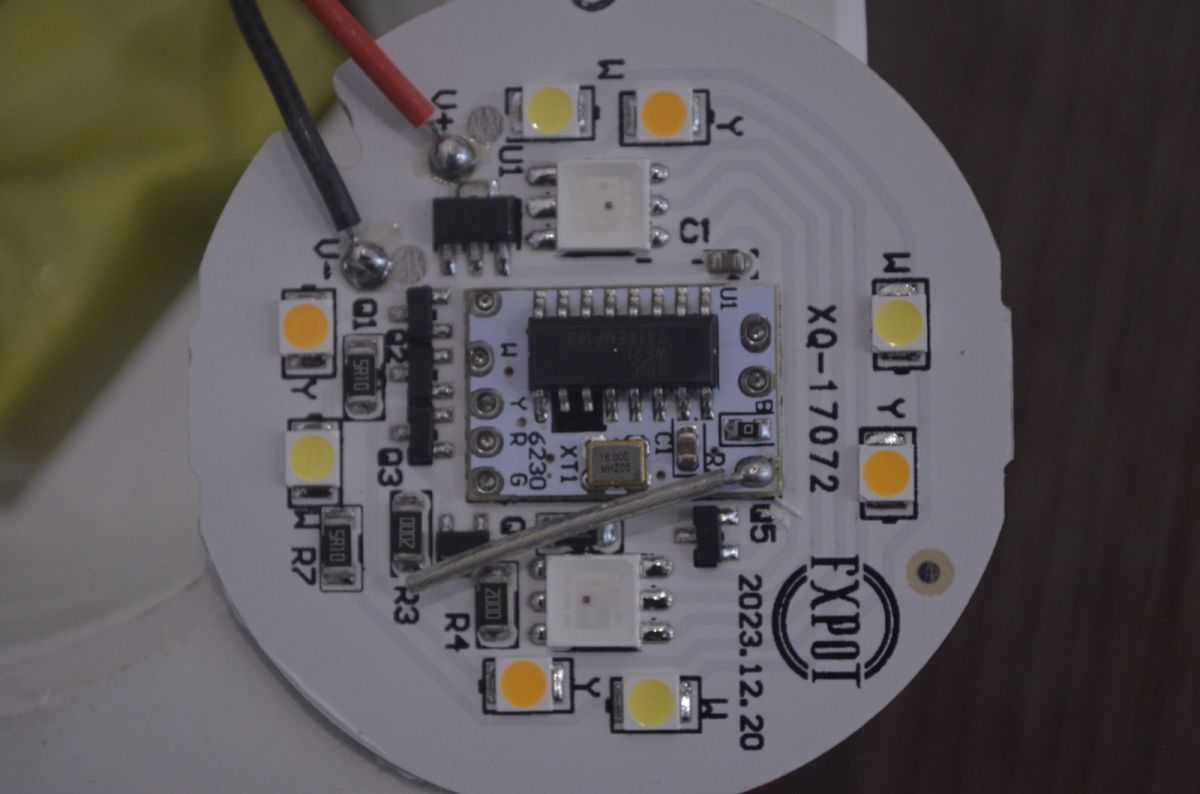

    Close-up of an electronic board with LED components and electronic elements.
    In the thrill of having a new house and the imminent phases of building it eating all my time I innocently fell for the Tuya trap thinking it was just a protocol as Zigbee, WIFI enchanted me. Time had come, powered HOAS up, but then, what? My lights are only BLE? Fu#k!
    All my ESP32 S3's have Bluetooth, so ok, calm down.
    But during the process of searching more about after I moved I came across Cloudcutter and flashing chips. What I'm asking is for directions, what should I do to have these lights best integrated with my HA?
    Are these lights Cloudcutter-able? Should I solder an ESP32 chip on them or simply using the ESP32 BLE is good enough?

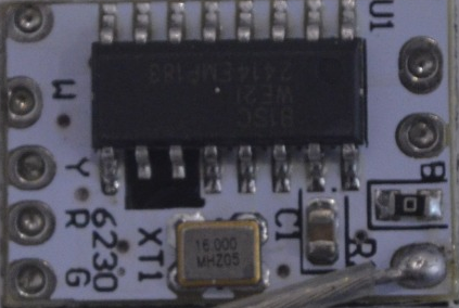

    It seems you've provided detailed images of your BLE smart light's internal PCB, specifically the module responsible for BLE communication and light control. Let's break down your situation based on these images and your question regarding integrating these lights with Home Assistant (HA):
    Analysis of the PCB and BLE Module
    1. BLE Chip Details:
    - The central IC on the module in your PCB is marked B15C, typically used in Tuya BLE devices. This is a Telink IC commonly found in Tuya products.
    - It uses a 16 MHz crystal oscillator for timing.
    - This IC is specifically designed for Tuya BLE protocol.
    2. LED Driver Setup:
    - The board includes pins labeled `R`, `G`, `B`, `W`, and `Y`, likely corresponding to the Red, Green, Blue, Warm White, and Yellow LED channels.
    - These outputs are likely controlled via PWM signals driven by the BLE module.
    - Other components like resistors and capacitors around the module are for filtering and LED driver stabilization.

    >>21316867 @ElektrodaBot You make a good point, about it being BLE, I don't think it is compatible with cloudcutter, right? The first step of using cloudcutter is having a WIFI card!
    The BLE Bridge seems what I need, talk more about it. Is it cloud dependent? Using this would be the way to go? https://github.com/shmuelzon/esp32-ble2mqtt?

    You're correct—Cloudcutter isn't suitable for BLE-only devices like your lights because it focuses on Tuya devices with Wi-Fi capabilities. The initial step in using Cloudcutter involves connecting to a Wi-Fi network, which your BLE lights cannot do. Therefore, utilizing a BLE bridge with your ESP32-S3 devices is a practical solution for integrating your lights with Home Assistant (HA). This approach isn't cloud-dependent and allows for local control of your devices. Let's delve deeper into how this works and how the esp32-ble2mqtt project can help.

    So I just found out that the module in this device, the B1SC-WE21 is actually a PHY6320 and it is not even re-flashable, since it is a OTP - One-Time-Programmable Memory.
    This leaves me only with the option of buying another (not considering this yet), reverse engineering the Tuya Bluetooth Beacon Mesh protocol (which I don't have the skill) and changing the hardware, removing the chip from my downlights, buying another and soldering them.
    My question is, will this work? What needs to be compatible, let's say I will buy an esp32 based chip and flash it with esphome could work? What is needed to change the chip? Only matching the GPIOs and that's it? I'm lost

    holchansgomes wrote:
    (...) hardware, removing the chip from my downlights, buying another and soldering them.
    My question is, will this work? What needs to be compatible, lets say i will buy an esp32 based chip and flash it with esphome could work? What is needed to change the chip? Only matching the GPIOS and thats it? Im lost
    Initial Assessment of Available Information
    You've discovered that your B1SC-WE21 device uses a PHY6320 chip, which is a One-Time Programmable (OTP) memory chip. This means the chip cannot be reflashed or reprogrammed after manufacturing. As a result, you're considering replacing the PHY6320 with an ESP32-based chip flashed with ESPHome to regain control over your downlights and integrate them with Home Assistant. You're unsure about the feasibility of this approach and need guidance on what needs to be compatible for a successful replacement.
    Direct Answer to Your Questions
    1. Will replacing the PHY6320 chip with an ESP32 module work?
    Yes, replacing the PHY6320 chip with an ESP32 module can work, provided you carefully address both hardware and software requirements. The ESP32 is a versatile microcontroller with Wi-Fi and Bluetooth capabilities, and when flashed with ESPHome, it can be integrated with Home Assistant for automation and control.
    2. What needs to be compatible?
    Several compatibility factors need to be considered:
    - Electrical Compatibility: Ensure that voltage levels, power supply, and signal logic levels are compatible between the ESP32 and your existing downlight circuitry.
    - Physical Compatibility: The ESP32 module should physically fit within the device's enclosure, and connections must be properly managed.
    - Functional Compatibility: The ESP32 must be capable of replicating the control signals (e.g., PWM for dimming, GPIOs for on/off control) required by your downlights.
    3. Is matching the GPIOs sufficient for the chip replacement?
    Matching GPIOs is essential but not the only requirement. You must also consider power requirements, signal levels, communication protocols, and ensure that the ESP32's firmware is configured correctly to replicate the original chip's functionality.
    Detailed Problem Analysis
    Understanding the Original Hardware
    - PHY6320 Chip:
    - A Bluetooth Low Energy (BLE) module commonly used in Tuya devices.
    - Features One-Time Programmable memory, making it immutable after manufacturing.
    - Controls the downlight's functions (e.g., power, brightness) through specific pins and protocols.
    - Downlight Circuitry:
    - Includes LEDs, possibly driven by an LED driver or directly controlled via PWM signals.
    - May have specific voltage and current requirements.
    ESP32 as a Replacement
    - ESP32 Module:
    - A powerful microcontroller with integrated Wi-Fi and Bluetooth connectivity.
    - Supports custom firmware like ESPHome for home automation integration.
    - Provides multiple GPIOs, PWM outputs, and communication interfaces (I2C, SPI, UART).
    Hardware Compatibility Considerations
    1. Voltage and Power Requirements:
    - ESP32 Voltage: Operates at 3.3V logic level.
    - Power Supply: Ensure the existing power supply can provide adequate current for the ESP32 (consider peaks during Wi-Fi transmission).
    2. GPIO Mapping:
    - Functionality: Determine which PHY6320 pins are responsible for controlling the downlight functions.
    - Mapping: Map these functions to ESP32 GPIOs, ensuring that the ESP32 can drive the required signals.
    3. Physical Constraints:
    - Size and Form Factor: The ESP32 module must fit within the downlight's enclosure.
    - Connection Points: Adapt the ESP32's pinout to align with the existing PCB pads or use jumper wires for connections.
    Software Compatibility and Configuration
    1. ESPHome Firmware:
    - An open-source solution that simplifies programming the ESP32 for home automation purposes.
    - Provides components for controlling lights, sensors, and other devices.
    2. Replicating Control Signals:
    - PWM Control: Use ESP32's PWM outputs to control LED brightness.
    - GPIO Control: Utilize GPIOs for on/off functionality or other control signals.
    3. Integration with Home Assistant:
    - The ESPHome-flashed ESP32 can be easily integrated with Home Assistant, allowing for automation and control.
    Challenges and Potential Issues
    - Signal Level Mismatch: Ensure that signal levels between the ESP32 and the downlight circuitry are compatible to prevent damage.
    - Unknown Communication Protocols:
    - If the downlight uses proprietary protocols or communication methods, replicating these may require additional reverse engineering.
    - Hardware Modifications:
    - Soldering and desoldering surface-mounted components require skill and appropriate equipment.
    - Risk of damaging the PCB or other components during the replacement process.
    Practical Guidelines
    Step 1: Assess the Existing Downlight Hardware
    - Disassemble the Downlight:
    - Carefully open the device to access the PCB and components.
    - Document the disassembly process for reassembly.
    - Identify Key Components and Connections:
    - Locate the PHY6320 chip and note its connections to other components.
    - Use a multimeter to trace connections if necessary.
    - Obtain Datasheets:
    - Acquire the PHY6320 datasheet to understand its pinout and functionality.
    - Compare with the ESP32's datasheet to plan the GPIO mapping.
    Step 2: Plan the ESP32 Integration
    - Select an Appropriate ESP32 Module:
    - Choose a module that fits physically and has the necessary features (e.g., ESP32-WROOM-32).
    - Map GPIOs and Functions:
    - Create a mapping between the PHY6320 pins and ESP32 GPIOs.
    - Ensure that the ESP32 can replicate the required control signals.
    - Design Connection Interfaces:
    - Decide whether to solder the ESP32 directly to the PCB or use adapter wires.
    - Consider creating a custom PCB if appropriate.
    Step 3: Develop and Flash ESPHome Firmware
    - Set Up ESPHome:
    - Install ESPHome on your computer and prepare to write a configuration file.
    - Create ESPHome Configuration:
    - Define device settings, Wi-Fi credentials, and enable necessary components.
    - Example configuration:
    Code: text
    - Flash the ESP32:
    - Connect the ESP32 to your computer and upload the ESPHome configuration.
    Step 4: Hardware Modification and Installation
    - Remove the PHY6320 Chip:
    - Use appropriate desoldering tools (e.g., hot air station) to remove the chip carefully.
    - Prepare the ESP32 Module:
    - Solder header pins or wires to the necessary GPIOs on the ESP32.
    - Connect ESP32 to the Downlight PCB:
    - Solder the wires from the ESP32 to the corresponding points on the PCB.
    - Ensure solid and clean solder joints to prevent connectivity issues.
    - Secure the ESP32 Module:
    - Physically secure the ESP32 within the downlight enclosure, ensuring it doesn't interfere with other components.
    Step 5: Testing and Troubleshooting
    - Initial Power-On Test:
    - Power the modified downlight and observe the ESP32 startup.
    - Check for any signs of malfunction (e.g., overheating, smoke).
    - Connectivity Test:
    - Verify that the ESP32 connects to your Wi-Fi network.
    - Ensure it appears in Home Assistant via the ESPHome integration.
    - Functional Test:
    - Use Home Assistant to control the downlight (e.g., turn on/off, adjust brightness).
    - Monitor the ESPHome logs for any errors.
    - Troubleshooting:
    - If functionality isn't as expected, double-check your GPIO mappings and soldering connections.
    - Use a multimeter to verify electrical connections and signal outputs.
    Potential Challenges and Solutions
    - Voltage Level Differences:
    - If the original circuitry operates at a different voltage, use voltage level converters or adjust the power supply.
    - Insufficient GPIOs or PWM Channels:
    - The ESP32 has multiple GPIOs and PWM channels, but ensure they meet your specific needs.
    - If additional outputs are required, consider using I/O expanders.
    - Space Constraints:
    - If space is limited, use a smaller ESP32 module, such as the ESP32-Pico, which integrates required components into a smaller package.
    - Heat Management:
    - Ensure that the added ESP32 doesn't cause overheating within the enclosure.
    - Adequate ventilation or heat sinking may be necessary.
    Recommendations
    - Skill Assessment:
    - Evaluate your proficiency in soldering and working with surface-mount devices.
    - If necessary, practice on spare PCBs or seek assistance from someone with more experience.
    - Backup Plan:
    - Be prepared for potential failure or unintended damage to the downlight.
    - Consider the cost-benefit of replacing the entire unit versus modifying it.
    - Documentation:
    - Keep detailed notes and diagrams of your modifications for future reference or troubleshooting.
    - Community Resources:
    - Seek out community forums and projects where others have undertaken similar modifications.
    - Platforms like GitHub, Hackaday, or the Home Assistant community may have valuable insights.
    Conclusion
    Replacing the PHY6320 chip with an ESP32 module in your downlights is a feasible solution to regain control and integrate with Home Assistant. It involves careful consideration of hardware compatibility, precise physical modifications, and proper firmware configuration using ESPHome. By addressing the electrical, physical, and software aspects, you can successfully repurpose your downlights.
    Suggestions for Further Research
    - Explore Similar Projects:
    - Look for online tutorials or case studies of similar chip replacements in smart devices.
    - Learn About ESPHome Capabilities:
    - Delve deeper into ESPHome documentation to customize functionality according to your needs.
    - Understand LED Driver Requirements:
    - Research the specific requirements of the LEDs or LED drivers used in your downlights to ensure compatible control signals.
    - Safety First:
    - Always disconnect power before performing any hardware modifications.
    - Use appropriate personal protective equipment (e.g., safety glasses).
    - Testing Setup:
    - Before final assembly, test the ESP32 and downlight functionality externally to ensure everything works correctly.
    - Software Updates:
    - Keep your ESPHome and Home Assistant installations up to date for the latest features and security improvements.
    Possible Disclaimers
    - Risk of Damage:
    - Modifying hardware can lead to irreparable damage if not done correctly.
    - Warranty Voidance:
    - Such modifications will void any existing warranties on your downlights.
    - Liability:
    - Proceed at your own risk; ensure you are confident in your abilities or consult a professional.
    Final Thoughts
    Transitioning your downlights to use an ESP32 module offers enhanced control and integration capabilities. While the process is technically challenging, it can be a rewarding project that enhances your understanding of electronics and home automation systems. Should you encounter any obstacles or require further clarification, don't hesitate to reach out for assistance.
    Feel free to ask any additional questions or seek clarification on any step. I'm here to help guide you through this process.

    I'm about to switch the PHY6320 SOP16 in a board with an ESP32, let's focus hardware-wise. @ElektrodaBot
    In this post you about the topic one of the topics are: 1. compare the pinout of the module with the inside and check if a given ESP module (for example, ESP12F) can replace it
    take a look https://www.elektroda.com/rtvforum/topic3816654.html
    do I need the multimeter for that? or an oscilloscope?
    The board has a PHY6320 on it but the board itself I have not yet unsoldered, so I don't know if there is info on the back of it.
    You are considering replacing a PHY6320 module on your device's PCB with an ESP12F module (based on the ESP8266). The PHY6320 is currently soldered onto the board, and you have not yet desoldered it to inspect the backside. You are unsure whether you need a multimeter or an oscilloscope to compare the pinouts of the two modules and determine if the ESP12F can be a suitable replacement.
    To compare the pinout of the PHY6320 module with that of an ESP12F and determine compatibility, you will need a multimeter for continuity testing, but an oscilloscope is not necessary. A multimeter allows you to trace connections and verify how the pins of the PHY6320 are connected within the circuit. Visual inspection, possibly aided by magnification tools, and obtaining datasheets for both modules are also essential steps in this process.
    Understanding the Modules
    1. PHY6320 Module
    - Functionality: A Bluetooth Low Energy (BLE) module commonly used in Tuya devices.
    - Characteristics:
    - Operates at 3.3V logic levels.
    - Features One-Time Programmable (OTP) memory, meaning it cannot be reflashed.
    - Application: Controls device functions such as wireless communication and interaction with other components on the PCB.
    2. ESP12F Module (ESP8266-Based)
    - Functionality: A Wi-Fi-enabled microcontroller module with multiple GPIOs (General Purpose Input/Output).
    - Characteristics:
    - Programmable with custom firmware like ESPHome, allowing integration with platforms like Home Assistant.
    - Application: Capable of replacing other microcontroller modules in IoT devices, handling wireless communication, and controlling hardware functions.
    Comparing Pinouts
    1. Gather Datasheets and Pinout Diagrams
    - PHY6320: Obtain the datasheet or pinout diagram to understand the functions of each pin.
    - ESP12F: Acquire the module's pinout diagram, which is widely available due to its popularity.
    2. Visual Inspection
    - Examine the PCB:
    - Use magnification tools to inspect the connections between the PHY6320 module's pins and the PCB traces.
    - Look for any labeling on the PCB indicating pin functions.
    3. Using a Multimeter for Continuity Testing
    - Set the Multimeter:
    - Configure it to continuity mode (often indicated by a diode symbol or a sound icon).
    - Trace Connections:
    - Power Pins: Identify which pins are connected to the power supply (VCC) and ground (GND).
    - Signal Pins: Determine which pins are connected to other components, such as LEDs, buttons, or sensors.
    - Communication Lines: Locate any pins used for communication protocols (e.g., UART, I²C, SPI).
    - Document Findings:
    - Create a mapping of PHY6320 pins to their connections on the PCB.
    4. Comparing with ESP12F Pinout
    - Match Pin Functions:
    - Align the PHY6320 pin functions with the corresponding pins on the ESP12F.
    - Ensure that critical functions (e.g., power, ground, control signals) can be replicated.
    - Assess GPIO Availability:
    - Verify that the ESP12F has sufficient GPIOs to handle all required functions.
    - Note any differences in pin assignments or functions.
    Evaluating the Need for an Oscilloscope
    - Oscilloscope Use Cases:
    - Visualizing signal waveforms.
    - Analyzing timing characteristics in high-speed signals.
    - Current Task:
    - Pinout comparison and continuity testing do not require waveform analysis.
    - Conclusion:
    - An oscilloscope is not necessary for comparing pinouts or determining basic electrical compatibility.
    Unsoldering the PHY6320 Module
    1. Accessing Hidden Traces
    - Potential Need:
    - If PCB traces are on the underside of the module or multilayered, unsoldering may be required to fully inspect connections.
    - Technique:
    - Use a hot air rework station or soldering iron with appropriate desoldering tools.
    - Proceed carefully to avoid damaging the PCB or nearby components.
    2. Cautions
    - Skill Level:
    - Desoldering surface-mount devices (SMDs) requires experience and steady hands.
    - Risk of Damage:
    - Overheating can lift pads or damage the PCB.
    - Alternative:
    - If unsure, consider seeking assistance from someone with SMD rework experience.
    Supporting Explanations and Details
    Importance of Visual Inspection
    - Identifying Physical Connections:
    - Visual tracing helps in understanding how the module interfaces with the rest of the circuit.
    - Noting PCB Labels:
    - Some PCBs have silkscreen labels indicating pin functions, which can be invaluable.
    Role of the Multimeter
    - Continuity Testing:
    - Verifies electrical connections between points without powering the circuit.
    - Resistance Measurement:
    - Can identify pull-up or pull-down resistors connected to certain pins.
    - Voltage Measurement (Optional at Later Stage):
    - After initial testing, voltage measurements can confirm power supply levels when the device is powered.
    - Pin Function Differences:
    - The PHY6320 and ESP12F may have different pin functions and arrangements.
    - Voltage Level Compatibility:
    - Both modules operate at 3.3V, but it's crucial to confirm this to prevent damage.
    - Physical Dimensions:
    - The ESP12F may have a different footprint, requiring mechanical adjustments or adapter PCB.
    1. Preparation
    - Tools Needed:
    - Multimeter with continuity function.
    - Datasheets/pinout diagrams.
    - Magnifying tool (e.g., loupe, microscope).
    - Fine-tipped soldering iron and desoldering tools (if unsoldering).
    2. Safety Precautions
    - Power Off:
    - Ensure the device is disconnected from any power source before testing.
    - Static Electricity:
    - Use anti-static precautions to prevent damage to sensitive components.
    3. Documentation
    - Record Keeping:
    - Document each pin's connection and function meticulously.
    - Take photos of the PCB and module for reference.
    4. Testing After Replacement
    - Initial Power-On:
    - Power the modified device cautiously, monitoring for any signs of malfunction.
    - Functionality Check:
    - Verify that all device functions operate as expected with the ESP12F.
    - Firmware Configuration:
    - Program the ESP12F with appropriate firmware (e.g., ESPHome) configured to control the device.
    Conclusion
    For comparing the pinout of your PHY6320 module with an ESP12F to assess compatibility, a multimeter is essential for continuity testing, while an oscilloscope is unnecessary at this stage. By carefully mapping out the connections and functions of each pin using the multimeter and datasheets, you can determine if the ESP12F can effectively replace the PHY6320 in your device. This approach allows you to ensure electrical compatibility and plan for any necessary firmware adjustments.
    - Consult Community Resources
    - Review the thread you mentioned: Elektroda Forum Post.
    - Search for similar projects where others have replaced BLE modules with ESP modules.
    - Explore ESP8266 Documentation
    - Familiarize yourself with the ESP12F’s capabilities, pin functions, and programming requirements.
    - Consider ESP32 Modules
    - If additional features or Bluetooth capability is needed, an ESP32 module might be a suitable alternative, although it may have different power requirements and physical dimensions.
    Final Remarks
    Replacing the PHY6320 with an ESP12F is a feasible project that requires careful planning and execution. Ensure you have the necessary tools and skills for the task. If you have further questions or need guidance on specific steps, feel free to ask. I'm here to support you in successfully completing your project.

What is OTP memory on the PHY6320 or B1SC-WE21 module, and why does it stop the module from being reflashed?
"OTP memory" is non-volatile memory that is programmed once during manufacturing, cannot be rewritten later, and therefore blocks normal reflashing of device firmware. In the thread, the discovered B1SC-WE21 path was identified as a PHY6320 using OTP, which is why the user concluded that reflashing was no longer an option. Once that finding was made, the realistic choices became Bluetooth protocol work, ESP32 bridging, buying different lamps, or removing the original module and wiring in a replacement controller. [#21347461]
When replacing a PHY6320-based Tuya module with an ESP32 or ESP12F, what electrical and pin compatibility checks do I need to make besides matching GPIOs?
You must check power, logic levels, control method, and physical fit, not just GPIO count. The thread highlights 3.3 V logic compatibility, adequate current for ESP peaks, and whether the original board expects PWM, simple GPIO, or another control signal. You also need to verify boot constraints, shared grounds, and whether the new module fits inside the enclosure. A bad match can mean unstable boot, incorrect dimming, or permanent damage. GPIO matching is necessary, but it is only one part of a safe module swap. [#21347462]
How do I compare the pinout of a PHY6320 module to an ESP12F or ESP32 module using a multimeter before desoldering the original board?
Use a multimeter in continuity mode and map functions before removing anything. 1. Identify obvious rails first: check which pins connect to GND and the power rail. 2. Trace the remaining pins to LEDs, drivers, buttons, or test pads and document each destination. 3. Compare that map against the ESP12F or ESP32 pinout, especially boot pins and usable GPIOs. The thread is clear that this job needs a multimeter, magnification, and datasheets; an oscilloscope is not required for basic pinout comparison. [#21347476]

What are the main safety and hardware risks when desoldering a SOP16 PHY6320 module from a downlight PCB and wiring in an ESP-based replacement?
The main risks are lifted pads, overheated PCB traces, wrong-voltage damage, and unsafe work on a mains-powered light. The thread repeatedly warns that surface-mount removal needs proper tools such as a hot-air station and careful handling. A bad swap can also leave the ESP unstable if power rails, grounds, or boot pins are wrong. Disconnect power first, document every wire, and test outside the final enclosure before reassembly. This is a high-risk modification, and the original warranty is effectively gone once you start rework. [#21347462]
