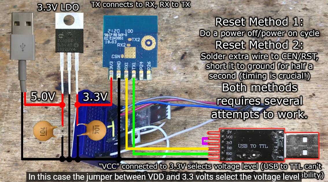

    Itd, I can look into this in more detail, unfortunately I have a problem. I'm using CH341 to wire up the UART, when disconnected it forces the device to go into gas detection alarm and after a while puts the device into off line mode, you can't see it in the app. Probably something wrong with the load on the UART pins.
    Can you suggest what programmers you use to wire up the UART?

    I use CH341 for UART tapping, when disconnected it forces the device to go into gas detection alarm and after a while puts the device into off line mode, you can't see it in the app. Probably something wrong with the load on the UART pins.
    I have not encountered such a problem. Unless there is very complex data there, e.g. in RAW mode, you can also retrieve the dpID from the Tuya API: DpID extraction for TUYA MCU devices .
    You can try for principle with this converter what I recommend, possibly also describe how you connect it?
    A side thing to check, by the way, is whether this is a normal TuyaMCU device or battery-powered , i.e. is the MCU able to switch off power to the Wi-Fi module and only switch it on to report data to the cloud? Is 3.3V still on the VDD of the Wi-Fi module? Is the Wi-Fi module's VDD connected to the power supply via the MOSFET that the MCU controls?

    Can you suggest what programmers you are using to wire up the UART?.
    I use the ones shown on YT, such as:
    Which UART tapping programmer for the Wi-Fi gas detector in TuyaMCUAnalyzer?
    CH340 with jumper to select voltage level.
