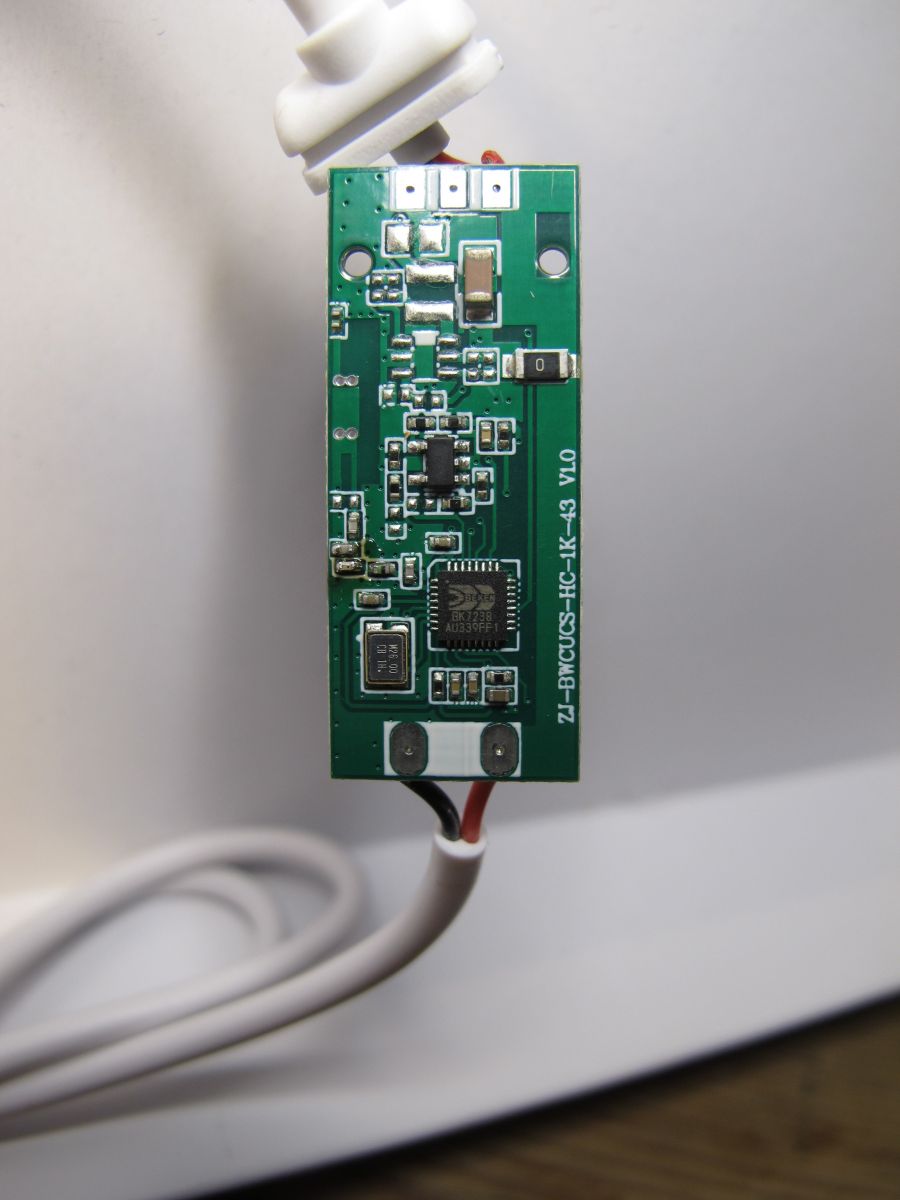

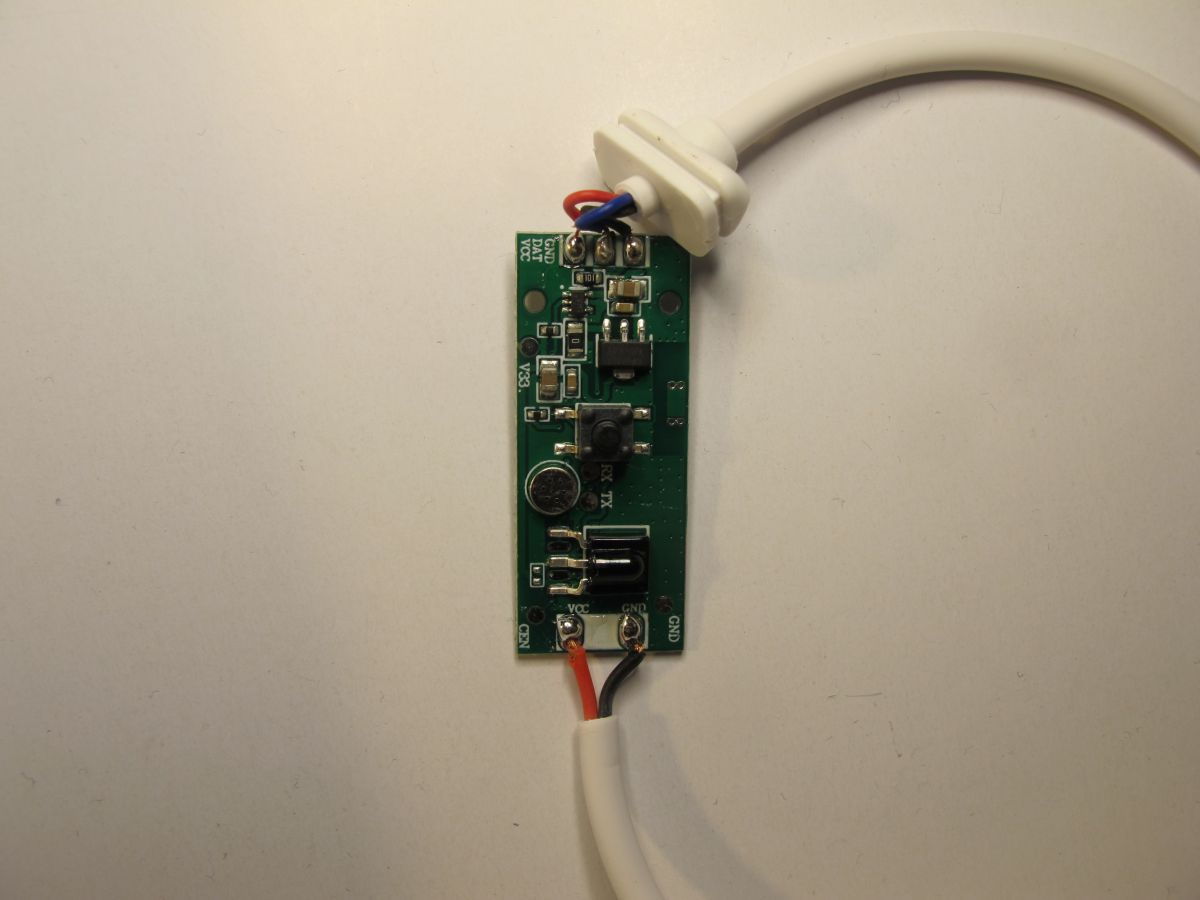

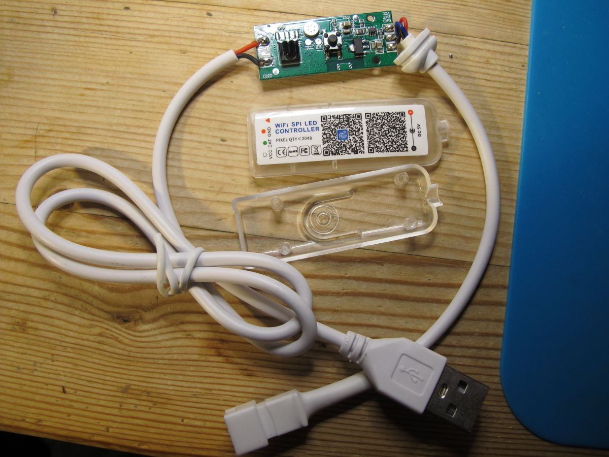

    SurpLife (Zengge) Symphony Controller USB SPI. Very small.
    WiFi SPI LED Controller with USB cable on a wooden table Photo of an electronic board with several components and a connected white wire. SurpLife (Zengge) USB SPI controller module on a white background.
    BKFIL and Easy Flasher firmware backup attached. The coeff on this device is 84f37800 84f37800 84f37800 84f37800.
    boot at 115200 baud
    app boot is at 2000000 baud

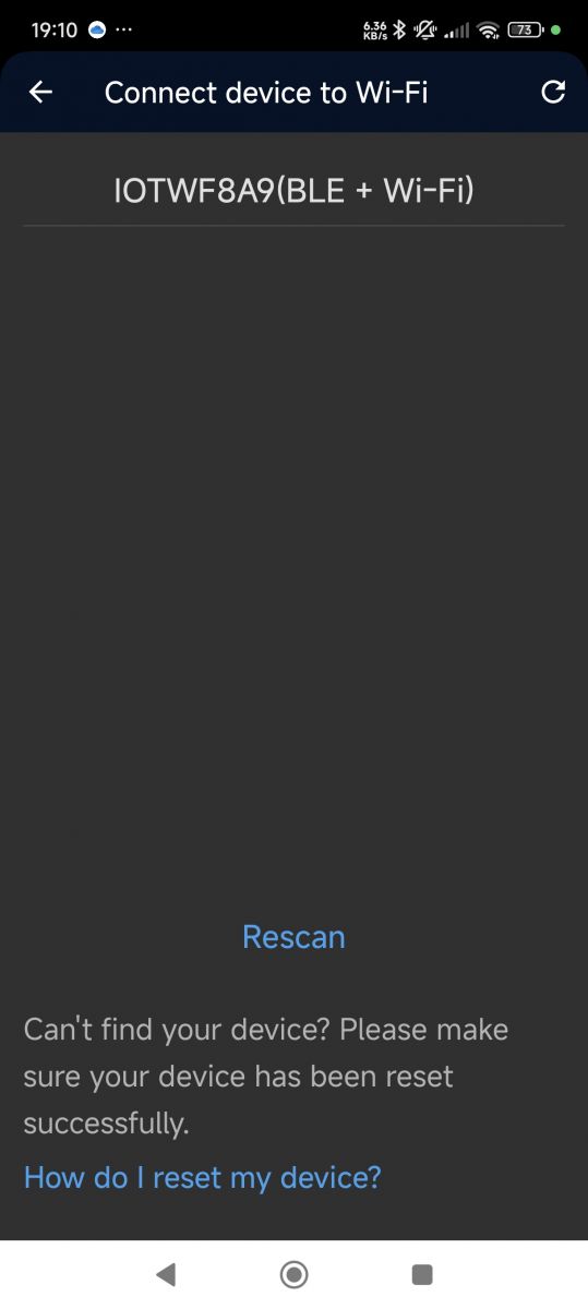

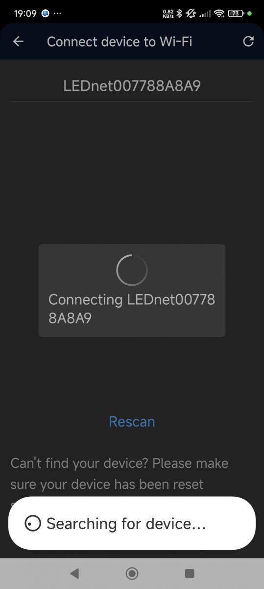

    attempting OTA with mhflasher to see what it says:

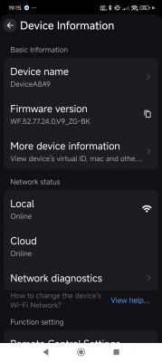

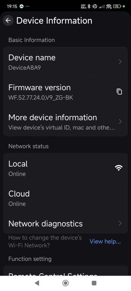

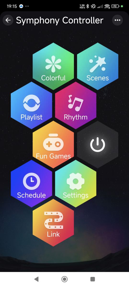

    detected by the Magic Home and SurpLife apps but SL has all the SPI LED scenes and features
    Device information screen from an app showing device name and firmware version. Symphony Controller app screen with hexagonal menu items. App screen for connecting the device to Wi-Fi. App screen showing connection to Wi-Fi network LEDnet007788A8A9.

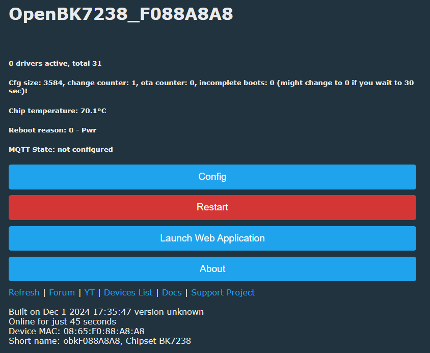

    @insmod's Arduino SDK build boots:
    Screenshot of OpenBK7238 control panel.

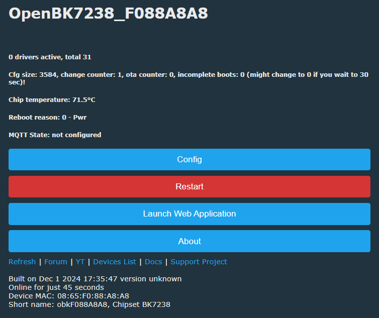

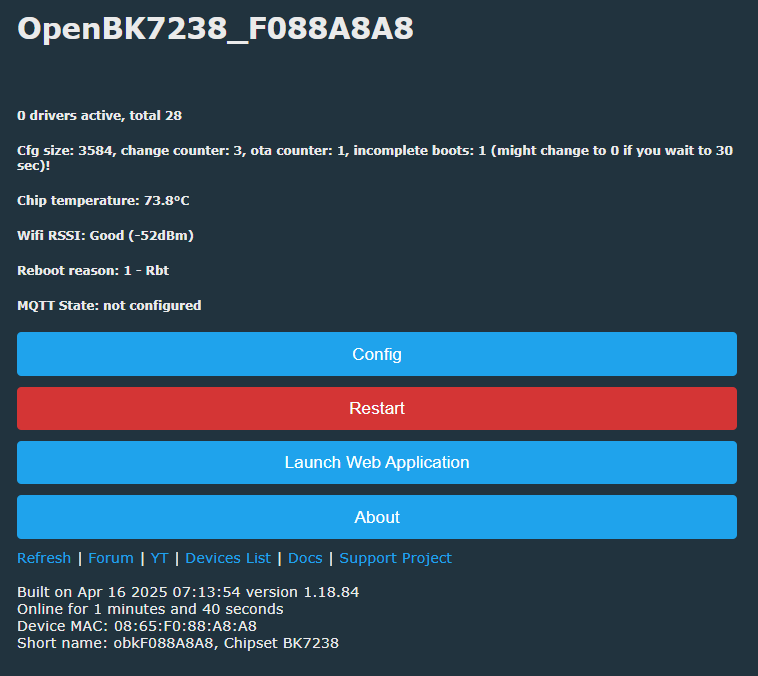

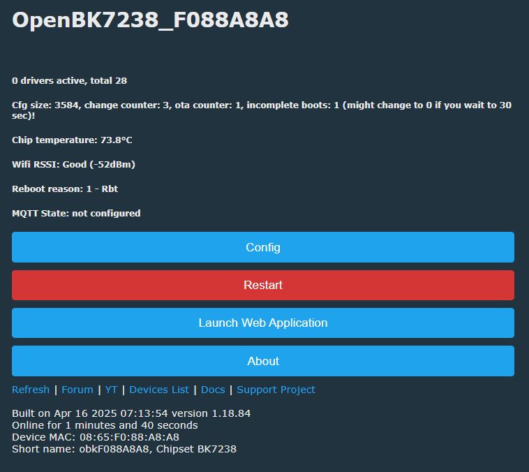

    hooked this back up to see what was on it. Early OpenBK7238.
    OpenBK7238 control panel with configuration, restart, and web application launch buttons.

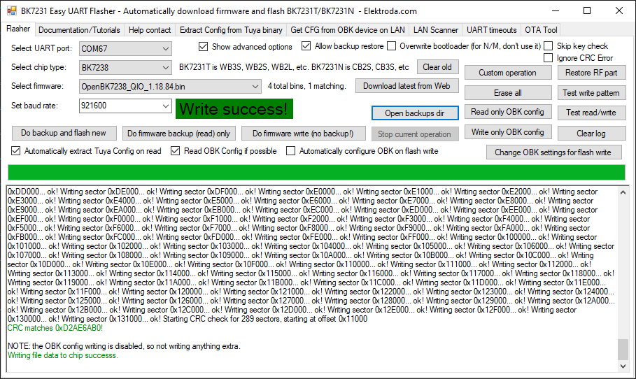

    OTA I guess wasn't working at this point so flashed with EF
    BK7231 Easy UART Flasher window with Write success! message indicating successful firmware writing.
    I notice the OpenBK7238 log out must have switched UART too.
    1.18.84 OTA- > 1.18.84 log:
    flashed factory back from 0x0 and tested OpenBK7238 flash and OTA was still OK as if new user converting from factory.
    OTA still behaves as it should ✅
    Main interface of the OpenBK7238 web panel with device information and configuration options.

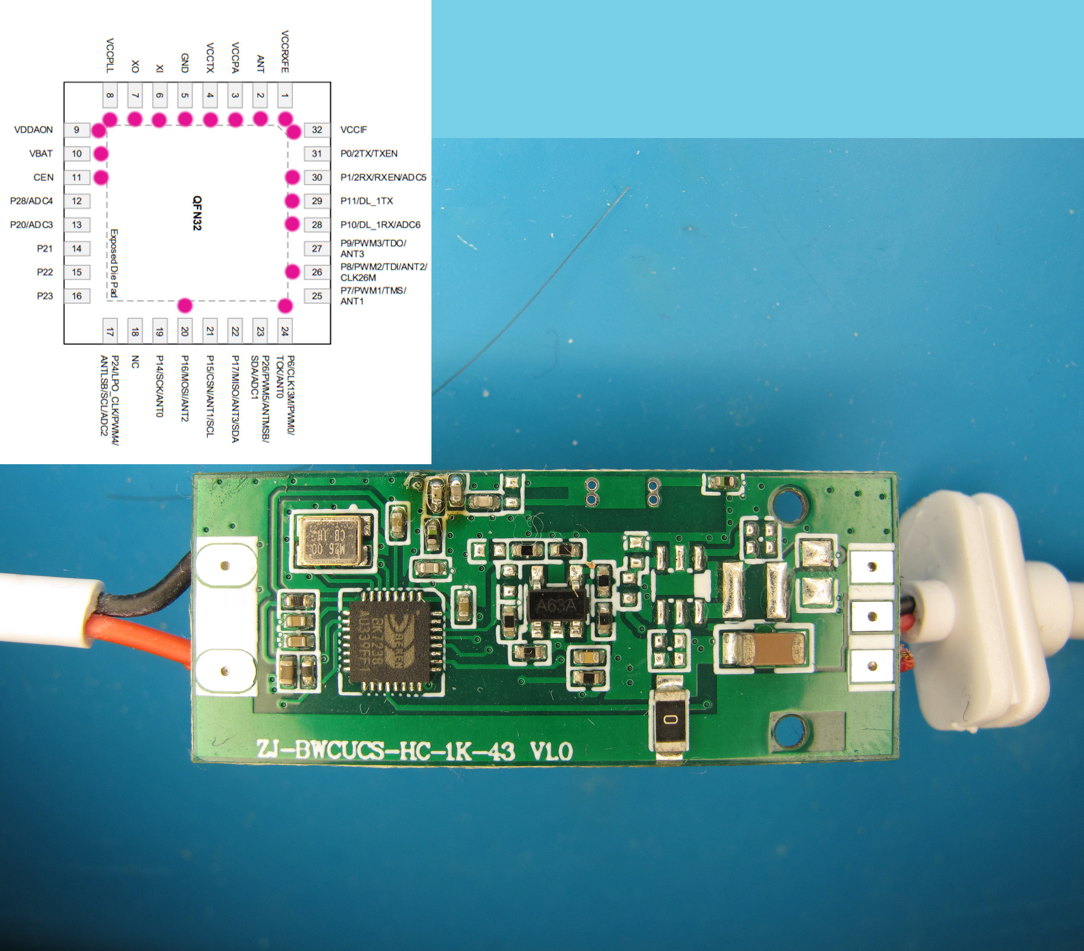

    although SPI isn't yet implemented yet on BK7238, here are the pin assignments discovered by trial-and-error and educated guesses after marking pins with traces
    P1 is the microphone, not supported in OBK
    PCB with electronic components and a microcontroller pinout diagram in the upper left corner.
    ZJ-BWCUCS-HC-1K-43 V1.0

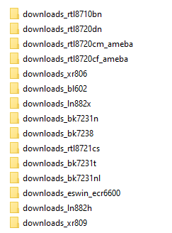

    hmm. unsure. I'll trawl a selection of these SDKs
    A list of folders with names of electronic module chips visible in a file explorer window.

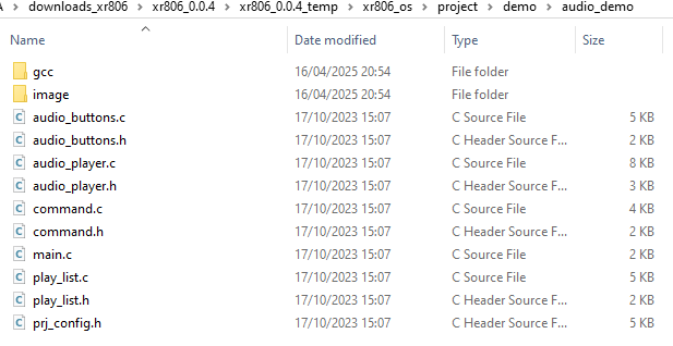

    There's this in XR806, but that's audio, not necessarily mic I guess
    Screenshot of a project folder containing C source and header files for an audio demo.

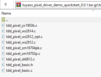

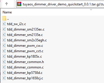

    a ton of stuff in the attached, but don't see anything super relevant.
    other things maybe interesting?
    A list of C source and header files in a pixel driver project folder. ZIP archive window with a list of folders in the os_kv directory. Screenshot of a folder containing directories and files from a software project. Screenshot of a folder window with several C source files and a README file. Screenshot of a file explorer window displaying C source and header files from the tuyaos_dimmer_driver_demo project.
    • TUYA.zip (7.97 MB) You must be logged in to download this attachment.

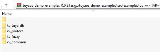

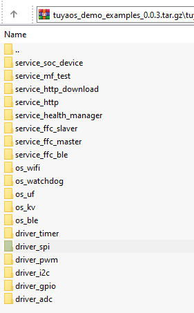

    A list of project folders with the driver_mic folder highlighted.
    • tuyaos_demo_examples_2.1.5.tar.gz (1.11 MB) You must be logged in to download this attachment.
    WAV recording support in microphone demo

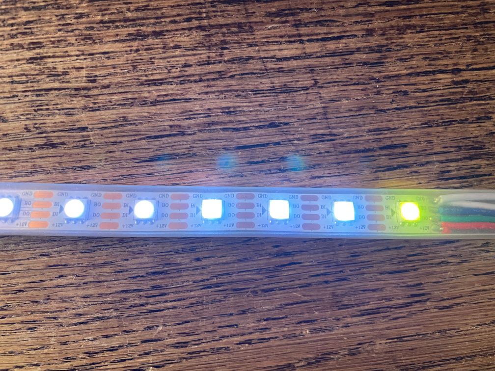

    So I can now drive WS2812 from BK7238 NiceMCU? I can give it a try today
    SPIDMA LEDs for BK7238, BK7252N and BK7231N_ALT.
    Tested 12 WS2812B leds on BK7238, animations work fine.
    Fixed Powersave on BK7238.
    Implemented SPI with new sdk, not tested. (N/7238/7252N use SPI DMA, everything else SPI)

    Andy41
    Posts: 10
    Thank you for the coding for this part. Good work.
    There are two questions/ remarks:
    - sometimes the firmware crashed, if I set more than 20 Pixels at startup. Sometimes the last pixel set a wrong color,
    (startDriver SM16703P | SM16703P_Init 32 | startDriver PixelAnim) -> Comet with white color let the last pixel be yellow.
    I think, it could
    Lit LED strip with white and one yellow LED on a wooden surface be a problem of PixelAnim !?
    - Where can I find the command-set for SM16703P?
    I want to set brightness at startup. i.e.
    Thanks
    Andreas
    Added after 4 [hours] 36 [minutes]:
    Now I have found the command-set at github in /scripts/commands.md. Sorry.
    The crash, I have had, is at startup - if you use "Change Startup Command Text". Not by autoexec.bat!. I think, there is a timing problem. If I start with "delay_ms 100" the problems are gone.
    Andreas
