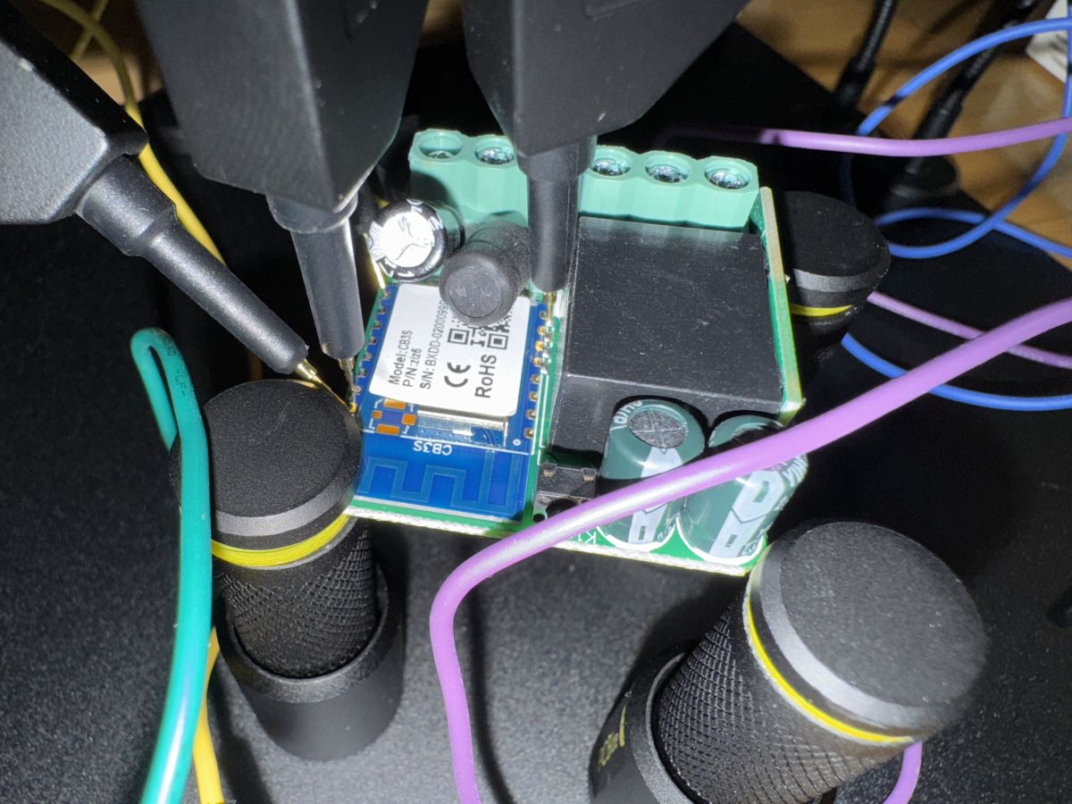

  • CB3S flashing works despite obstructed VCC pad
    #1 21345937
    hasso4711

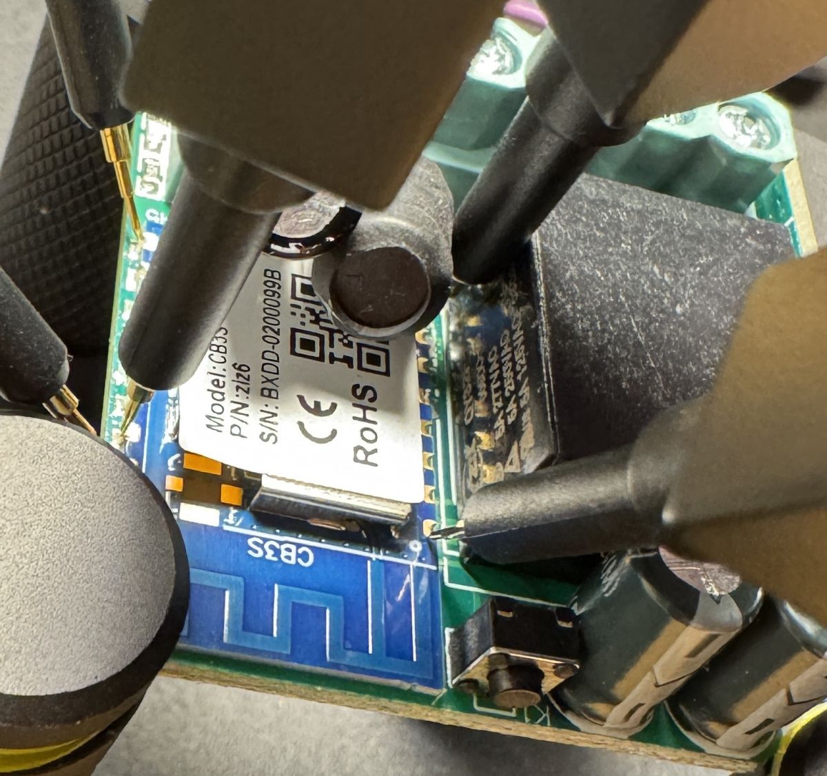

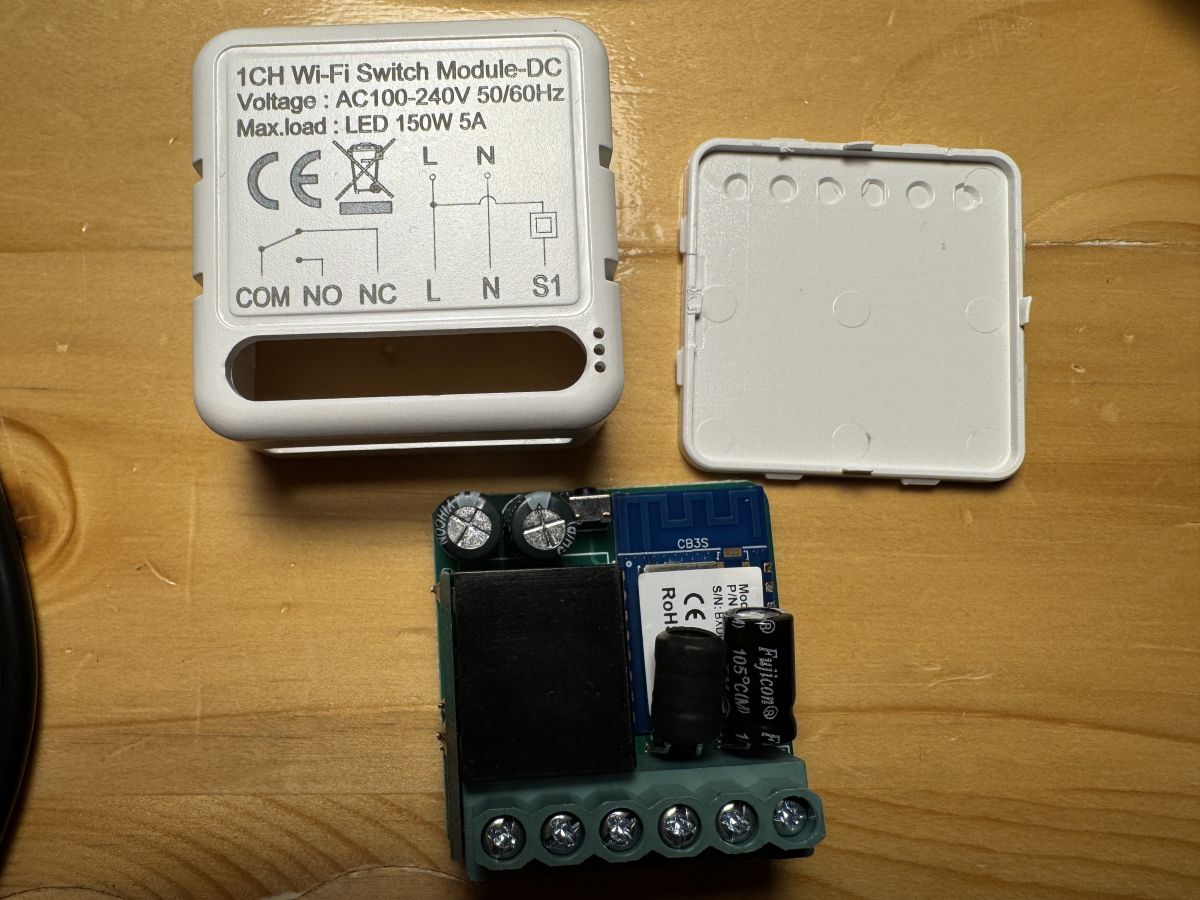

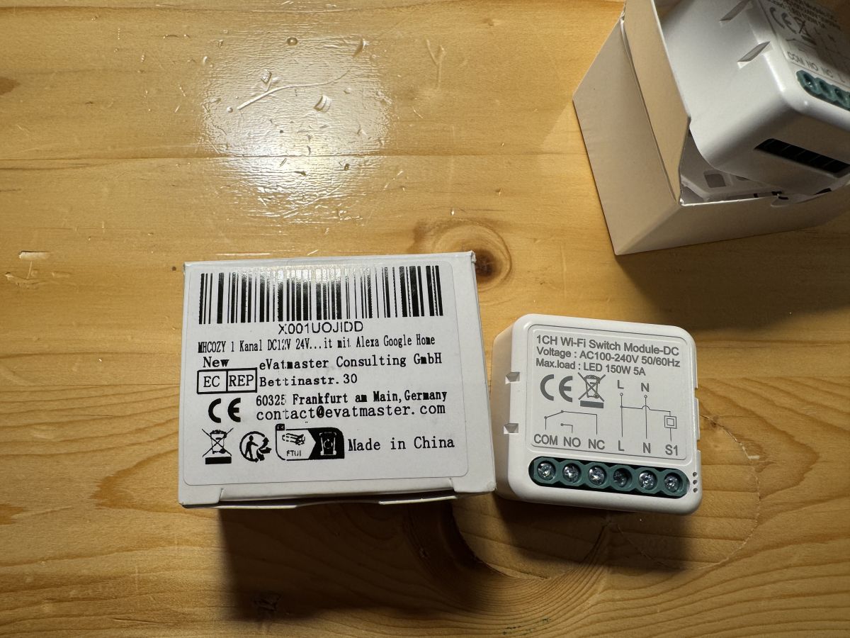

    I got this module from Amazon Link
    it has the CB3S Module
    flashing with the GUI app was easy

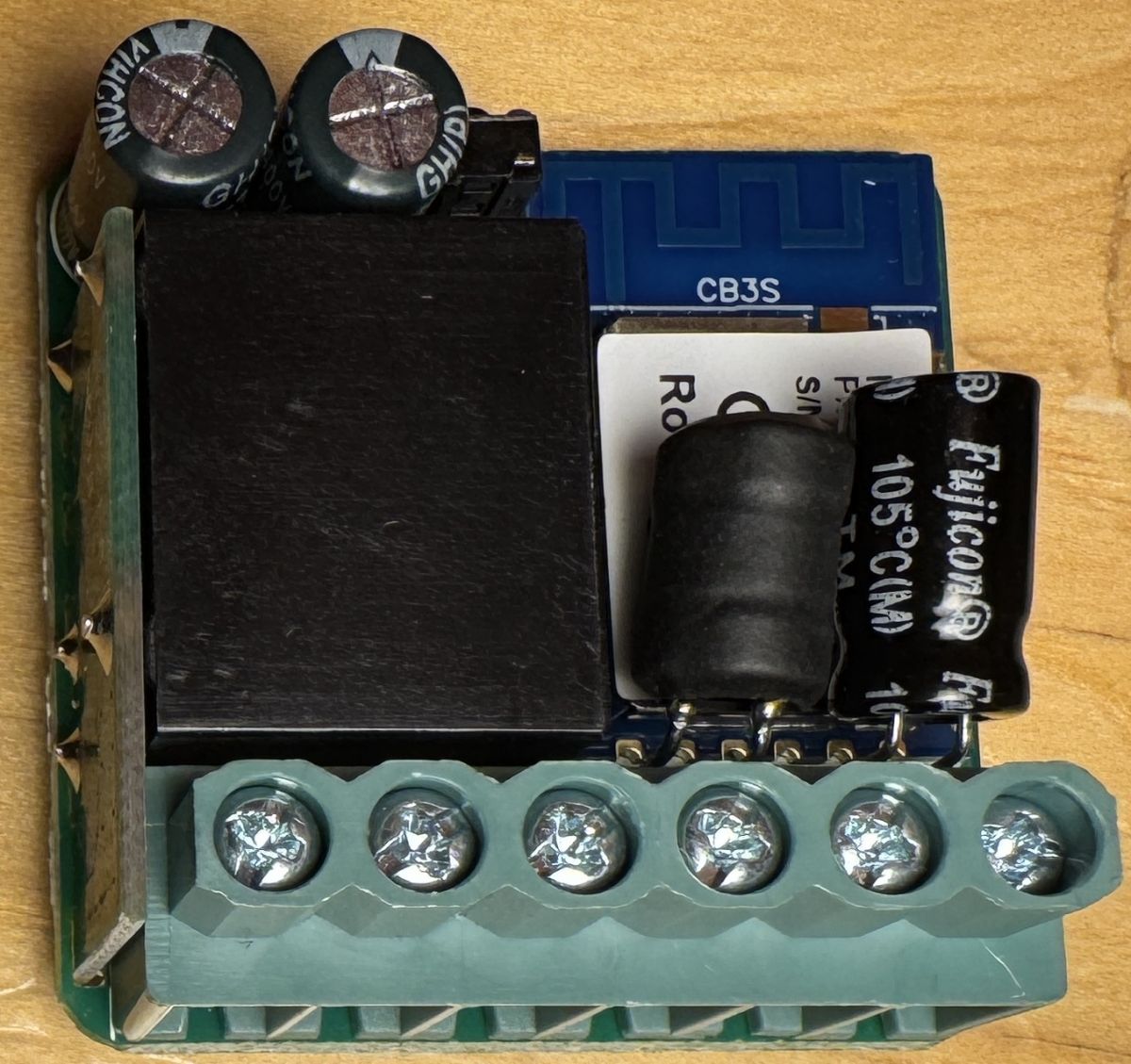

    all the pads are relatively easy accessible

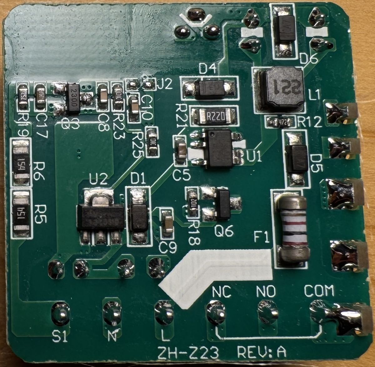

    only the VCC pin is a bit obstructed by a capacitor
    and it discovered the template
       "rl1_lv":"1",
       "on_off_cnt":"10",
       "onoff_rst_m":"1",
       "onoff_clear_t":"10",
       "rand_dpid":"42",
       "net_trig":"4",
       "onoff_n":"5",
       "netled1_lv":"1",
       "jv":"102",
       "onoff_rst_type":"2",
       "total_bt_pin":"26",
       "nety_led":"0",
       "total_stat":"2",
       "reset_t":"3",
       "netled1_pin":"9",
       "remote_add_dp":"49",
       "remote_list_dp":"50",
       "net_type":"0",
       "inch_dp":"44",
       "module":"CB3S",
       "ch_cddpid1":"9",
       "onoff1":"8",
       "clean_t":"6",
       "init_conf":"38",
       "zero_select":"0",
       "onoff_type":"0",
       "series_ctrl":"0",
       "total_bt_lv":"0",
       "cyc_dpid":"43",
       "remote_select":"0",
       "ch_num":"1",
       "rl1_pin":"6",
       "netn_led":"0",
       "ch_dpid1":"1",
       "crc":"66"
    CB3S module with soldered wires on a PCB. CB3S electronic module connected with wires and two probe clips. Electronic PCB module with various components like capacitors and resistors. Labels such as ZH-Z23 REV:A are visible. Electronic module labeled CB3S, capacitors, and screw terminals on a wooden surface. 1CH Wi-Fi switch module with open casing and visible components. Wi-Fi switch module on a wooden table, next to a labeled manufacturer box. Box with text and electronic components on a desk.
    #2 21345981
    Posts: 14749
    Rate: 12849

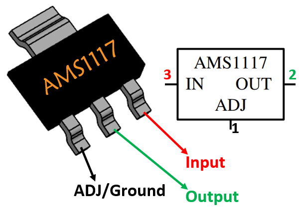

    You can also just solder wires to AMS1117-3.3V pads: Diagram of AMS1117 chip connection.
    Remember to enable PowerSave 1 on this device, so you can avoid doing this fix in the future:
    https://www.elektroda.com/rtvforum/topic3898805.html
