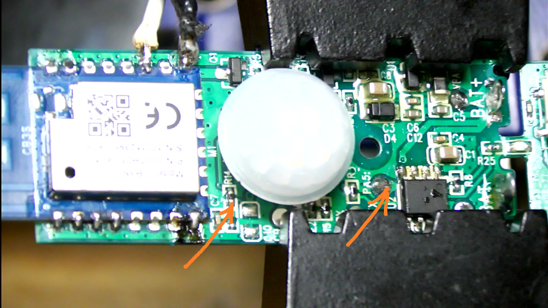

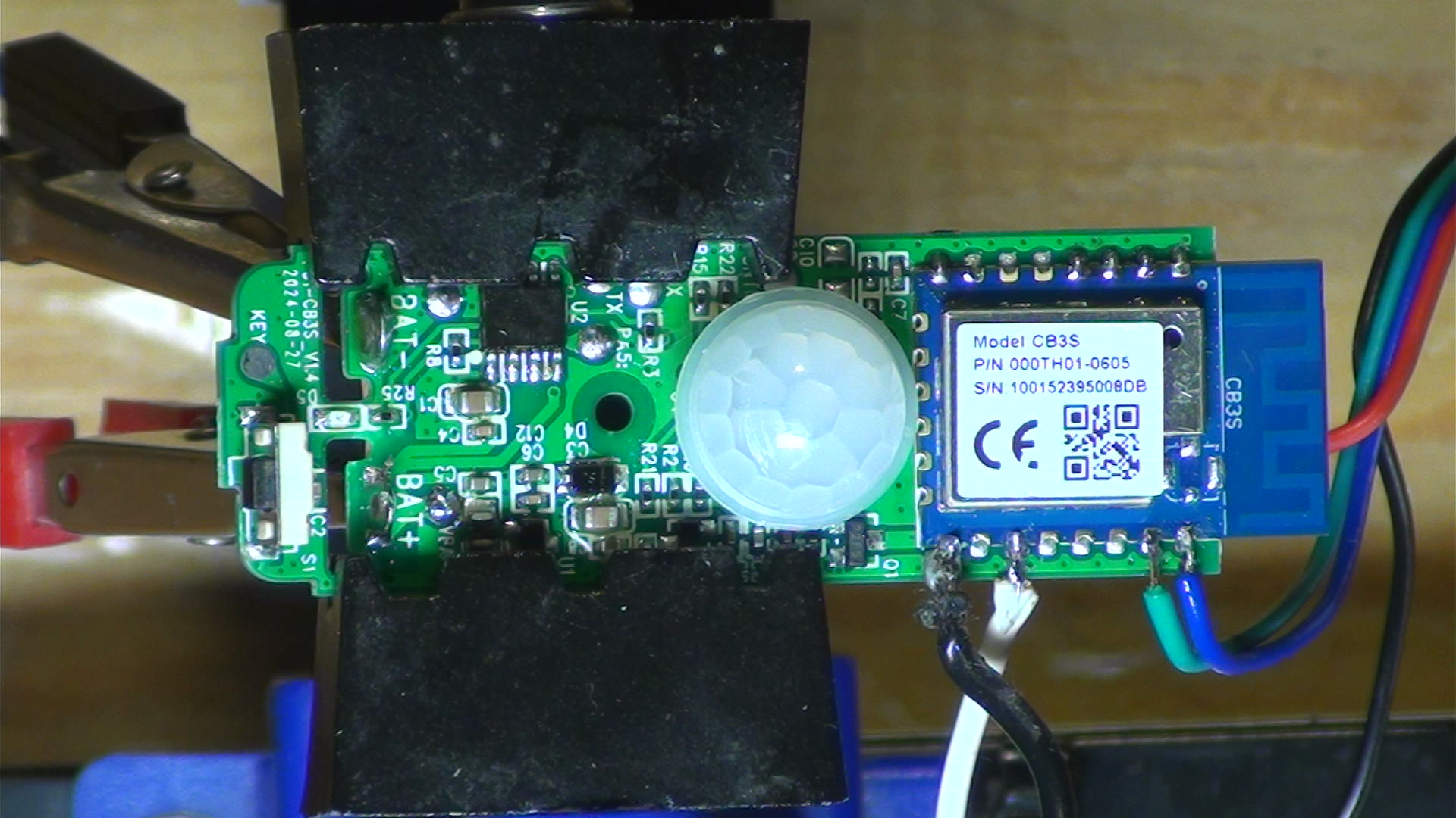

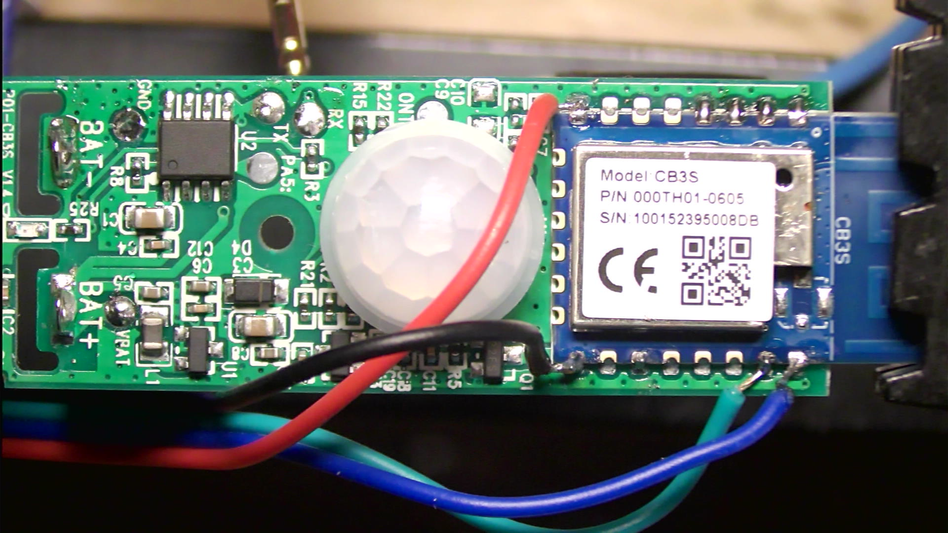

    This is how I wired the device (Green:RX, Blue: TX):
    Close-up of Tuya PIR sensor board with visible wire connections.
    If anybody with more experience with these chips, if you have an idea, please don't hold back! :)
    Added after 14 [minutes]:
    Well, in the meantime I employed a second USB-UART adapter to monitor the chip WHILE trying to reset/flash and I can see that in fact, it does reset. I just didn't think it did, because the red LED kept blinking before-during and after the reset....
    Anyway, the issue still stands, I can't flash it, the flasher tool wouldn't recognize the reset.

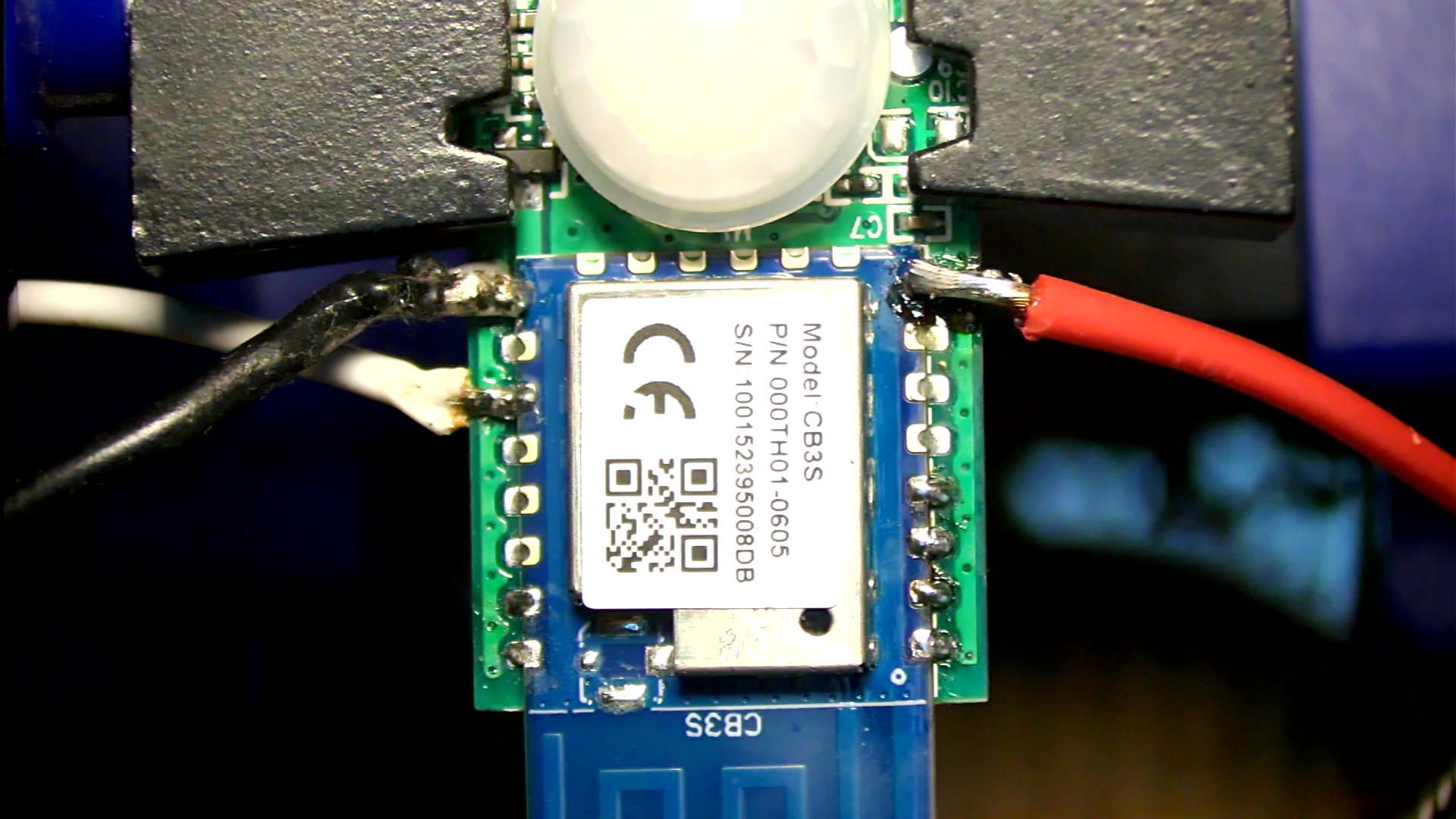

    I removed the 8 pin SOIC, and was able to make a backup of the original flash as well as to flash it with Openbk. The flasher could not get any meaningful config out of the factory firmware.
    Unfortunately, it still doesn't want to work properly: Monitoring the serial output of the chip I can see that it boots up OK, then at around line 191 it resets itself. Here is a sample of the bootloop (I left in 2 full cycles plus a bit so that you have something to look at :) ):

    I made a quick video of what I am doing - no sound. During the first half, the CB3S is powered directly, the second half, it is powered from the battery terminals. You can see the debug output of the CB3S, and you can see that the button press makes little difference.
    Here is the video:
    BTW: I looked at the linked document (from @spin55), but I didn't get much wiser... I don't even know how to put it into pairing mode. Note, this doesn't have the original firmware at the moment. And with Openbk there is nothing to pair - just an access point to connect to. Or I misunderstand something...

    In the video you can see that starting at minute 1:18 and almost at the end, the connection maintenance times go from 8 or 9 seconds to 18 seconds. Maybe if you play with the times you hold down the pairing button you will get it. At the moment, those 18 seconds are not enough.

    Ha! I figured it out:
    After doing some reverse engineering of the PCB I found out that something else controls NOT the 3.3V of the MCU, but the GND... If I connect the power AND the GND directly to the MCU, it stays on and now I can continue with the configuration. You can see the switching transistor above and left of the GND pin:
    PCB with CB3S module and soldered wires.
    Added after 1 [hours] 6 [minutes]:
    Now I got into new trouble... Maybe I should open another thread?
    Take a look at this image:
    Close-up of a circuit board with electronic components and marked connection points.
    The marked points (one side of R14 and test point PA5) are connected. This is the point where the voltage changes as the PIR sensor gets activated: Normally, it is GND level, when there is movement, it raises to around 3 volts, then, after a few seconds, it drops to GND again.
    I didn't find this signal on any of the MCU pins. I.e. none of the MCU pins change level when this point changes. This means that the other chip handles it: It switches on the MCU for a few seconds to report back to the MQTT server, probably it sends data to it so that the MCU has something meaningful to send, then it switches it off.
    Am I in the right direction? I'm concerned that if I have to tap into the serial communication between the SOIC chip and the MCU, I won't be able to continue as I don't have the right equipment for it and it is also a bit more time/effort I wanted to put into getting this bad boy working....

    You have to be clear that this is a device controlled by TuyaMCU chip. The pir signal goes to this chip and it communicates with the wifi module through the Tx and Rx pins.
    Forget about hardware now. Now what you have to do is configure the CB3S wifi chip so that it communicates correctly with TuyaMCU. To do this you have to create a configuration file type autoexec.bat in the corresponding Openbeken tab. To do this, feed it directly as when you programmed it to stay online.
    The content of that file is:
    startDriver TuyaMCU
    startDriver tmSensor
    //setChannelType 1 readonly
    // vincular dpid al canal 1
    //linkTuyaMCUOutputToChannel 1 val 1
    //setChannelType 4 readonly
    // vincular dpid al canal 4
    //linkTuyaMCUOutputToChannel 4 val 4
    //SetChannel 1 2
    Disconnect the Vcc and Gnd cables from the WiFi chip, but leave the Tx and Rx cables. Monitor the Rx and Tx lines separately with Rx from the USB module. I use Realterm, but you can use any other.
    This is to identify the DPid's in the TuyaMCU/CB3S communication. You will see something similar to this:
    55 AA 00 01 00 24 7B 22 50 22 3A 22 4F 6B 75 72 6F 6E 6F 32 58 4C 56 52
    56 30 66 42 22 2C 22 76 22 3A 22 31 2E 31 2E 30 22 7D 19
    55 AA 00 02 00 00 01
    55 AA 00 05 00 0A 65 01 00 01 00 66 04 00 01 03 E3
    If you get this far we continue.

    I added the autoexec.bat file. I also set up the wires as you recommended, plus 3.3V and GND at the battery terminals. However, I don't see any communication between the chips. Not only is the terminal empty, but with an oscilloscope I can see that nothing is happening on the lines, they are constantly at high level. Could this indicate that the SOIC chip is broken?
  • #15 21346772
    spin55
    Posts: 209
    Help: 17
    Rate: 42
    Can you connect Rx of the USB modem to pin 11 of CB3S? Now restart the device.
  • #16 21346784
    vitya123
    Posts: 51
    Rate: 11
    Yes, and I can see the messages coming. And the unit is restarting after a few seconds if I don't play with the button.

    OK, here is a pic of the current setup:
    Close-up of a circuit board with soldered wires and a module labeled CB3S.
    You can see that the thing is powered from the battery terminals. There are wires soldered on each UART line, but only the white one spits out useful info.

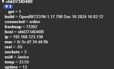

    I updated the autoexec.bat file.
    Aaaaaaa and it is working!!!! When I activate it with some movement, it publishes a 0/1 in the get topic:
    Screenshot of diagnostic data from OpenBK7231N device.
    Excellent!!!! Thank you for sticking with me - even after I lost hope :)
    I documented every step of the way - so in a few days I will write a guide in the new hardware topic.
    Thank you again!!!
