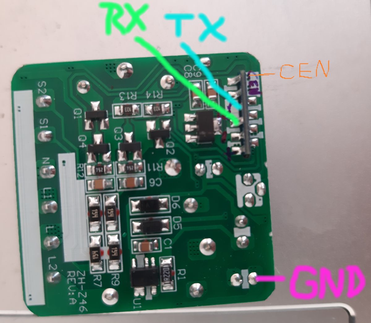

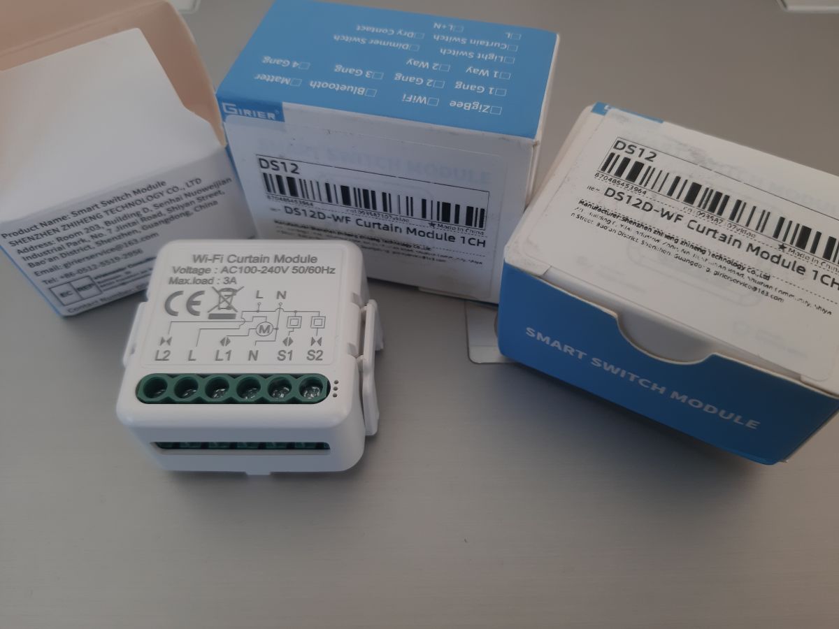

    I have now here a Girier Curtain Module, 1CH in Wifi Version, the Model number is DS12D-WF
    Wi-Fi curtain control module and three boxes labeled Smart Switch Module.
    It can be easily flashed by only connecting RX1, TX1 and Ground.
    A printed circuit board with RX, TX, CEN, and GND pins labeled in color markers.

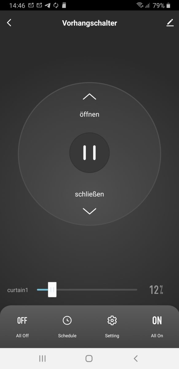

    In Tuya Developer Center we get additional info on this CB2S based device:

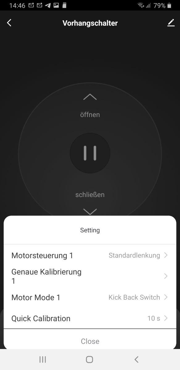

    It looks similiar from outside to the Shutter Controller FS-03W already in this forum, but it is even simpler. The Tuya menu offers settings for motor type (standard or reverse), calibration of run times and switch type (rocker or switch-back). That's all.
    App screen for controlling a curtain switch with visible settings options.
    App screen for curtain control with open, close, and pause options.
    Sadly, it gives no tuya-settings set when doing a read-back of the original firmware, so I'll have to find the settings on my own. Or is there another way to do that?
    Hinzugefügt nach 6 [Stunden] 33 [Minuten]:
    OK, I found by try and error that P7 is the CLOSE-relay and P23 the OPEN-relay. P6 is the LED.
    Still 3 Pins left: P8, 24, 26 for the functions: Input UP, Input DOWN, HW-Button Case.
    How can I find out which is which without destroying anything?
    Hinzugefügt nach 9 [Minuten]:
    P8 is the hardware button in the relays case. P11 ist Stop
    Hinzugefügt nach 11 [Minuten]:
    Done:
      "vendor": "Tuya",
      "bDetailed": "000004j39f",
      "name": "Girier_Curtain_Module",
      "model": "DS12D-WF",
      "chip": "BK7231N",
      "board": "ZH-Z46",
      "flags": "1024",
      "keywords": [
        "TODO",
        "TODO",
        "TODO"
      "pins": {
        "6": "LED;3;0",
        "7": "Rel;1;0",
        "8": "Btn;6;0",
        "11": "Btn;0;0",
        "23": "Rel;6;0",
        "24": "TglChanOnTgl;1;1",
        "26": "TglChanOnTgl;6;1"
      "command": "PowerSave 1",

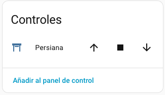

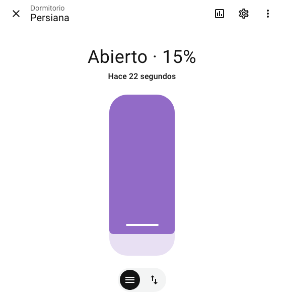

  • #7 21647442
    clasik
    Level 4  
    Posts: 8
    Code adapted to works in ESPHome:
    # Relés del motor (subida/bajada)
    switch:
      - platform: gpio
        pin: GPIO7
        interlock: [down_relay]
        restore_mode: ALWAYS_OFF
      - platform: gpio
        pin: GPIO23
        interlock: [up_relay]
    # LED de estado
    status_led:
      pin: GPIO6
    # Botones físicos en modo pulsador
    binary_sensor:
      - platform: gpio
        pin:
          number: GPIO24
          mode: INPUT_PULLUP
          inverted: true
        on_press:
          - cover.open: shutter1
        on_release:
          - cover.stop: shutter1
      - platform: gpio
        pin:
          number: GPIO26
          mode: INPUT_PULLUP
          inverted: true
        on_press:
          - cover.close: shutter1
        on_release:
    # Persiana controlada por tiempo (para % en HA)
    cover:
      - platform: time_based
        name: "Persiana Dormitorio"
        device_class: shutter
        open_action:
          - switch.turn_on: up_relay
        open_duration: 22s   # ajusta con tu tiempo real de subida
        close_action:
          - switch.turn_on: down_relay
        close_duration: 21s  # ajusta con tu tiempo real de bajada
        stop_action:
          - switch.turn_off: up_relay
          - switch.turn_off: down_relay
    Screenshot showing a window blind control card in Home Assistant with icons to raise, stop, and lower the blind.
    Shutter control interface in Home Assistant showing that the bedroom shutter is 15% open.
