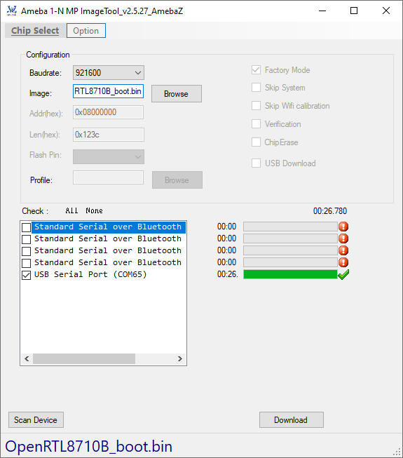

  • #123 21379259
    Posts: 5027
    Help: 438
    Rate: 891

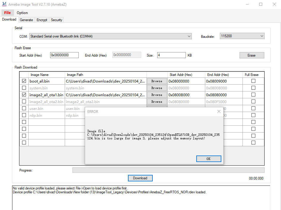

    >>21377607
    which tool are you using?
    Screenshot of Ameba Image Tool V2.7.18 interface showing an error message.

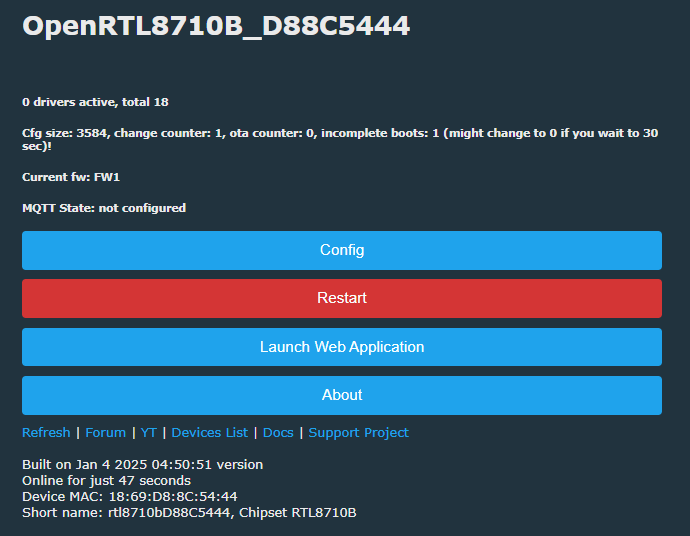

  • #126 21379303
    Posts: 5027
    Help: 438
    Rate: 891

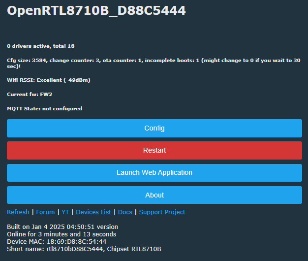

    >>21361242
    T112_V1.1 RTL8710BN
    User interface of OpenRTL8710B_D88C5444 showing device information and configuration options. Screenshot of Ameba 1-N MP ImageTool software with USB port selected.

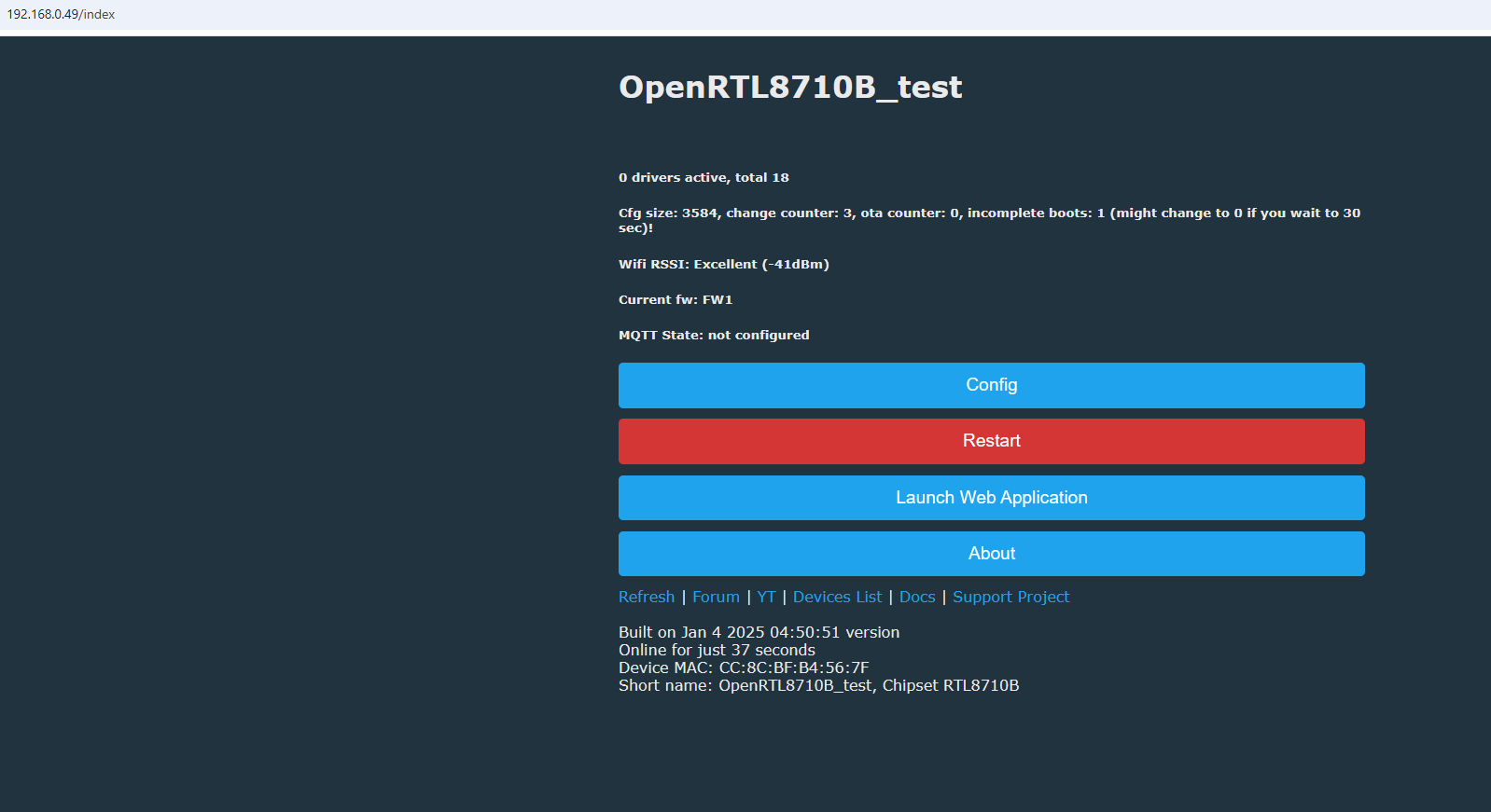

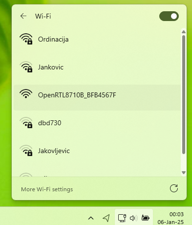

  • #128 21379327
    DeDaMrAz
    Level 22  
    Posts: 601
    Help: 34
    Rate: 129

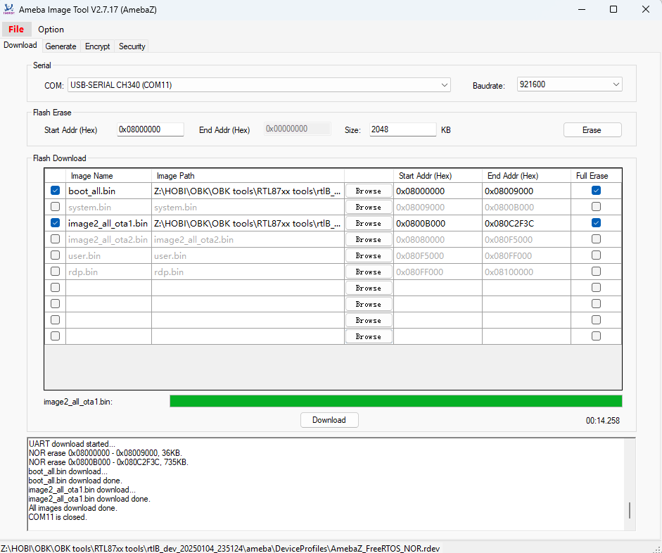

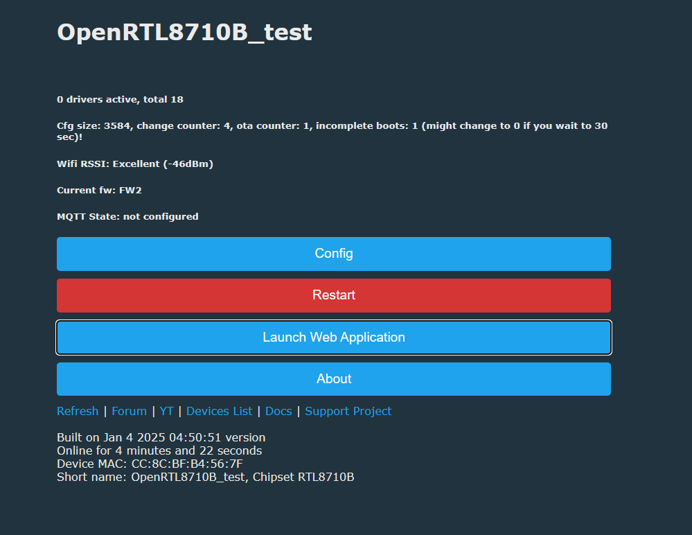

    @insmod Here is the RTL B progress
    Screenshot of Ameba Image Tool V2.7.17 showing binary files to download.
    Wi-Fi network list with OpenRTL8710B_BFB4567F selected, on a green background.
    Screenshot of the OpenRTL8710B_test web interface with configuration buttons.
    OTA passed as well, waiting for new version to test more :)
    After OTA
    User interface of the OpenRTL8710B test on a webpage.
    Added after 9 [minutes]:
    >>21379319
    WiFi LED on static IP is working as well as on DHCP :)

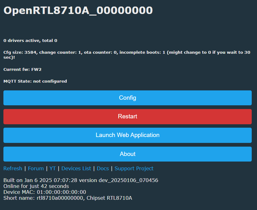

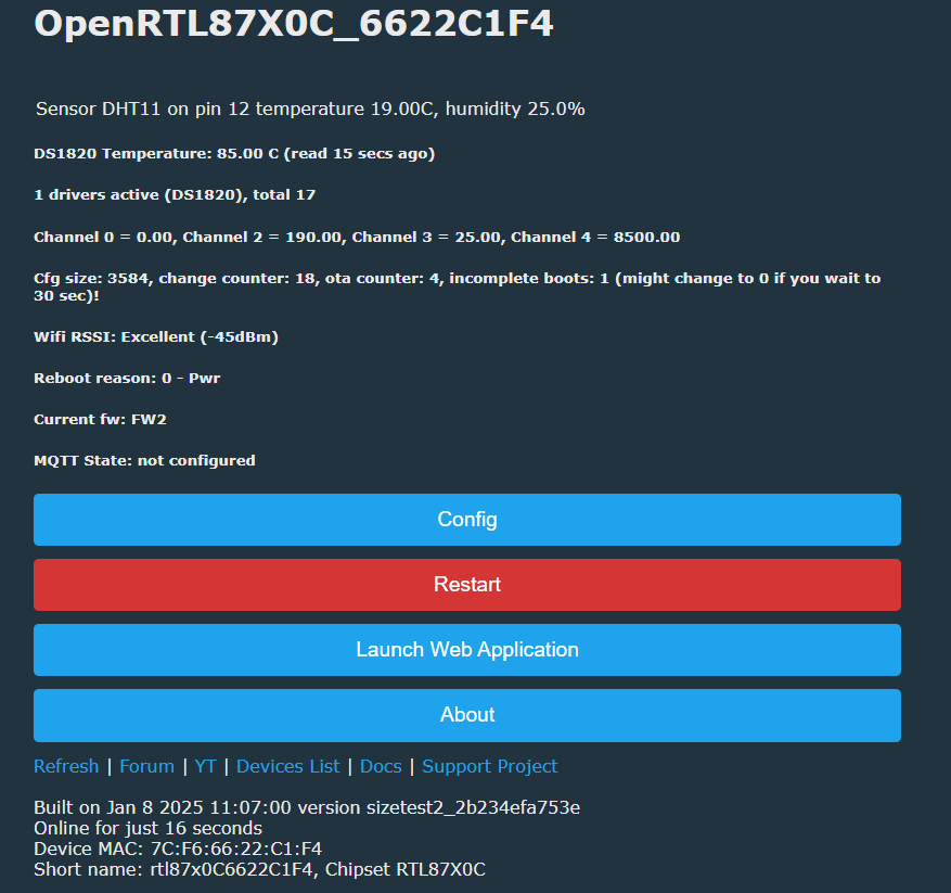

    insmod
    Posts: 1388
    Help: 164
    Rate: 432
    Managed to run on RTL8711AM. But, i had to sacrifice RTL8710A support. (no xip support?)
    There is not enough RAM to run OBK, without moving a large code part to SDRAM, which 8710 lacks.
    OpenRTL8710A user interface screen with configuration buttons.
    This is only ramdebug, writing to flash currently gives
    Image1 length: 0x41fc, Image Addr: 0x10000bc8
    Image1 Validation Incorrect !!!
    Fixed that, now it boots.
    But one problem remains, mac address is zeroed, it is not stored in efuse (at least in the one that can be read, and i remember reading somewhere that it is stored on flash), and LwIP_GetMAC and the device mac i see on router are different.
  • #130 21380578
    Posts: 5027
    Help: 438
    Rate: 891

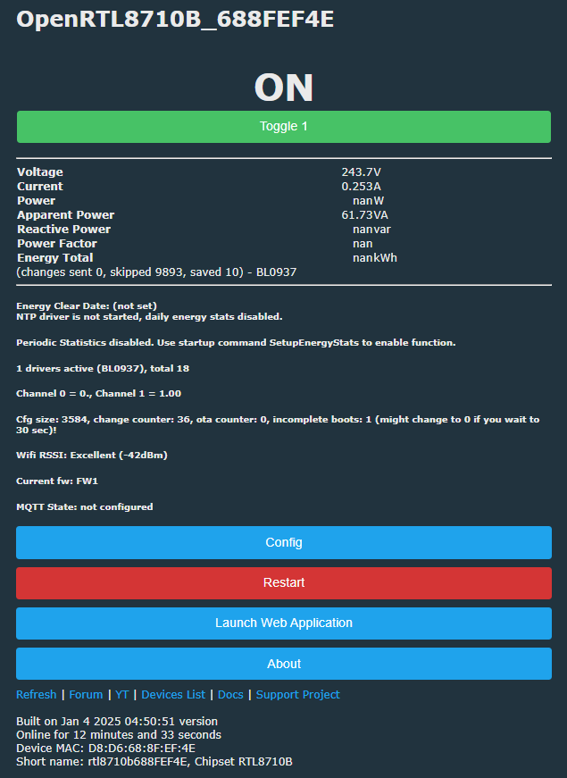

    >>21379303
    my limited fiddling:
    flash OpenRTL8710B_dev_20250104_235124.bin to OTA1 0x0800B000
    OTA to OTA2
    User interface for OpenRTL8710B device displaying status and configuration options.
    try OTA again
    <no reboot, device active>
    <power off/on>
    <boots back up as FW1 - so OTA seemed a success)
    try OTA again
    device boots OK to FW2
    Added after 5 [minutes]:
    did that a few more times. it's always OTA2->OTA1 that doesn't kick off a reboot
    Added after 2 [hours] 53 [minutes]:
    flashed this T102_V1.1 RTL8710BX - almost a year since posting. flashed to factory backup from 0x08000000 then OpenRTL8710B to 0x0800B000. soldered module back
    BL0937 calibrated with 60w bulb
    OpenRTL8710B user interface displaying module status and parameters.
    LED is working as is relay and button
    UPDATE:
    :D
    Screenshot displaying software version and uptime information.

    On RTL8710A static ip is wrongly parsed on save
    IP=192.168.1.176 (c0 00 00 00)
    Mask=255.255.255.0 (ff 00 00 00)
    DNS=192.168.1.1 (c0 00 00 00)
    GW=192.168.1.1 (c0 00 00 00)
  • #139 21384958
    Posts: 14580
    Help: 654
    Rate: 12604
    I know this problem, wait a sec
    See here:
    https://github.com/openshwprojects/OpenBK7231...mmit/6eb8162b456410e1226104148e076303bcd9c8c6
    Or search in SDK for str_to_ip, in this file:
    https://github.com/openshwprojects/OpenBK7231...4148e076303bcd9c8c6/src/cmnds/cmd_tokenizer.c
    We have some kind of sscanf incosistency. I am not the one who created this str_to_ip, it could be done without sscanf... but ok.

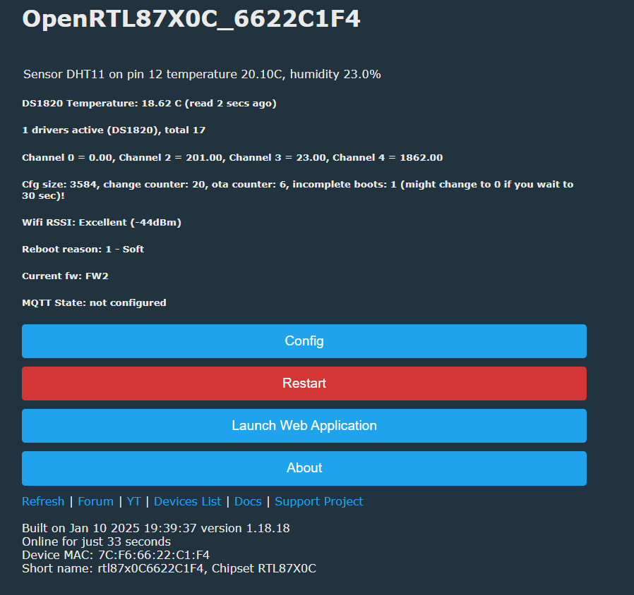

  • #148 21387821
    Posts: 14580
    Help: 654
    Rate: 12604
    I didn't test it yet myself, but we have a report from polish user saying that WBR3 didn't restart for him after OTA 1.18.14 -> 1.18.18 and he had to do power off cycle manually. Still, take it with grain of salt, as I didn't test it yet. I'll try to test it and update, or we can ask @DeDaMrAz
    https://www.elektroda.pl/rtvforum/topic4098222.html#21387354
    Or maybe let me try it now...

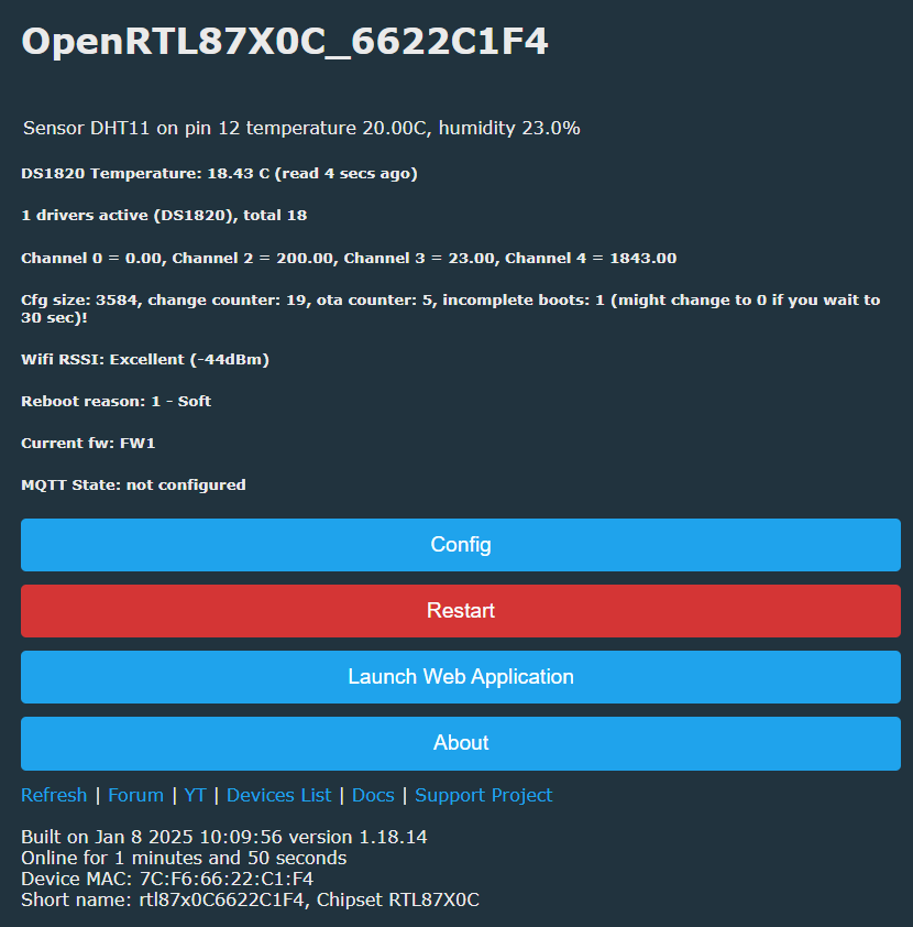

    Before:
    Device management panel of OpenRTL87X0C with sensor data and functions.
    To 1.18.14:
    Screenshot of the OpenRTL87X0C_6622C1F4 device management panel.
    Ok now to 1.18.18:
    Screenshot of the OpenRTL87X0C interface with configuration information and button options.
    Strange, it works for me. I need to ask him for details.
