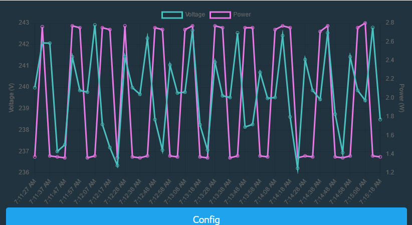

  • BL602 chart setup with temperature and humidity variables

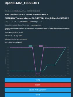

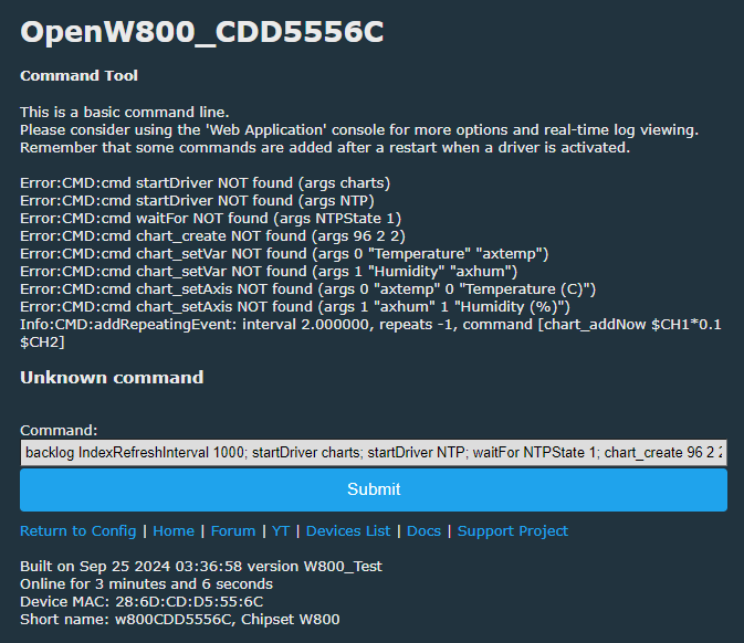

    sorry about lack of progress. tired. brain go-slow. I can carry on with LN/W800 tomorrow if wanted. My W600 isn't ideal for testing sensors (Air602 is in the post though).
    OpenBL602 user interface with temperature and humidity charts.
    BL602 started with command:
    I can do XR809 but still need to remove XR3 from P06 device.
    Added after 29 [minutes]:
    Screenshot of the OpenW800_CDD5556C interface showing error messages in the console.
    would need sensor driver too (AHT, SHT or 83XX) I guess. Unless I did it on LED channel and flicked them on and off for a while?

    W800 uses DISABLE_ALL_DRIVERS so you need to do some tweaks to allow loading and using drivers at all.
    I locally enabled this to use DS1820, so it's working for me as long as I define DS1820, too.
    XR809 is the same, but I never tried to enable it here, for I don't have any of those modules...

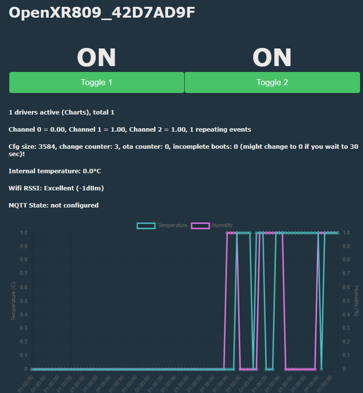

    I know XR809 isn't the focus, but this on the bench right now for other work.
    not sure how far I can get with no ntp driver. shall I forget XR809?
    OpenXR809 interface with toggles and temperature and humidity charts.
    this is me toggling switches manually.
    same backlog single line of commands as BL602 above. it's filling the bottom with sample dots and the pattern moves off the the left without issue. Not sure if this the test you're looking for.

    Thats fine, thanks. If the chart is drawn, that's all we need to know, for the handling of data is the same for all devices.
    I didn't want to focus on XR809, it was only a good opportunity to test the idea of a "reduced" driver support for devices with DISABLE_ALL_DRIVERS.
    I came to the same situation while doing the DS1820 driver for W800 and used it again here for the charts driver.
    It's simply allowing three functions: starting a driver, calling "on every second" and adding HTML to status page.
    So your feedback is very helpful for me, showing it works for different platforms.
    Details filled in soon, it's just three lines or so.

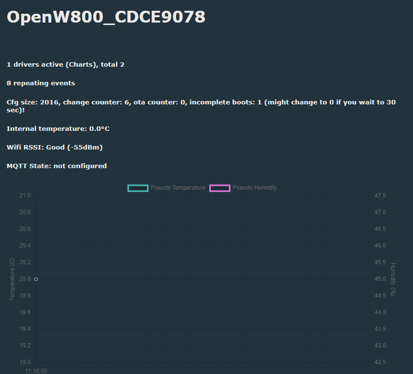

    Just as an idea, this should "emulate" some temp and hum data, even without time/ntp:
    backlog  startDriver charts; chart_create 96 2 2; chart_setVar 0 "Pseudo Temperature" "axtemp"; chart_setVar 1 "Pseudo Humidity" "axhum"; chart_setAxis 0 "axtemp" 0 "Temperature (C)"; chart_setAxis 1 "axhum" 1 "Humidity (%)"; addRepeatingEvent 2 -1 chart_add 1727438906+$uptime 20+5*$rand01 40+5*$rand01;
  • W800 startup command length limits require WebApp setup

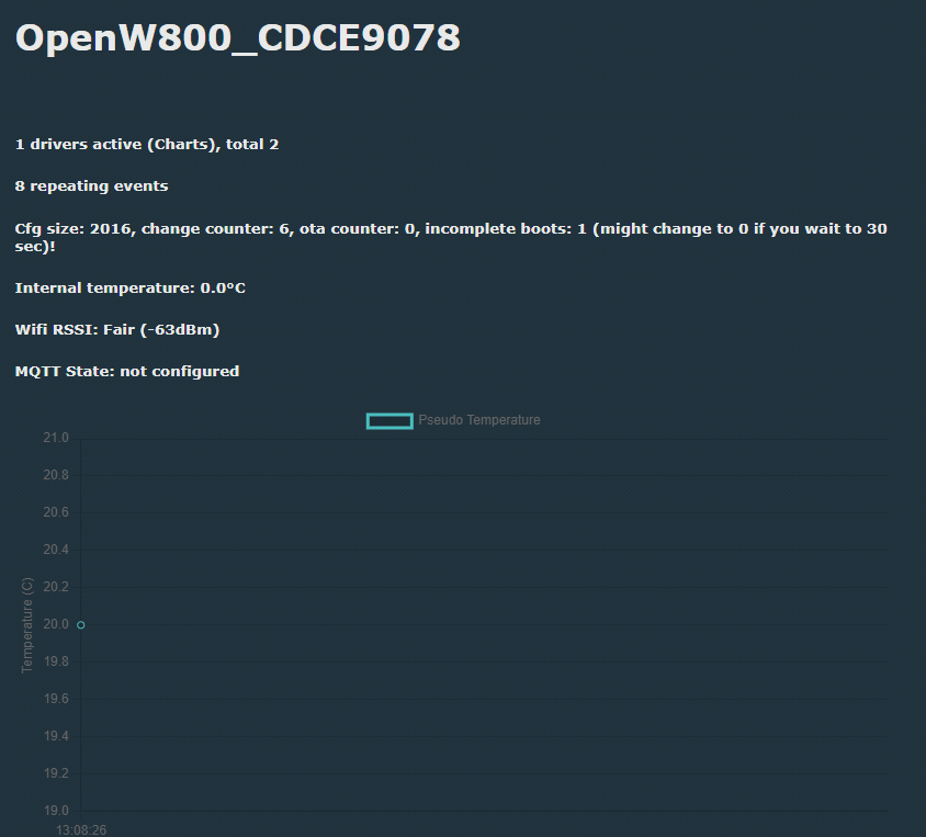

    #41 21242165
    Posts: 5220
    Help: 449
    Rate: 918

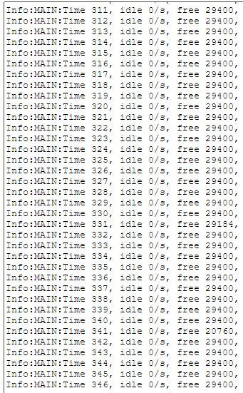

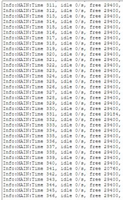

    cheers. that gives me a single straight line on W800. This is even more manual but still serves to demonstrate:
    W800 startup command doesn't seem to support very long strings, so has to be run from WebApp.
    Temperature chart on the OpenW800 interface with system status described.
    seems stable. not eating memory
    Screenshot of system logs showing information on time, idleness, and available memory.
    Is leaving that above command running overnight on several platforms a worthy test or are you pretty confident at this point and PR is ready for merging?
    Added after 8 [minutes]:
    and with humidity, just because.
    Screenshot of the OpenW800_CDCE9078 interface displaying temperature and humidity data.
  • Circular y-axis labels and no memory leak

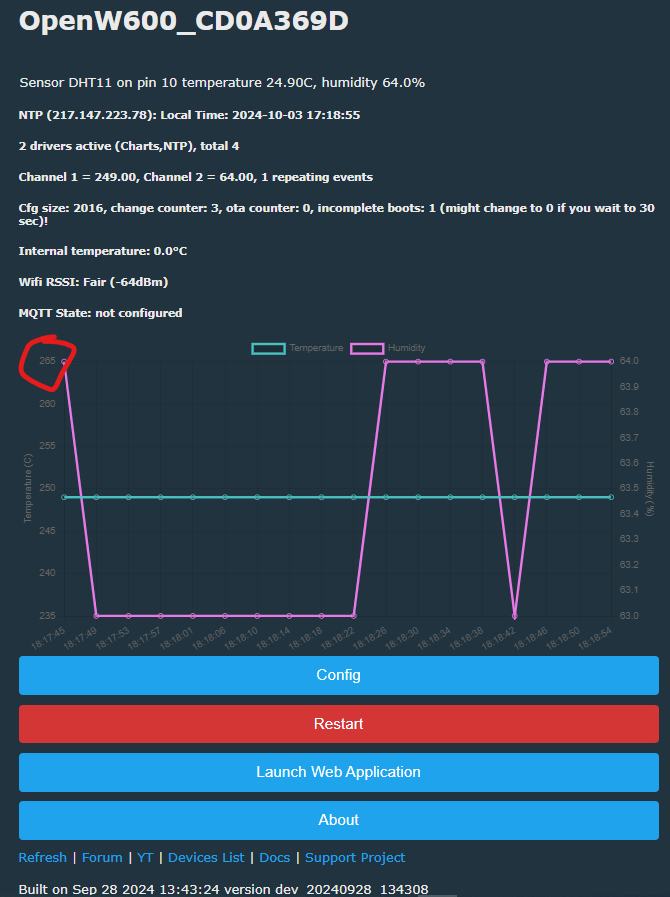

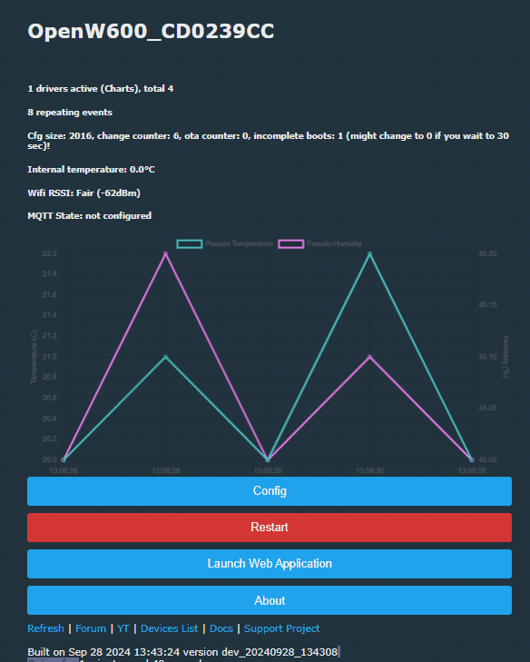

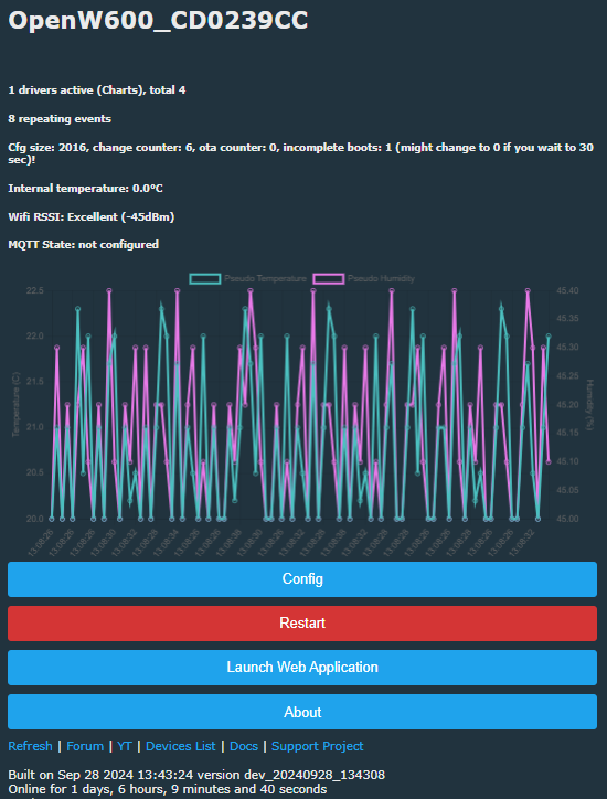

    #46 21244282
    Posts: 5220
    Help: 449
    Rate: 918

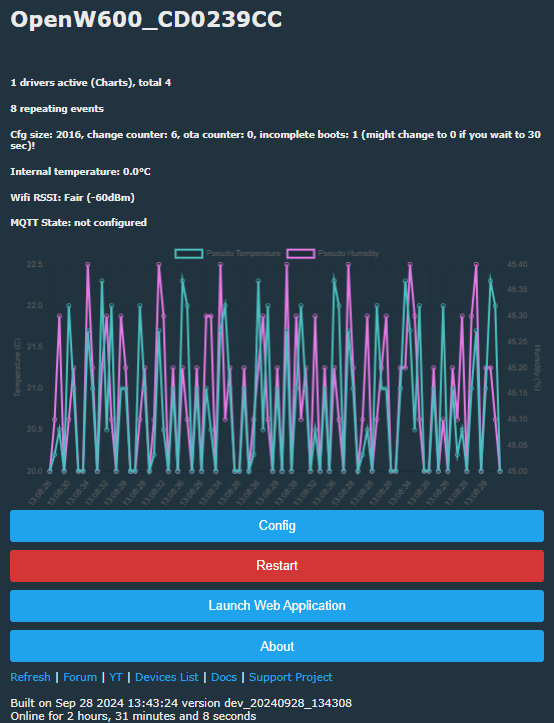

    I appreciate this is only one test, but I'll leave this W600 going all night. Shows W600 working anyway.
    OpenW600 user interface with temperature and humidity chart.
    Added after 7 [hours] 35 [minutes]:

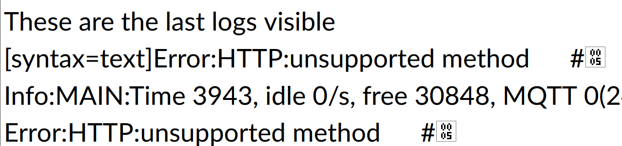

    so this may not have anything to do with Charts driver, but W600 is unresponsive this morning.
    the following was true:
    -web app logs page was left open in the browser
    -OBK main GUI with chart drawing was left open in another tab
    -the device is still responding to pings
    These are the last logs visible
    I'll start W600 again but with no pages left open.

    Reading the source in src/httpserver/new_http.c
    https://github.com/openshwprojects/OpenBK7231...9539d7e2677b65/src/httpserver/new_http.c#L628
    this means, there was a request on HTTP port other than the supportet methods ("GET", "PUT", "POST", "OPTIONS"):
    The code line for this error message is:
    ADDLOGF_ERROR("unsupported method %7s", recvbuf);

    Error:HTTP:unsupported method      #
    ------------------------------1234567
    looking in the source of your post, there is a char 0x05 (^E) after the "#", don't know if this is from the output or from copying the output:
    Screenshot of logs with HTTP error messages.
    So at least the error messages seem to be from another source than the charts driver or the used ringbuffer.
    The constant memory usage also looks good for me ...
  • Memory drop observed after extended uptime
    #48 21244441
    Posts: 5220
    Help: 449
    Rate: 918
    very interesting. thank you.
    since earlier, it's been up for over twice the length of time now. Again, this is with no active browser sessions to device.
    Screenshot of OpenW600_CD0239CC control panel with charts and configuration options.
    hmm. can't recall. I should have screenshot. If this is of interest I can try to replicate and screenshot...

  • Working chart_create backlog for voltage and power
    #51 21245745
    max4elektroda
    Posts: 758
    Help: 49
    Rate: 189
    For me this command works:
    backlog startDriver charts; startDriver NTP; waitFor NTPState 1; chart_create 48 2 2; chart_setVar 0 "Voltage" "axv"; chart_setVar 1 "Power" "axp"; chart_setAxis 0 "axv" 0 "Voltage (V)"; chart_setAxis 1 "axp" 1 "Power (W)"; addRepeatingEvent 5 -1 chart_addNow $voltage $power
    Screen with energy data and a graph of voltage and power.

    Screenshot of the OpenW600 interface showing temperature and humidity graphs.
  • #53 21246385
    jpduhen
    >>21245745 Thanks, it now shows the graphs.
  • waitFor command missing and temperature scaling wrong
    #54 21249276
    Posts: 5220
    Help: 449
    Rate: 918
    just playing with a W600 and a real sensor.
    gives
    Info:MAIN:Started NTP.
    Error:CMD:cmd waitFor NOT found (args NTPState 1)
    Info:CMD:addRepeatingEvent: interval 2.000000, repeats -1, command [chart_addNow $CH1*0.1 $CH2]
    Info:CMD:[WebApp Cmd 'backlog startDriver charts; startDriver NTP; waitFor NTPState 1; chart_create 96 2 2; chart_setVar 0 "Temperature" "axtemp"; chart_setVar 1 "Humidity" "axhum"; chart_setAxis 0 "axtemp" 0 "Temperature (C)"; chart_setAxis 1 "axhum" 1 "Humidity (%)"; addRepeatingEvent 2 -1 chart_addNow $CH1*0.1 $CH2' Result] Unknown command
    and the temp isn't /10
    User interface with temperature and humidity charts and device configuration details.

    Finally got it working:
    Graph showing changes in voltage and power over time.
