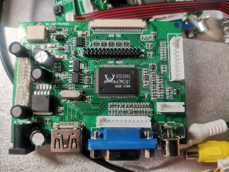

    PCB with RTD2660 chip and video ports

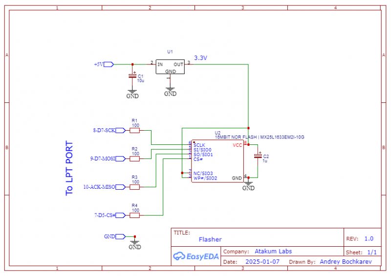

    Modifying the software using the Arduino .
    As for adapting the code to the matrix, at first glance this may appear to be a cumbersome affair. However, it only looks that way.
    A property of the controllers, based on the RTD2660 processor, is that the control code is on a 25x40 EPROM memory chip. So we need a SPI programmer for these cubes. It can be any one you like. You can even use the parallel port of an old computer. Schematic below.
    I have neither a specialised programmer nor a serial port. I used an Arduino. There is a lot of information about programming an SPI device using it, including on our forum.
    You can connect the chip to the programmer using wires, no soldering is necessary. You just need to connect the ground and the 3.3 V supply. I don't recommend using long wires, because interference can cause errors. First, using the programmer, we read out the already recorded code and save it on the hard disk (or pendrive) just in case.
    Next we run the programme: "Control code configuration". This was developed thanks to a ZX-PK forum member named Valerim. He managed to find the code sections that are responsible for the resolution and the image location. The configuration programme makes it easy to make changes to the code without having to search for the relevant parameters there.. We open the file with the one read earlier and modify it according to the characteristics of the matrix and our own requirements.

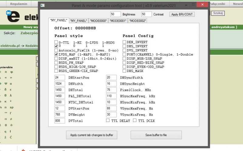

    Panel and mode parameter configuration software
    Tile code control panel.
    Basic configuration .
    In the first case, everything is clear. We look in the Datasheet and set the resolution according to it in the "My panel" menu. There this valence is marked twice, so we enter it twice. After the change, we press the "Apply current tab changes to buffer" button.
    After correcting the matrix indicators (if the need arises at all), we go to the "MODE000x" menu. There, we change the three qualities - needed vertical resolution, horizontal resolution and frequency - according to these computer factors. If you want to get the best image quality from your computer on a matrix with a high resolution, you should select a number higher than the original. For example, the ZX-Spectrum produces a video signal with a resolution of 768х288, in which case a better result can be obtained by fixing 1536x576. Provided, of course, that the matrix allows this, i.e. has a higher resolution.
    After making all the changes in both menus, we press "APPLY BRI/COUNT". With this program we can also determine the brightness and contrast (with the sliders at the top). However, the exact values can only be determined after the monitor has been switched on for the first time. Before this, the modified file is uploaded (using the programmer software!) to the EPROM memory cube, the programmer is disconnected from the board, the buttons and power supply are connected. The image may not be exactly in the centre of the screen. This can be corrected using the controller menu. However, this operation is not always successful. In this case, disconnect the power supply, plug in the programmer, and determine the new image location values. Then upload the new file and repeat the steps.

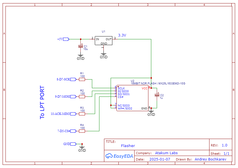

    DOS-LPT programmer schematic with ICs and connections.
    Schematic programmer via DOS-LPT.

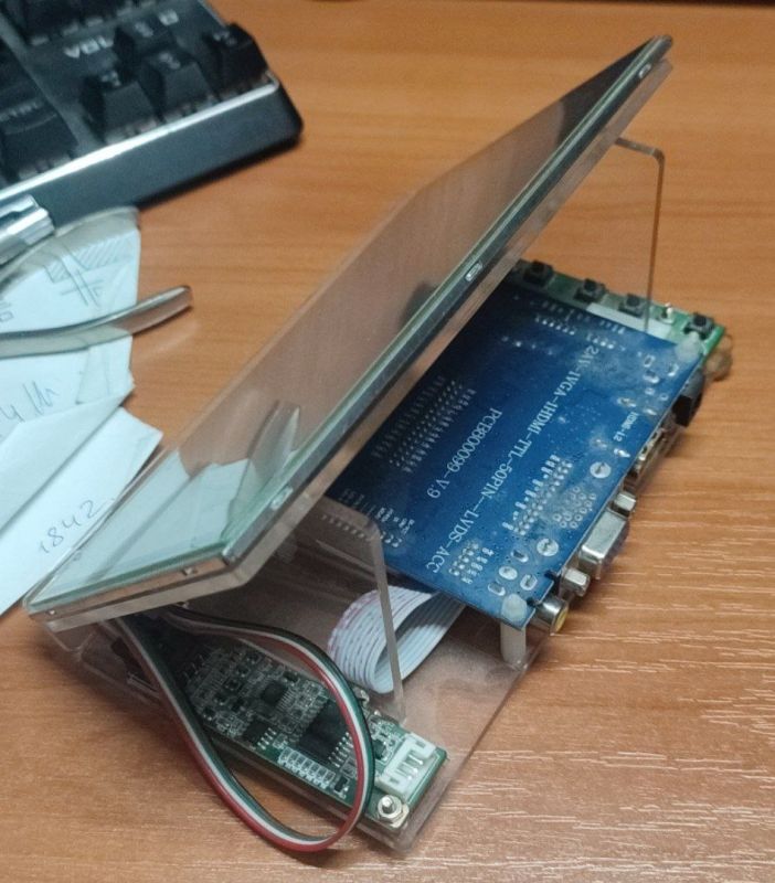

    Do you have any photos of the finished product i.e. the Retro Monitor or is it just a display matrix?
  • #16 21395822
    andreyatakum
    Posts: 836
    Rate: 1156
    >>21395658 .
    Electronic kit with display and circuit board on a desk.
    Interesting, but no one has pointed out that this universal tile by the preprogramming I recommended allows you to place the image anywhere and even reduce the border on the ZX Spectrum.

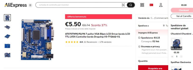

    The post is from 2025 but I see these interfaces on Ali for a minimum of PLN59.
    On allegro you have a Dell U2410f (e.g. auction 17131151671) without the cradle for 70zł. See what sockets it has, your eyes will pop out :) .
  • #19 21397365
    andreyatakum
    Posts: 836
    Rate: 1156
    xangel wrote:
    Post is from 2025 but I see these interfaces on Ali for a minimum of PLN59.
    Screenshot of an AliExpress offer featuring an LCD controller board.
    Added after 1 [minute]:
    A couple of months ago it was €4.5
  • #20 21397377
    xangel
    Level 19  
    Posts: 543
    Rate: 147
    I typed in PCB800099 and it has different prices, but all in all a module is a module.
    But it jumps you a 37% discount there
    Are you logged in? Because often these prices are just decoys and then when you log in the price is different.
    Give the auction number

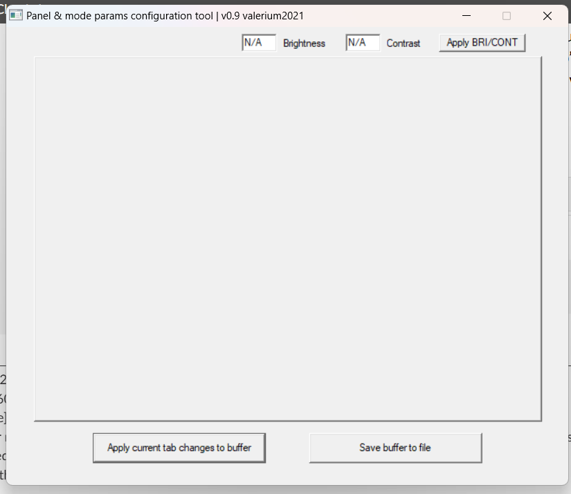

  • Question about newer RTD2660 configuration tool for PCB800809
    #23 21424312
    salacpavel
    Level 4  
    Posts: 6
    salacpavel wrote:
    I was wondering if the "Sensible Code Configuration" is really the "Configuration.exe program" from rtd26660.rar, or should I download it elsewhere? If so, could you point me/us to the download location?
    Well I think I have my answer now. Turns out it may work, just not with flash image taken from my board. It took like 15 minutes then finally this window poped up.
    I do not suppose there is another/newer version of this tool to work with PCB800809 board?
    Screenshot of panel and mode parameters configuration tool with an empty window. .
    You can upload the file from the EPROM to correct it by the program "Panel and mode params...."-.

    I read and write Flash on my old laptop via the LPT port with the proposed program in DOS, only that I found a newer version that already identifies the ZB25VQ40 memory. The recommended version does see the signature, but does not read the type and manufacturer because they are not in the library. But that doesn't change things.
    The only thing I can add to the article is that, when performing operations via the LPT port, a logic converter from 5V to 3.3V should be installed. The fact that you can manage without it, but there is a danger of flash damage, or at least various irregularities in communication. Anyway, on the ZX-PK forum this was also mentioned.
  • 5V-to-3.3V level shifting needed for LPT programming

    Marek Matysek wrote:
    The only thing I can add from me to the article is that, carrying out operations via the LPT port, it would be necessary to install a logic converter from 5V to 3.3V. The fact, that it is possible to do without it, but there is a danger of flash damage, or at least various irregularities during communication. By the way, on the ZX-PK forum this was also mentioned.
    Right, but I don't have an LTP port so I was reviving the arduino as a programmer. For many of the participants on the Russian language forums, this turned out to be the only solution to the problems of reading and uploading codes into the EPROM of this board.

  • Asking for a Conftool-edited bin to test on same board
    #29 21445492
    Marek Matysek
    Level 20  
    Posts: 388
    Help: 24
    Rate: 28
    Andrey, on those forums you gave links to, people are struggling with flash programming on the board, through various programmers including Arduino. I don't have these problems. I have kept an old laptop that has everything a self-respecting computer should have. From DOS or MS-DOS in Win98 I read and write without error. The same bin I read I upload again and everything works. I have no interference from the RTD side. I also uploaded the bin that Pavel posted and it also worked. Admittedly the image was inverted and mirrored, but this can all be set in the Menu accessible from the keyboard.
    I don't want to repeat what I mean, as I wrote about all this in my previous entry.
    An idea occurred to me. Do you have the same board? Did you edit your bin from that disc in Conftool? If so, can you post (upload to P.W.) it on the forum. I would like to see if it can be edited at my place and if it will work in my board. Maybe that way we can get to something.
    An idea occurred to me. Do you have the same plate?
    Unfortunately I damaged my disc not long before this article was published. But I have the file saved somewhere. If I can't find it I'll ask a friend.
