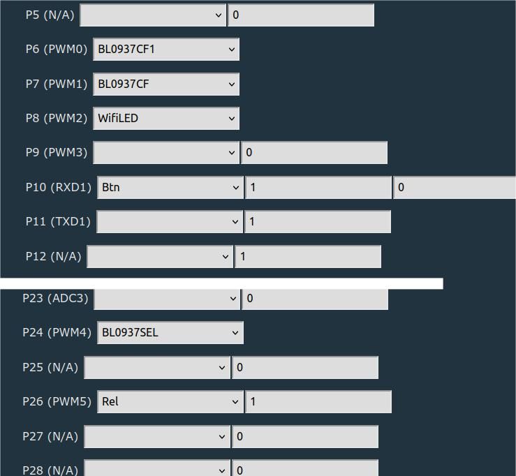

    I have several WiFi sockets (BK7231N (CB2S), BL0937). The same is entered under "Configure Module" and "Configure Flags". The Openbeken version is 1.17.592.
    I have now flashed seven new WiFi sockets. They work as intended, except that nothing happens when I press the button. With my older WiFi sockets everything works. What could be wrong?

    Are you sure that you have chosen correct pin for the button?
    Do config extraction:
  • #3 21392375

    Here it is:
    - BL0937 SEL on P24
    - Button (channel 1) on P10
    - BL0937 VI on P6
    - WiFi LED on P8
    - BL0937 ELE on P7
    - Relay (channel 1) on P26
    Device seems to be using CB2S module, which is using BK7231N.
    And the Tuya section starts at UNCOMMON POSITION 0
    Screenshot of the device configuration extracted from Tuya.

    Pin 23: Btn on channel 1 works :-)
