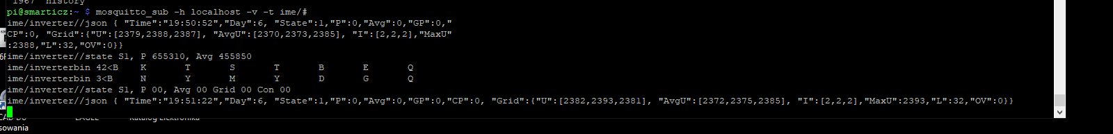

  • #33 21420459
    Daro1003
    Posts: 2713
    Help: 295
    Rate: 606

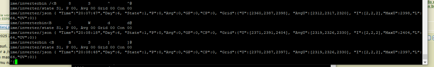

    in screen ctrl and c
    and I fired back
    after which :
    Screenshot of a terminal with MQTT subscription results containing inverter data. .
    in NodeRed no change.
  • #34 21420465
    michal.zd
    Posts: 1684
    Help: 84
    Rate: 274
    😄 space removed from there too. See the inf from mosquitto, there can be no spaces in the topic
    Between the word inverter and /state and /json
    Simply in the etc/ime file you have an unnecessary space after the topic name.
    I have not immunized the program against this.

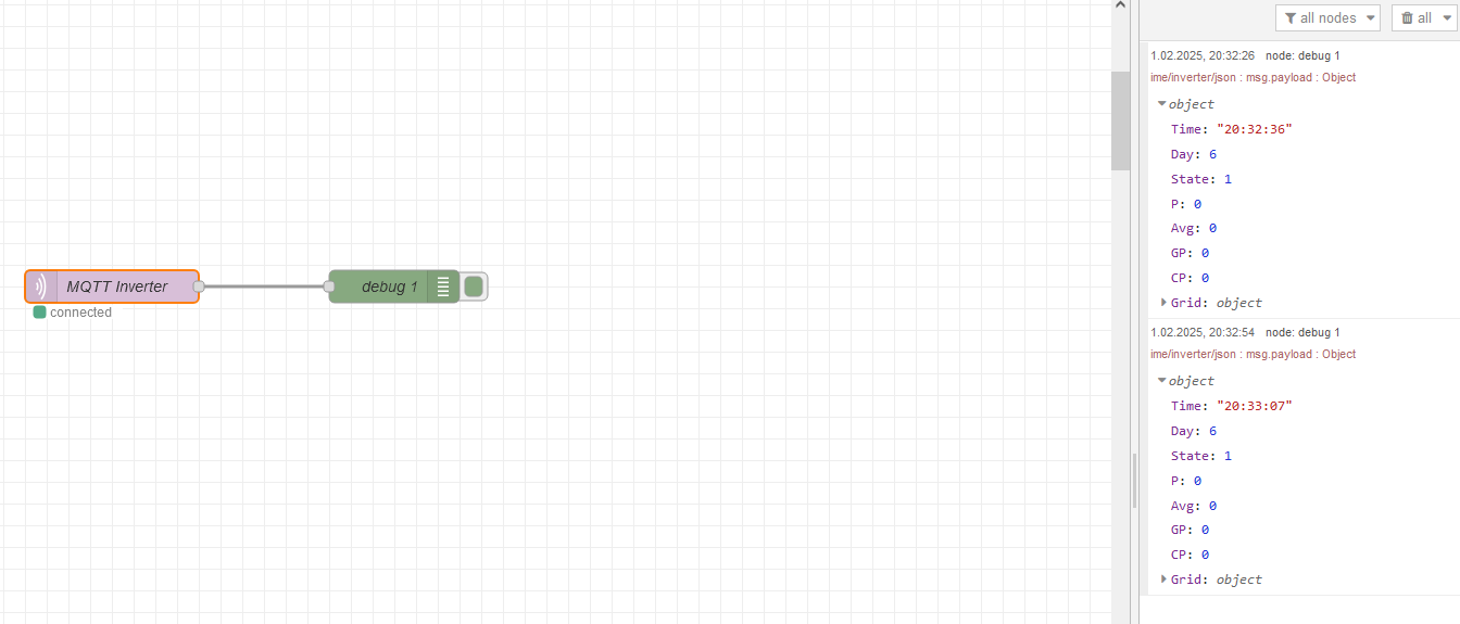

  • #35 21420478
    Daro1003
    Posts: 2713
    Help: 295
    Rate: 606

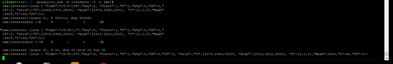

    That's what I thought I saw that there was a space between the / / I removed one it looks like this:
    Screenshot of a terminal displaying JSON messages from an inverter.
    But in the node still nothing:
    Data flow diagram in Node-RED with MQTT and debug nodes. .
  • #36 21420505
    michal.zd
    Posts: 1684
    Help: 84
    Rate: 274

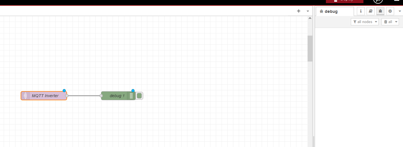

    Deploy you have to press. The red button and the dots above the node indicate that you have not saved this flow to the server. Press the red Deploy button.
  • #37 21420512
    Daro1003
    Posts: 2713
    Help: 295
    Rate: 606
    I still did a reboot of RBPi in the meantime and restarted but it did nothing.
    As you wrote deploy and it flies:
    View of Node-RED tool with connected blocks MQTT Inverter and debug 1, and a debug panel on the right. .

    I don't know if you've noticed, but the G parameter also blows some number out of the water when there's not too much production as you can see in the screenshots today.
  • Raw inverter data still needs plus-minus correction

    Because Grid also has negative values when it draws from the grid.
    Anyway, in the uploaded data from the broker, I specifically left the raw data from the inverter to see exactly what is there. Now after your tests you can give plus/minus accordingly.
    The data for mosquitto also had such high values, I will correct all of this tomorrow and give it for testing.
    On the minus it goes down in the evening, when there is already a lack of energy from the pv, also you can do the test right then.

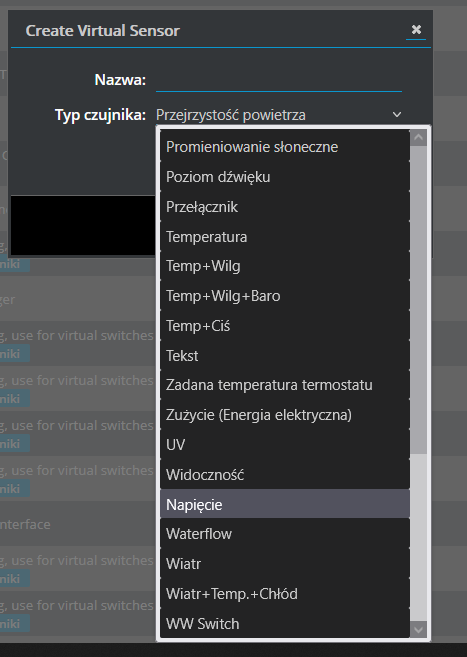

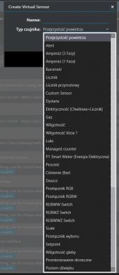

    It is a bit of a problem how to fly current and voltage data in one because there is no block in Domoticz to have these two indications together.
    You can make a current block and a voltage block but that's two blocks and two different IDYs.
    Screenshot of the Domoticz virtual sensor creation interface with a dropdown list of sensor types. .
    This is the case for temperature and humidity but unfortunately current and voltage are separate.

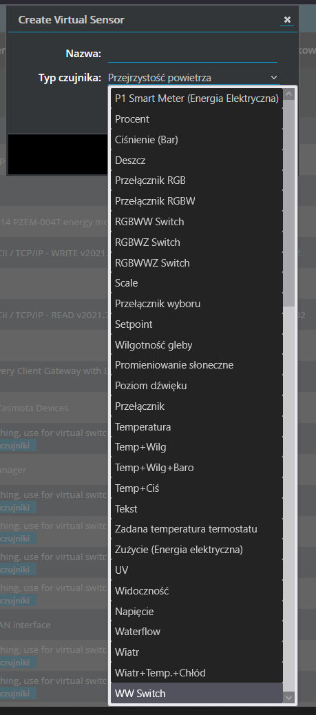

    #50 21482756
    Daro1003
    Posts: 2713
    Help: 295
    Rate: 606

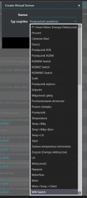

    michal.zd wrote:
    What's on that list in the picture?
    This is the menu for creating a sensor and we have what is on the list to choose from:
    Virtual sensor creation interface with a dropdown list of types. Virtual sensor creation interface with a dropdown menu for selecting sensor type. .

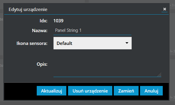

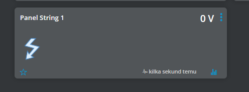

    And that's it, once the name is selected and entered, the finished sensor-block with IDX appears:
    View of a sensor panel named Panel String 1 with a lightning symbol, showing 0 V. .
    You can go into the edit options and that's it altogether name icon description:
    Sensor editing menu with settings and options. .

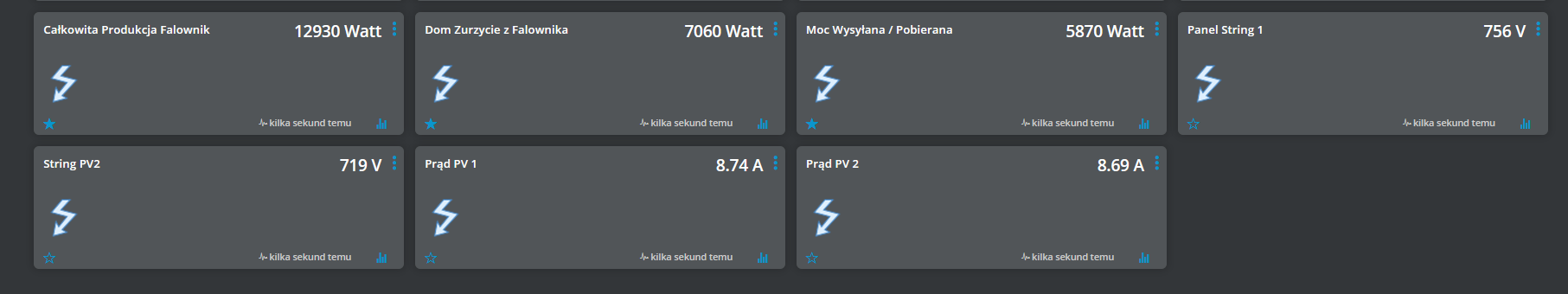

    #55 21483283
    michal.zd
    Posts: 1684
    Help: 84
    Rate: 274
    I have added the voltage and current information of strings PV1 and PV2 as four mqtt messages.
    The voltage and current will be shown in two messages, as agreed with @Daro1003
    into the configuration file in etc/time/inverterbroker
    specify idx according to domoticz.
    #domoticz
    domoticz_topic       domoticz/in
    domoticz_inverter_state    1020
    domoticz_pvpower_idx    1026
    domoticz_gridpower_idx    1027
    domoticz_consumption_idx 1028
    # informacja o napieciach i pradach stringów PV
    domoticz_pv1_voltage_idx  1030
    domoticz_pv1_current_idx  1031
    domoticz_pv2_voltage_idx  1032
    domoticz_pv2_current_idx  1033
    The program as usual can be downloaded on Git.
    https://github.com/michalzd/pvInverterBroker/...mqtt/dist/Release/GNU-Linux/RaspberryPi/ARM11
    There is also a sample configuration file: https://github.com/michalzd/pvInverterBroker/tree/mqtt/dist/etc
    which must be located in the /etc/ime directory
    In addition, there is also a configuration file for the service run by system.d : https://github.com/michalzd/pvInverterBroker/tree/mqtt/dist/service_config/lib_systemd_system
    this file must be in the directory: /lib/systemd/system/
  • #56 21483603
    Daro1003
    Posts: 2713
    Help: 295
    Rate: 606
    It is already working for me:
    Control panel displaying data on energy production and consumption. .
    Thanks @michal.zd you are GREAT.
  • #57 21483631
