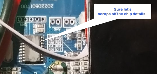

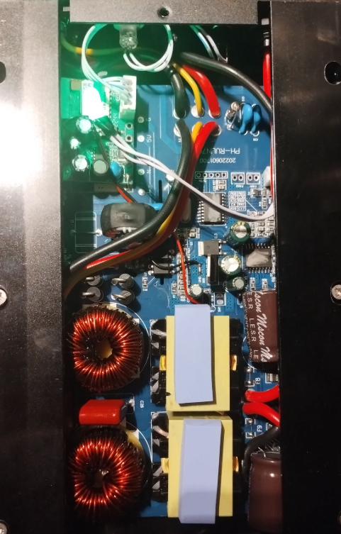

    Inside view of a solar micro inverter with electronic components.
    Close-up of a microinverter circuit board with obscured chip details.

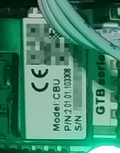

    Close-up of a microinverter chip with model CBU and GTB series markings.

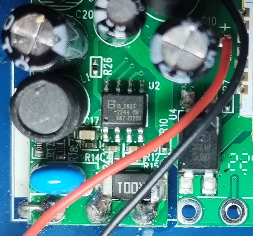

    The power measurement breakout board uses a BL0937 so I'll try that one first.
    Close-up of a circuit board with BL0937 integrated circuit and attached wires.
    tuyaMcu_defWiFiState 4 halts the BK and led starts flashing rapidly. Will try other wifi states.

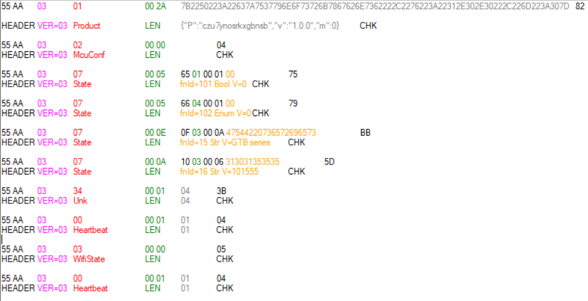

    After startdriver TuyaMCU we see some activity, but then no further activity is seen and the CBU stops.
    Reported : id 101 (switch), id 102 ( power %), 15 (device model), 16 (device id)
    Displaying TuyaMCU messages in text format
    Info:CMD:[WebApp Cmd 'startdriver TuyaMCU' Result] OK
    Info:TuyaMCU:Consumed 51 unwanted non-header byte in Tuya MCU buffer
    Info:TuyaMCU:Skipped data (part) 00 00 00 00 00 00 00 00 00 00 00 00 00 00 00 00 00 00 00 00 00 00 00 00 00 00 00 00 00 00 00 00 00 00 00 00 00 00 00 00 00 00 00 00 00 00 00 00 00 00 E0
    Info:TuyaMCU:Received: 55 AA 03 01 00 2A 7B 22 50 22 3A 22 63 7A 75 37 79 6E 6F 73 72 6B 78 67 62 6E 73 62 22 2C 22 76 22 3A 22 31 2E 30 2E 30 22 2C 22 6D 22 3A 30 7D 82
    Info:TuyaMCU:ProcessIncoming[v=3]: cmd 1 (QueryProductInformation) len 49
    Info:TuyaMCU:ParseQueryProductInformation: received {"P":"czu7ynosrkxgbnsb","v":"1.0.0","m":0}
    Info:TuyaMCU:Received: 55 AA 03 02 00 00 04
    Info:TuyaMCU:ProcessIncoming[v=3]: cmd 2 (MCUconf) len 7
    Info:TuyaMCU:ProcessIncoming: TUYA_CMD_MCU_CONF, TODO!
    Info:TuyaMCU:Received: 55 AA 03 07 00 05 65 01 00 01 00 75
    Info:TuyaMCU:ProcessIncoming[v=3]: cmd 7 (State) len 12
    Info:TuyaMCU:ParseState: id 101 type 1-bool len 1
    Info:TuyaMCU:ParseState: byte 0
    Info:TuyaMCU:Received: 55 AA 03 07 00 05 66 04 00 01 00 79
    Info:TuyaMCU:ParseState: id 102 type 4-enum len 1
    Info:TuyaMCU:Received: 55 AA 03 07 00 0E 0F 03 00 0A 47 54 42 20 73 65 72 69 65 73 BB
    Info:TuyaMCU:ProcessIncoming[v=3]: cmd 7 (State) len 21
    Info:TuyaMCU:ParseState: id 15 type 3-str len 10
    Info:TuyaMCU:Received: 55 AA 03 07 00 0A 10 03 00 06 31 30 31 35 35 35 5D
    Info:TuyaMCU:ProcessIncoming[v=3]: cmd 7 (State) len 17
    Info:TuyaMCU:ParseState: id 16 type 3-str len 6
    Info:TuyaMCU:Received: 55 AA 03 34 00 01 04 3B
    Info:TuyaMCU:ProcessIncoming[v=3]: cmd 52 (TUYA_CMD_REPORT_STATUS_RECORD_TYPE) len 8
    Info:TuyaMCU:0x34 command 4
    Info:TuyaMCU:Received: 55 AA 03 00 00 01 01 04
    Info:TuyaMCU:ProcessIncoming[v=3]: cmd 0 (Hearbeat) len 8
    Info:TuyaMCU:Received: 55 AA 03 03 00 00 05
    Info:TuyaMCU:ProcessIncoming[v=3]: cmd 3 (WiFiState) len 7
    Info:MQTT:mqtt_host empty, not starting mqtt

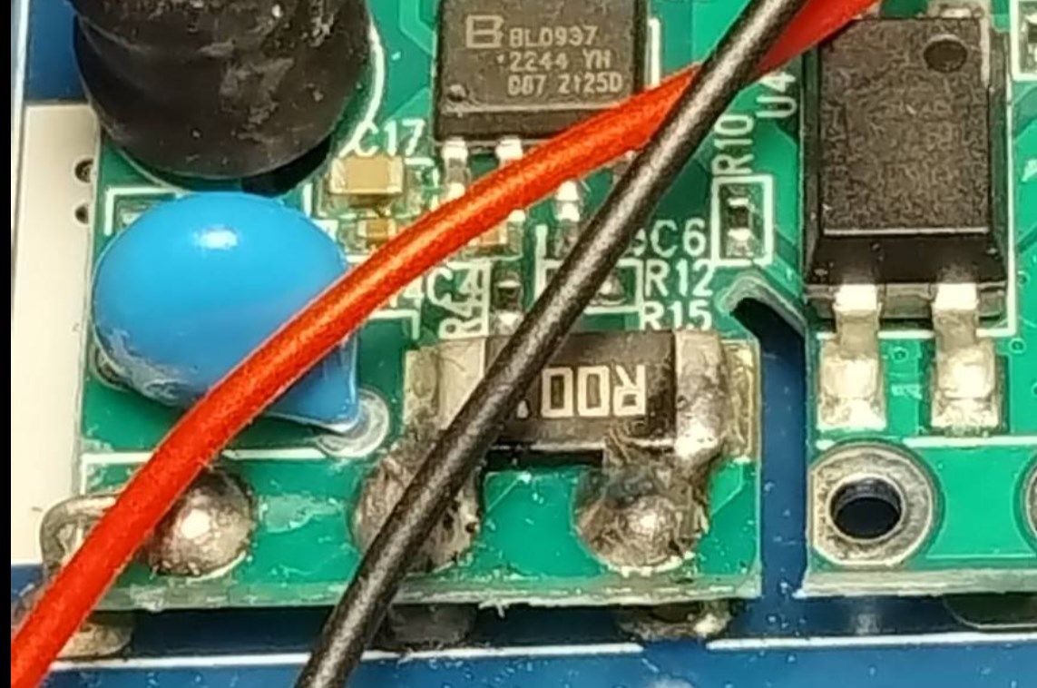

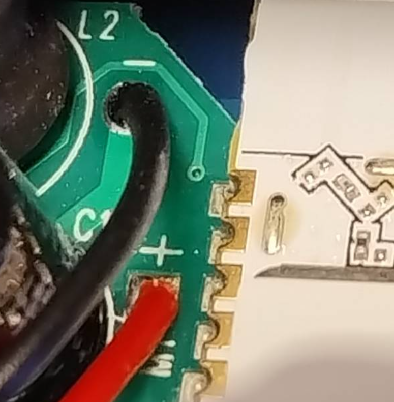

    Ok lets find out what this presumed power cable is doing.
    Close-up of a circuit board with connected cables.
    this seems to deliver power to the powermeasurment/CBU module, but guess what : 0 volt while running.

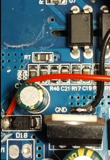

    This is the corresponding connection to the main board :
    Close-up of a circuit board with electronic components and wiring
    That looks as a power supply line to me, but with 0v ?
    This thing is no fun to dissassemble so probable the module might have its own power supply since it is soldered only to L-N-N, having 220v between L-N and N-N is the shunt.
    Close-up of a circuit board featuring a BL0937 chip and soldered wires.
    The 5V-GND is 0v as well.

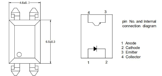

    The use of the optocoupler ORPC-817SC-TP-F is not clear
    Internal connection diagram of an optocoupler
    Loading BL0937 driver does not crash the CBU, but nothing is shown either.
    I am seriously puzzled how the main board CPU even communicates with the BL/CBU board.

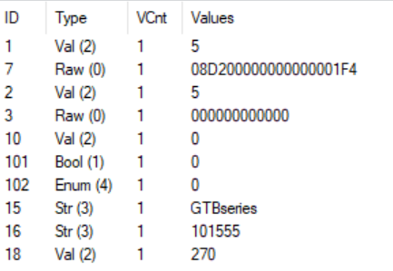

    Ok one step further :
    It seems that i need to issue
    backlog startdriver TuyaMCU; tuyaMcu_defWiFiState 4;
    so that the time between starting the driver and settting the WiFistate should be short?
    1 ,Total forward active energy
    2 ,Total reverse active energy
    3 ,Input
    7 ,Output
    10, Total power
    15,Inverter type
    16, Inverter ID
    18, Inverter temperature
    101,inverter switch
    102,Output power setting
    We get all back except for temperature :
    TuyaMCU controller data table showing various IDs and values.
    Lets check tuya data for id 7
    55 AA 03 07 00 0E 07 00 00 0A 08D200000000000001F4 F7
    HEADER VER=03 State LEN fnId=7 Raw V=08 D2 00 00 00 00 00 00 01 F4 CHK
    So following the "instructions" for ID 7 at the beginning of this post let’s decode the provided HEX data:
    HEX Input:
    Voltage: 2 bytes (unit: 0.1 V)
    Current: 3 bytes (unit: 0.001 A)
    Power: 3 bytes (unit: 0.001 kW)
    Let’s assume the relevant portion is the first 8 bytes and the rest is some checksum
    First 8 Bytes: 08 D2 00 00 00 00 00 00
    Voltage (2 bytes) = 0x08D2 = 2258 * 0.1V = 225.8V
    Current (3 bytes) 0x000000 = 0 * 0.001A = 0.000A
    Power (3 bytes) 0x000000 = 0 * 0.001KW = 0.000 kW
    That makes sense :)
