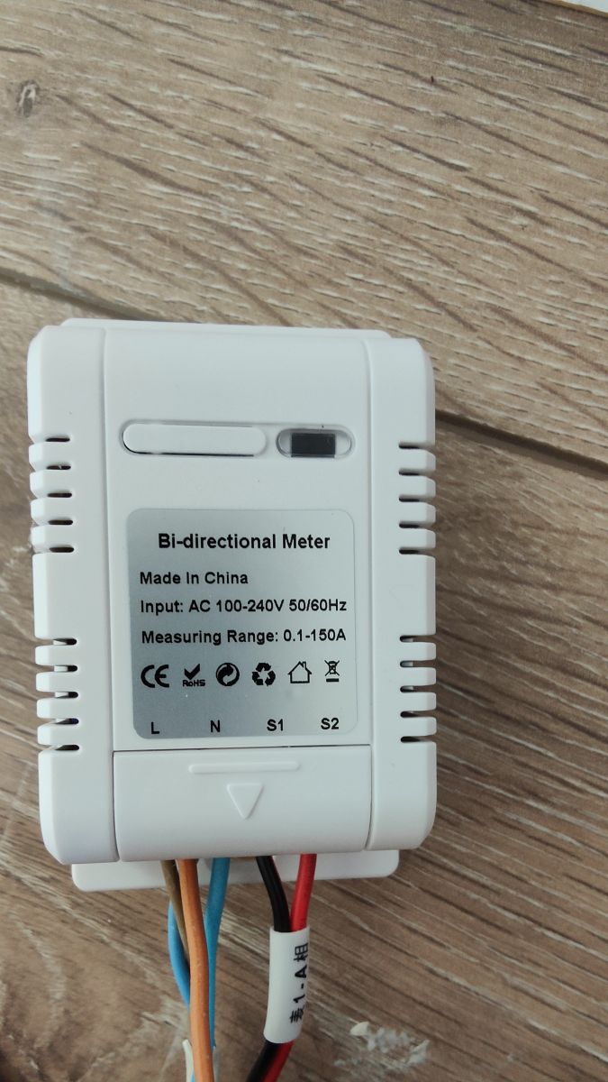

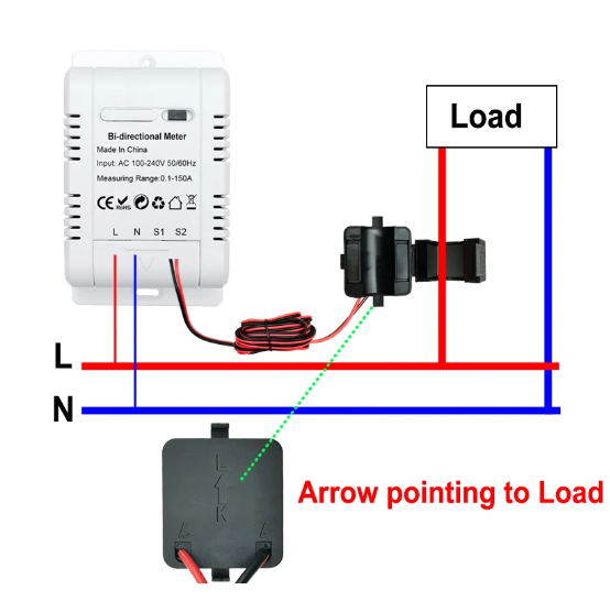

    Ola, I share the software modification for a bidirectional solar photovoltaic. TuyaMCU
    buy on aliexpress
    Diagram of a bidirectional meter installation with its components. Bidirectional meter module with a label detailing technical specifications.
    Link
    The module uses a CB2S chip
    Flashing is simple VCC GND TX RX I did not need to remove the module.

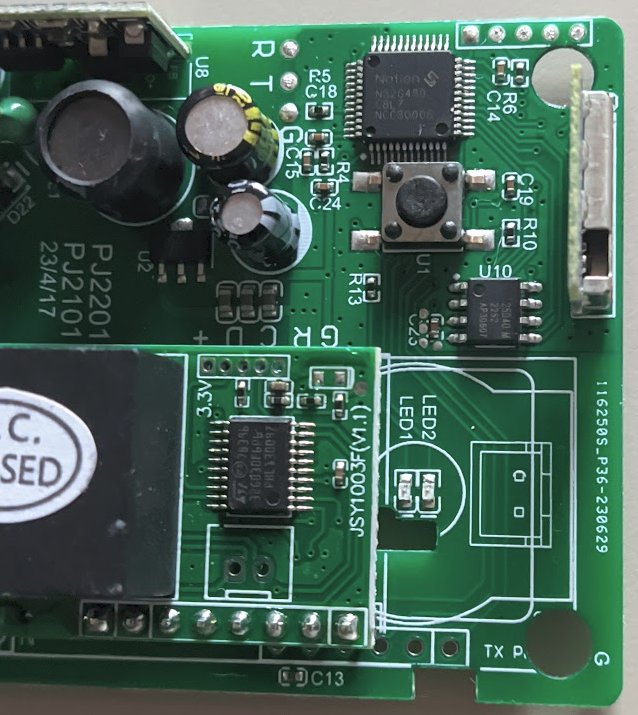

    Sorry for double posting. I have some more relevant information about this device.
    It has two more MCUs, a Nationstech: N32G430 C8L7 (controlling the wifi board and receiving data from the other MCU I suppose) and a STM32G030F6 for reading the current coil
    Circuit board with visible microchips and capacitors.
    Image of a printed circuit board with visible electronic components, including two microcontrollers, capacitors, and a button.
