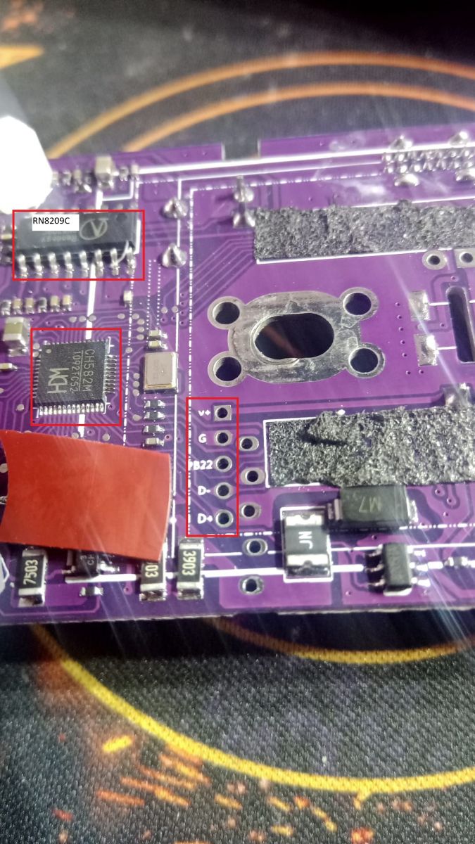

    I need to integrate one device in Home Assistant, the device name is Atorch DT20HBW:
    https://www.youtube.com/watch?v=VEQWkEoxd1M
    https://www.aliexpress.com/item/1005007168934...ml?spm=a2g0o.cart.0.0.378f4ae4TWJZOA&mp=1
    I was able to identify some of its chips:
    -CB2S
    -RN8209C
    -CH582M
    I see also some available solder connections on the PCB: V / G / D- / D and PB22(?)
    Image of a PCB with visible RN8209C and CH582M chips and solder points.
    Can someone please advise what the best approach will be for a beginner?
    I'm asking since I could not find info for CH582M chip so far...
    (sorry for my English)

    Thanks, in fact I just started reading those, I never flashed a tuya chip till now, luckily I have two of these DT20HBW devices.
    At this moment one of them has a new isolated dc-dc attached (18-75v to 5v) and monitors the solar battery using tuya integration, refresh rate makes this solution almost unusable since I had to calculate SOC based on current sensor value.
    From what I see in those tutorials is not that simple for me to identify all sensor data but someone has to do that so wish me luck.

    good luck. don't forget to take full backup before flashing :)
