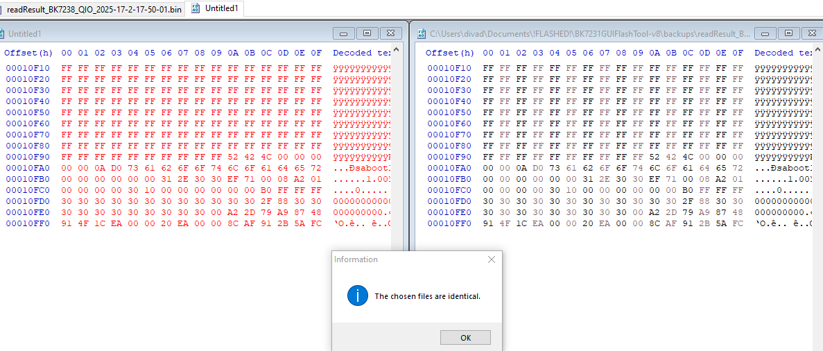

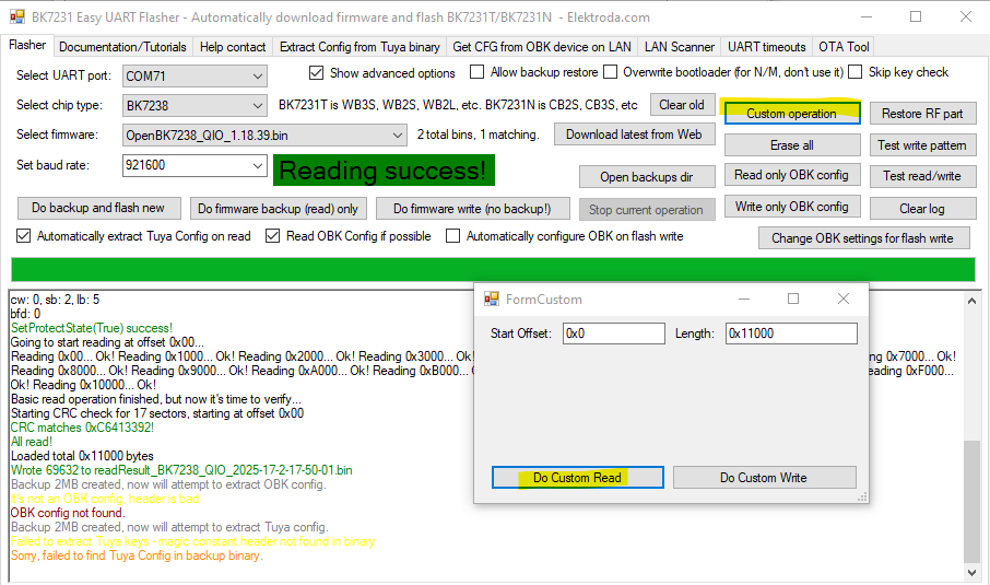

    Screenshot of BK7231 Easy UART Flasher program with a successful read.
    read of 0x0 length 0x11000 of a flashed firmware compared to original full dump extract
    Screenshot comparing two binary files in a hex editor with a message indicating identical content.

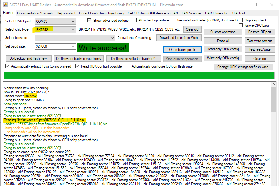

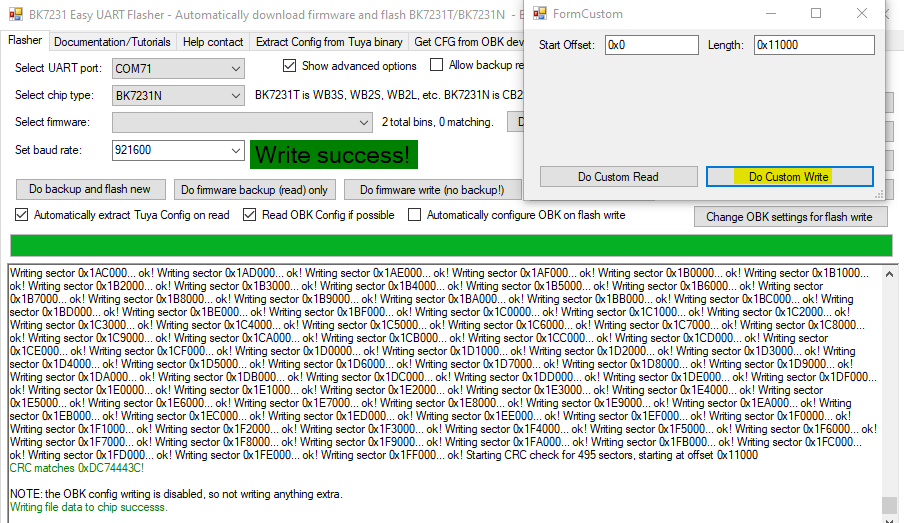

    I attempted to transplant the BL from another BK7231n dump so chose the whole 2mb file but only selected 0x0 - 0x11000 to flash, but it burnt the whole file. I guess chosen file needs to be exactly the size to be flashed.
    Easy Flasher software interface with a successful write message.

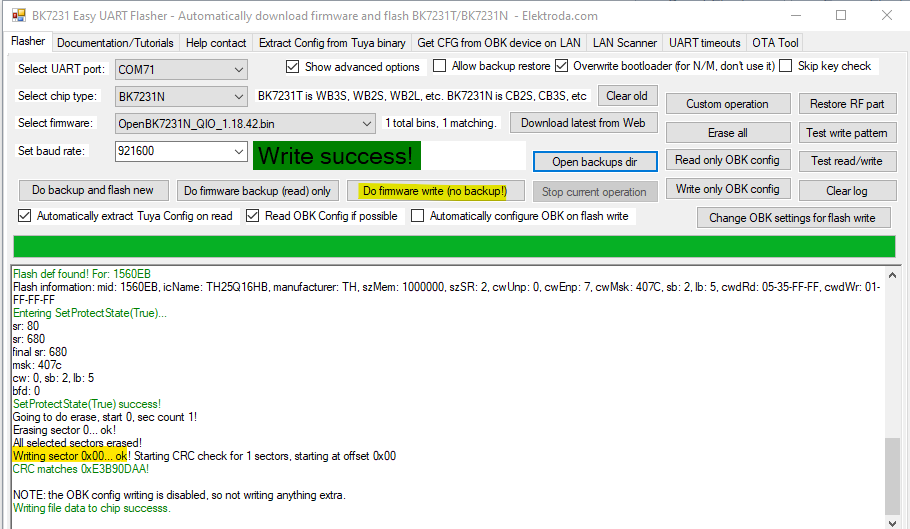

    after setting a custom write operation going back to standard "do firmware write (no backup!)" will perform a small write to 0x00 instead of the full QIO as expected
    User interface of BK7231 Easy UART Flasher tool displaying firmware write success.

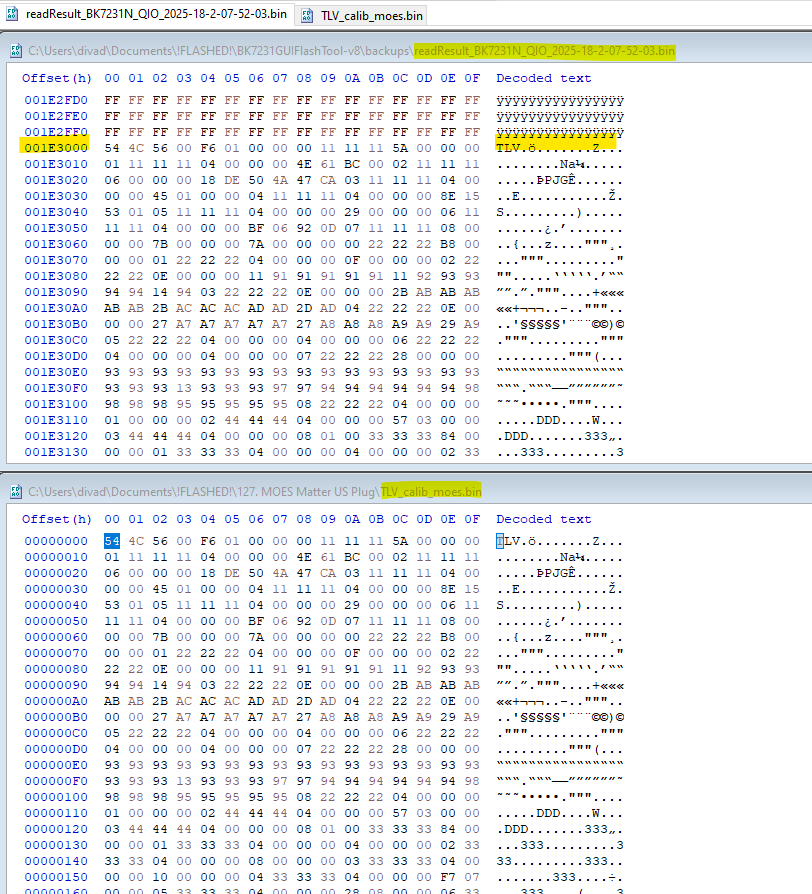

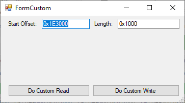

    to confirm custom write offset selection I erased the whole flash of a BK7231N using BKFIL then flashed 4kb file TLV_calib_moes.bin to 0x1E3000
    Screenshot of FormCustom window with Start Offset and Length fields.
    then took a whole flash backup to check location and content. looks good

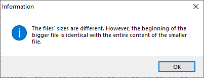

    and with 0x0 up to 0x1E3000 removed from the full dump:
    Dialog window with information about file size difference.

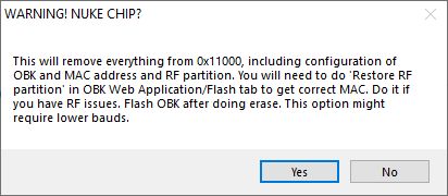

    not directly related but I've proposed the erase all info text is updated to say it doesn't include BL
    https://github.com/openshwprojects/BK7231GUIFlashTool/pull/52

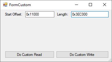

    It's not immediately obvious to users that BK7252 mode in EF is currently for 2mb BK7252U and will skip bootloader before they begin backup.
    to get 4mb, still with no BL, a custom read operation can be performed
    An application window named FormCustom with fields for start offset and length, and two buttons for custom read or write.
    Screenshot showing two BIN files with different names, sizes, and creation dates in a folder on a computer.
    ideally there'd be some wrap-around (?) check thing to dump full 2 or 4mb, rename of BK7252 to BK7252U and then the addition of BK7252N, which includes ROM like BK7238 and BK7231N.

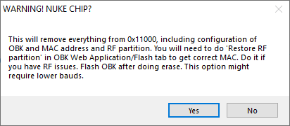

    "Erase all" does nothing for LN882H and the text would need customising for LN too if it did work. Also, official LN tool erases from 0x0, it'd be good if the erase feature was either blocked for unsupported chips or there was an option to erase from 0x0 for chips with rom
    Warning dialog about erasing chip memory from address 0x11000
