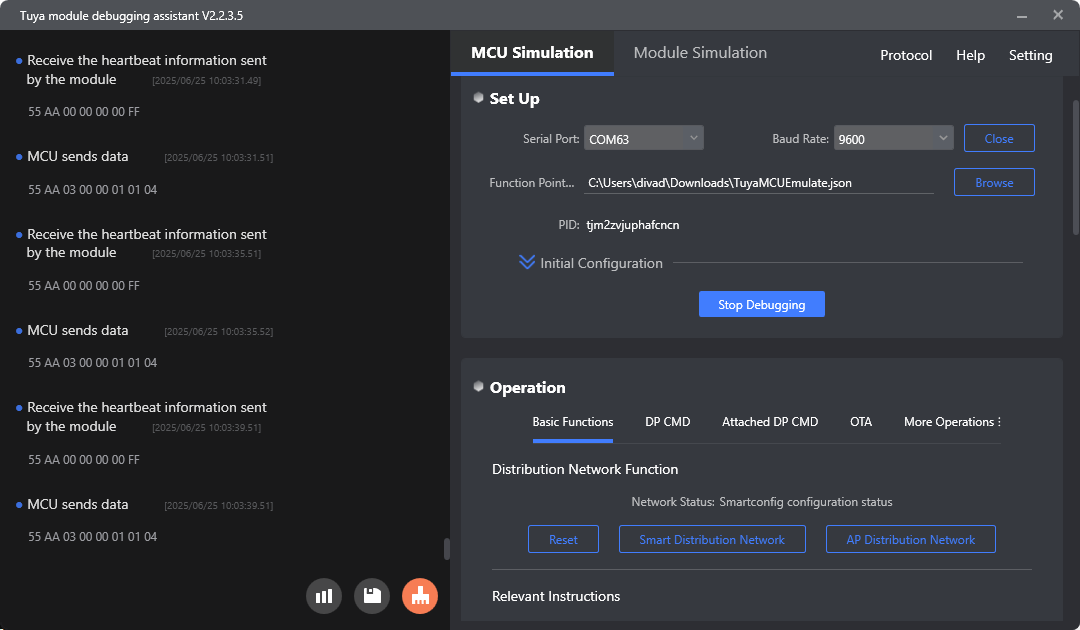

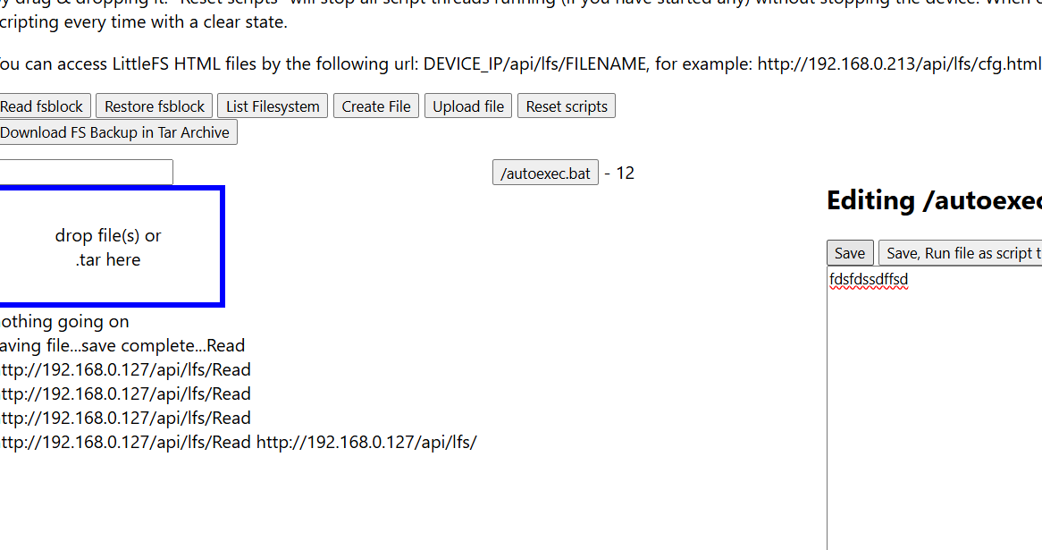

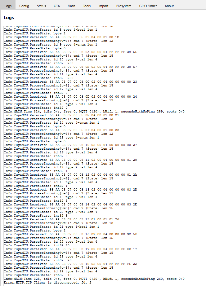

    with Tuya MDA and open COM port at 9600 baud to XR806 PB14/PB15
    AllWinner/XRadioTech XR806AF2L_Baseboard V1.0 - Dev Board Info
    TuyaMCU driver starts and can query dpIDs in fake PID json doc in TMDA

    So now WXU users can utilize their devices to full extent.
    And if OTA works, then XR806 can be said to be feature-complete with OBK, second alongside XR809 and after beken.

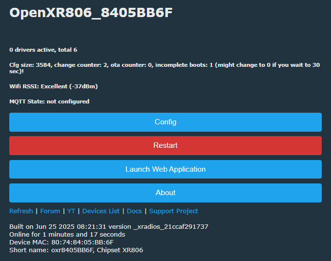

    _xradios_ef9a1db9f086

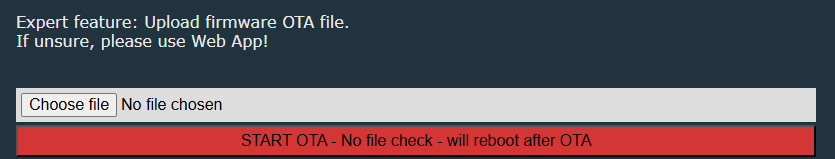

  • OTA image loads and verifies but never reboots
    #37 21589052
    Posts: 5208
    Help: 446
    Rate: 914
    ooh. seems successful loading and checking image but nothing further. doesn't initiate reboot
    and no sign OTA is staged or whatever on manual reboot. not that I know what OTA should look like on XR boot

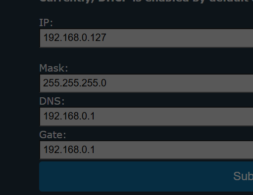

  • OTA progress with intermittent TCP disconnects
    #41 21589126
    Posts: 5208
    Help: 446
    Rate: 914
    HTTP
    each hard reset is then just the below, requiring reflash to get past
    Added after 7 [minutes]:
    quick OTA _xradios_b624f8e829b4
    OTA image loads but TCP client disconnects

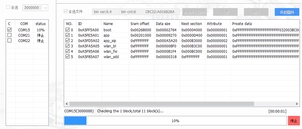

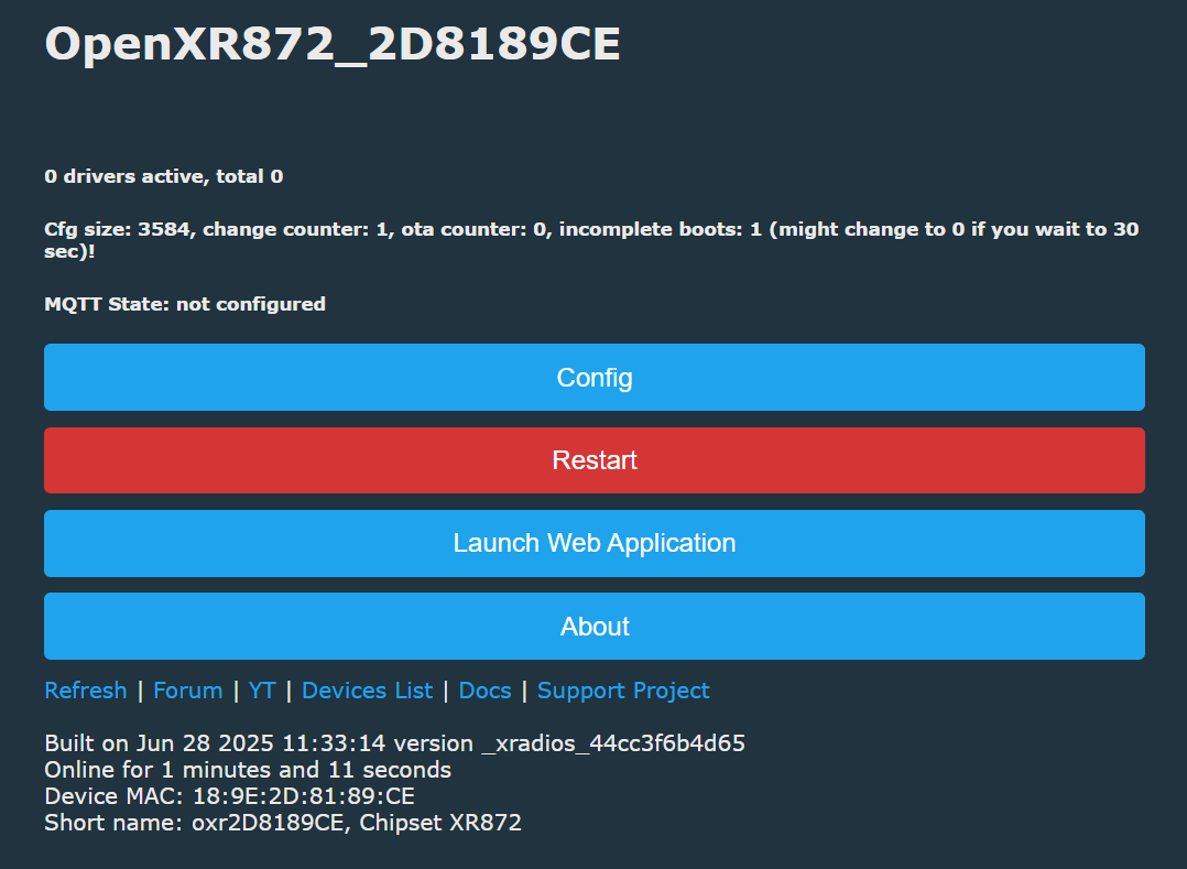

    #44 21589465
    insmod
    Posts: 1432
    Help: 168
    Rate: 455
    Small adjustments.
    Added XR872 OTA and moved obk code to xip.
    Enabled XR809 compression (~235kb flash saved, more is possible in exchange for heap (now ~200k free, was ~64k)). Disabled XR809 OTA (was unable to get http working, even in main (not obk) thread). LFS format works, but OTA flash erase doesn't.
    All XRs are now using XR806 mkimage tool (no need to specify flash offsets - meaning no error).
    https://github.com/NonPIayerCharacter/OpenBK7231T_App/actions/runs/15884616221
    If XR872 OTA is verified to be working, i'll open a pull request.

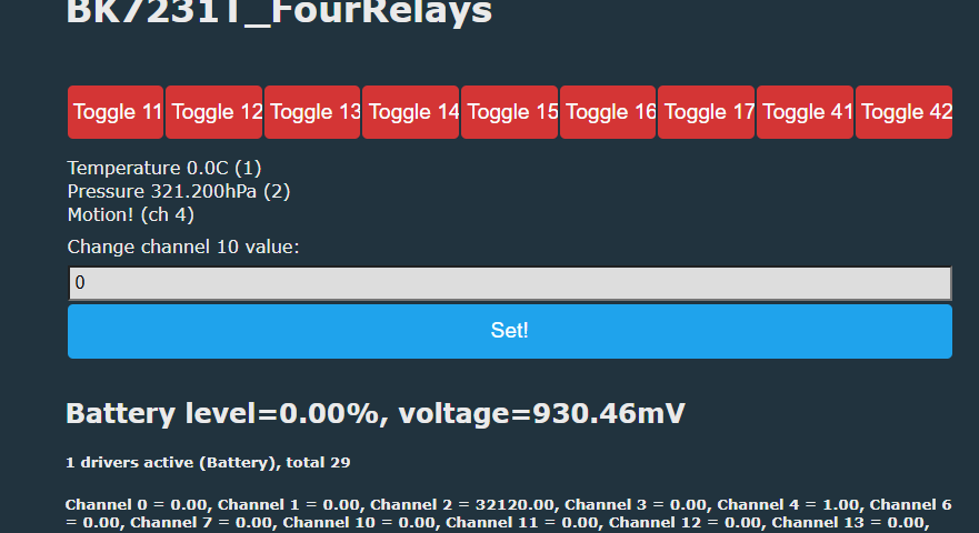

    And can someone verify BK7231 battery driver? I commented out HAL_ADC_Init in Batt_Measure, since it should already be initialized in pins setup.

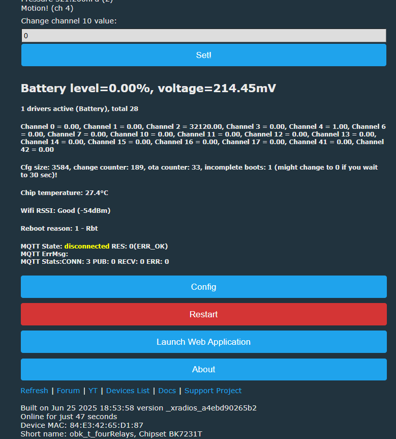

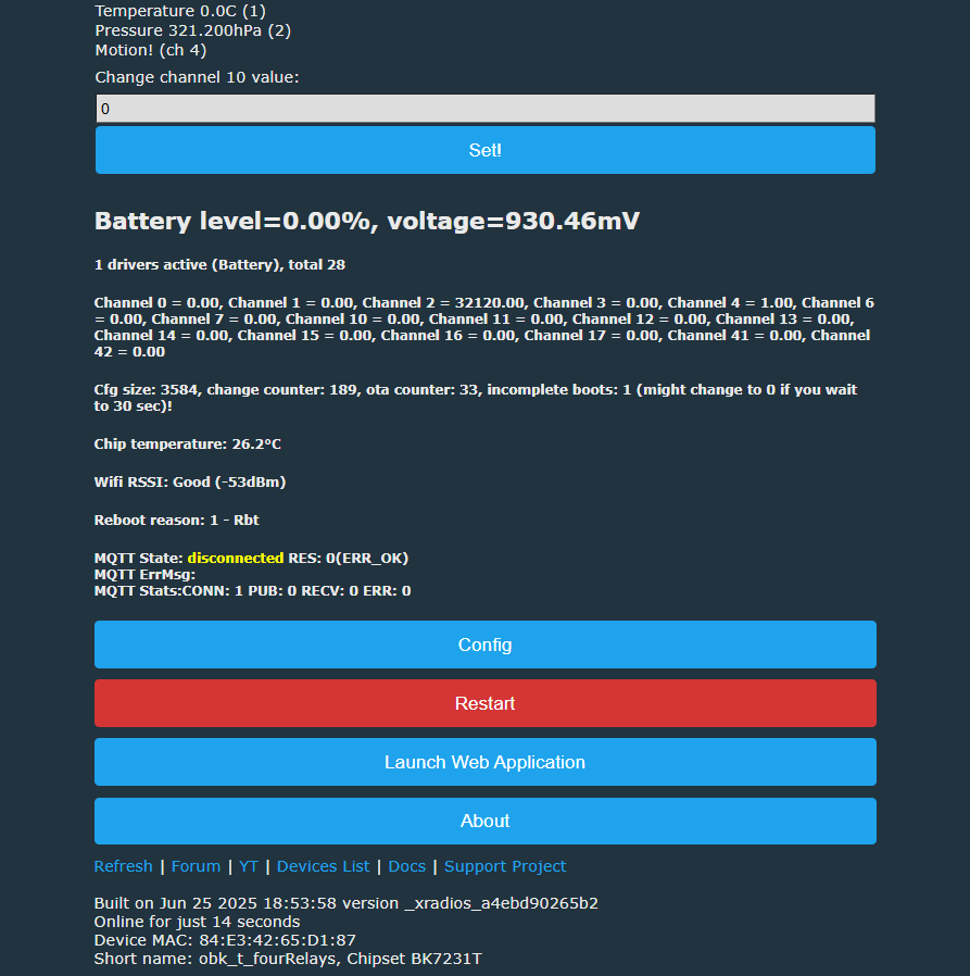

  • ADC appears to work with A0 tied to 3V
    #45 21589617
    Posts: 14754
    Rate: 12876
    Interesting, I don't know why it's done repeatedly, since ADC is already set up in pins for IOR_BAT_ADC. Maybe you could ask here:
    https://www.elektroda.com/rtvforum/topic3959103.html
    Still, author doesn't seem to log in these days, so probably we can just test it ourselves.
    Probably just need a pot on ADC pin, I may try it in a moment
    Just started driver on my PR - shorted A0 to 3V on NodeMCU:
    Doing OTA...
    Added after 3 [minutes]:
    Seem to work the same, at least the ADC aspect:
    First is ADC of nodemcu connected to vdd, second is hanging in air.
    _xradios_a4ebd90265b2 boots on 1mb XF16 still.
    2mb XF16 OTA from quick gui:
    web app

    sorry. that WAS 1mb OTA. Wrong cam. doing 2mb now.
    Added after 6 [minutes]:
    quick gui=
    2mb. _xradios_a4ebd90265b2
    quick/expert gui:
    HTTP:
    HTTP looks happy then doesn't progress
    Unknown flash ID and SDC command 8 errors

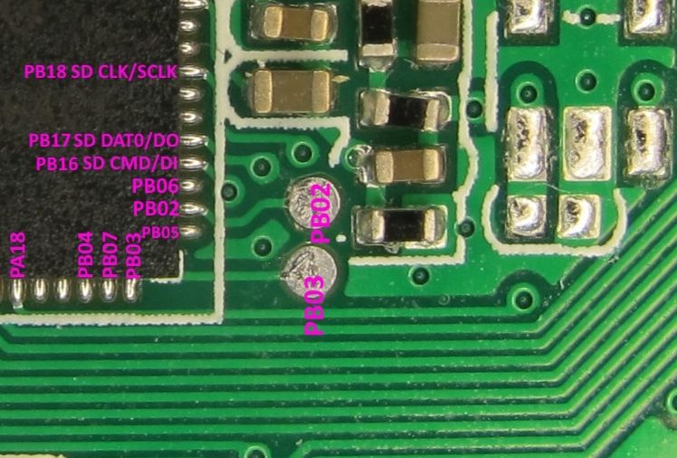

    #53 21592109
    Posts: 14754
    Rate: 12876
    New camera, original boot log:

    Flash via UART:

    New boot log:
    platform information ===============================================
    XRADIO Skylark SDK 1.2.2 Jun 28 2025 11:33:12
    sram heap space [0x21ea68, 0x26dc00), total size 323992 Bytes
    cpu  clock 240000000 Hz
    HF   clock  40000000 Hz
    sdk option:
        XIP           : enable
        INT LF OSC    : enable
    mac address:
        efuse         : 18:9e:2d:81:89:ce
        in use        : 18:9e:2d:81:89:ce
    user_main
    OpenXR872, version _xradios_44cc3f6b4d65
    Paired with WiFi:
    Set IP:

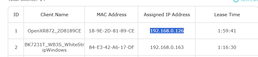

    page is at new IP, seems to work I guess:
    Info:HTTP:TCP server listening
    Info:MAIN:Time 1, idle 0/s, free 262272, MQTT 0(0), bWifi 0, secondsWithNoPing -1, socks 2/20
    Info:MAIN:Time 2, idle 0/s, free 262272, MQTT 0(0), bWifi 0, secondsWithNoPing -1, socks 2/20
    Info:MAIN:Time 3, idle 0/s, free 262272, MQTT 0(0), bWifi 0, secondsWithNoPing -1, socks 2/20
    Info:MAIN:Time 4, idle 0/s, free 262272, MQTT 0(0), bWifi 0, secondsWithNoPing -1, socks 2/20
    [net INF] no need to switch wlan mode 0
    Info:MAIN:Time 5, idle 0/s, free 262272, MQTT 0(0), bWifi 0, secondsWithNoPing -1, socks 2/20
    Info:MAIN:Registered for wifi changes
    Info:MAIN:Connecting to SSID [MyWiFiSSID]
    [net INF] netif (IPv4) is up
    [net INF] address: 192.168.0.127
    [net INF] gateway: 192.168.0.1
    [net INF] netmask: 255.255.255.0
    [net INF] msg <network up>
    wlan_msg_recv msg type:18
    LFS seems ok:
    Potential reflash via UART seems OK i guess?
    Or wait, let me power this off and on.... OK, still working.
  • PB03 grounding enables XF16 recovery mode
    #54 21592365
    Posts: 5208
    Help: 446
    Rate: 914
    OK, still working
    yes indeed. makes things a lot easier on XF16. Although PB03 grounded is all that's required if it breaks
    can't remember where I got to with XR806/XR809 attempts to enable PRJCONF_CONSOLE_EN
    ref: https://www.elektroda.com/rtvforum/topic4074636-150.html#21536584, https://github.com/divadiow/OpenXR872/commit/6386115b73e26fd40b3568b86ac8d07d2e0c5f6b
    XR809 didn't seem to be as straight-forward
