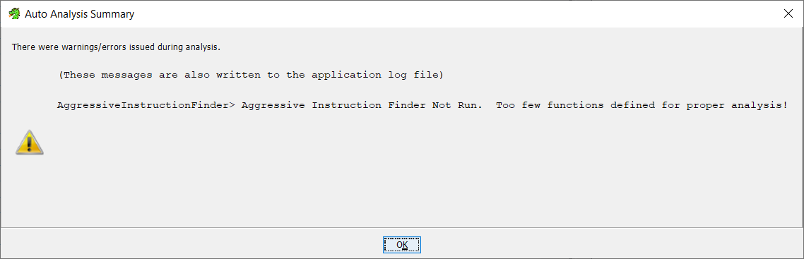

    Error message in auto analysis
    https://github.com/search?q=repo%3Adivadiow%2FECR6600%2040800000&type=code

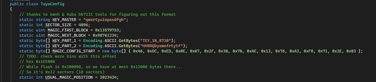

    Screenshot of a C# code snippet dealing with Tuya configuration.
    it was something GPT suggested was derivable from @miegapele's efuse bytes https://www.elektroda.com/rtvforum/topic4106357.html#21500523

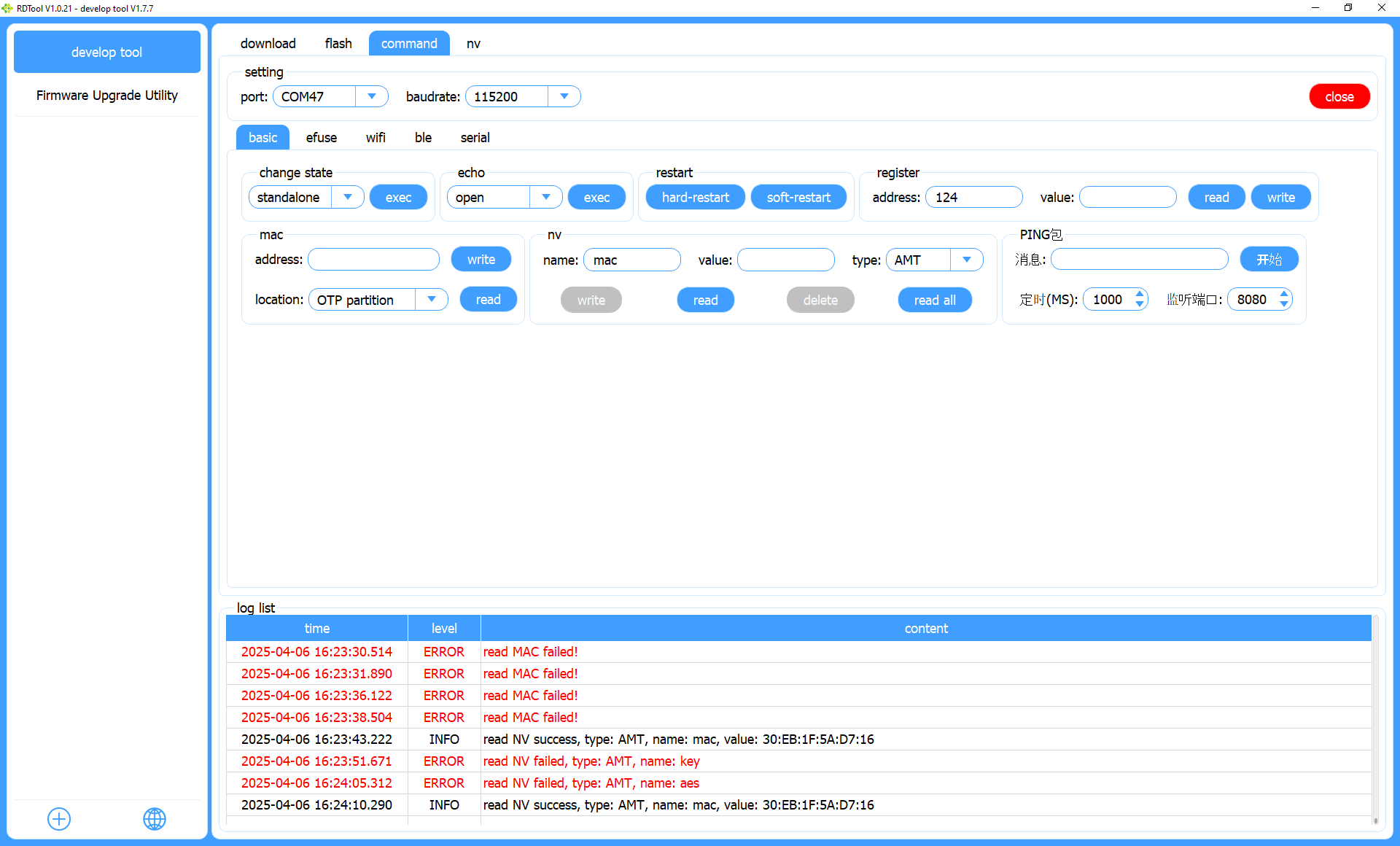

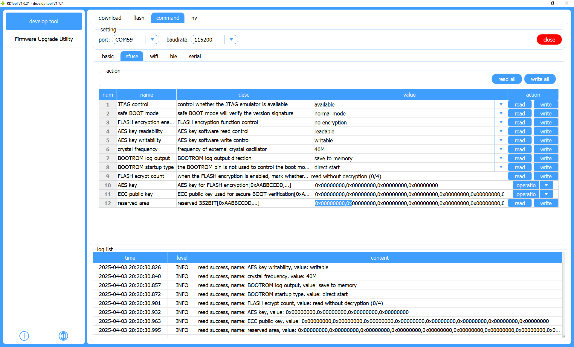

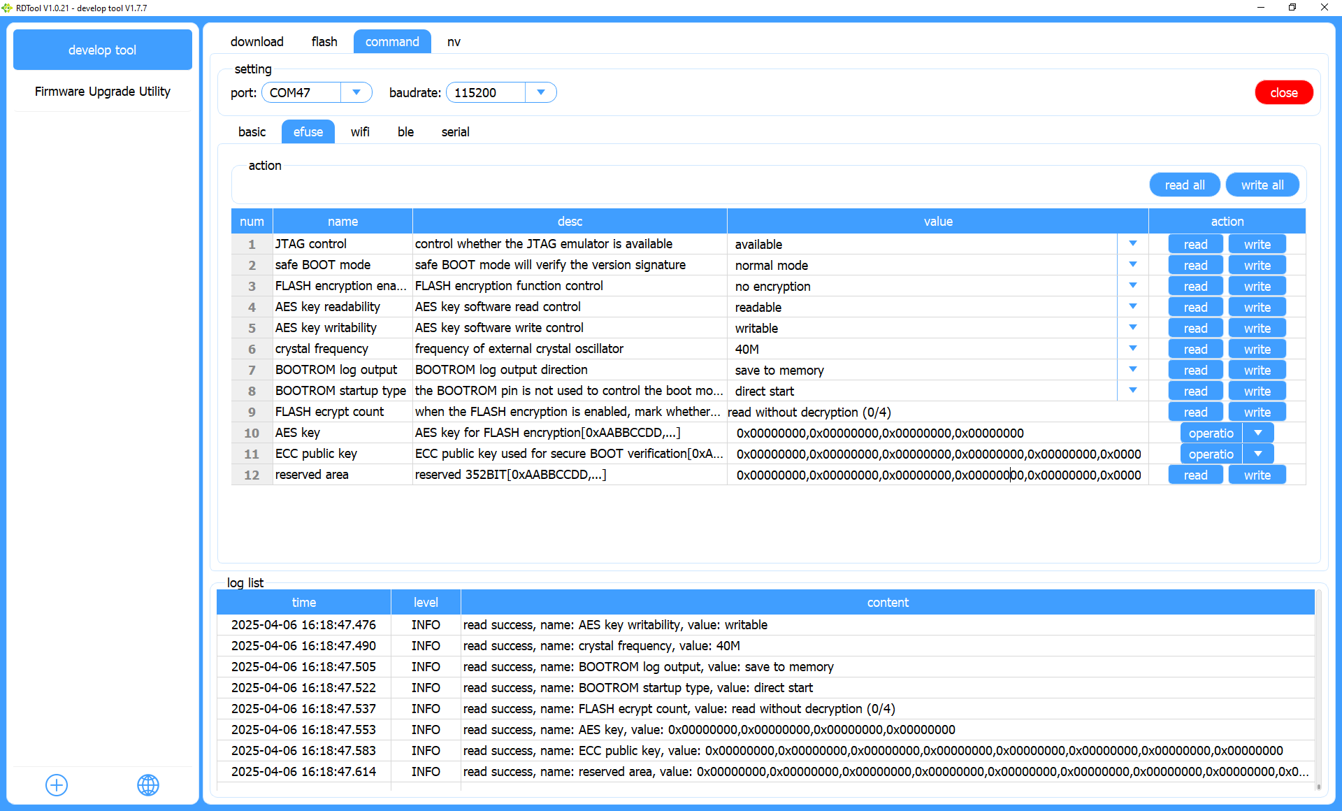

    I was going to hook up WG236 again this evening just to experience the efuse read in RDTool using AT.
    Added after 1 [hours] 7 [minutes]:
    yuh. no great surprise. all 0x0. read via TX0/IO6 and RX0/IO5
    Screenshot of RDTool showing efuse settings details and read logs for a device.
    UART prints
    Added after 4 [minutes]:
    this would be doable on the ECR6600 EU plugs because that's the same RX/TX as flash is through - but miegapele has already read it somehow. not sure how @miegapele's values translate to what would be displayed in RDTool though.

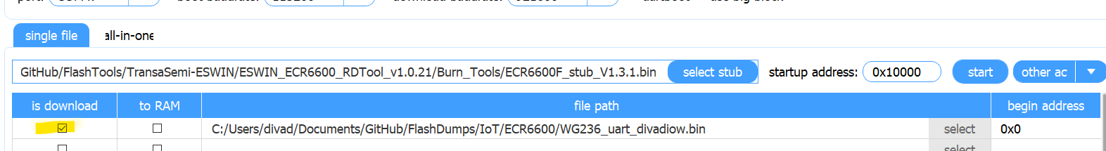

    in my haste I neglected to uncheck the WG236A backup under stub and flashed that already! 🤦🏼‍♂ I'll dump second, I'm betting it'll be the same as the others we've had though.
    Screenshot of a binary file management program with the download option checked.
    efuse read is successful but doesn't reveal anything different to trying on WG236 https://www.elektroda.com/rtvforum/topic4111822-60.html#21506177
    Firmware upgrade software interface with a settings table.
    seeing what else I can read from it. any requests?

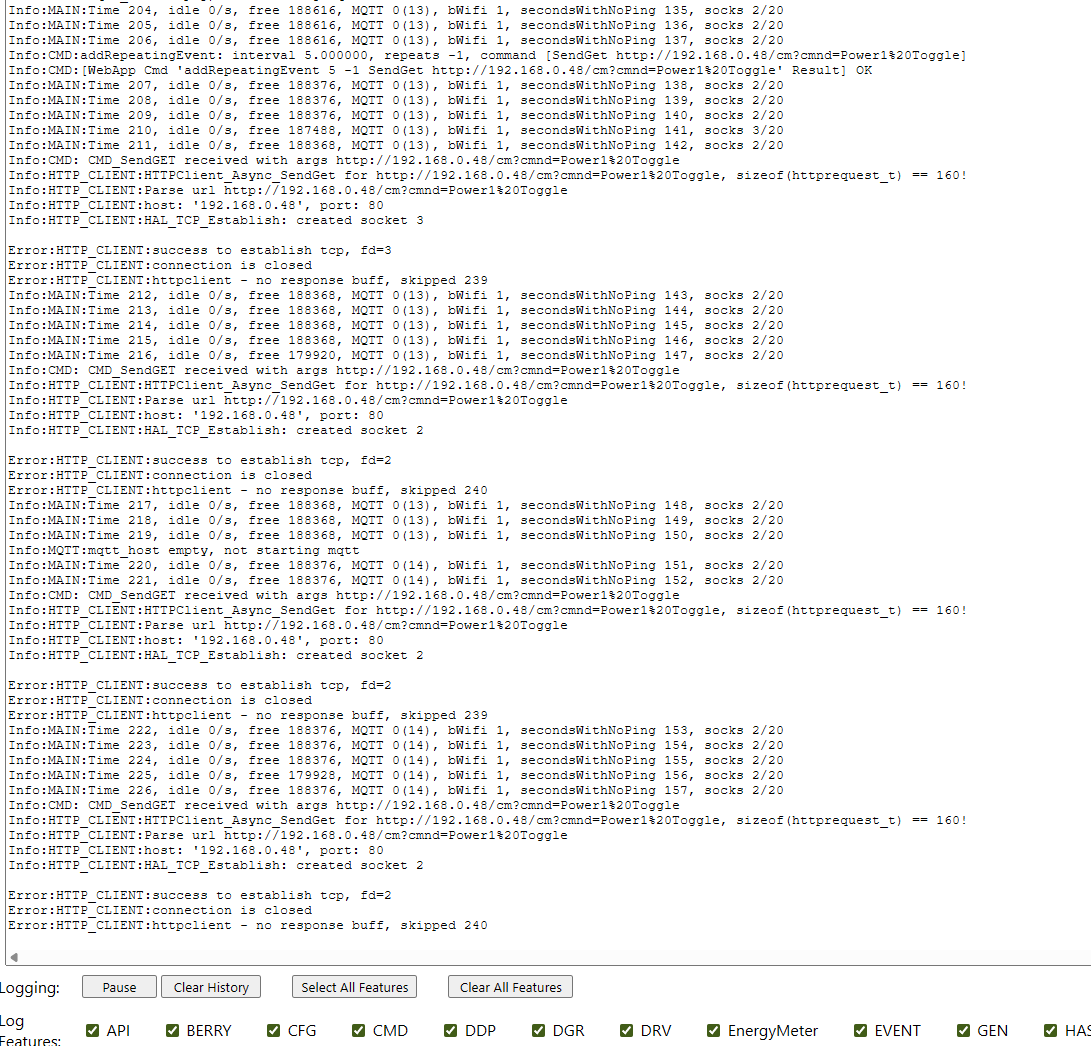

    I didn't make any futher tests with IDA, but I am helping user to port HTTP GET/POST requests to ECR in OBK, and I'm currently looking for hal_machw_time equivalent in their SDK - any ideas?

    I'll give it a go. Another missing think would be lwip_close_force, which was added by me to LWIP some time ago as a work around to lingering sockets... they weren't freed correctly and kept using heap. I'm curious if the same problem will occur on ECR, maybe it should be solved differently.

  • #79 21594487

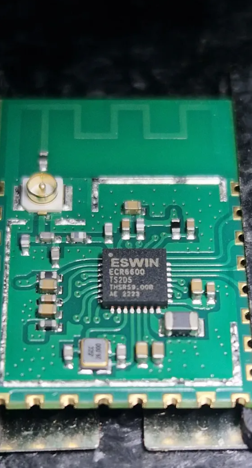

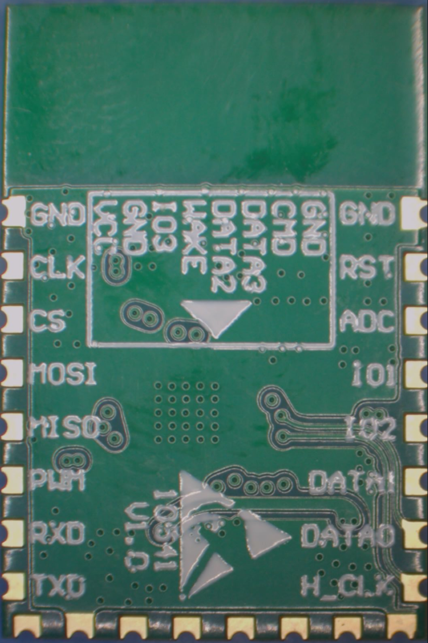

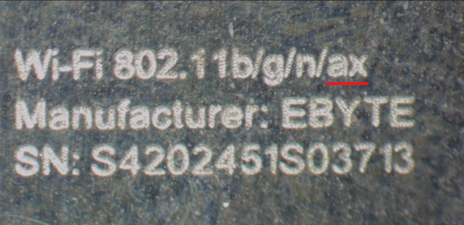

    Since I am back to digging through my collection of modules I've noticed something interesting, first E103W module has a non standard pinout
    Eswin ECR6600 flashing guide, datasheet, pinout, 100% local setup, Home Assistant
    And second is this little detail
  • #82 21594671
    Posts: 14649
    Help: 655
    Rate: 12660
    I didn't notice it as well, but it seems that this module can work with WiFi 6.

    I knew that it can work with Wifi 6. But it can't work with 5Ghz.
    The only module i know that supports both wifi 6 and 5ghz is ESP32-C5.

    Confirmed, SendGET is working from ECR module to another OBK, both as a single toggle and as a repeating event!

    I have fixed SendGet on BL602 as well, I am working on LN882H now. I'm also going to clear up codebase there a bit.
    Ok, next test. Does ECR have LFS? I think it does? So... try to download a file.
    // Following command will send get and save result to file:
    // SendGet http://example.com/ myFile.html
    // test code: addRepeatingEvent 30 -1 SendGet http://example.com/ myFile.html
    Just make sure to use HTTP, not HTTPS. We don't have HTTPS enabled.
    Maybe try on Beken first, my memory may be faulty here, but it should work more or less...
    Just to be sure - no sockets in use/heap impact after repeated requests?
    Confirmed, heap does go down some, check the log.
    Error:HTTP_CLIENT:success to establish tcp, fd=2
    Error:HTTP_CLIENT:connection is closed
    Error:HTTP_CLIENT:httpclient - no response buff, skipped 240
    Info:MAIN:Time 745, idle 0/s, free 188376, MQTT 0(46), bWifi 1, secondsWithNoPing 676, socks 2/20
    Info:MAIN:Time 746, idle 0/s, free 188376, MQTT 0(46), bWifi 1, secondsWithNoPing 677, socks 2/20
    Info:MAIN:Time 747, idle 0/s, free 188376, MQTT 0(46), bWifi 1, secondsWithNoPing 678, socks 2/20
    Info:MAIN:Time 748, idle 0/s, free 188376, MQTT 0(47), bWifi 1, secondsWithNoPing 679, socks 2/20
    Info:MAIN:Time 749, idle 0/s, free 188376, MQTT 0(47), bWifi 1, secondsWithNoPing 680, socks 2/20
    Info:CMD: CMD_SendGET received with args http://192.168.0.48/cm?cmnd=Power1%20Toggle
    Info:HTTP_CLIENT:HTTPClient_Async_SendGet for http://192.168.0.48/cm?cmnd=Power1%20Toggle, sizeof(httprequest_t) == 160!
    Info:HTTP_CLIENT:Parse url http://192.168.0.48/cm?cmnd=Power1%20Toggle
    Info:HTTP_CLIENT:host: '192.168.0.48', port: 80
    Info:HTTP_CLIENT:HAL_TCP_Establish: created socket 2
    Error:HTTP_CLIENT:httpclient - no response buff, skipped 239
    Info:MAIN:Time 750, idle 0/s, free 175512, MQTT 0(47), bWifi 1, secondsWithNoPing 681, socks 3/20
    Info:MAIN:Time 751, idle 0/s, free 188368, MQTT 0(47), bWifi 1, secondsWithNoPing 682, socks 2/20
    Info:MAIN:Time 752, idle 0/s, free 188368, MQTT 0(47), bWifi 1, secondsWithNoPing 683, socks 2/20
    Info:MAIN:Time 753, idle 0/s, free 188368, MQTT 0(47), bWifi 1, secondsWithNoPing 684, socks 2/20
    Info:MAIN:Time 754, idle 0/s, free 175512, MQTT 0(47), bWifi 1, secondsWithNoPing 685, socks 3/20
    Info:HTTP_CLIENT:HAL_TCP_Establish: created socket 3
    Error:HTTP_CLIENT:success to establish tcp, fd=3
    Info:MAIN:Time 755, idle 0/s, free 188368, MQTT 0(47), bWifi 1, secondsWithNoPing 686, socks 2/20
    Info:MAIN:Time 756, idle 0/s, free 188368, MQTT 0(47), bWifi 1, secondsWithNoPing 687, socks 2/20
    Info:MAIN:Time 757, idle 0/s, free 188368, MQTT 0(47), bWifi 1, secondsWithNoPing 688, socks 2/20
    Info:MAIN:Time 758, idle 0/s, free 175512, MQTT 0(47), bWifi 1, secondsWithNoPing 689, socks 3/20
    Info:MAIN:Time 759, idle 0/s, free 188368, MQTT 0(47), bWifi 1, secondsWithNoPing 690, socks 2/20
    Info:MAIN:Time 760, idle 0/s, free 188376, MQTT 0(47), bWifi 1, secondsWithNoPing 691, socks 2/20
    Info:MAIN:Time 761, idle 0/s, free 188376, MQTT 0(47), bWifi 1, secondsWithNoPing 692, socks 2/20
    Info:MAIN:Time 762, idle 0/s, free 175520, MQTT 0(47), bWifi 1, secondsWithNoPing 693, socks 3/20
    Info:MAIN:Time 763, idle 0/s, free 188376, MQTT 0(47), bWifi 1, secondsWithNoPing 694, socks 2/20
    Info:MAIN:Time 764, idle 0/s, free 188376, MQTT 0(48), bWifi 1, secondsWithNoPing 695, socks 2/20
    LFS is present and confirmed working. SendGET obviously needs some delay after booting but it is working. For http file download I will try at some point, not sure when though.
