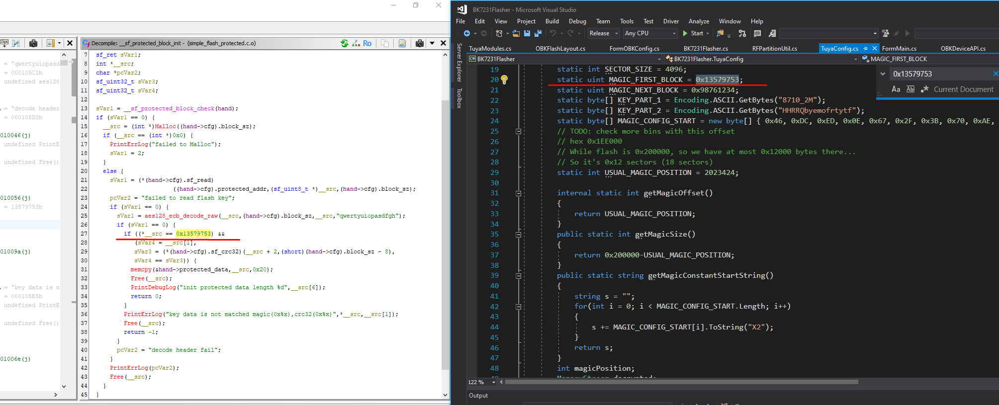

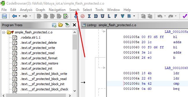

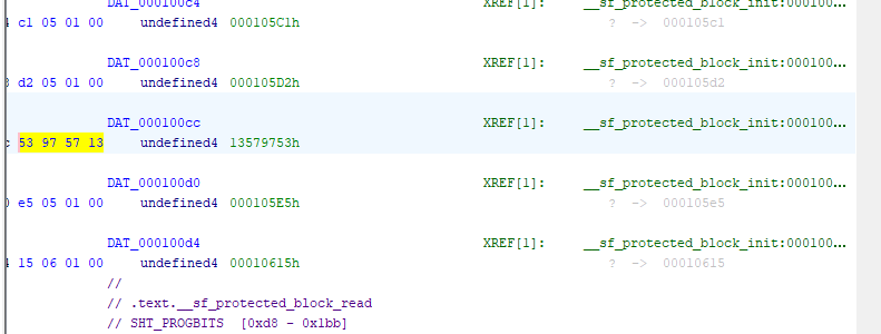

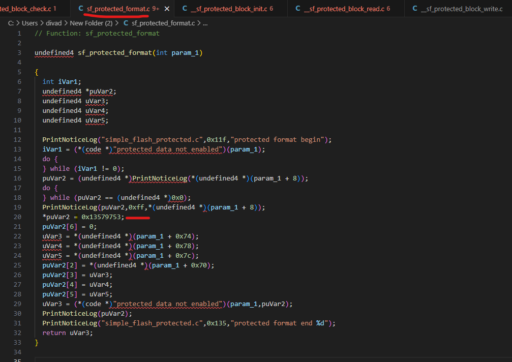

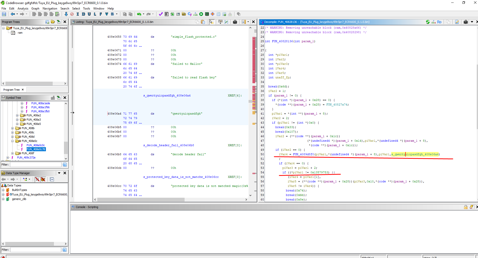

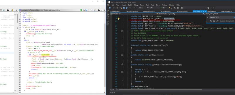

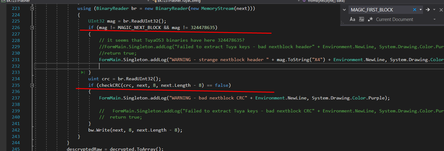

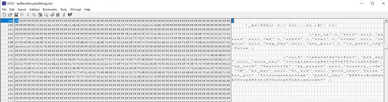

Why does Tuya config extraction from ECR6600 backups fail after the first block, and what does the thread suggest about changed secondary keys or TuyaOS 3 storage?
It fails because the first block decrypts, but later blocks fail header and CRC checks, which points to a changed secondary key or a different storage scheme. The extractor found the Tuya config magic at offset 1921024, passed the first MAGIC and CRC checks, then produced repeated "strange nextblock header" and "bad nextblock CRC" warnings. The thread’s main hypothesis was that ECR6600 changed KEY_PART_1 used by makeSecondaryKey, while a related idea was that newer TuyaOS 3 firmware stores config differently from older BK-based devices. In short, the parser understands the opening block but not the follow-up encryption logic. [#21481206]

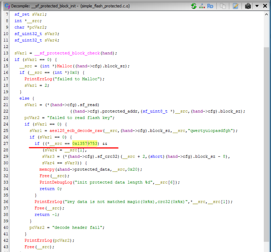

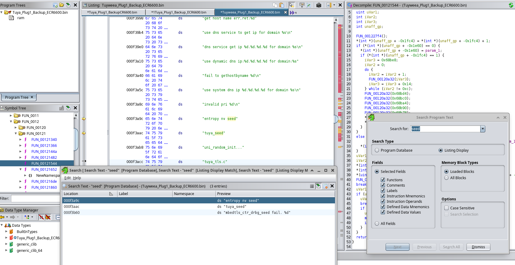

What is KV_KEY_SEED in Tuya firmware, and why does it matter when trying to decrypt or extract configuration from ECR6600 dumps?
KV_KEY_SEED is the short seed string used to derive part of Tuya’s secondary flash-encryption key for stored configuration. "KV_KEY_SEED is a Tuya firmware configuration value that feeds key derivation for encrypted key-value storage, and changing it breaks block decryption even when the first flash header still matches." In the thread, older non-ECR examples used CONFIG_KV_KEY_SEED="8710_2M", but ECR6600 binaries appeared to contain only some known key parts, not that seed. Because decryption failed right after makeSecondaryKey was applied, the maintainers suspected ECR6600 used a different KV seed or a modified derivation path. [#21481270]

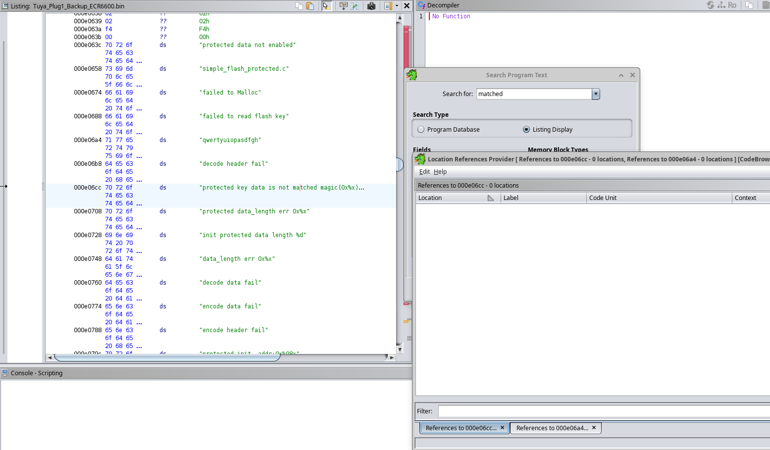

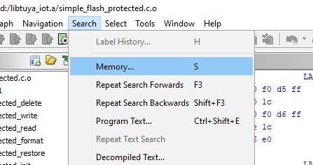

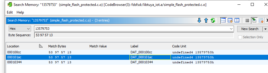

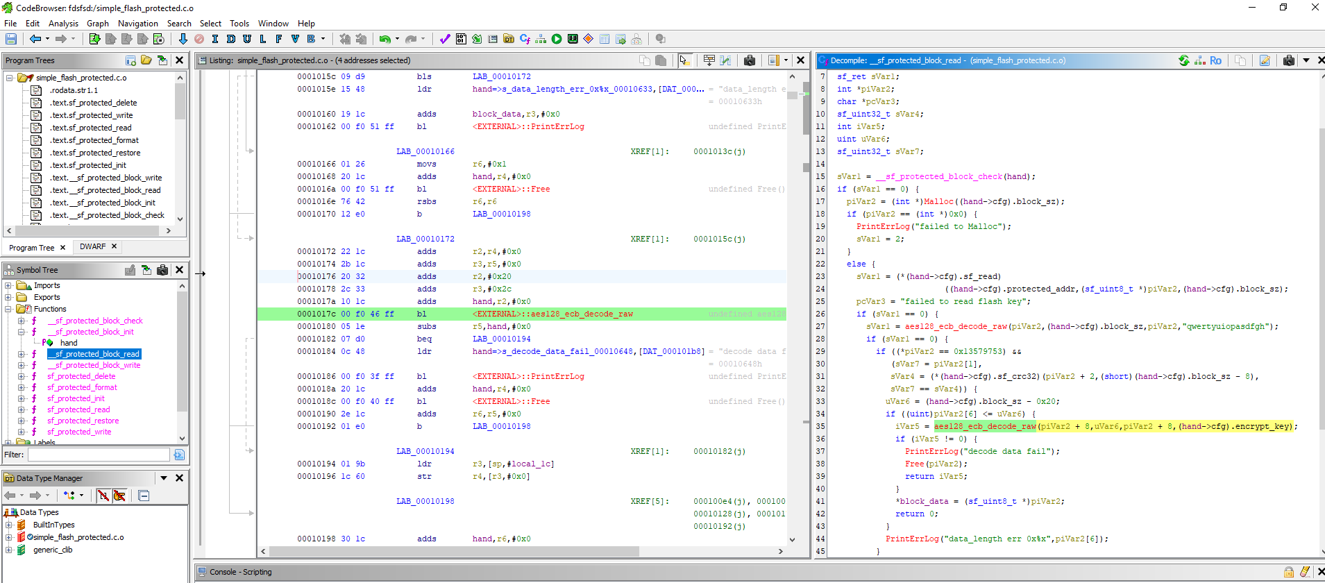

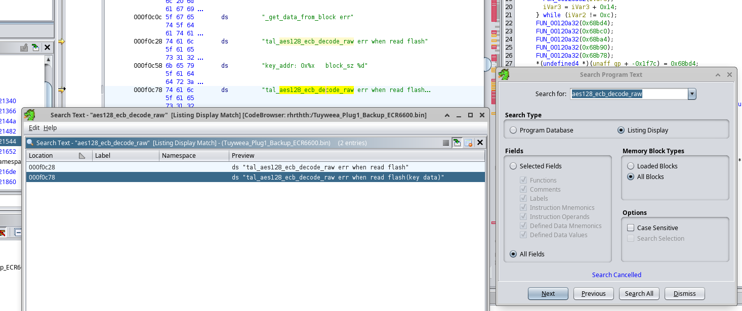

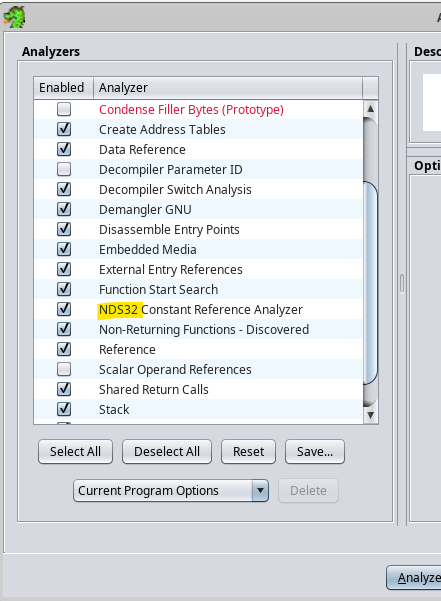

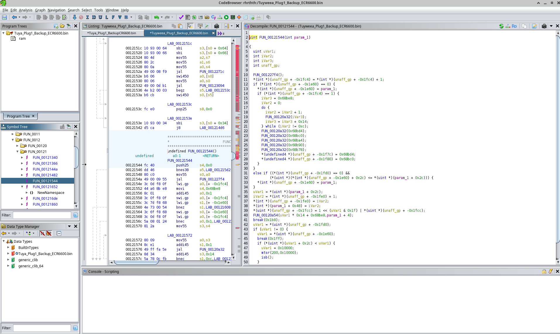

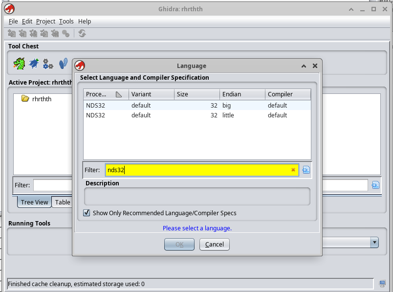

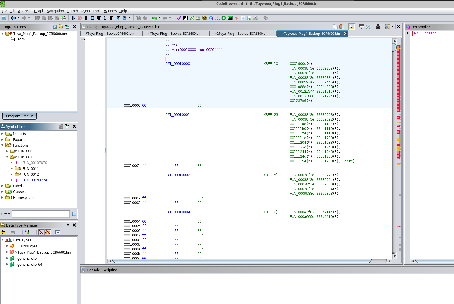

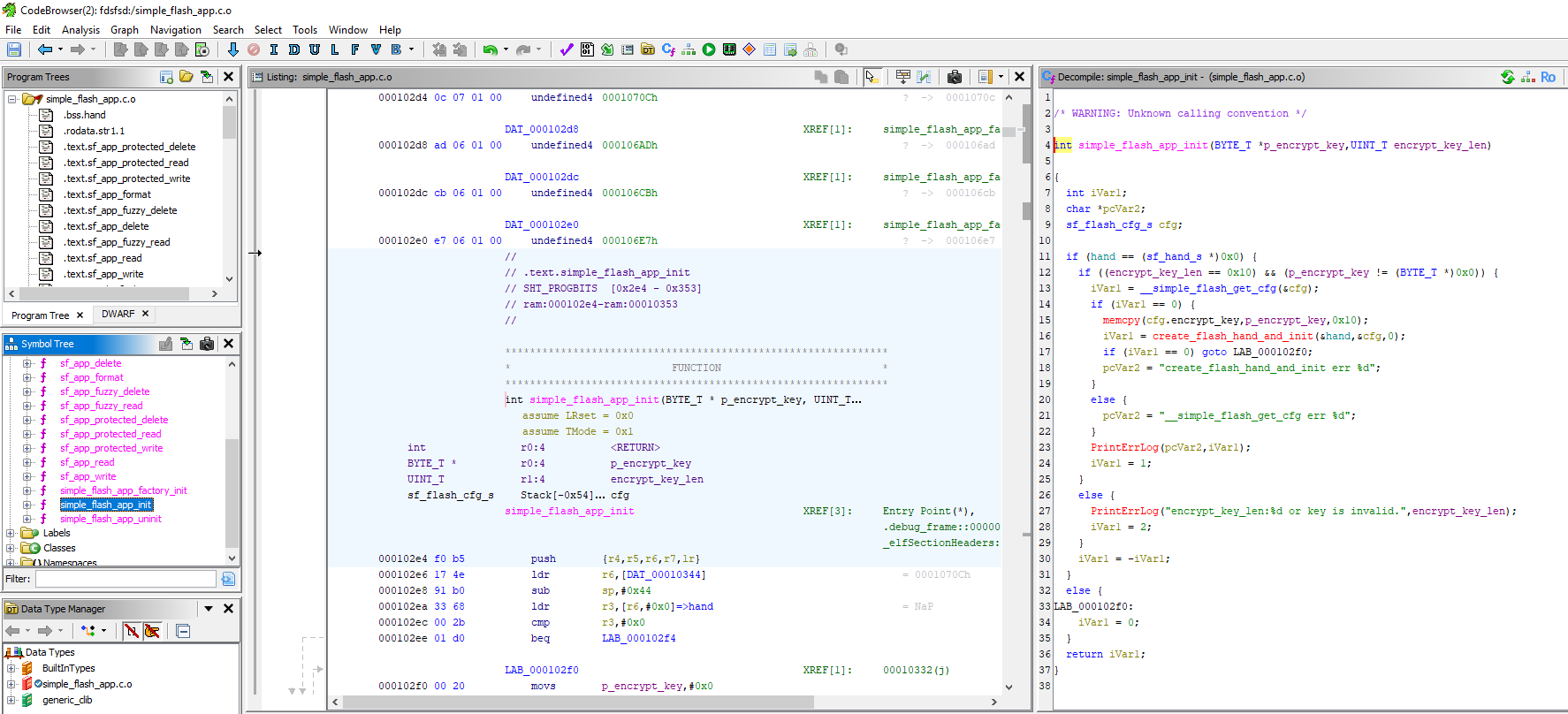

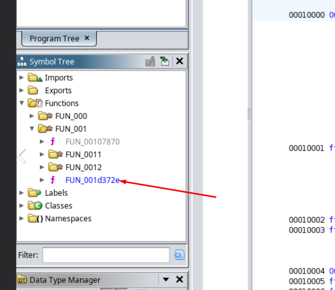

What is NDS32 in relation to the ECR6600 SDK, and how were people in the thread using Ghidra to analyze ECR6600 binaries?
NDS32 is the Andes CPU architecture used by ECR6600, and it is why stock reverse-engineering setups struggled with the binaries. The thread found the SDK used nds32le-elf-mculib-v3s, then built a custom Ghidra version with NDS32 processor support from an external branch. After that, users could at least open binaries and view disassembly. They searched for strings, constants like 0x13579753, and boot-log references such as the key print path to locate simple_flash and key-handling routines. The goal was to trace where ECR6600 derives or loads the Tuya secondary decryption key. [#21481465]
