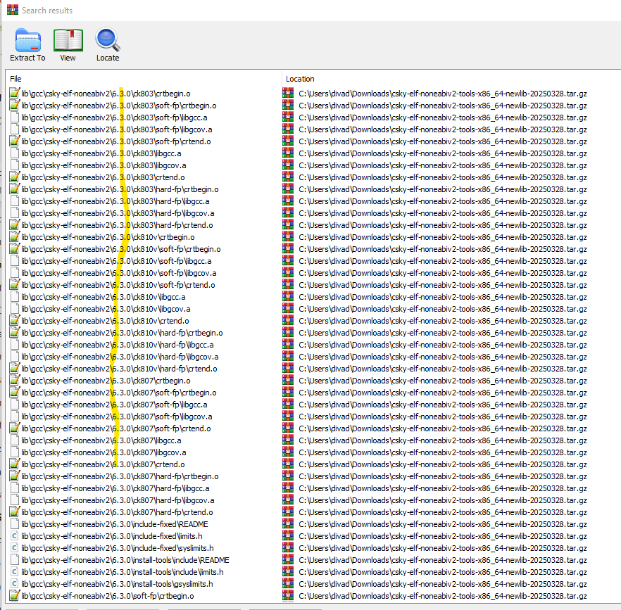

    >>21534191 v5 can't be used, different ISA i'm afraid.
    I'm more interested if risc-v gcc can work.
    Then there is also https://archlinux.org/packages/extra/x86_64/nds32le-elf-gcc/, but is it for v3 or for v5?
    And there are quite a few variants of v3, like v3, v3f, v3j, v3m, v3s. ECR6600 uses v3s, while TR6260 uses v3.
    For csky, what i need is csky-elf-noneabiv2-tools-x86_64-newlib-20250328.tar.gz
    Currently i use csky-elf-noneabiv2-tools-x86_64-newlib-20230301.tar.gz
    But i see little differences in size, so gcc version is probably the same - 6.3.0
  • #63 21534673
    Posts: 5026
    Help: 438
    Rate: 891
    ahh. ok. yes
    Screenshot of an archive manager showing a list of GCC library and header files within a .tar.gz archive.

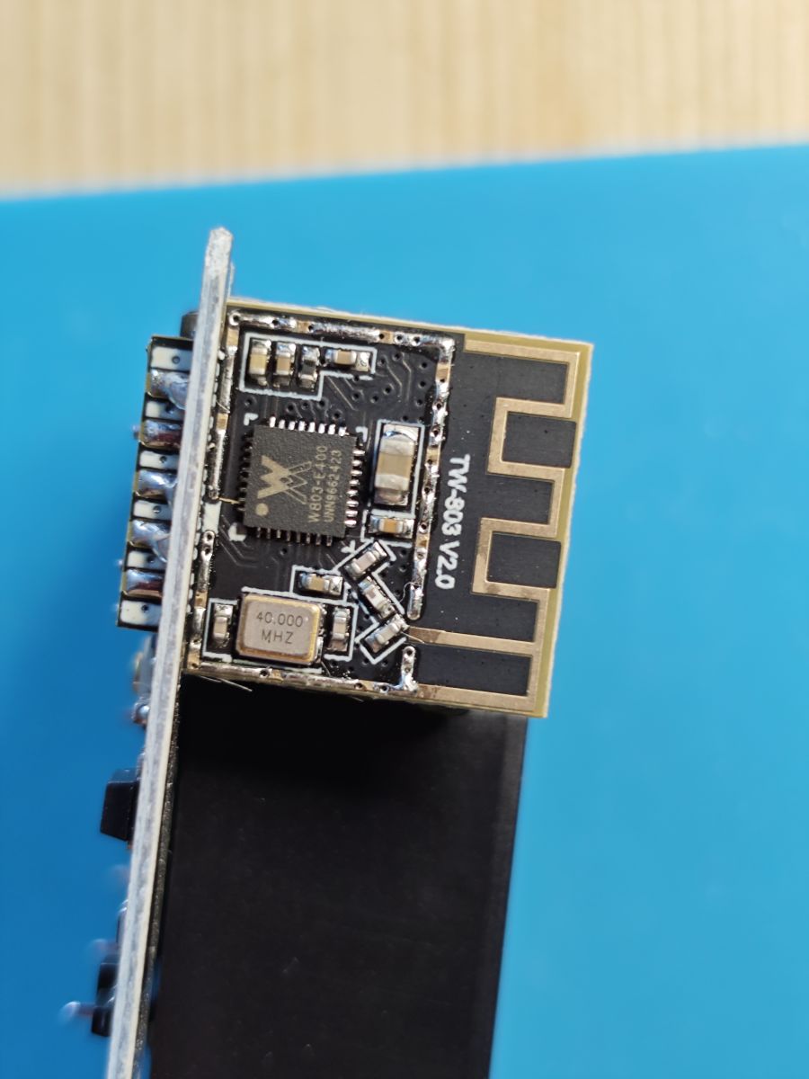

    Thought I was wasting my time with another square mini switch/breaker, but look!
    Wireless module labeled TX-803 V2.0 with control chip and PCB antenna on blue surface
    Will have a proper look at it when I can
  • #71 21635943
    Posts: 14580
    Help: 654
    Rate: 12604
    Wait, what? TW-803 V2.0? W803-E400? No results on our forum yet, you're first one?
    https://www.elektroda.com/rtvforum/find.php?q=W803

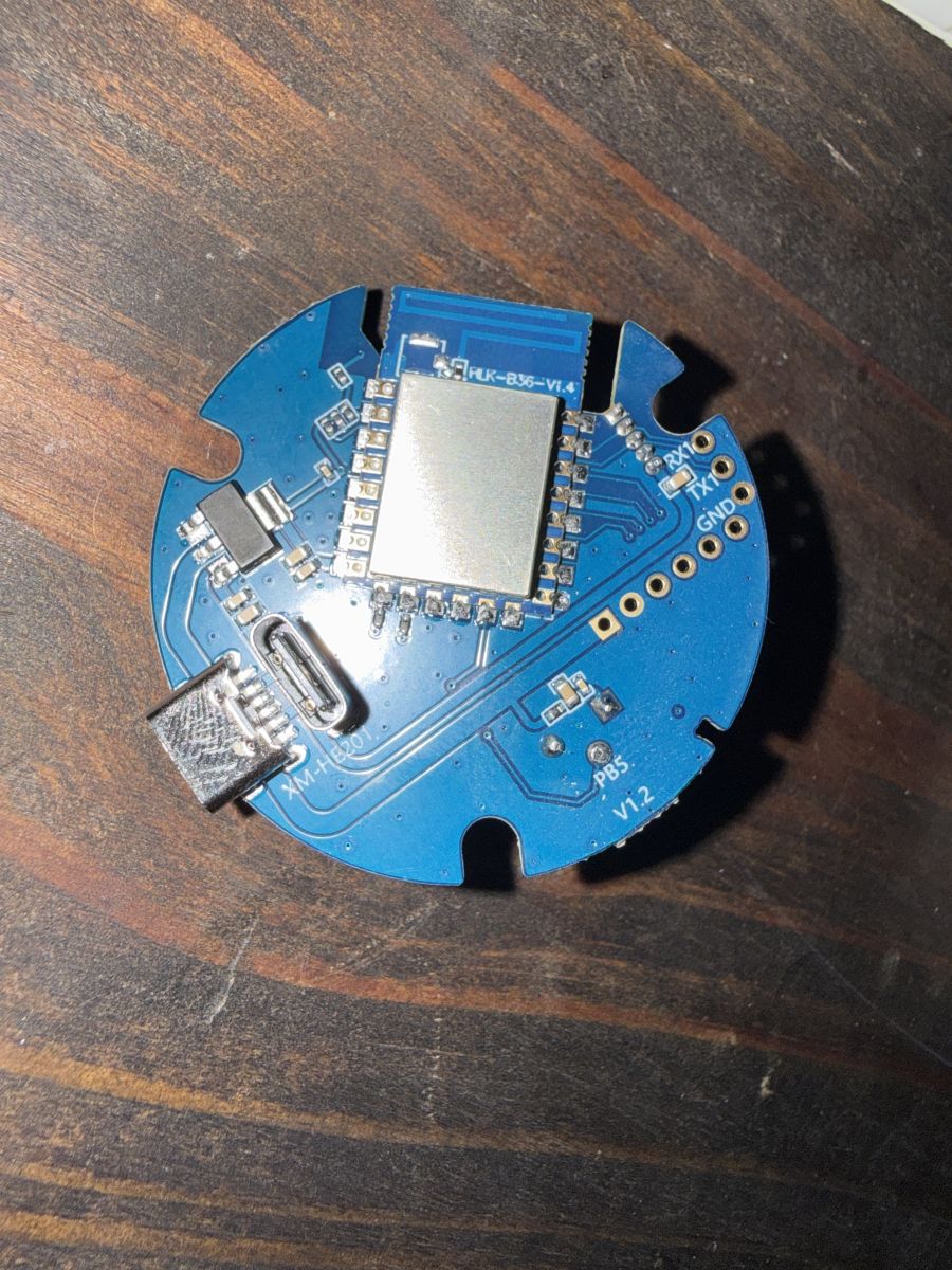

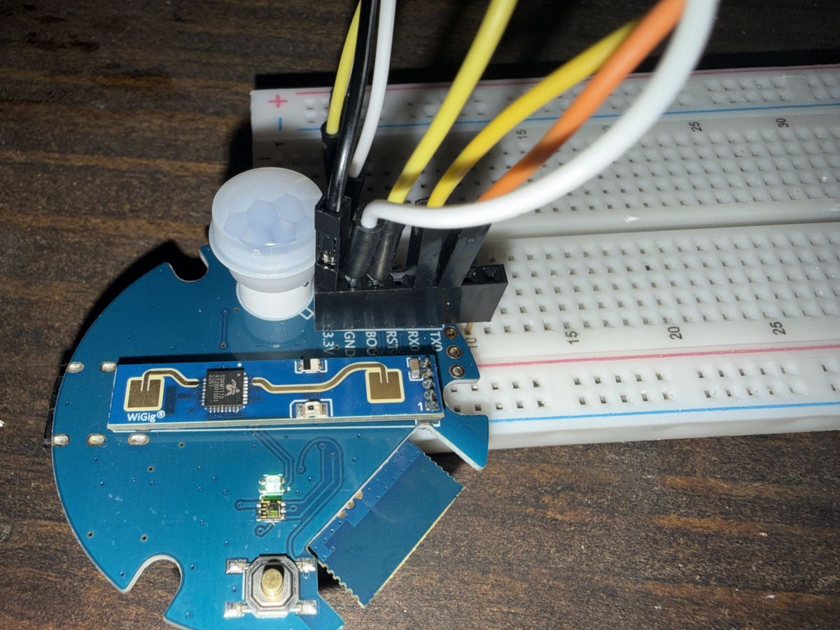

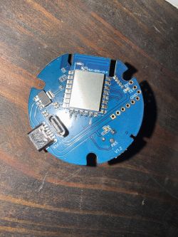

    W800 HLK-B36 spotted in Tuya presence sensor - XiuMii XM-HE201
    Round blue PCB with FLK-BX6-V1.4 module and USB-C connector PIR sensor module connected to breadboard with jumper wires
