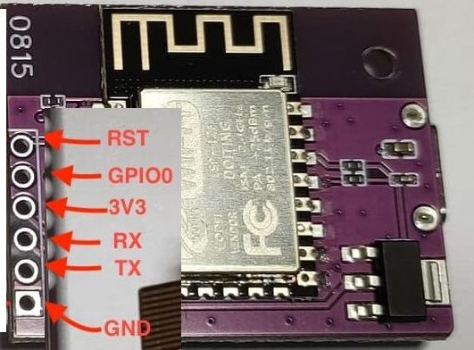

    This is the WI-FI display esp8266: board: esp12e
    There are different GEEKMAGIC models on esp8266 and ESP32
    I changed the software to ESPHome which allows the display of entities from HA

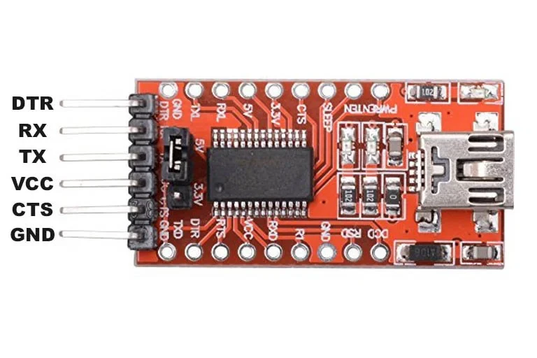

    I have connected the ESP board using the FT232 - FTDI USB converter
    GEEKMAGIC Smart Weather Clock ESP8266 ESPHome - integration with Home Assistant, entity display .
    ESP8266 ESP-12E board with clearly labeled pins: RST, GPIO0, 3V3, RX, TX, GND. .
    and I programmed

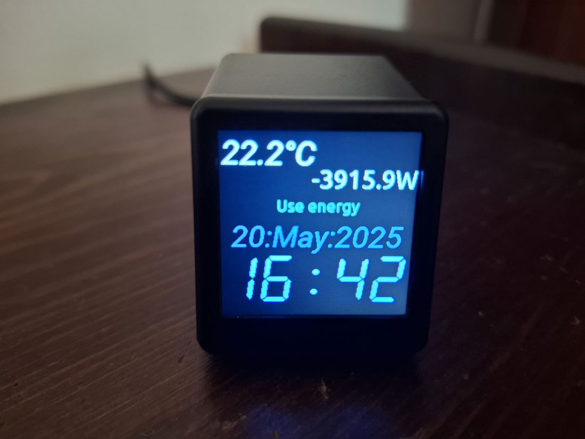

    Here is the result on the display you can publish the content of each entity from the HA in this case instantaneous power , date , time , outdoor temperature and use energy is the result of the hourly interphase balancing.
    Small cube with LCD display showing temperature, power, date, and time.

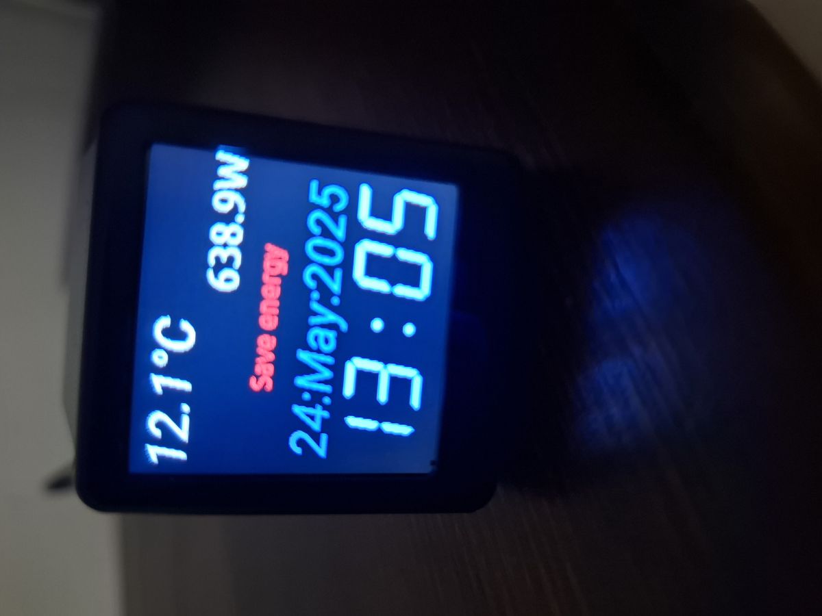

    Small change text Save energy displays in red when the hourly balance between phases is in the negative
    Electronic display showing temperature, power, date, time, and a red Save energy message.
