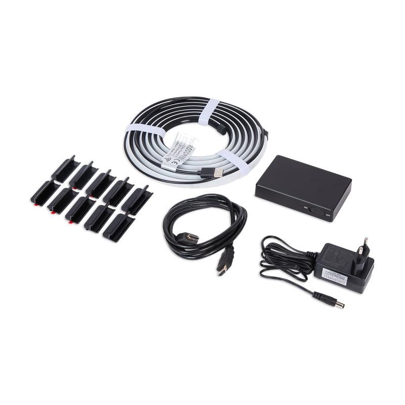

    The Smart HDMI Sync Box by Eurodomest was offered cheaply at Action in November 2024 and normally used with the LSC Smart Connect app.
    Set of electronic installation items: cable, power supply, cord, black box, and mounting clips.

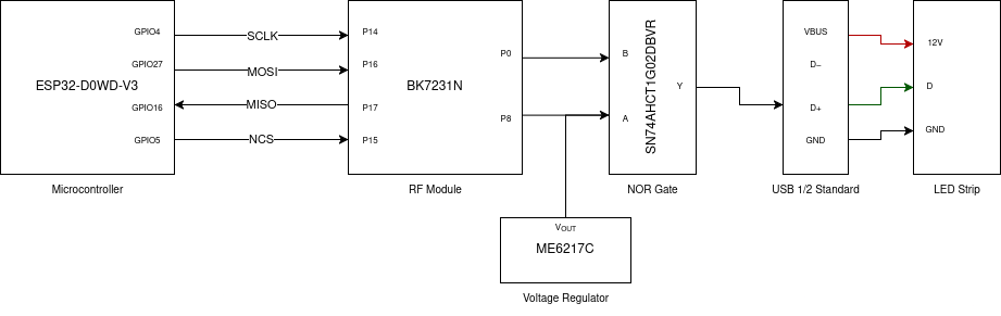

    A CloudCutter profile is already available for installing OpenBeken. However, the pin assignment could not be read out with the firmware dump and UART output, so it was determined by tracing the tracks. The ESP32-D0WD-V3 (master) and BK7231N (slave) microcontrollers communicate via SPI. Pin P0 and P8 of BK7231N control the LED strip, whereby they represent the inputs of a NOR gate and its output corresponds to the data line.
    Block diagram showing ESP32 microcontroller connected to BK7231N RF module, NOR gate, USB port, and LED strip.

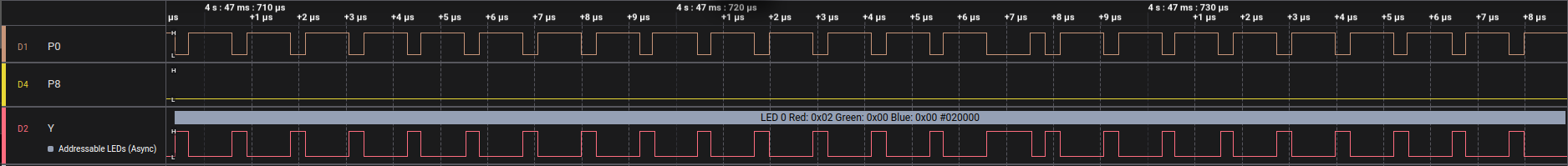

    The initial communication of the device in EZ mode recorded with a logic analyzer can be decoded using Logic 2 by Saleae as WS2812B protocol. P8 is actually permanently low and turns on the LED strip by high at the beginning. P0 corresponds to the inverted signal, which can be decoded.
    Screenshot from a logic analyzer showing digital waveforms, including a signal for addressable LEDs.
    A driver is now required which corresponds to the inverted actual signal for WS2812B. In addition, contrary to the existing SM16703P driver for P16 (MOSI), this is required on P8 without SPI. The transmission of the image information from the ESP32-D0WD-V3 to the BK7231N with SPI must then be examined in order to ensure that the LED strip is controlled in accordance with the image content.

    SM16703P uses P16 because it's a hardware SPI data output. The driver is using DMA to get precise timings.
    Are you saying that such precise timings are now needed on P0 of BK?
    I'm not sure how we can do that. We don't have a hardware SPI output on P0, do we? Then it could mean that they are using bitbang, but then we'll run into the flash cache issue... and will need a working ram func.
    Do you have boot log of original device? Maybe it could give us some hints how they did it
