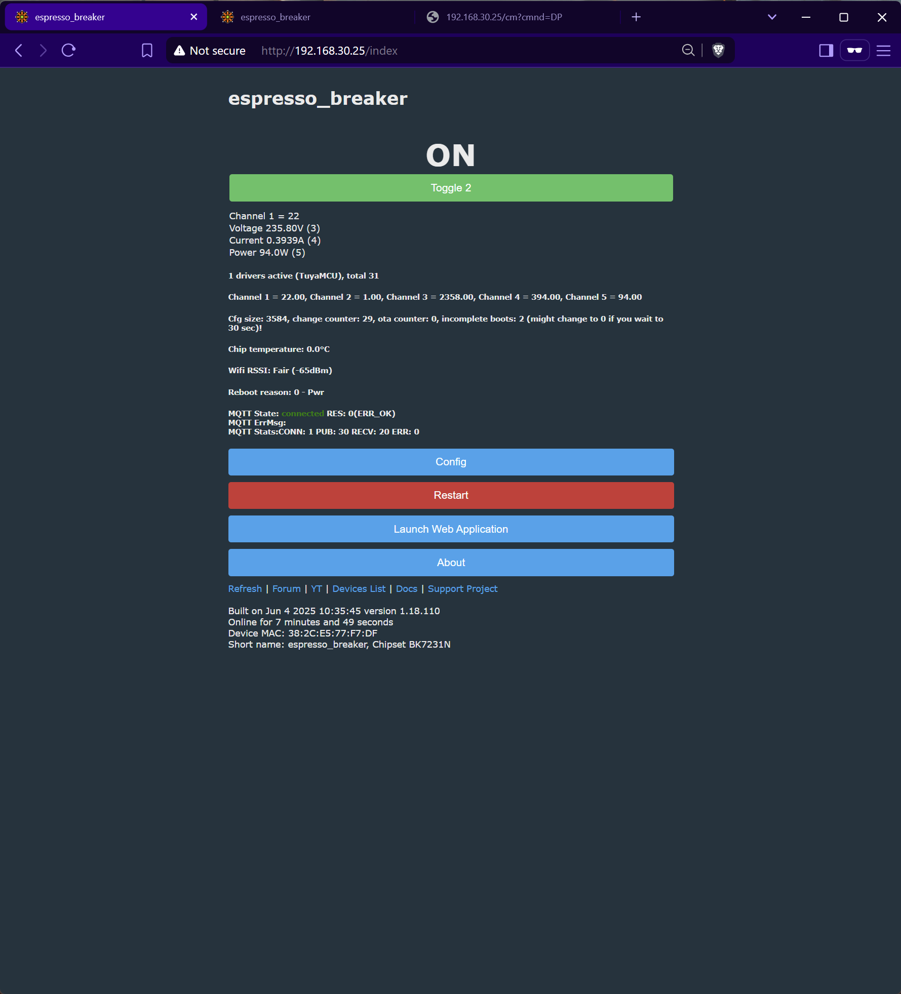

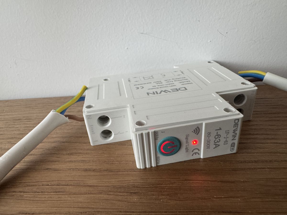

    lubopetrov wrote:
    Even when I press the physical button on the device the UI button "Toggle" switches colors red/green.
    Wait, what? This is very important information. Which physical button? Can you make a photo?
  • #43 21580815
    lubopetrov
    Posts: 39
    Button on the device
    Dewin RMDT-1PNL 63 Smart Circuit Breaker OpenBK7231 MQTT Setup
  • #44 21580818
    Posts: 14632
    Help: 655
    Rate: 12647
    This is crucial information and this means that communication with TuyaMCU works. So there are three options now:
    - maybe wrong physical connection?

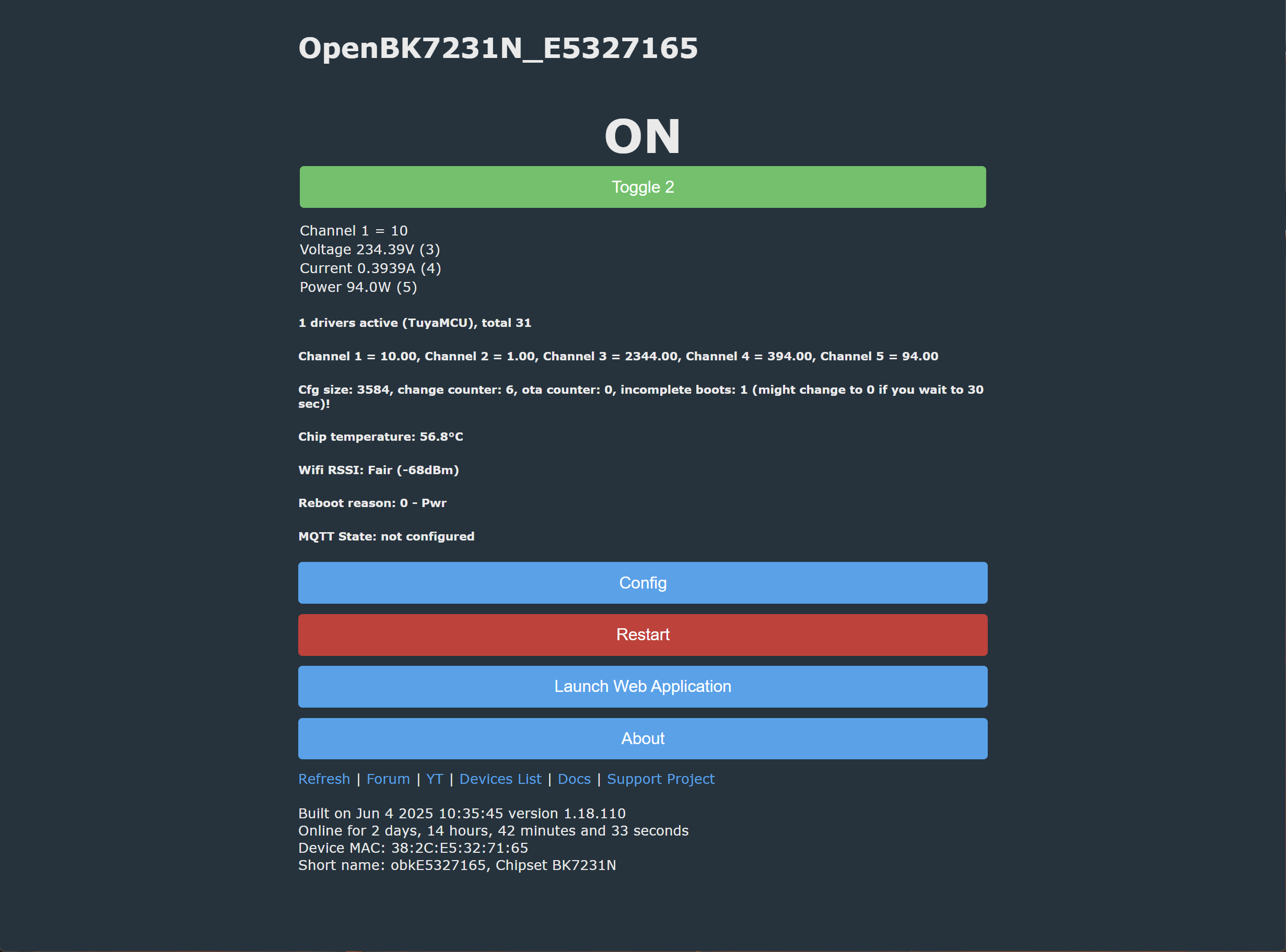

    - maybe relay inside is broken?
    - maybe device has some kind of extra setting within Tuya app or TuyaMCU that disables dpID 16 switch?
  • #45 21580826
    lubopetrov
    Posts: 39
    1. Wrong physical connection - very unlikely. The light is turning on/off
    2. Broken relay - again unlikely because of the reason above.
    3. Maybe ??? How to check? Can I reflash it back to the original and how?
  • #46 21580833
    Posts: 14632
    Help: 655
    Rate: 12647
    Hm ok, so reflash Tuya 2MB backup and check if it works in Tuya. Maybe some other dpID must be changed for it to work?
    So it's permantently shorted? I mean, is relay always open now or always closed?
  • #47 21580835
    lubopetrov
    Posts: 39
    The relay works as long as I use the physical button. It turns the light on/off. Btw, I haven't created a project or anything like this on Tuya dev site with this relay. How do I flash the backup fw?
    Added after 1 [hours] 43 [minutes]:
    I found out why this board was acting. When I soldered the wires accidently I damaged one line on the board.
  • #48 21581048

    Yes, thank you. This has been resolved. I still need help with following:
    1. Channel 1= 22 / I believe this is total consumption in kWh. How to change the name from "Channel 1" to "Total Power Consumption" and divide by not sure 100 or 1000
    2. Fine tune the value of power. I have but rated at 100w but is showing like 95W
    3. What is the current refresh rate for reporting values and can this be altered to report more often?
    4. How to present all the values above as MQTT data to Home Assistant?
    Can you please help me?
    Here is the current json output:

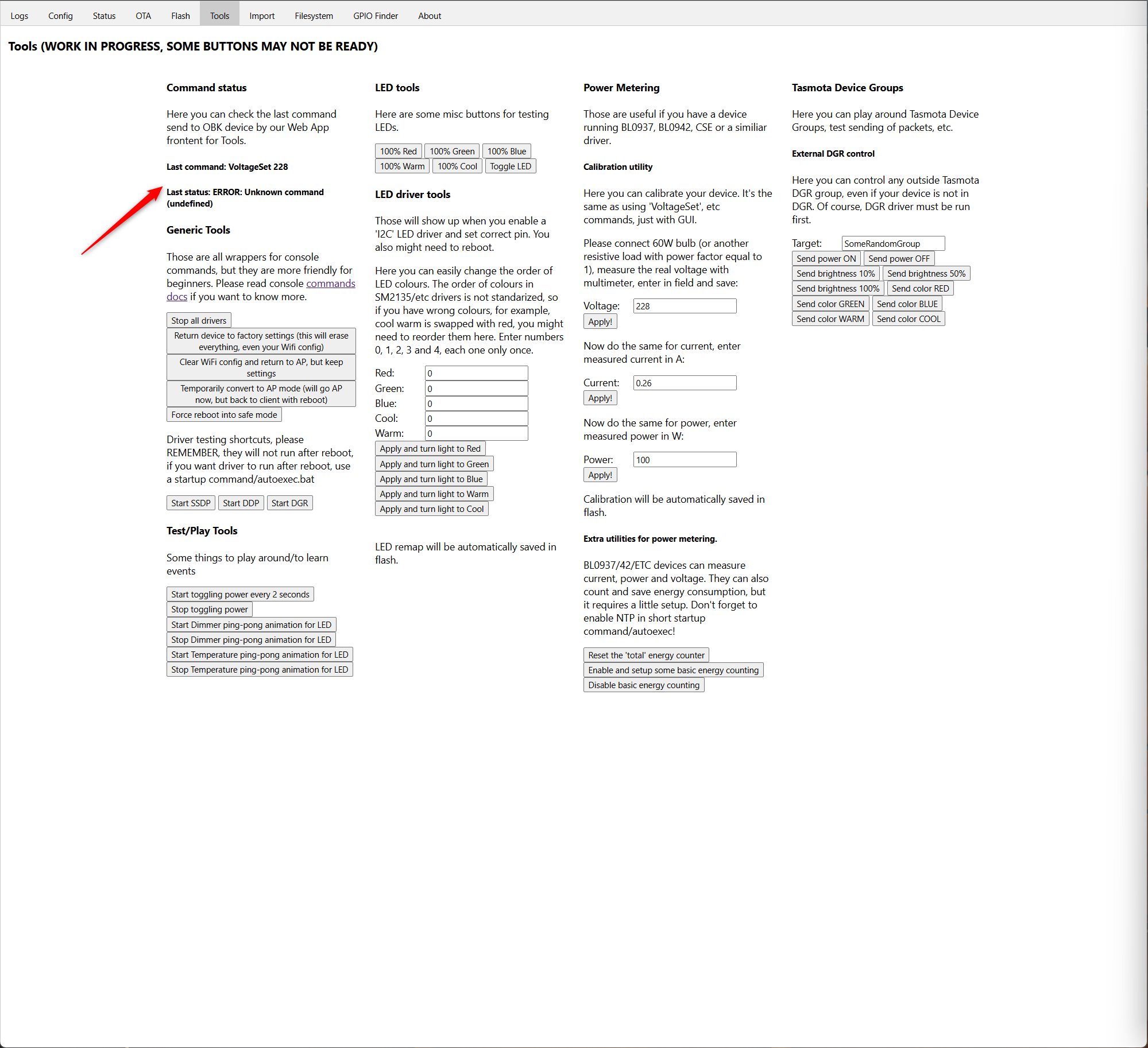

  • #50 21589240
    lubopetrov
    Posts: 39
    Why when I try to fine tune the voltage I'm getting error Last status: ERROR: Unknown command (undefined)
  • #51 21589431
    Posts: 14632
    Help: 655
    Rate: 12647

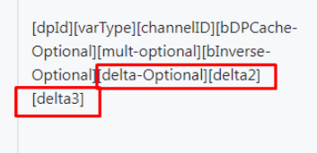

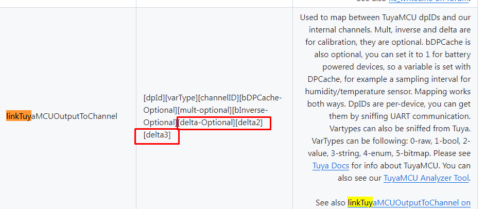

    1. Try EnergyTotal_kWh_div1000 channel type, maybe?
    2. You can specify offset while mapping dpIDs.
    Use 0 for dpCache, 1 for mult, 0 for bInverse, then specify deltas.
    3. If possible, then repeatedly request update from MCU:
    addRepeatingEvent 10 -1 tuyaMcu_sendQueryState
    Every 10 seconds.
    4. Use HASS discovery:
    Regarding last question: Voltageset is not TuyaMCU, just for BL0942/BL0937

    You can specify offset for the mapped value in autoexec.bat:
    Find the line where you are mapping the VCP packet (Voltage/Current/Power), fill the missing fields with default values, and use delta values to adjust Voltage/Current/Power.

    This is incorrect. You have:
    setChannelType 3 Voltage_div10
    setChannelType 4 Current_div1000
    setChannelType 5 Power
    And:
    linkTuyaMCUOutputToChannel 6 RAW_V2C3P3 3
    And arguments are:
    So you stub dpCache, mult and inversion:
    linkTuyaMCUOutputToChannel 6 RAW_V2C3P3 3 0 1 0
    and then add deltas for Voltage, Current, Power
    linkTuyaMCUOutputToChannel 6 RAW_V2C3P3 3 0 1 0 50 100 150
    In sample above, voltage raw value delta is 50 (5V), current delta is 100, and so on.
    Deltas are not scaled (in TuyaMCU values). You need to save and restart to see result I guess.

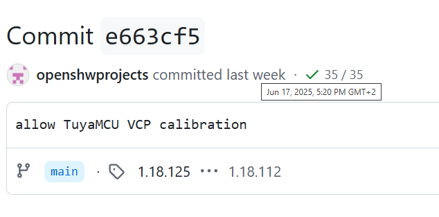

  • #59 21589871
    Posts: 14632
    Help: 655
    Rate: 12647
    Calibration for VCP was added on Jun 17, so you don't have it yet.
    Make autoexec.bat backup first.

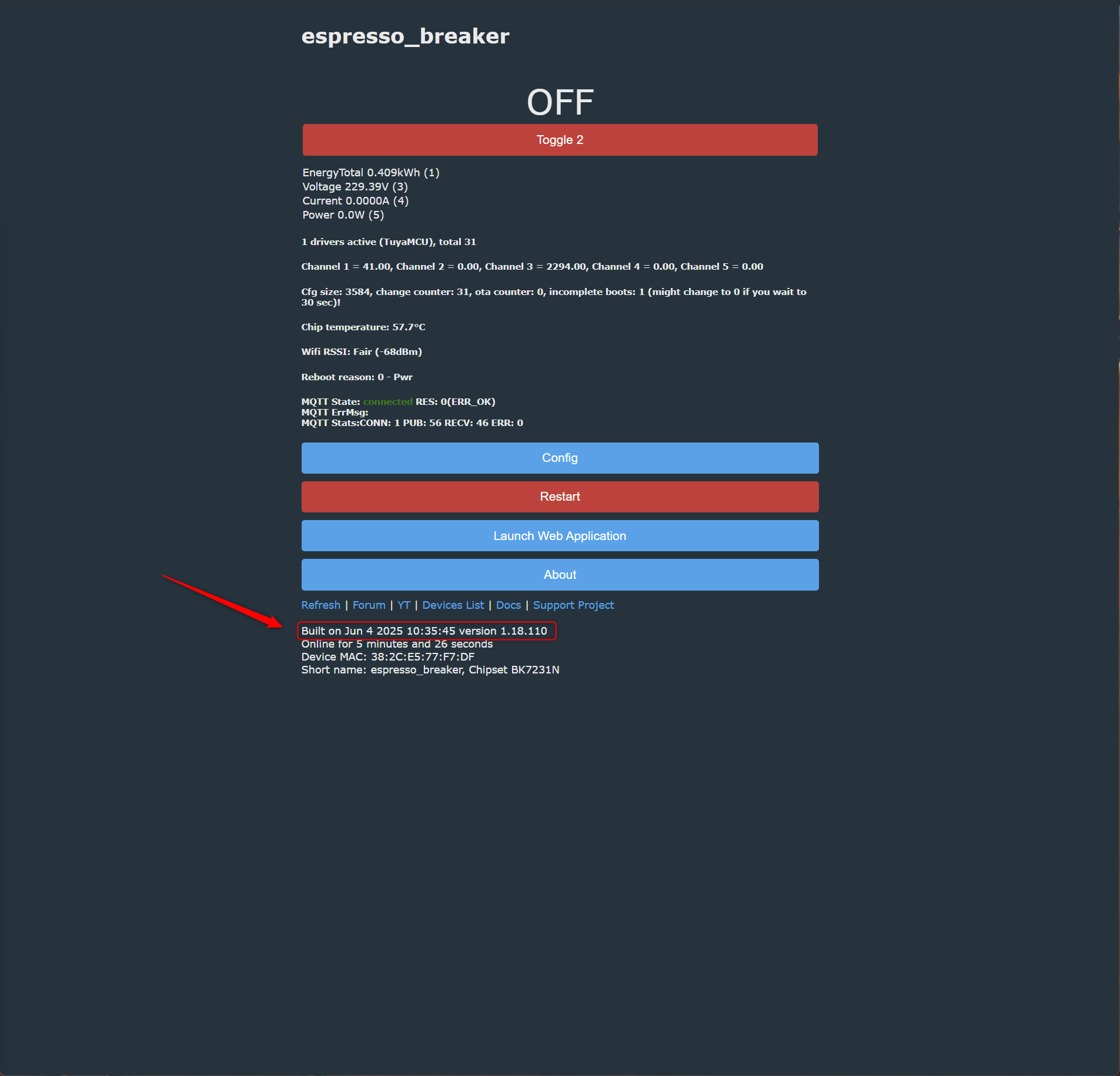

    But now there is another issue. When the bulb is off the device reports consumption of the delta value.

Key insight: This Dewin RMDT-1PNL 63 is a TuyaMCU breaker, not a simple direct-GPIO device. Map dpID 16 for the relay and dpID 6 for the 8-byte V/C/P packet, and the MQTT entities appear correctly. [#21574681]
  • dpID 6 carries an 8-byte payload in big-endian format: 2 bytes voltage at 0.1 V, 3 bytes current at 0.001 A, and 3 bytes power at 0.0001 kW. [#21580392]
  • The working switch mapping used dpID 16 as a boolean toggle, while voltage, current, and power were exposed on channels 3, 4, and 5. [#21574681]
  • Total energy came from dpID 1 and was later treated as kWh with scale 2, so EnergyTotal_kWh_div100 matched the thread’s final setup. [#21589864]
  • The breaker reported no meaningful load data over USB-only power; measurements appeared only after connecting it to mains with a real load. [#21572371]
  • Calibration support for VCP offsets was added after June 17, which explains why older OpenBK7231 builds ignored voltage and power deltas. [#21589871]

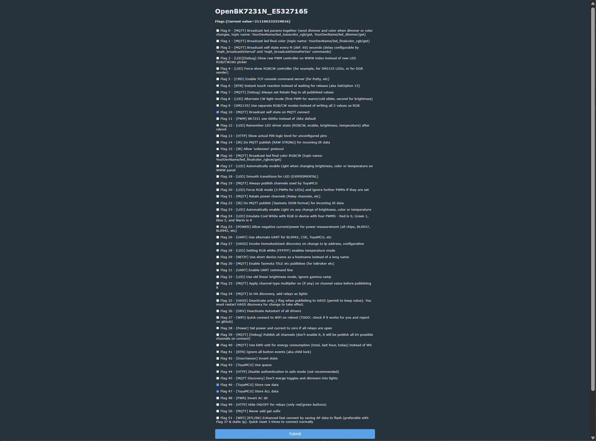

Where do I find the DP command output in OpenBeken, and how do flags 46 and 47 help with TuyaMCU debugging?
You get DP output by calling the device URL with cm?cmnd=DP. First enable flag 46, or optionally flag 47 for more data, then run tuyaMcu_sendQueryState, and open a URL like http://DEVICE_IP/cm?cmnd=DP. Flag 46 stores the last seen dpID values so OpenBeken can present them as JSON. That JSON is what you use to confirm whether ids like 1, 6, 16, 102, and 107 are arriving. [#21572288]
How do I map Dewin breaker dpID 16 to a working toggle and dpID 6 to voltage, current, and power channels in autoexec.bat?
Use channel 2 for the switch and channels 3 to 5 for metering. The working mapping was: setChannelType 2 toggle, linkTuyaMCUOutputToChannel 16 bool 2, setChannelType 3 Voltage_div10, setChannelType 4 Current_div1000, setChannelType 5 Power, and linkTuyaMCUOutputToChannel 6 RAW_V2C3P3 3. That made the UI toggle work and exposed volts, amps, and watts. One expert summary from the thread was simple: “set voltage, current, power channel types,” then map dpID 6 to 3, 4, and 5. [#21574681]

How do I add total energy from dpID 1 in OpenBeken and convert it to the correct kWh scale for Home Assistant?
Map dpID 1 to a read-only energy channel and use a kWh-scaled channel type. The final thread config used setChannelType 1 EnergyTotal_kWh_div100 and linkTuyaMCUOutputToChannel 1 val 1. The device schema described dpID 1 as total forward energy in kWh with scale 2, and later tests showed the value rising from 9 after about 1 hour to 21 after about 2 hours on a 100 W bulb, which confirmed it was the cumulative energy register. [#21575291]

How can I calibrate voltage and power in OpenBK7231 for a TuyaMCU breaker using linkTuyaMCUOutputToChannel deltas, and why did older firmware ignore the offset?
Calibrate by expanding the mapping line with delta parameters and using a recent firmware. The thread changed linkTuyaMCUOutputToChannel 6 RAW_V2C3P3 3 to a fuller form such as linkTuyaMCUOutputToChannel 6 RAW_V2C3P3 3 0 1 0 50, where later arguments add raw-value offsets. Older firmware ignored that because VCP calibration was added only after June 17. A later fix also stopped idle loads from showing the delta when real power was 0 W. [#21589905]
