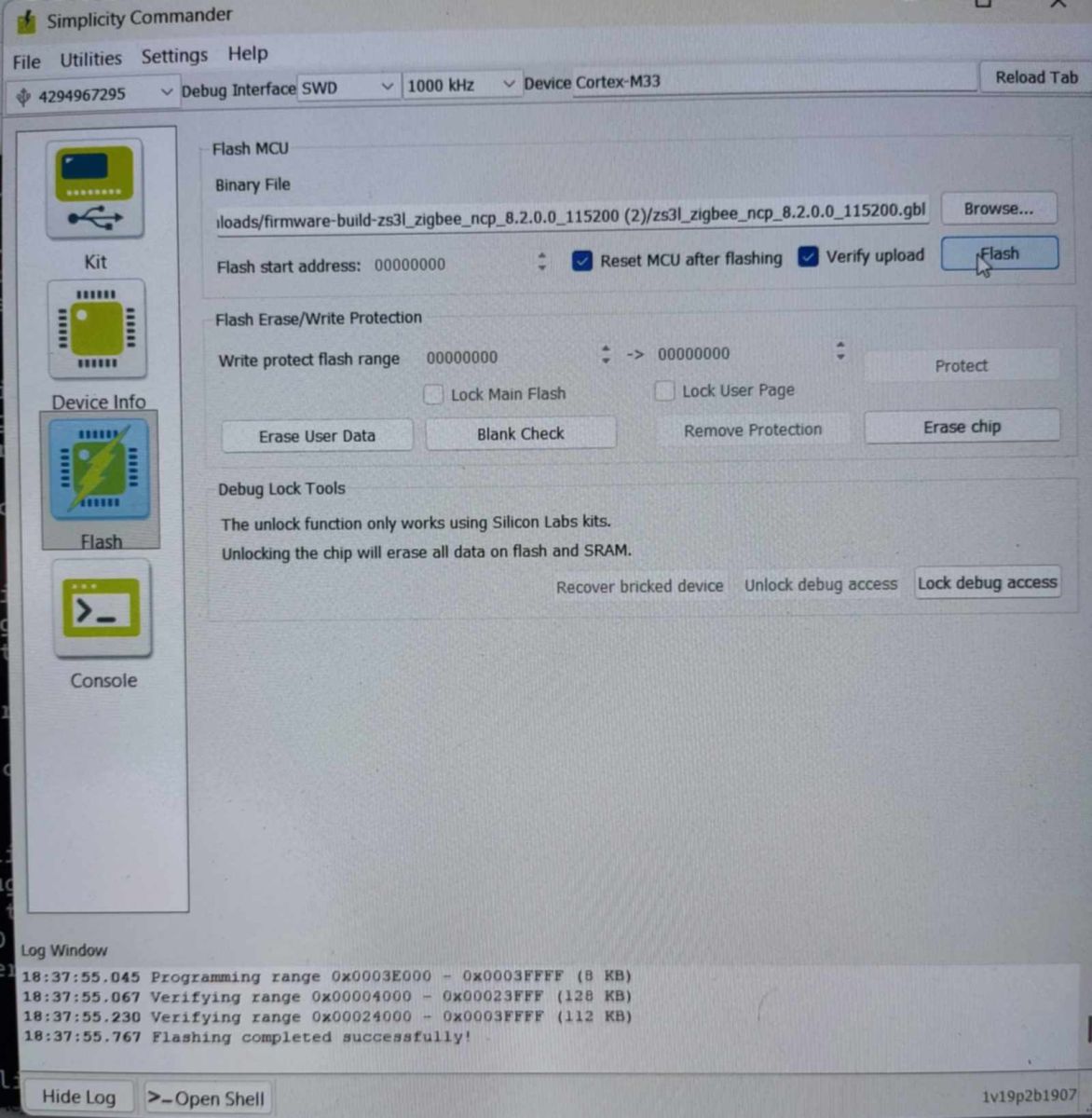

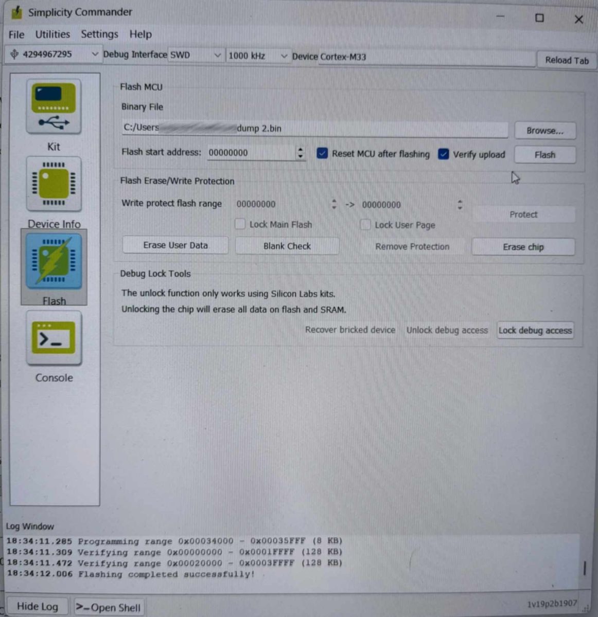

    Good news and bad news.
    Good news: flashing the new bootloader did NOT brick the device and still booted the stock firmware. This is where I started to get suspicious. If the new bootloader also boots the stock firmware, then it's unlikely to be the cause of other firmware not booting.
    Anyways, I proceeded to flash again 8.2.0.0
    Code: Bash
    Bad news: After flashing, the firmware still did not work :-(
    Code: Bash
    Nothing, nada ....
    I then flashed a couple more like zs3l_ncp-uart-hw_EmberZNet8.0.1.0.gbl, zs3l_zigbee_ncp_8.1.1.0_115200.gbl, G01-pro-ncp-uart-hw_4.gbl .... but they all did the same, nothing..... tested with bellows and Z2M and ZHA :-(
    I then reverted to my backup and am back on stock :-(
    Code: Bash
    There must be something stored in the flash or some other spot on the ZS3L preventing non-stock firmware from booting or making them crash, but I am too scared to go and erase the entire flash; maybe it's not in the flash, and then I'll brick it completely.
    Hopefully, these experiments and write-up help someone else, and maybe they come up with a solution.

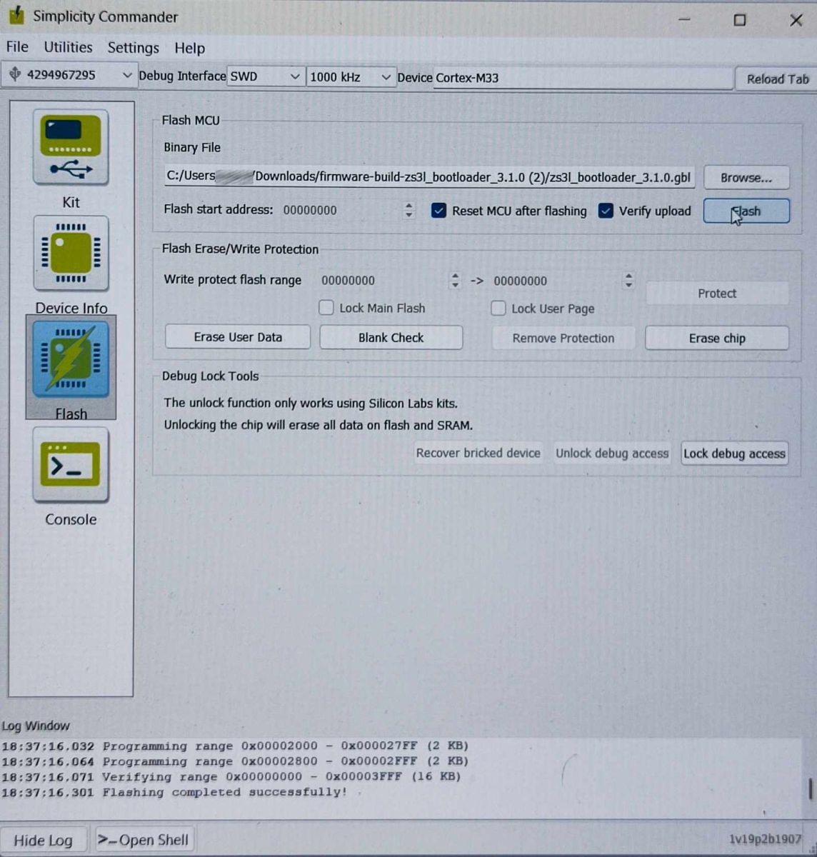

  • Bootloader 3.1.0 flashed before storage erase
    #37 21686371
    diepeterpan
    Posts: 22
    >>21686233 Thanks, I have just tried the init file, and there are a couple of specific .gbl files for the CPU that the ZS3L uses, but I had no luck after erasing the flash.
    Link
    I flashed the new bootloader 3.1.0
    Code: Bash
    Then, with the new bootloader, I erased the storage
    Code: Bash
    The flashed e.g. 8.0.2, tried various, but it did not work after flashing
    Code: Bash
    Then, with the new bootloader flashed, the stock firmware worked again
    Code: Bash
    It just does not make sense, somewhere something is wrong.....
    Anyway, let's see if somebody else has experienced similar and maybe come up with a new way to fix it.

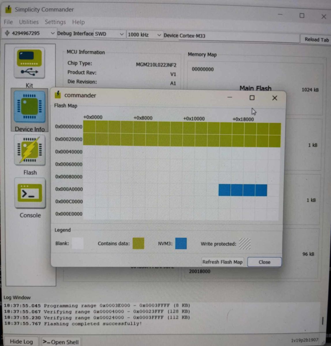

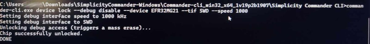

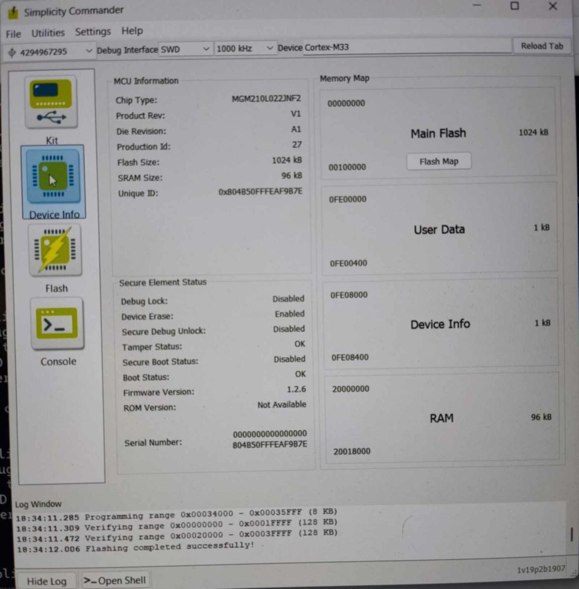

    I eventually got to JLINK the chip, making an interesting discovery, but I had no joy running a newer version.
    1) I first tried the command-line Simplicity Commander to unlock the chip, just in case it was the problem. Chip unlocked, but newer firmware did not work :-(
    Smart Gateway RSH-GW006 to OBK Conversion: Tools, Files, Setup, and Integration Guide
    2) This was very interesting as the chip is marked ZS3L, but the identification gave MGM210L022JNF2 with 1024kB flash instead of an EFR32 with 768kB. Does Tuya have a newer version of the ZS3L, and that's why the firmware doesn't run?
    3) I was able to wipe the chip, just in case. I then flashed a new bootloader and firmware, but no go to running it :-(
    Smart Gateway RSH-GW006 to OBK Conversion: Tools, Files, Setup, and Integration Guide Smart Gateway RSH-GW006 to OBK Conversion: Tools, Files, Setup, and Integration Guide
    4) I then flashed back the stock firmware backup, and it works. So I trust the JLINK is working correctly.
    I wonder if someone can create a custom .gbl file for this chip, if it indeed is the problem.
  • Different ZS3L variant confirmed to work
    #41 21693329
    diepeterpan
    Posts: 22
    >>21693266
    Tested both, but only one worked.
    You are a genius, so apparently, there are different ZS3L's out there!
    "And MGM210L022JNF (without 2)" <= worked!!!!
    I will add some devices to it in Zigbee2MQTT and let it run for a day or so, and provide feedback again.  A BIG thanks again!!!!!
    Code: Bash

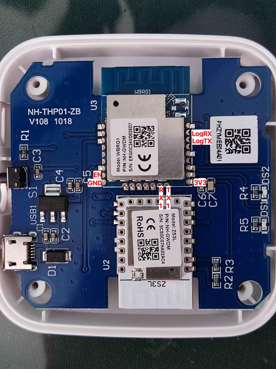

  • OpenBeken pinout and ZS3L firmware flashing steps
    #42 21694269
    diepeterpan
    Posts: 22
    >>21693329
    "Everything is working fine with the MGM210L022JNF firmware '8.2.0.0 build 191' for the ZS3L on the Tuya MOES gateway - NH-THP01-ZB using Z2M."
    Teardown pictures of the device:
    The device has 4 small screws hidden under the rubber feet
    Device top view:
    Device back view:
    Device PCB view:
    Interior of an electronic device with visible PCB and communication modules.
    Board pinout to flash WRBG1, need to solder lines as there are no headers on the board:
    Follow the bootloader procedure with the resistor to put WRBG1 into bootloader mode and load OpenBeken for RTL8720D UART file using the Imagetool.
    To load firmware for the ZS3L:
    Use the following firmware and universal-silabes-flasher that can be found here - https://github.com/NabuCasa/universal-silabs-flasher
    Code: Bash
    My version of the device has a ZS3L using the MGM210L022JNF chip and needs the firmware at https://github.com/NonPIayerCharacter/silabs-firmware-builder/actions/runs/17817962778 ; if you are unsure of what type of ZS3L your device has, you have to use JLINK and Simplicity Commander to identify it.
    firmware-b...115200.zip (1.26 MB)You must be logged in to download this attachment.
    OpenBeken pin configuration:
    autoexec.bat
    The Zigbee chip can be reset by toggling "Zigbee reset"; handy when the Zigbee chip stops working and you need to remotely reset it.
    Force the bootloader to load new firmware by toggling "Zigbee bootloader" followed by a "Zigbee reset" loader; this is helpful when the firmware becomes unresponsive e.g., when you load the incorrect chip firmware.
    Zigbee2MQTT config:

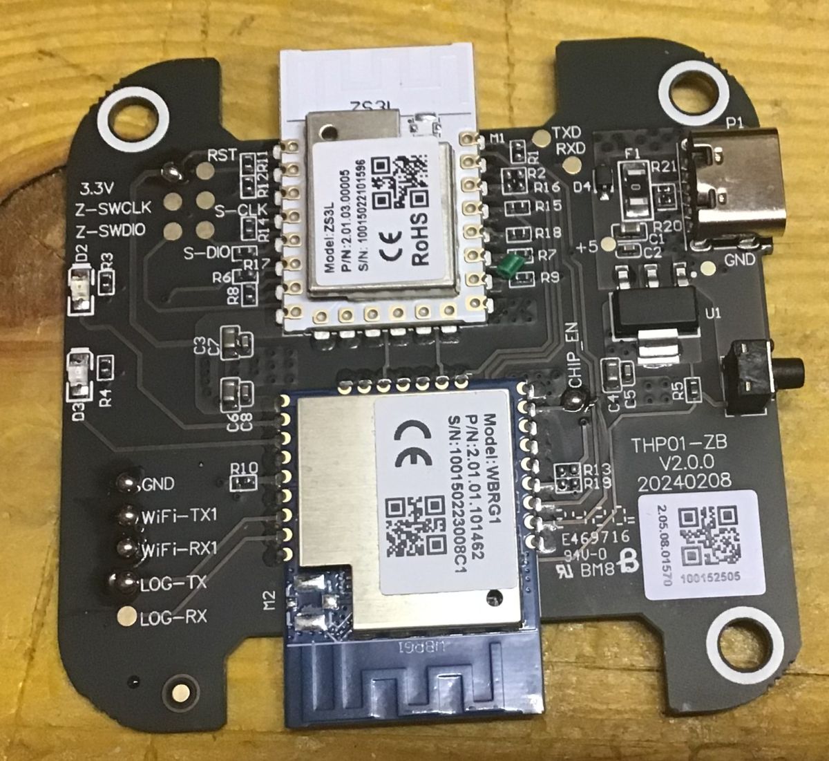

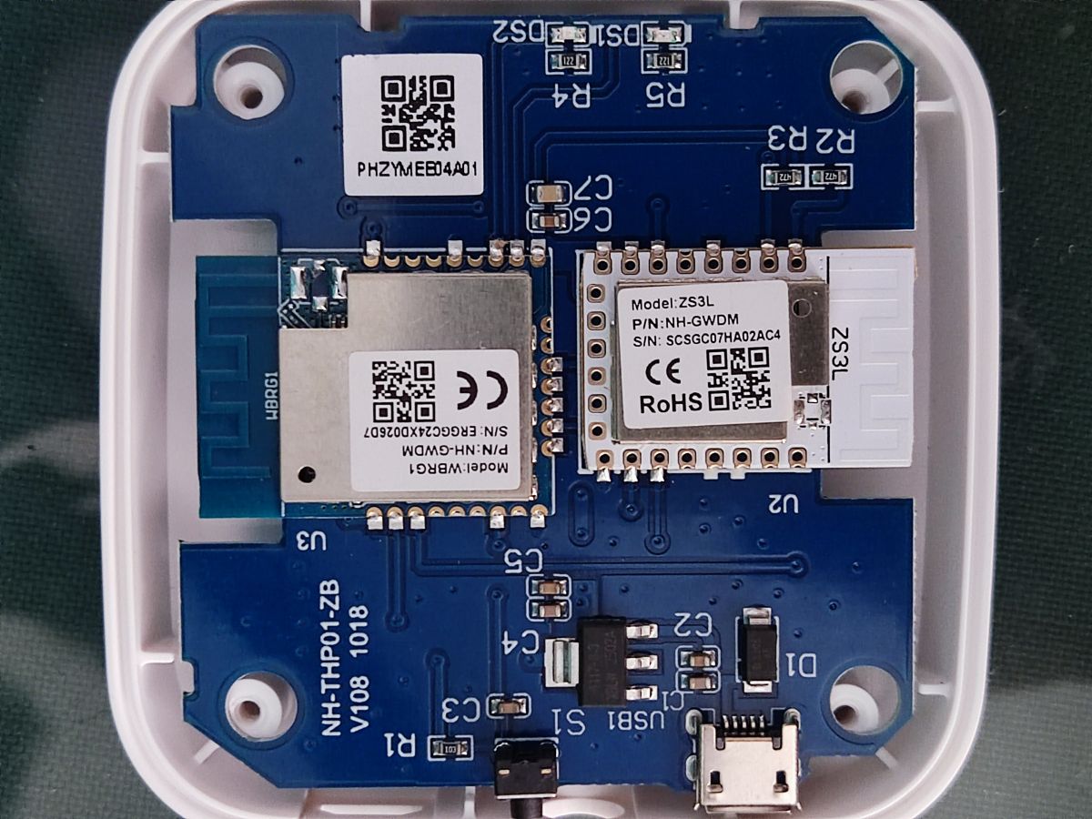

  • Bootloader flash failure on THP01-ZB module
    #45 21871411
    maxrower
    Posts: 9

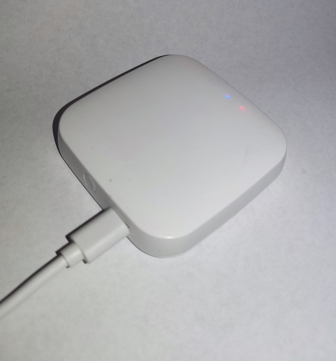

    Hello, I recently got another similar module; it was shipped with a set of Maginon Zigbee thermostat modules. Since I do not use that Tuya stuff, I thought converting it to OpenBeken was a nice idea.
    https://maginon.de/products/smartes-thermostat-gateway-wt-2g-100952
    Sadly, flashing it with the Image Tool V2.3.2 fails. I tried a new version of the Image Tool V2.8.10, and that one fails as well.
    COM4 is open successfully!
    Uart download server has started...
    Err: Flashloader download fail
    COM4 is closed successfully!
    I'm using this module: https://www.az-delivery.de/products/usb-c-zu-...t-ft232rl?_pos=1&_sid=0357d203a&_ss=r
    Print on the board:
    THP01-ZB
    V2.0.0
    20240208
    Print on the WBRG1:
    P/N 2.01.01.101462
    S/N 10015022******
    Print on the ZS3L:
    P/N 2.01.03.0005
    A/N 10015022******
    Putting the board in bootloader mode seems to work; at least there is no more output on LOG-TX. When booting normally, there is a lot of Tuya output.
    Any clues what to try next?
    Flashing with an ST Link V2? J-Link?
    Picture of the board, with solder applied to the relevant connectors.

    Flashing is done via Log-TX and Log-RX, not WiFi-TX/RX.
    And it's preferable to always take a backup before flashing.
    Our tool can both take a backup and flash WBRG1
    Select RTL8720DN (AmebaD) chip type.

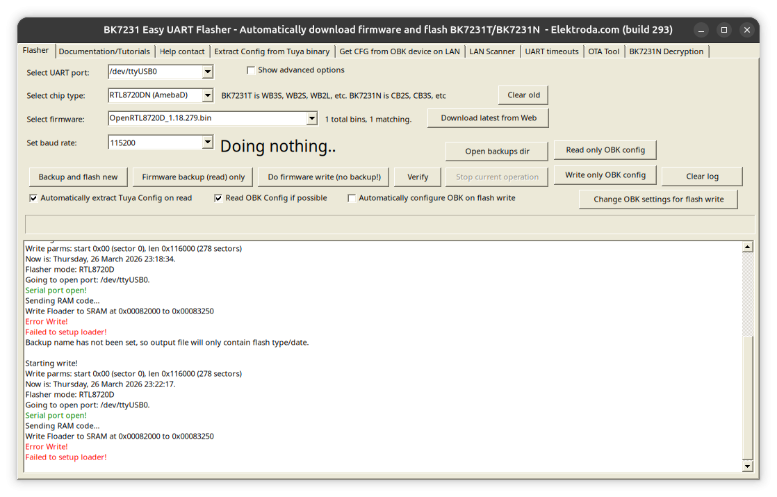

  • Linux flashing attempt via Mono also failed

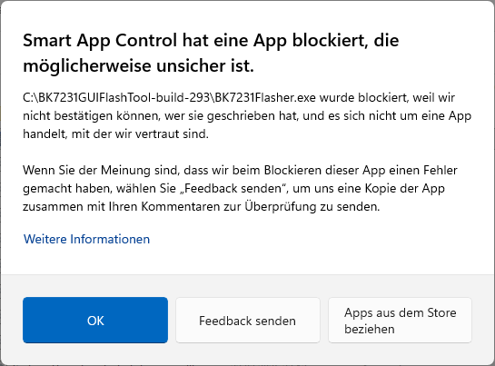

    #47 21871479
    maxrower
    Posts: 9
    >>21871429 Thanks for the quick reply. I will try again with the Log-RX and Log-TX. Is there a way to flash via Linux as well? I'm trying to minimize Windows usage.
    Edit: I read that it could be run using Mono, I will try that.
    Added after 46 [minutes]:
    >>21871479 Sadly, unsuccessful as well.
    Screenshot of BK7231 Easy UART Flasher showing log errors “Error Write!” and “Failed to setup loader!”
    Added after 15 [minutes]:
    >>21871479 F...ing Windows! I hate it!
    Windows Smart App Control dialog: BK7231Flasher.exe blocked as potentially unsafe

    >>21871479
    What steps have you took exactly?
    I have the same gateway as you, and i did it that way:
    1. Solder wires to LOG-TX/RX, GND and connect them to UART adapter
    2. Connect LOG-TX to GND
    3. Power it via USB Type-C
    4. Disconnect LOG-TX from GND
    If done correctly, it should start spamming NAK symbol (ASCII 0x15) at 115200 baud
    After that, flash read/write can be performed.

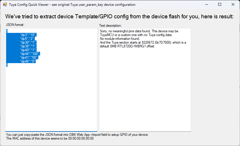

  • Windows Smart App Control blocks unsigned executables
    #49 21871522
    maxrower
    Posts: 9
    >>21871513 After disabling Windows Smart App Control, I could run it, and it did work! Finally, thanks for your help. Don't know why it didn't work with Linux.
    Screenshot of BK7231 Easy UART Flasher showing “Write complete!” and a flashing log output.
    Screenshot of Tuya Config Quick Viewer showing JSON dp entries and a message that no meaningful GPIO pins data was found
    Added after 6 [minutes]:
    >>21871513 Windows 11 seems to block any executables that are not signed correctly if Smart App Control is active.

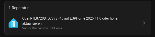

  • #50 21871543
    insmod
    Posts: 1432
    Help: 168
    Rate: 455
    >>21871522
    Attached both zigbee and OT firmwares
    For BT, use this in autoexec/startup command:
    waitfor wifistate 4
    btinit
    startdriver esphomeapi
    delay_s 2
    btstartscan
    In HA, connect it as an ESPHome device. No api key or password required.

    >>21871543 Ok, next gateway flashed, with Zigbee NCP 8.2.2. Tried Bluetooth as well (before upgrading the ZS3L firmware). Can Bluetooth be used concurrently with Zigbee or Thread?
    After registering the device as ESPHome in HA, HA immediately suggested an upgrade of ESPHome, would that even work?
    Screenshot of a notification prompting an OpenRTL8720D update to ESPHome 2025.11.0 or higher

    I haven't tried it concurrently, but it should. If there are problems, ble window and interval can be reduced (on RTL it's concurrent by default - window=interval). Command is BTSetWindowInterval, first argument - window, second - interval. Values in ms.
    For example - 150ms interval, 50ms window. That way 33% of time it scans, 66% idle or wifi communication.
    Update wouldn't work, just ignore it

What hardware is inside the RSH-GW006, and where does OBK run?
The gateway houses a WBRG1 (Realtek RTL8720D/AmebaD) Wi‑Fi SoC and a Silicon Labs ZS3L Zigbee NCP. OBK (OpenRTL8720D) runs on the WBRG1, while the ZS3L stays as the Zigbee radio exposed over a TCP‑to‑UART bridge. [Elektroda, DeDaMrAz, post #21588187]
How do I open the RSH-GW006 case without damage?
Flip the unit and peel the four rubber feet. Remove the four small screws hidden beneath them. Lift the lid carefully to avoid stressing internal cables. This exposes the WBRG1 and ZS3L modules for UART and J‑Link access. [Elektroda, DeDaMrAz, post #21588187]
How do I put the WBRG1 into bootloader (download) mode?
Follow this 3‑step sequence:
  1. Connect UART (GND, 3V3, RX, TX) to P1 and pull ENABLE to GND.
  2. Pull LogTX to GND via a 2.2–4.7 kΩ resistor.
  3. Release ENABLE, then remove the resistor from LogTX; the module is in bootloader mode. [Elektroda, DeDaMrAz, post #21588187]

Enter download mode, then run rtltool.py to read full flash, e.g., py -3.12 rtltool.py -p COMx -b1000000 rf 0 0x8000000 ff.bin. Adjust Python version with python -V and tweak baud (up to 1,500,000). Expect ff.bin ≈ 8Mb. Use COMx on Windows or /dev/tty* on Linux. [Elektroda, DeDaMrAz, post #21588187]
How do I flash OBK onto the WBRG1 with Ameba Image Tool?
Open Ameba-ImageTool v2.3.2, load the latest RTL8720D UART build into the first field, and do not change other options. Put WBRG1 into bootloader, click Download, then reboot. The device should broadcast an OBK AP; connect and configure at 192.168.4.1. [Elektroda, DeDaMrAz, post #21588187]
