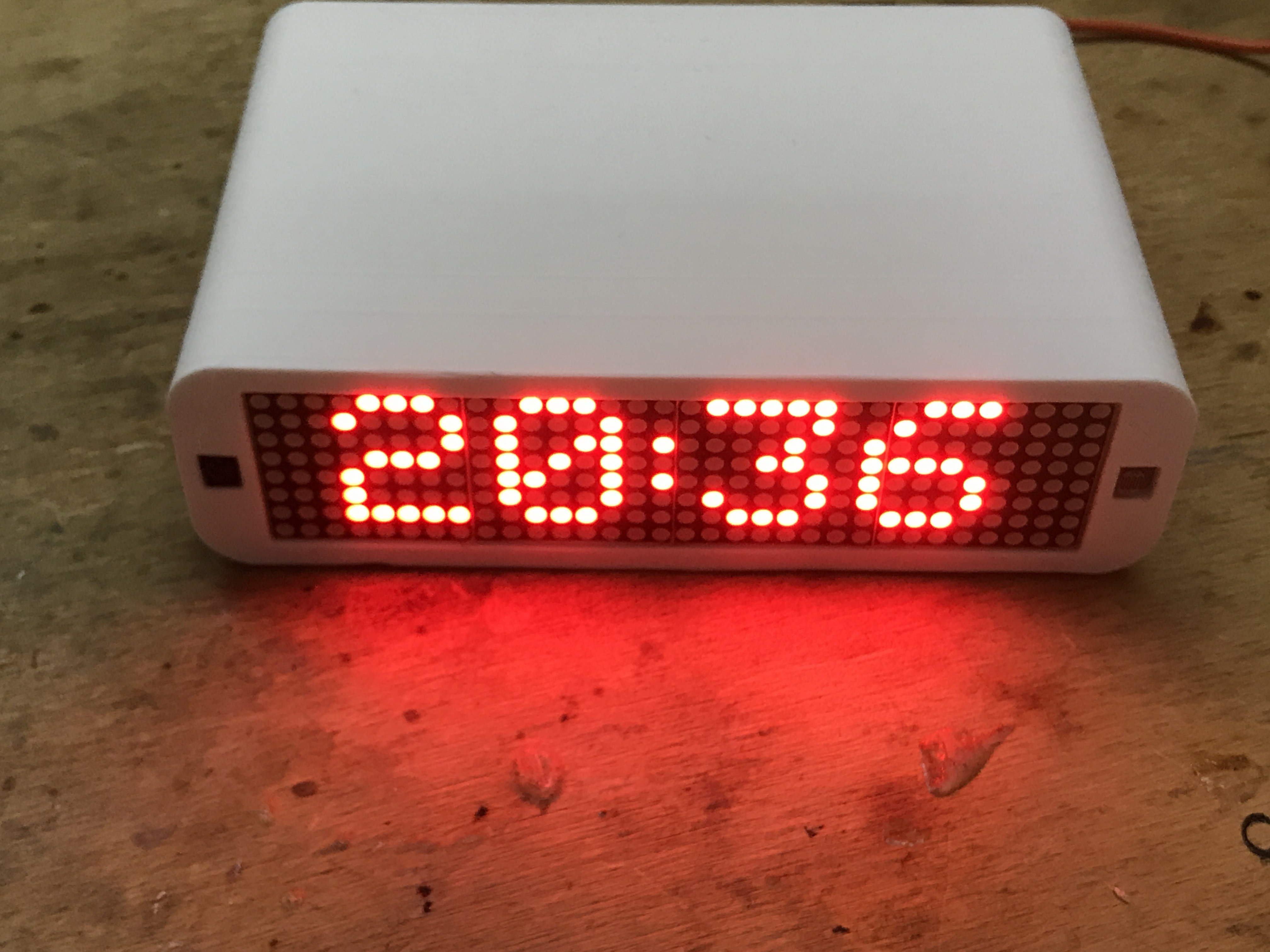

A few pics of the final operation of the device:
DIY device with an LED display showing the time. DIY LED display with 3D printed case Matrix LED display showing temperature 21°C in a white casing .
It alternates between showing the current time from the internet and the measurements from the DHT11.
Now I see a small typo, but maybe no one will realise .... it does not affect the operation.
Summary .
This is just a prototype, but I think it is fully functional and does the job well. I didn't do the board under it, but the pinout of my "sculpture" is fully sufficient for servicing, as well as the enclosure in its current form passes the test. In a free moment, it would be possible to make an "official version", already with the board designed under it and with the PCB mounts already included in the 3D printout. I will have to think about it, maybe I will design something in Eagle and order 5/10 pieces in China in the cheapest price range (10cm by 10cm), or I will etch something myself, but about that another time. The main thing is that the front rather looks good and gives a nice effect both day and night.
It's also worth noting here that the whole gadget allows me to use the remote to control any number of devices in the room without Home Assistant. The project receives the IR signal and then makes a GET request to the OBK or Tasmota device in question. HA here is not needed, although if I want to use it, I can simply forward it on to MQTT when an IR event is received.... the possibilities are very high.[/td]
