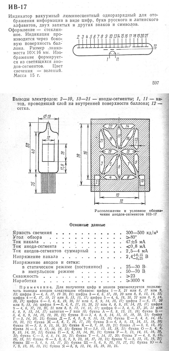

    Description and presentation below , designed and made by me, clock based on VFD IV-17 tubes .
    The impulse to make the clock is largely inspired by the video presentation of the Wiktor clock in action:
    https://www.elektroda.pl/rtvforum/topic3196412.html
    The design uses the application notes of the VFD lamp
    http://www.spark-tube.com/wp-content/uploads/2018/08/iv-17-datasheet.jpg
    https://www.eevblog.com/forum/projects/driver-for-iv-4-iv-17-18-segment-vfd-tube/
    Having previously made a clock on the IV18 lamp (and gained some experience), I decided that it was time to start with a much more complicated - much more representative 18-segment IV17 lamp.
    Note here: IV4 (IV-4, ИВ-4) and IV17 (IV-17, ИВ-17) tubes are replacements, and sometimes the designation IV4 may appear in this description.
    The main assumptions for the design of the IV17 clock
    - clock on 6 IV17 tubes;
    - use of the HV integrated circuit to control the segments (in the IV18 clock I used NPN keys to control the segments, it's possible, but a lot of extra work);
    - the control element will be STM32F103.

    The construction of the clock boils down to the proper power supply and logic operation of 6 VFD IV17 tubes. By assumption, for the 18-segment VFD, the mode of operation with multiplexed display was selected.
    POWER
    High voltage DC power supply based on the standard MC34063, with an interesting option to improve the MOSFET control, borrowed from the link:
    http://mirley.net/boost_converter_for_lamp_nixie.html
    A 120µH inductor (Imax > 1 A) was used, a MOSFET transistor IRL540 with reduced turn-on voltage U GS(th) . The output voltage of this DC-DC converter is 45 V. This voltage value was selected in order to extend the life of the VFD lamps (for multiplexed operation, the note suggests 50-70 Vdc, for static operation 25-30 Vdc) while maintaining sufficient brightness.
    The power supply of the lamp filaments with 1R resistors included in the circuits was selected so as to ensure the catalog operating conditions U fill ~2.4 V. The polarity of the glow potential was changed - the integrated circuit of the L9110 bridge was used.

    – main board includes: µC, all power supply circuits, HV5812 segment driver, USART, SPI, I2C interfaces;
    – Display intermediate board includes: NPN (BC847)-PNP(BC856) keys to control 6 grids of VFD tubes, 2xIDC12 connectors for each IV17 tube;
    – VFD IV17 tube board includes: 2xIDC12 connectors, 1 IV17 tube.
