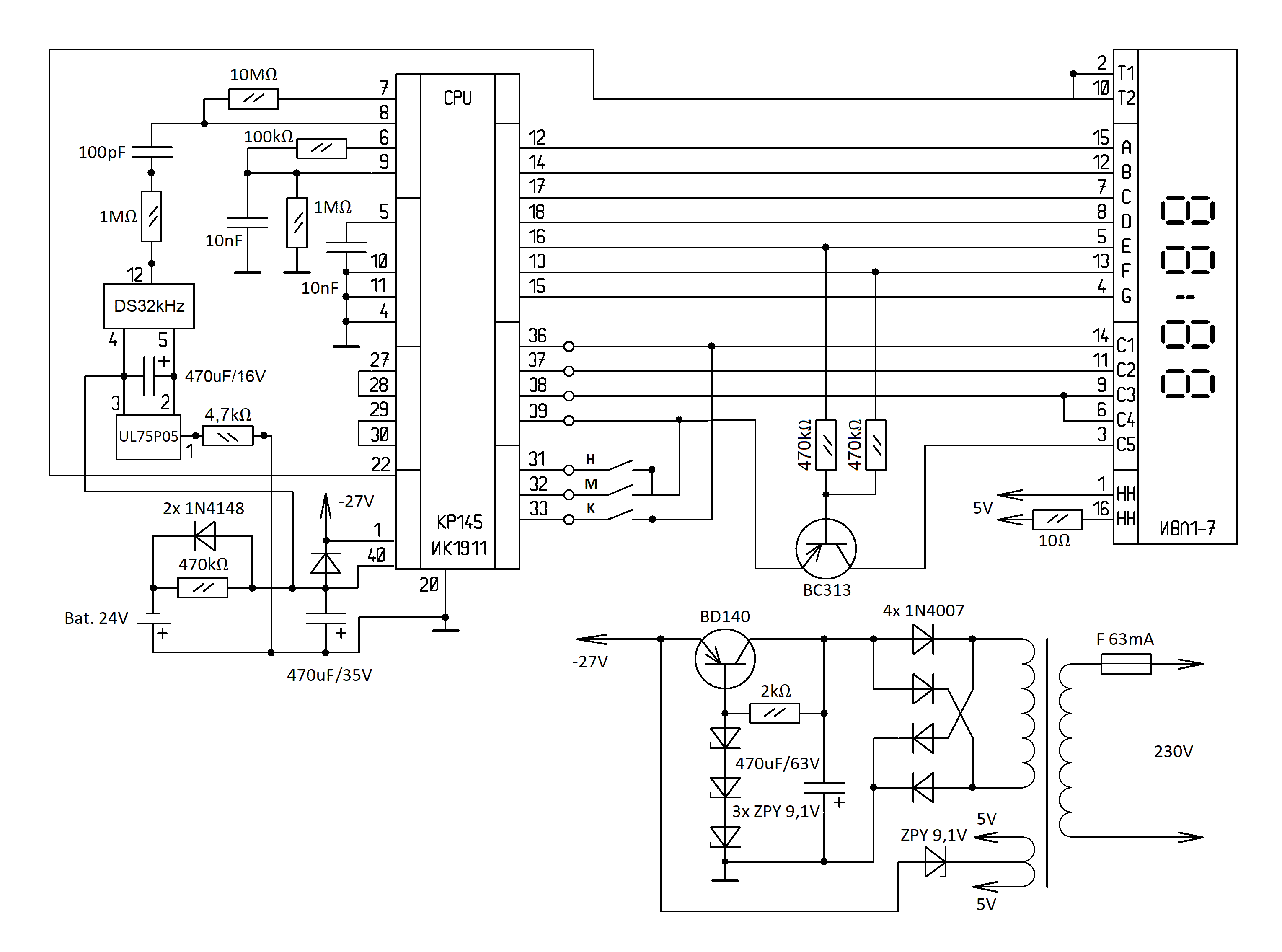

    The heart of the clock is one of the oldest specialized Soviet microcircuits for electronic clocks, made in the p-MOS technology КР145ИК1911 (KR145IK1911) in a 40-DIP housing. The system can control external devices or simply serve as an alarm clock and timer. I did not use these functions in my solution. The whole thing was assembled on a universal printed circuit board.

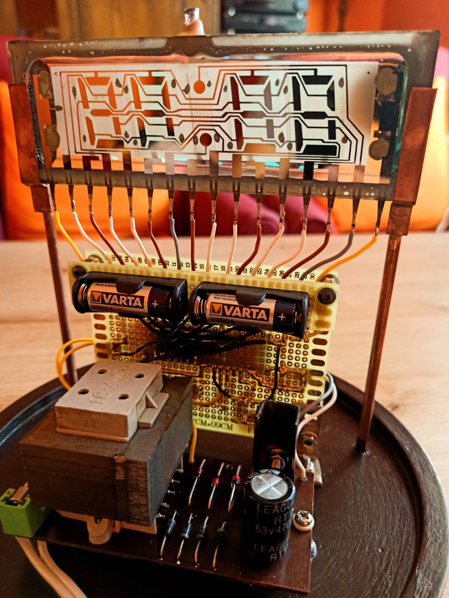

    The power section remained on the original board from the damaged clock. The КР145ИК1911 microcircuit requires a -27V DC power supply, which comes from a stabilizer based on a rectifier bridge, zener diodes and a transistor. A low-power transformer with two secondary windings is used, one to obtain a voltage of -27V and the other to obtain an alternating filament voltage of 5V. Since the display heating circuit is also the cathode, the transformer has a tap in the middle of the winding. In order to extend the life of the display, the glow voltage is reduced to approximately 4.8V. The clock is also equipped with a main oscillator maintenance system based on two A23 batteries connected in series.

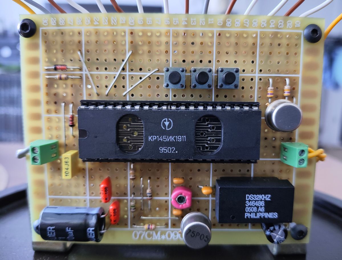

    A seven-segment digital code is generated at the outputs of the microcircuit 12-18. The VFD display ИВЛ1-7/5 (IVL1-7/5) with multiplex control is used to indicate the numbers. Signals from the КР145ИК1911 system control the potential of the anodes of individual digits and service characters, ensuring their alternate activation. Only one digit is displayed at a time, but the transition from one digit to another occurs at a frequency of 500 Hz, which makes the digits on the display appear to be continuous to our eyes. The display`s service characters (dots) are flashed by giving a 1Hz signal from output 22. The clock also has a blanking function that does not indicate zero when displaying single-digit hours, based on the BC313 transistor and two resistors.
    The main oscillator is located inside the microcircuit and connected to a standard watch quartz crystal resonator with a frequency of 32.768kHz. The oscillator was initially connected to a resonator system and two 20pF capacitors. However, its accuracy was not satisfactory, as I wrote about here: https://www.elektroda.pl/rtvforum/topic3852502.html.
    Therefore, I decided to add additional capacity to the system in the form of a 4.2-20pF trimmer capacitor. Despite numerous attempts to adjust the frequency and replace the capacitors with slightly larger capacity (22pF), I decided to look for a different solution.

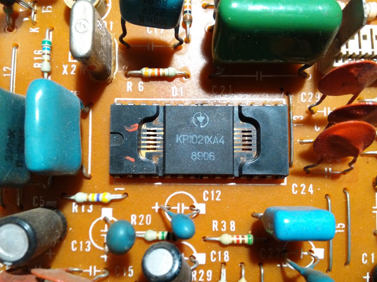

    Original version of the clock:

    Finally, I used a specialized DS32kHz circuit from Dallas as an oscillator, which is a temperature-compensated crystal oscillator (TCXO) with an output frequency of 32.768kHz. It is powered by the UL75P05 stabilizer with a voltage of 5V, the system also has a power supply backup based on the reserve power supply of the main oscillator of the КР145ИК1911 system. The DS32kHz system used, according to the manufacturer, has a deviation of ±2ppm, which results in ±1 minute / year (0.17 seconds / day). The system works perfectly, the clock is very accurate. Currently, after three months of continuous operation of the clock, the deviation from real time was approximately +0.03 seconds/day (+0.9 seconds/month), which gives an accuracy of ±0.3 ppm! After a year of trouble-free operation, the deviation was 6 seconds.
    According to the manufacturer`s data sheet, to obtain greater running stability, it is worth powering the DS32kHz system with a voltage close to 5V (preferably about 4.9V), as you can see, it gives very good results.
    The UL75P05 voltage stabilizer and the BC313 transistor used come from the era and are manufactured by the Polish CEMI, made in TO39 metal "hat" housings.
    Final wiring diagram:
    Clock with VFD display IVL1-7/5 based on KR145IK1911 and DS32kHz

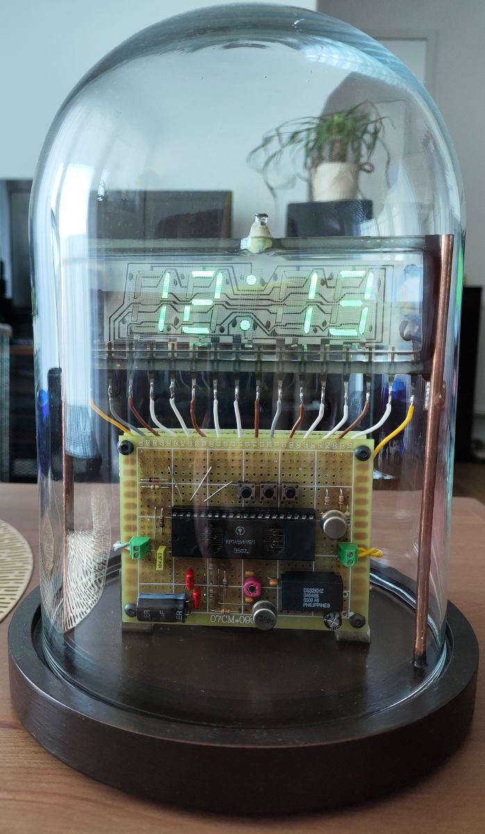

    Clock appearance:

    tomekptk wrote:
    Those who remember this "system" know that there was simply no (after all, everything was still missing at that time) proper housings, so they were loaded with windows that were supposed to be, for example, for EPROM memory or secret microprocessors to control ballistic missiles
    If it was a replacement as a result of a shortage, then:
    - please show me those EPROMs with two windows
    - the question is, what kind of layout would such two windows have, and those going through the casing?
    These recesses are ordinary technological holes, which certainly served to stiffen the openwork when filling the mold with resin. Why some have it and others don't, I don't know. However, the graphic signs on my and the author's layout indicate the same factory, so either someone there had "takuju idieju" and simply made such forms as more reliable, or they had more sticky resin or less rigid openwork and this forced the use of additional reinforcements.

    freak
    Well, it looks beautiful. What kind of arrangement is this anyway?
    I can't find anything under KP102XA4, KR102XA4, KR102ZA4.
    There can be several rational explanations:
    - access to connections (because they are exposed) from above. But why ?
    - if it was about high currents, then better cooling of the wires. But probably not in this case.
    - a little less used, probably valuable plastic. Well, then it would be worth covering these wires at least thinly.
    - or maybe it was just about "design"? Russians sometimes had such a fantasy...
    This is probably the most sensible explanation. But why didn't they do it "normally", like in all other systems? Haven't they done yet?
    Because it is ??1021??4 - the system is not very useful today, because it is a PAL decoder.
    By the way, the design of the pins of these displays from the IWL1 series is interesting. Usually, it is the metal legs that "enter" the vacuum and there somehow combine with the metallization on the glass. It's the other way around here - the metallization goes outside, and the connections with the feet are secured with a glass strip and some kind of resin. This solution is rather delicate and not very resistant to moisture. Of the four IWL1-8/13 displays found in different bushes, none of them have all the connections working, nay! Only in one there is no break in the glow circuit and anything can be lit. For comparison, a VFD with the legs going inside will work even fished out of the river, as long as the legs have not rusted and completely fallen off :D
    I wonder what it looked like historically? Were IWL1 transitional between IW (with wire legs embedded in glass) and IWL2 (with metal legs passing through glass)?
  • #29 20264084
    szeryf3
    Level 30  
    Posts: 2046
    Help: 12
    Rate: 674
    @mkpoz clock looks great. Even placing it in glass gives an effect.
