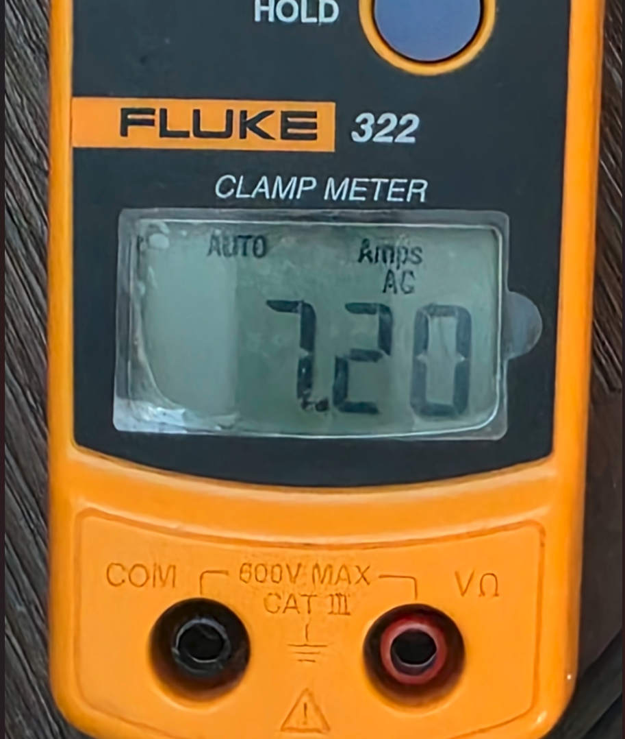

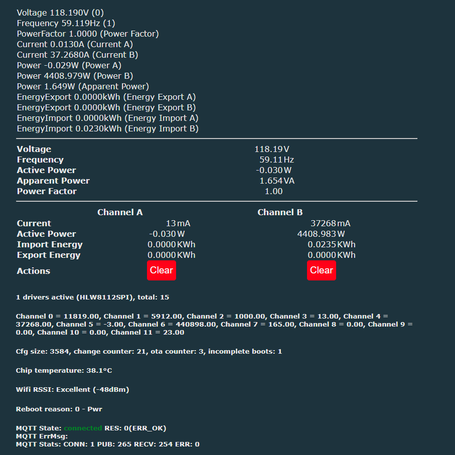

    alexsahka
    Interestingly, after flashing the new firmware, my device is reporting current readings exactly 5× higher than the actual values. Is there a way to recalibrate the scaling factor or apply a correction offset in the configuration? Thank you!

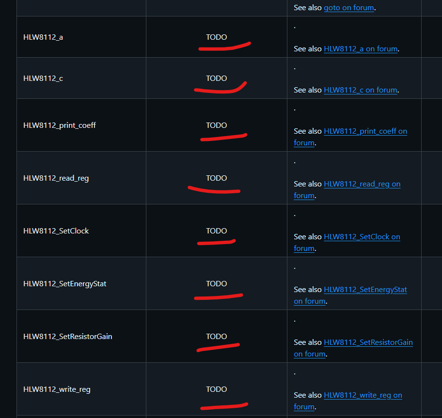

    alexsahka
    >>21794549 Thank you for the reply. I tried running some HLW8112 custom commands, but it looks like they aren't supported yet. I noticed a 'TODO' status in the code/documentation—am I interpreting that correctly?
    Also, the standard VoltageSet/CurrentSet/PowerSet commands are returning errors.
    Table with HLW8112 function names and TODO status for each entry
  • #36 21795260
    Posts: 14770
    Rate: 12913
    This does not mean that they are not supported. It means there is no docs for them yet. The author of HLW8112 SPI feature didn't fill their descriptions.

    #37 21795311
    alexsahka
    >>21795260 I managed to get it working. Using the command HLW8112_SetResistorGain 1 1000 1 caused the voltage readings to spike into the thousands. However, after running HLW8112_SetResistorGain 0 1000 1, the voltage returned to normal and the current readings became accurate (instead of being 5× too high).
    I also noticed a channel mismatch: my current clamp is physically connected to Channel A, but the interface displays the data on Channel B. If I plug the current clamp into Channel B, the interface shows no reading at all.

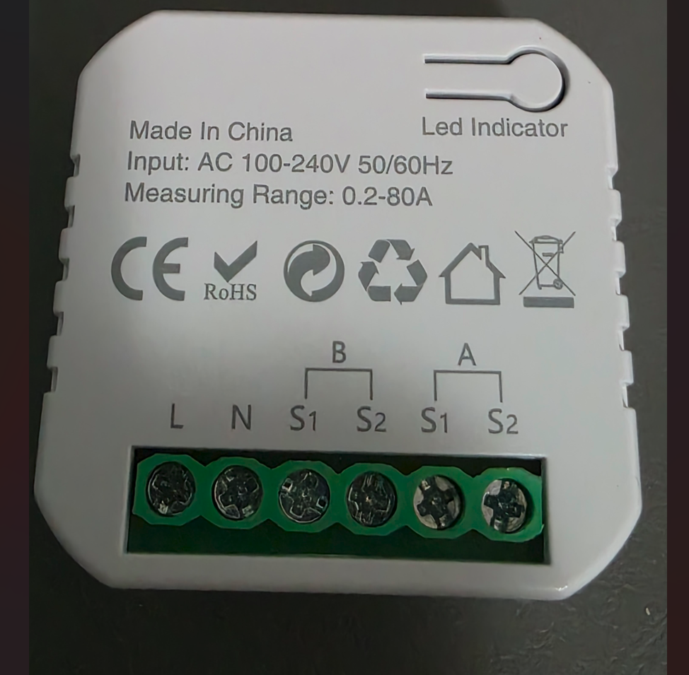

    >>21795356 Ah, I see—the manufacturer swapped the labels for Channel A and Channel B on the outer case compared to the actual circuit board.

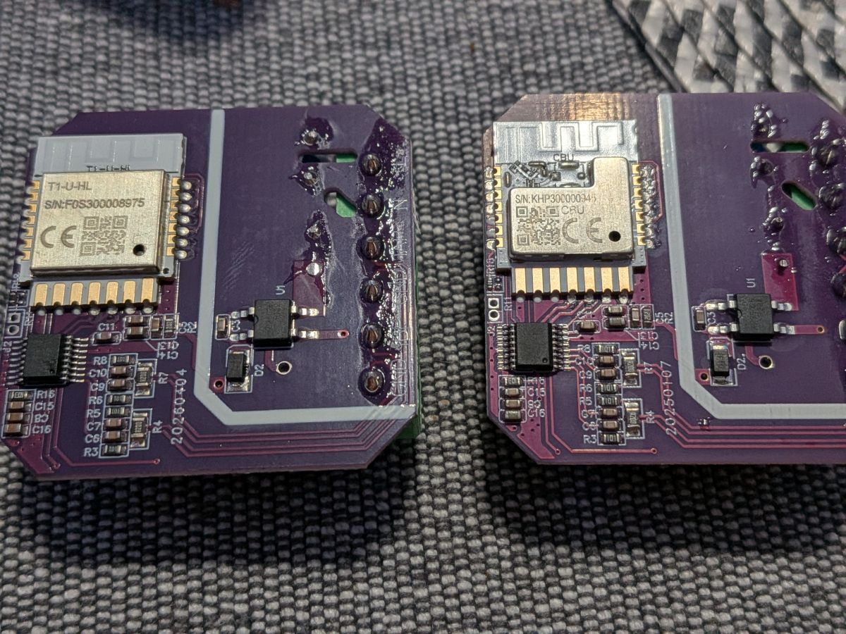

    #43 21947196

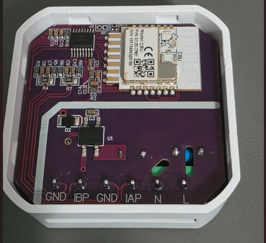

    CyberCraft1
    Would there be a way to get the HLW_8112 driver added to the BK7238 image? I have a newer 2-clamp power meter which comes with the T1-U-HL (BK7238) left in pic. I also have the older model with the CBU (BK7231N) on the right, which I have working with OpenBeken.
    The power meter circuit board seems to be exactly the same, other than the Tuya module.
    CBU (BK7231N) Pins:
    "pins": {
    "9": "HLW_8112_SCSN;0",
    "24": "WifiLED;0",
    "26": "Btn;0"
    T1-U-HL (BK7238) Pins I believe, WifiLED lit up with this config:
    "pins": {
    "21": "HLW_8112_SCSN;0",
    "8": "WifiLED;0",
    "6": "Btn;0"
